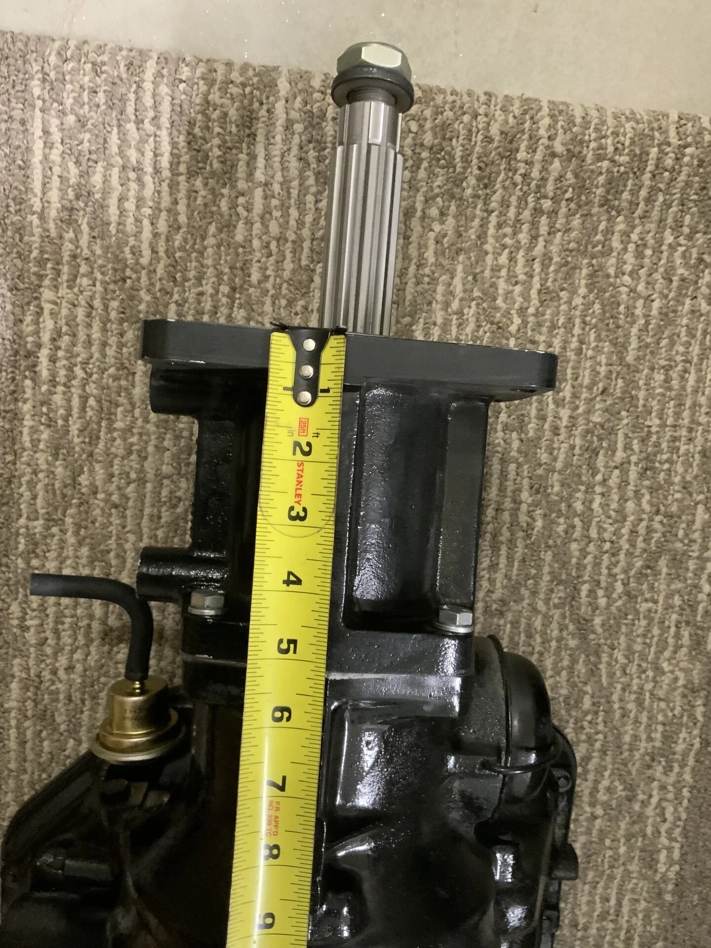

I run a GM305 /th350 and my shifter is pretty close to where it was originally, maybe slightly rearward 2 inches. The shorter V8 vs. the straight 6 is a trade off for the longer th350. How long is your t-case adapter? A longer output tail shaft tranny could be the issue. Got pics?
I bought an Advanced Adaptors kit to go from a TH350 to a 10 spline transfer case. It took 7 months to get. I had a TH 350 transmission built to incorporate the output shaft that came with the kit.
That's about right for the adapter length. How much will the drive shafts have to be altered? I'll look at mine again but i do believe all the t/c linkage is original and not too far back. If I can figure how to load a pic I will.
I saw an old post where it is stated that you may have to make your own bracket to get back to stock, this also depends on how far forward you set engine. The bosses you see on the adapter by the vacuum accuator in the pic hold the bracket from AA for the shifter but unless you set engine uncommonly further forward you will most likely find the AA bracket puts the shifter at back of stock hole in tunnel cover.

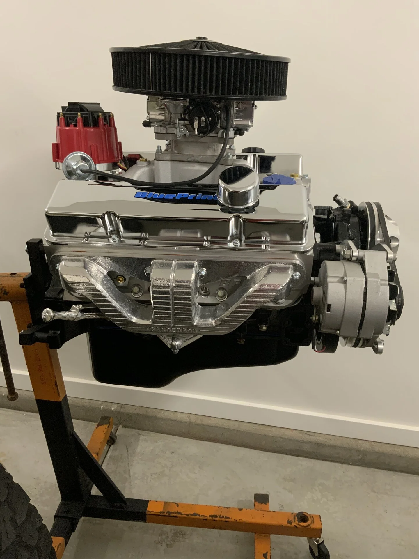

The original transfer case operates fine, It is not a vacuum operated one. I went on AA website and ordered their shifter relocation bracket and 1' Speedo extension cable. The cable for the emergency brake seems to short but I will cross that bridge when I get to it. I purchased her 15 years ago and trailed her home. Painted and switched out the original motor for an old 327 I've had since 1982 back in 2013. Being older now, its time for a new motor, automatic transmission and a cup holder.
