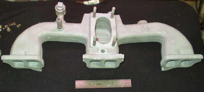

    Just about any rattle can high temp paint will get the job done. VHT makes high temp paint.
    The intake manifold can be sand or bead blasted to look like new. Then you can powder coat, paint it or just seal it. Here is a pic of my manifold after sand blasting. I will be powder coating it tonight with high temp silver. :grinpimp:
