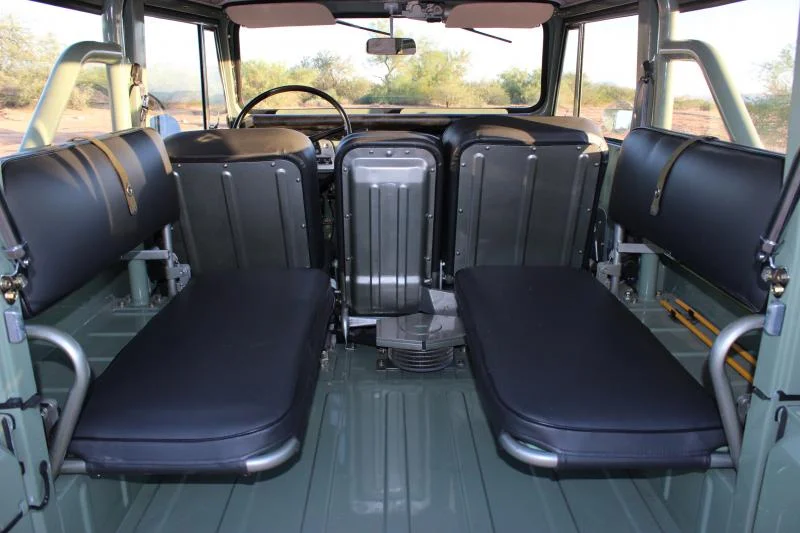

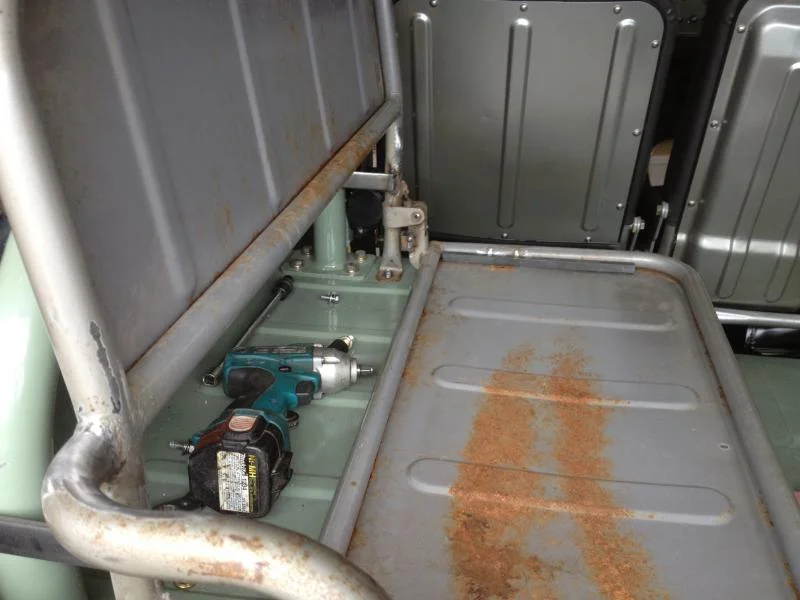

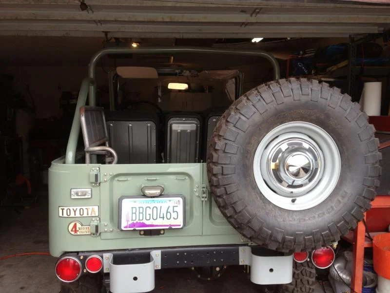

I have been working on getting the rear seats mounted. I had to move them inboard because of the roll bar. The original rubber bumpers ar useless now, so i modified the hinges to incorporate a stop. I also beefed up the seat bottom with 1/2" square stock to keep it from bending and built longer, beefier supports to the side of the bed.

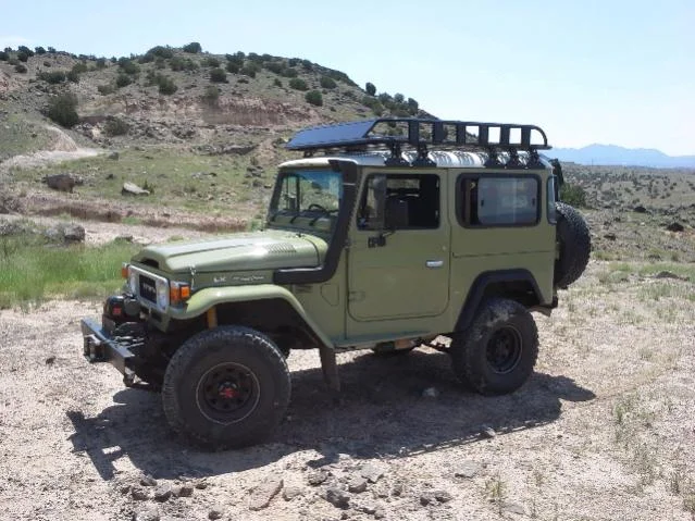

I want to apologize to those of you who have been following this thread for not keeping it up to date. I have been focusing on getting it finished, and really wasn't taking any photos along the way. It turned out nicer than I ever imagined in the beginning, and enjoyed building it more than any of my previous projects.

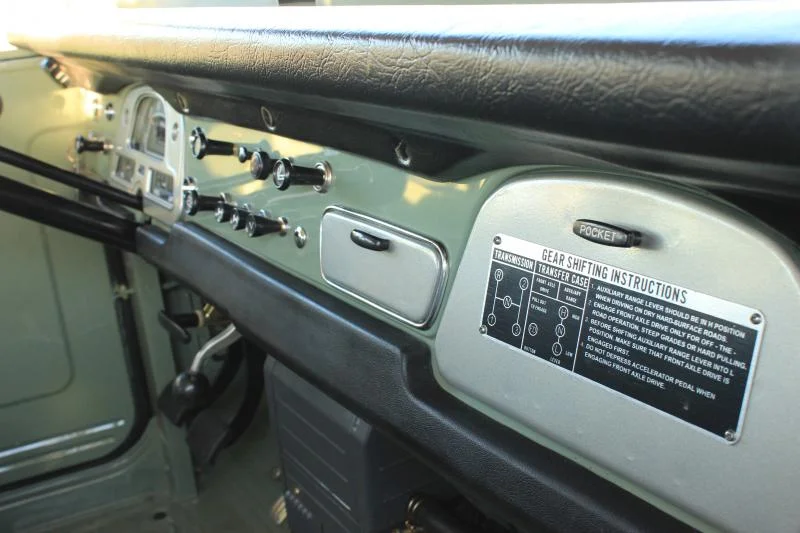

The requisite classic cruiser photo

Absolutely beautiful !!!
That is one sweet cruiser my man. Congrats!
Beautiful!!! I have used your build thread as much as my FSM. Thanks for sharing.
