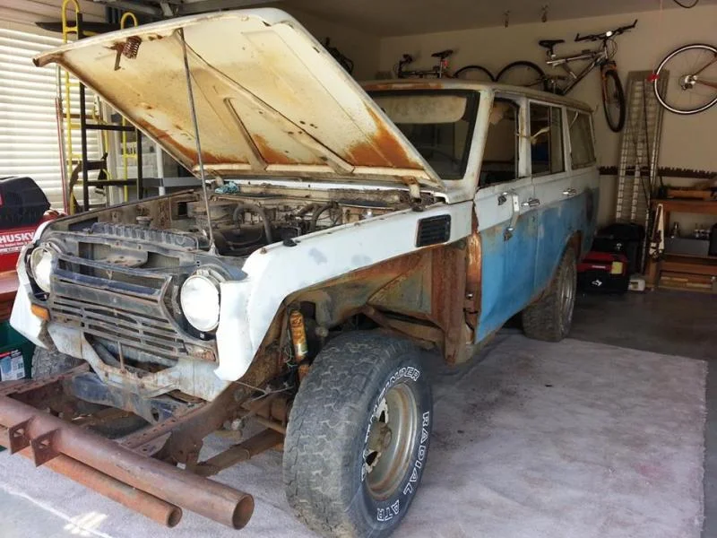

just bought this fj55. im new to fjs and I was pointed to this forum and was told that yall could help. im very excited about this rebuild.

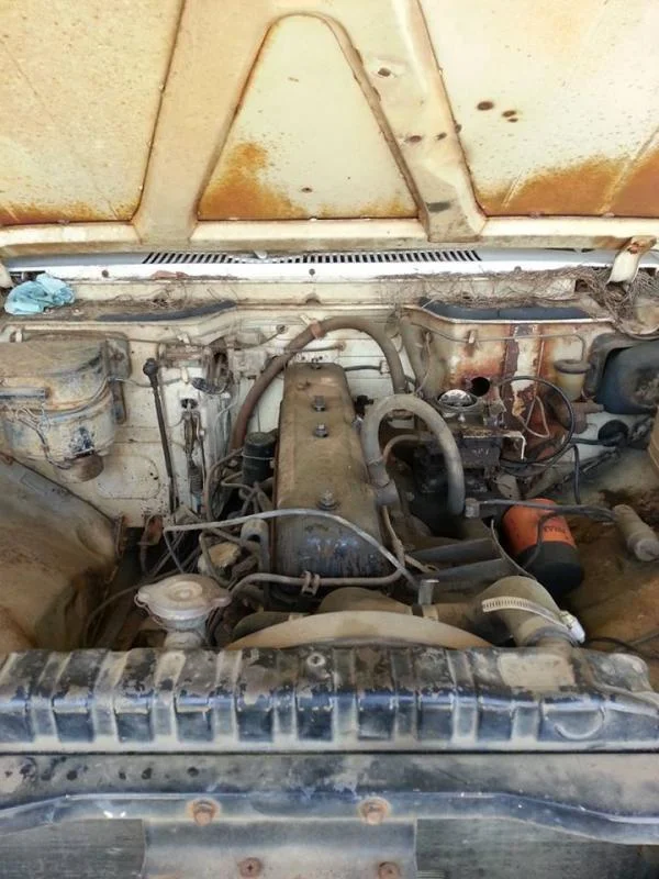

Ill look around in there a bit. Does anybody know the diffrrent carborator types like (and I don't know the terminology) single hole or something like that. Does anybody know if the 1969 fj55 have a single carborator hole/bore/tube or will I have to post some pics of the aftermarket strange carborator that is on it now

Pics always help, especially for non-OE.
Probably be useful for you to know the block casting number found on the passenger side of block, closer to firewall. Can determine production date from it, which also aids in determining corresponding components, since there are changes mid year.

Its an f125. Does that help?
It doesn't look like an F125. Maybe somebody was having some fun with a paintbrush!
There's an off chance it's actually a 68, as you do have the front marker lights that were common to both years. If so, you could have a metal adapter plate on the intake manifold as well that adapted it from a 2bbl down to a one bbl.

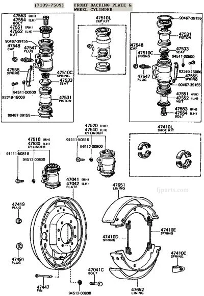

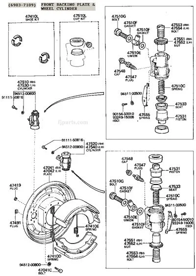

On cylinder rebuild
Fronts should be the same as 40s on the early drums, rears were 55 specific. You can get cylinders and rebuild kits from $OR -

Drums could remain on the rear and I was wrong in saying the OE rebuild kits are NLA, because Onur (beno, whom you might want to contact) just shipped rebuild kit for the rear of the 76.

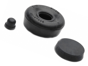

I'm not an expert on brakes. The brake cylinder rebuild kit on fjparts.com just shows a few rubber pieces. I was unsure if this was a rebuild kit because it was so cheap and there wasn't much to it. Could anybody verify that for me. I'm doing it on all 4 break drums.
