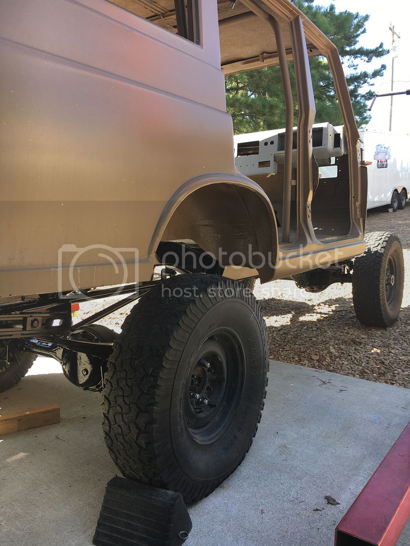

Here is what's happened to the drivers side rocker. When the primer and paint went on, there were no signs of rust coming through
Unfortunately, as I went around the vehicle, there are a couple of places where rust is pushing through the paint. To say I was unhappy to see this is an understatement. The body was sandblasted to clean metal before being painted, so it appears there was a problem with the way it was primed (2 part epoxy) and painted (urethane). I'm going to figure out how to do it right and redo it myself. Hopefully, I can make it turn out ok.

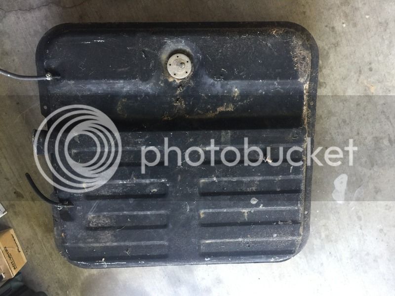

I looked up fj55 fuel tanks today, and from the pics and diagrams I saw, it looks like i may have some other tank on mine. Does this look like an fj55 tank to anyone?
It was mounted before, so that really isn't an issue, but it only has provisions for 2 fuel lines. Do in need to a third port added for a charcoal canister?
Stock tank should have four vent lines coming out of the tank and one overflow line coming down from the fill neck. The line going to the char. can comes off the fuel separator. Yours doesn't look stock to me, but I'm no expert on any subject. :)
