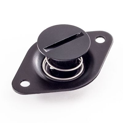

I have been wrastlin' with this issue too. I need sliders and i was going to use 3x4 and wanted to go from tire to tire. I am not sure how i want to secure the lower fender and welding is the easiest until you need to pull apart. I saw someone had made a bracket but it wasnt my favorite. I would like to be able to fold a 90 on the fender and create a 3/4-1" lip.
Ooo I think I like the dzus fastener idea. If I wasn't so cheap I would use them on every inch of my pig.
