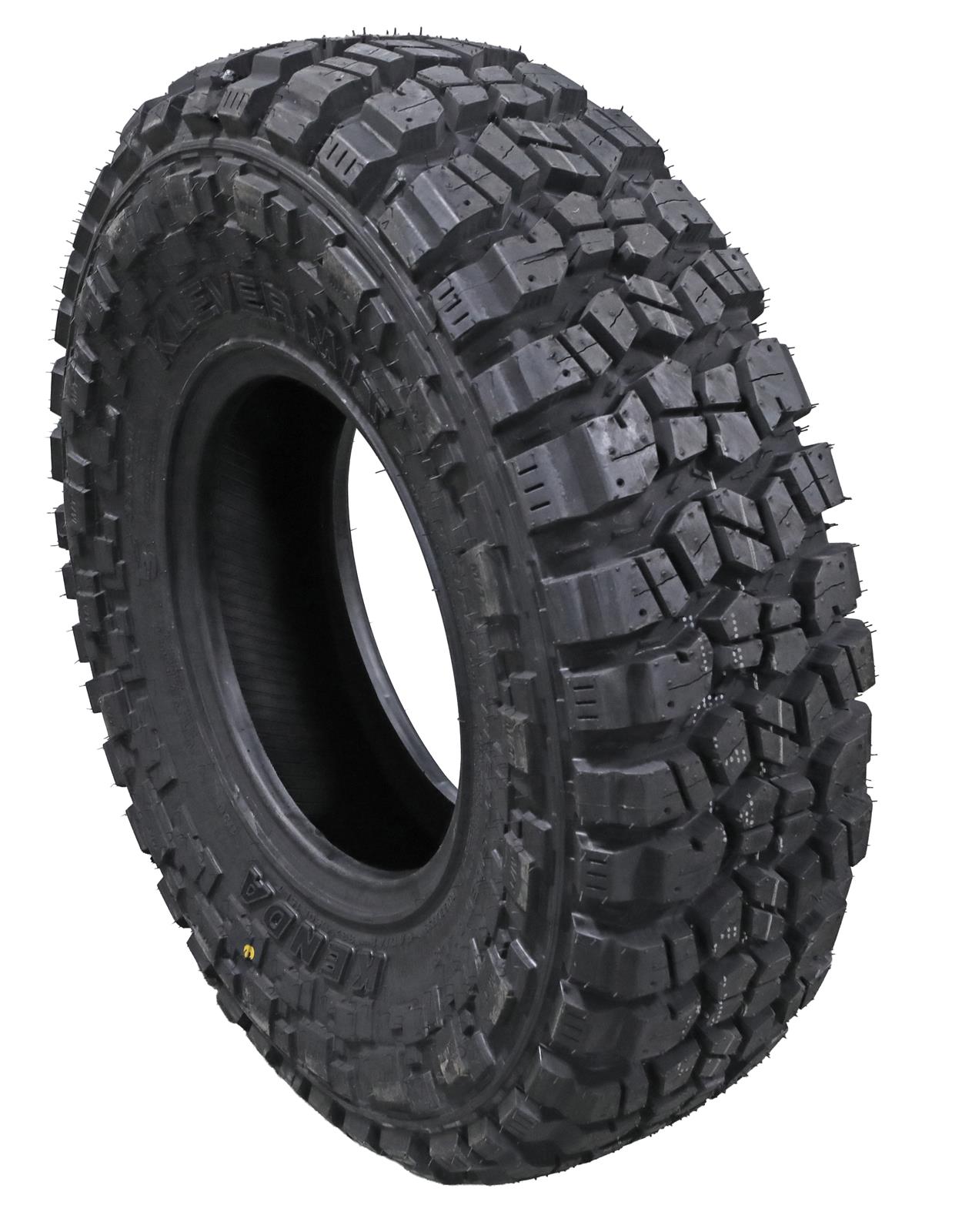

To start, I need to get the truck rolling so we can move it around. The tires are dry-rotted and shot. I almost broke my brain trying to figure out FJ40 wheel and tire combinations. I finally decided on this:
16x7, 4.00 backspace
I would like to be able to run hubcaps, but I cannot see $450 for shipping on the City Racer 16s. I think there was an effort at some point to mount hubcaps on these Vintiques but did not see a definitive solution. If so I would be interested.
Also, I am moving to 35s on my 100, and I hope to be able to move my 285/75/16s over to these at least temporarily.
