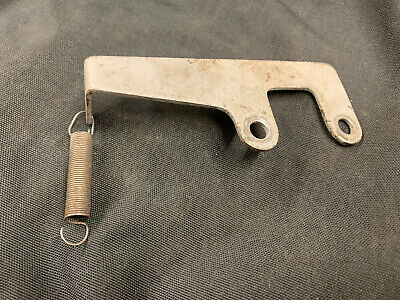

So now I have the right accelerator cable hooked up to the carb (thanks for pointing that out @MDH33 !) and realized I need a return spring and a bracket. The bracket is no issue, but I cannot seem to locate a spring, does anyone have an idea of what specifications the spring should be? I also got a used PCV valve of the right style from another user for the price of shipping, but I noticed that it seems that the airflow path is opposite of what it should be I think, when I suck on it, it stops the flow.

Here's a pic of the bracket and return spring. The spring isnt anything special. I bet you can find something at a local hardware store that's the approx length and tension.

I know Mark A has reproduction brackets available, and ToyotaMatt has repop return springs if you don't want to go hunting.
057-40ar
Yeah, I was gonna go through mark for the bracket I was pretty sure. If the spring is just something pretty standard and easy to find then ill just go to the hardware store.
