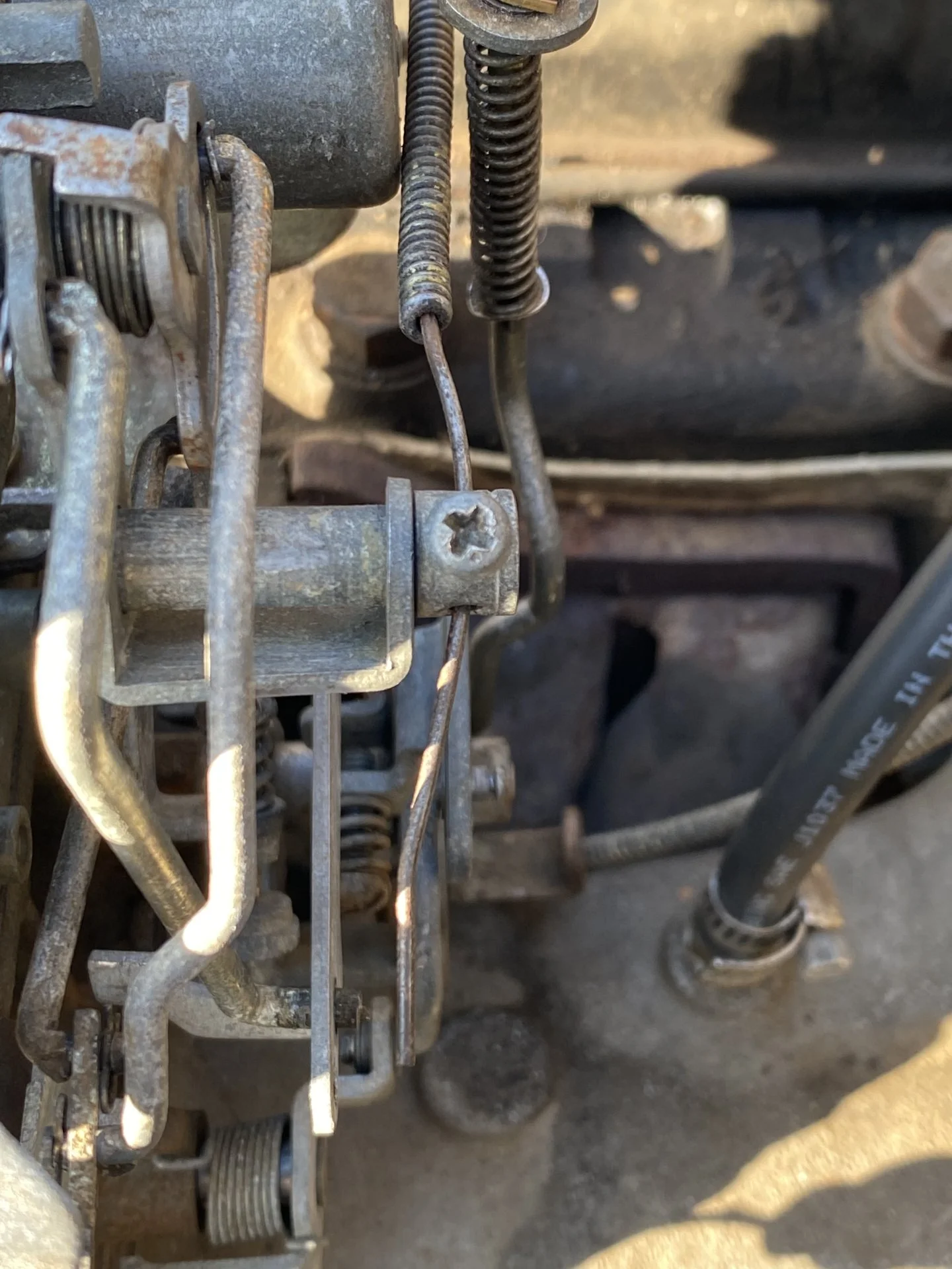

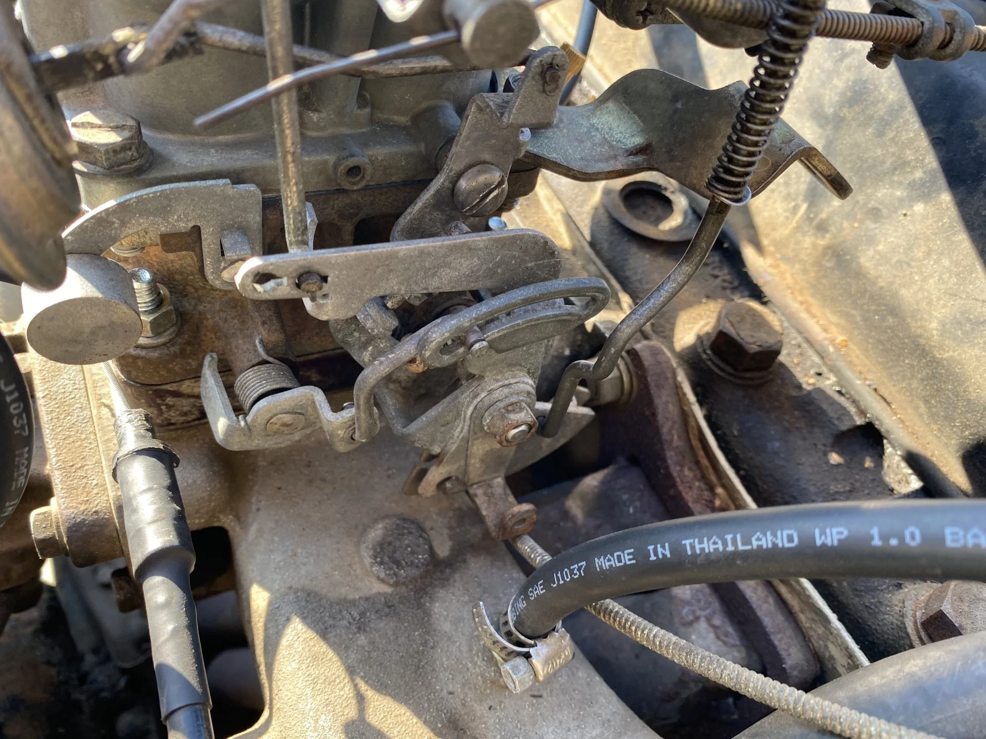

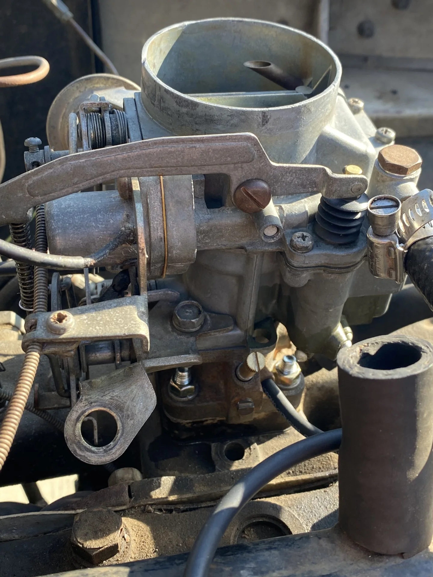

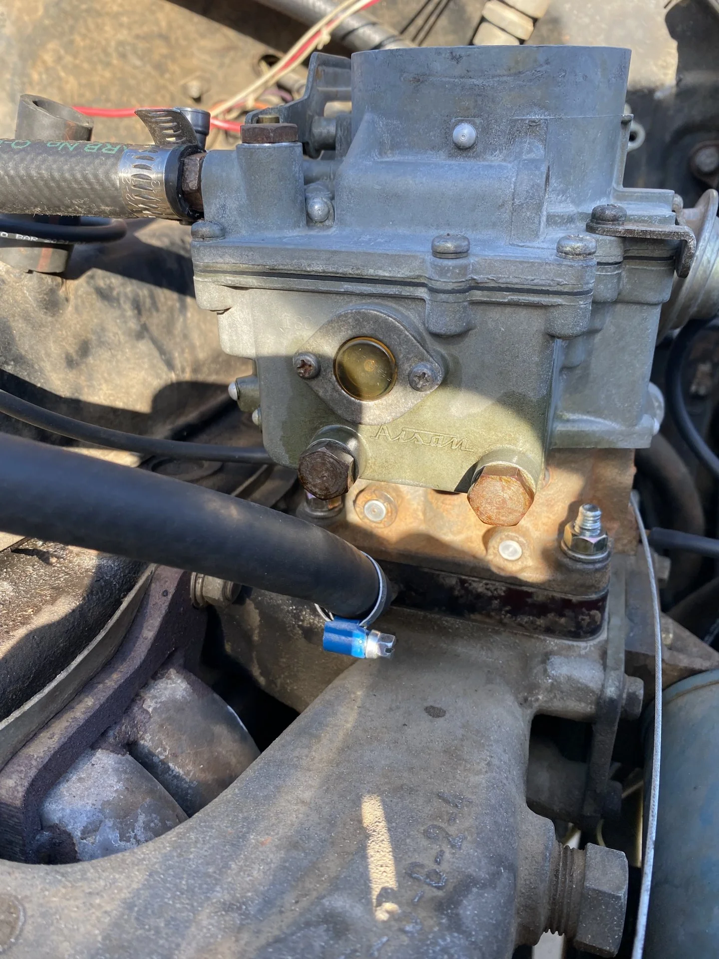

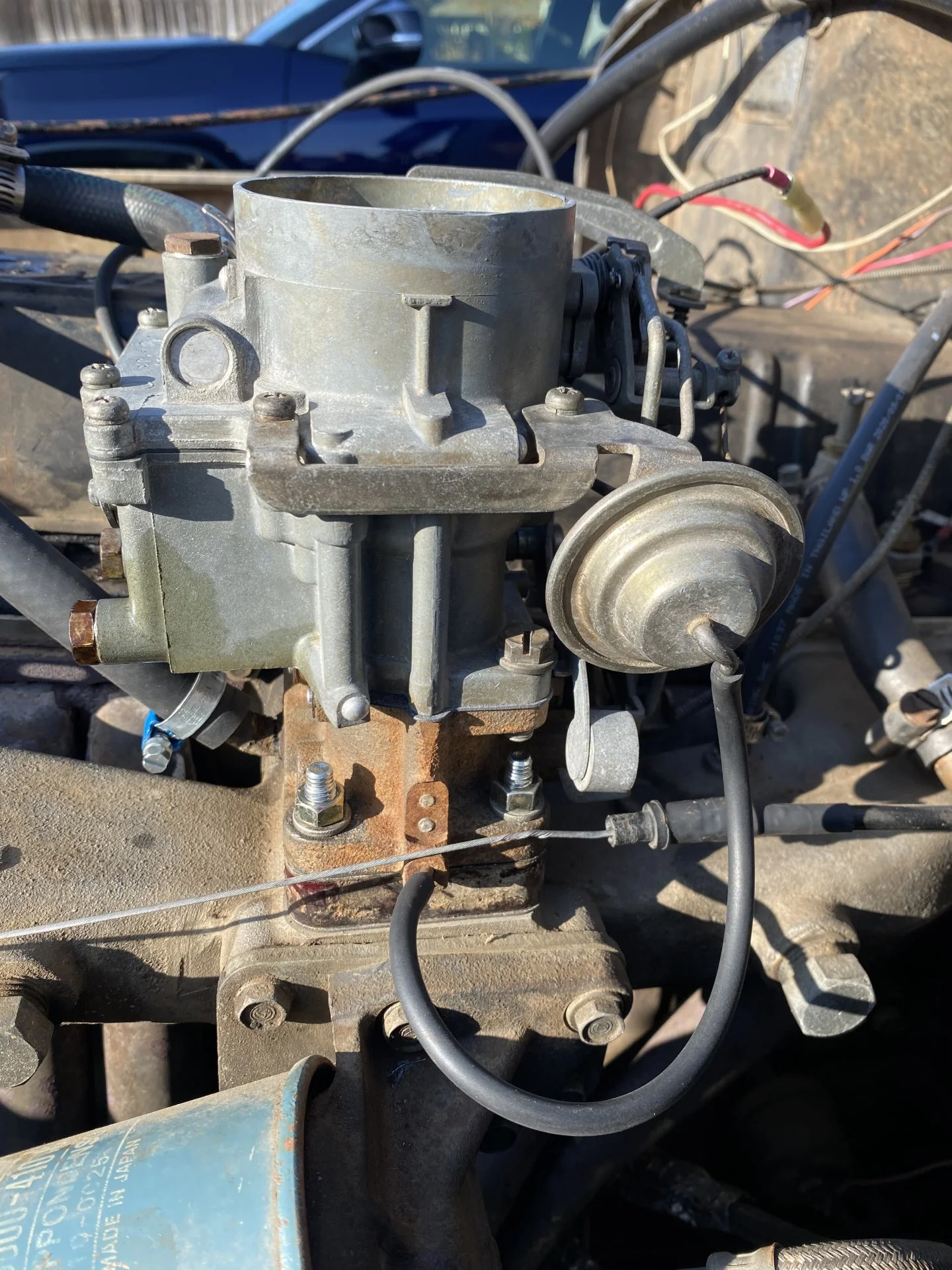

In the pics, your throttle cable is disconnected, and it's the wrong kind for this carb. The pcv hose is loose, big air leak. What is the big manifold vacuum line connected to (the SAE made in Thailand hose)? I don't see any fuel in the sight glass either. Is this how it's currently set up, or just when you first installed?
It’s just how it’s sitting there at the moment after I’ve been messing with it. The throttle cable isn’t connected because I’ve been trying to mess with the idle and didn’t want it in the way. The bowl is empty because I just checked the jets sizes. The SAE hose is just manifold vacuum that goes to a vacuum gauge inside the cab. I tried to get the right pcv hose from SOR, but the one I was sent was too small so I have this for now. I was pretty sure this is the right linkage for the carb since it’s a July of 71, it looks the same as the one on the SOR carb identification page?
Edit: Sorry, I thought you said linkage, what would the right cable look like?

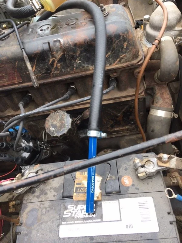

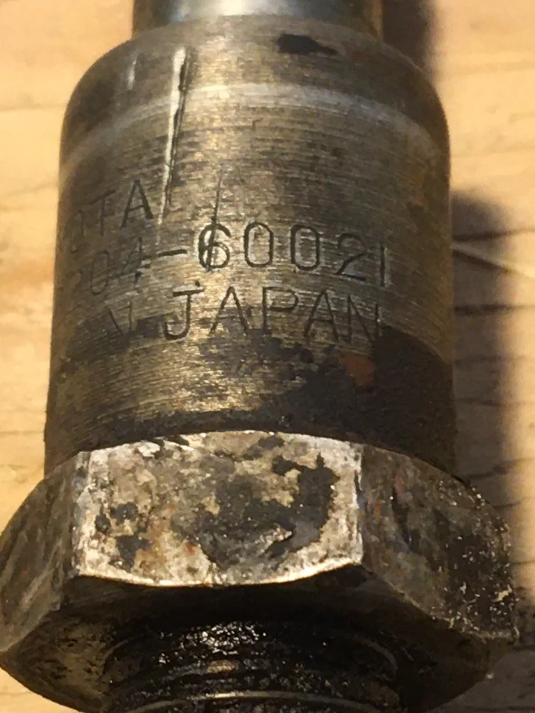

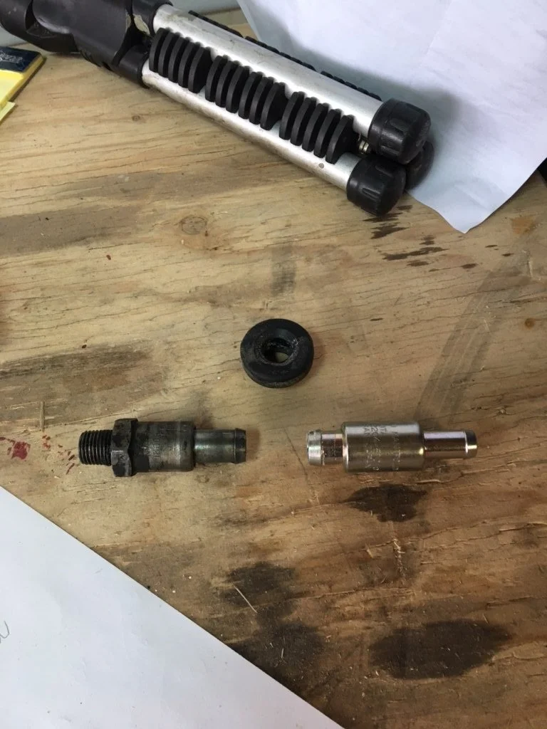

So a bit of an update. I guess it is the PCV valve? After taking the PCV hose off the valve and plugging it, it runs much better. I ordered a PCV valve off SOR earlier because it was cheap enough but forgot my motor is an 8/69, so the PCV valve was not compatible. Where I could find the earlier one or how I could possibly clean this one up? Edit: We are going to try putting a reducer in the neck of the metal part of the spacer that the PCV valve hose attaches to and see if that helps. I am also probably going to soak the PCV valve in carb cleaner for a bit later, I'll let y'all know if the reducer thing works.
Just suck on that valve. You should hear or feel a valve open and let air through. It's a 1 way valve. It lets air run to the vacuum off the carb plate or intake but not the other way. If you plugged the other side of the hose coming from the engine then get ready for side plate and oil pan leaks. Put the new valve on with new hose and good clamps and see if it fixes your problem. I
Unfortunately, the valve I have is the wrong style, maybe there’s a way I could get it to work until I find the right one?
