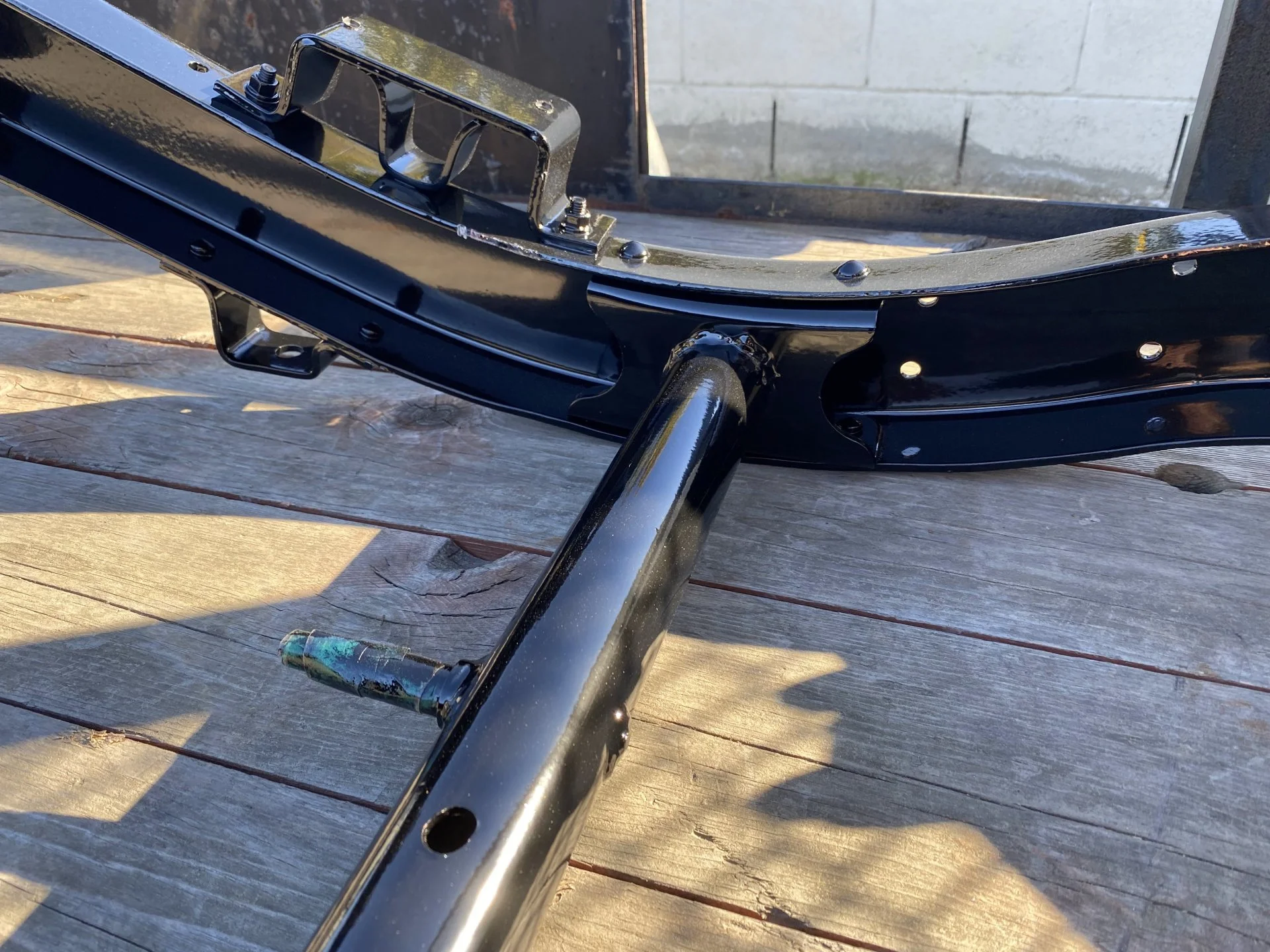

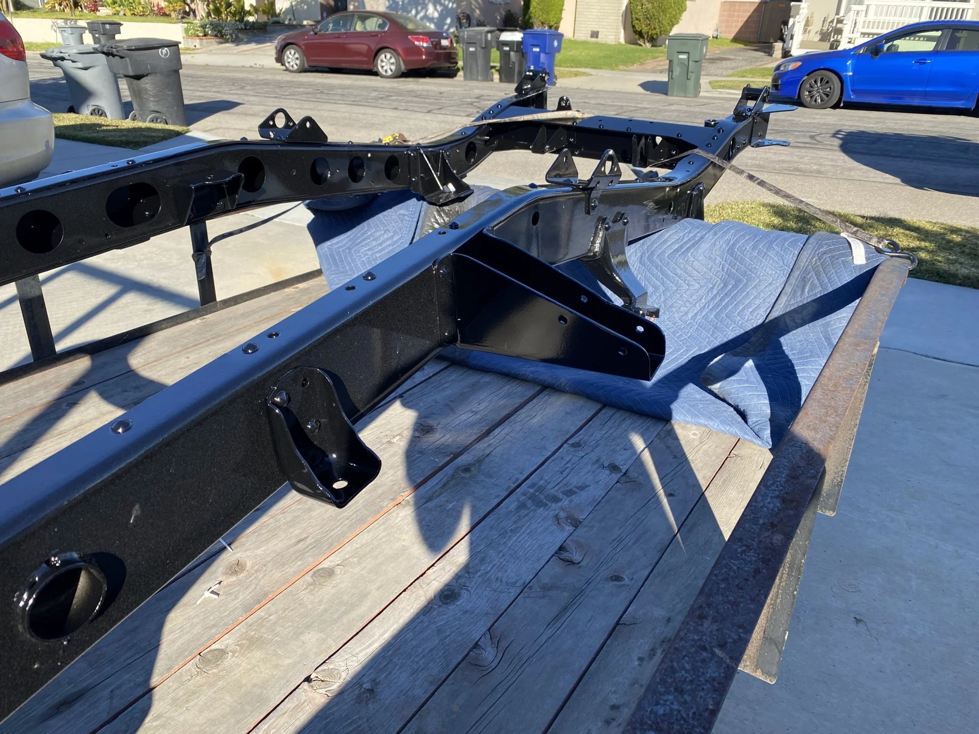

Got my frame back from powder coat this morning, I'm very satisfied with the work. You can find areas that aren't perfect but that wasn't what I was going for. If anyone in Southern California is interested, this was done at Crisol Metal Finishing in Gardena. It's a little dusty in the pics, but finish looks good to me.
They do nice work! And friendly I like them. I had my 60 series chrome wheels PC'D white along with a few other parts. look great!

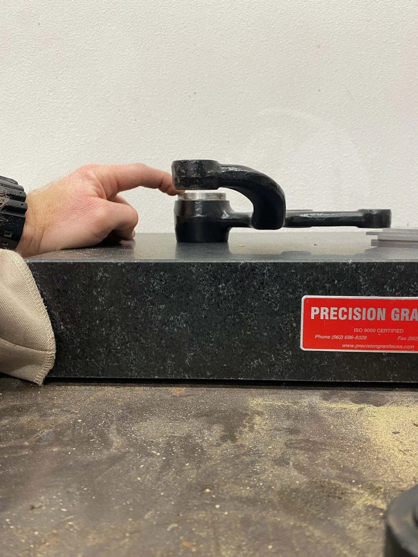

Forgot to tell you to check for radial bias on the center arm before you assemble. Road shock sometimes bends the hooked end of the arm.
Simple check: the flat on the arm where the drag link attaches should be parallel to top of the arm where you insert the bushings.

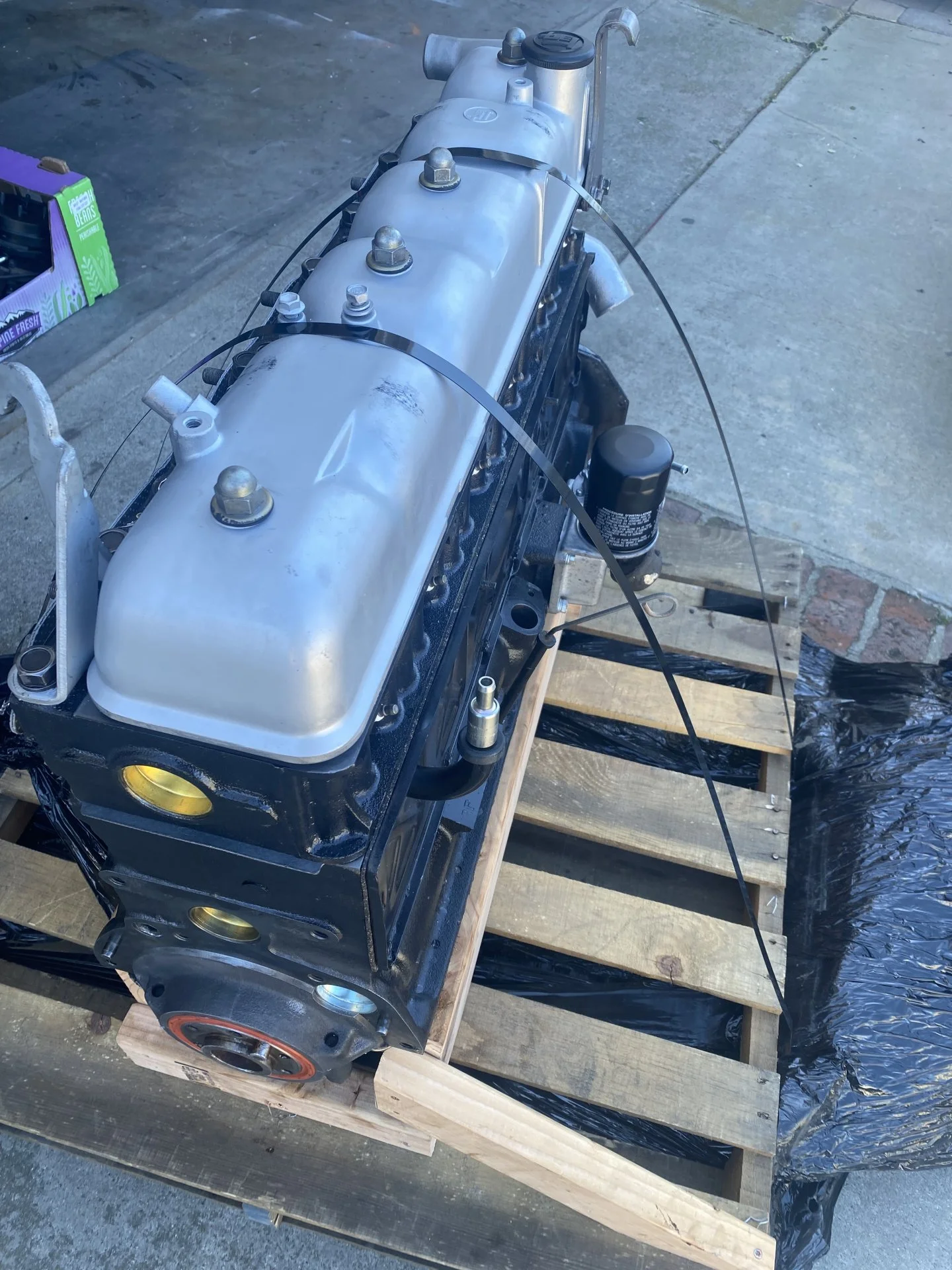

From the MM40 thread:
You have an oil-cooler water pump with a non oil cooler oil filter housing.
I can always count on your keen eyes, haha. So do folks cap the pump or cool the oil?
Don't cap the pump outlet. It will always fail at the worst possible time. Ask me how I know ;)

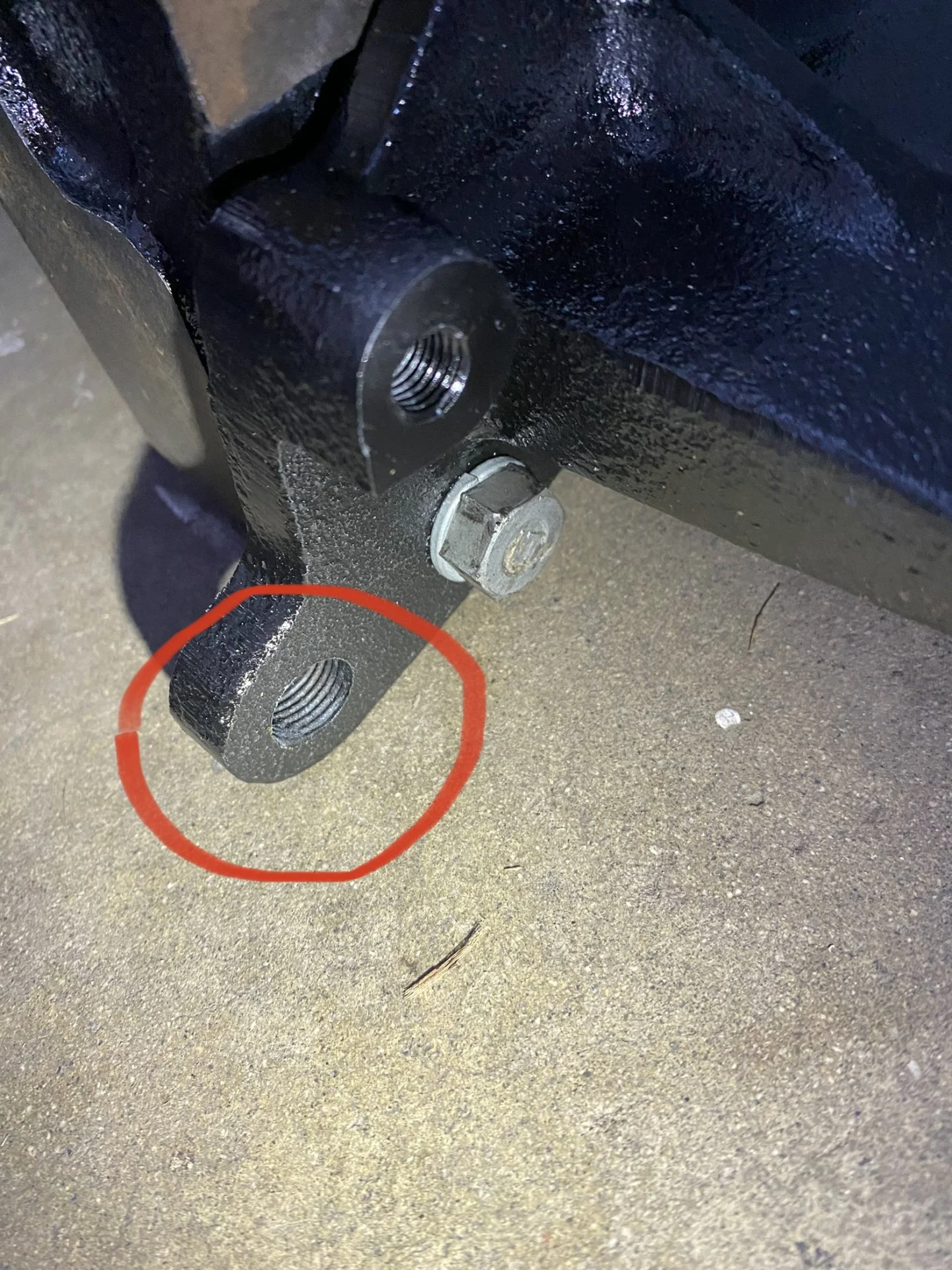

Dumb question- this is the driver side rear motor mount on the bell housing. What attaches to this location? I don’t think I had anything mounted to this when I pulled the motor.
Id be more then a little choked they banded it without some kind of softner against the valve cover...
