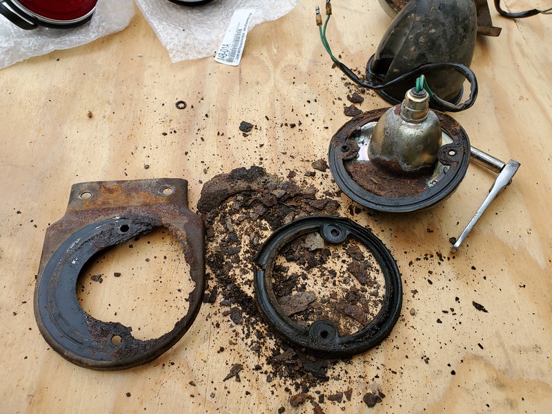

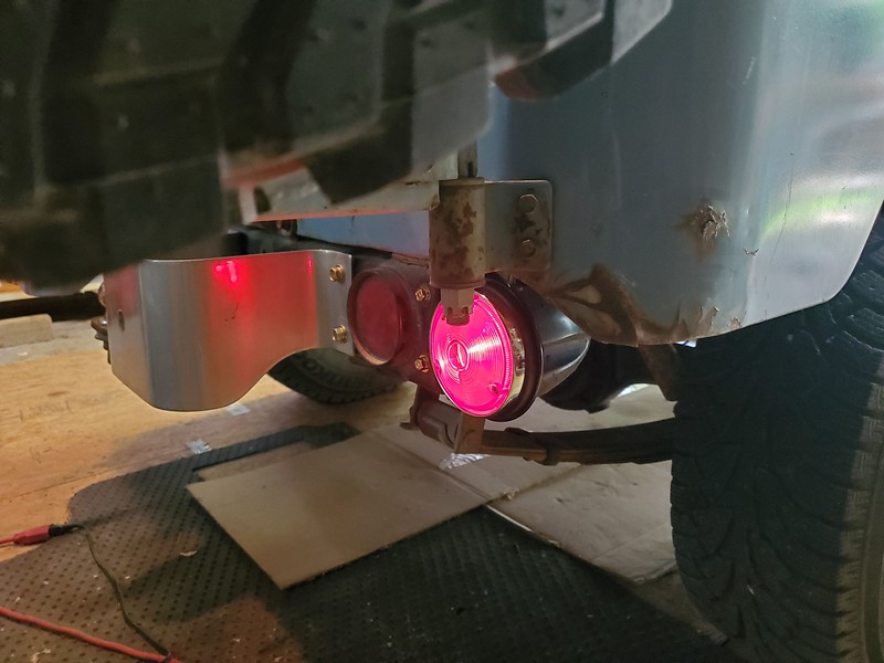

Your cones look pretty good! The lights are still available for 68 ( different and smaller than the ones posted by some which are the bigger 69-73, and have a different bolt pattern ). The metal brackets are hard to find. Btb has nice thick powder coated repros. I used them on my 68-69 40. They're nice.
My brackets and lights were toast too, but luckily the original 68 style cones and gaskets were good.

So I may be a bit confused, what‘s new, but the 69-73 taillights are different sized than the 64-68 taillights, and so are the associated cones. (And the pre-64 taillights are also different and smaller than the 64-68).
Here’s some pics - 64-68 is on the left, 69-73 is on the right:
I don’t think the cones interchange, the later 69-73 are shorter in height, not sure about diameter but they definitely mount differently (e.g. two bolts vs four bolts). I believe Cruiser Cults repops are for 64-68.

I don’t think the cones interchange, the later 69-73 are shorter in height, not sure about diameter but they definitely mount differently. I believe Cruiser Cults repops are for 64-68.
You have all your info correct! 👍
@ZooTownCruiser do you have 68 lights/cones on your 69? If you need a 69-73 light (beat up) and/or cone (ok shape iirc) the one pictured above is yours for shipping.
on edit: it’s possible your ‘69 has some ‘68 stuff (like taillights) due to transition timing, esp. if yours is an early ‘69
