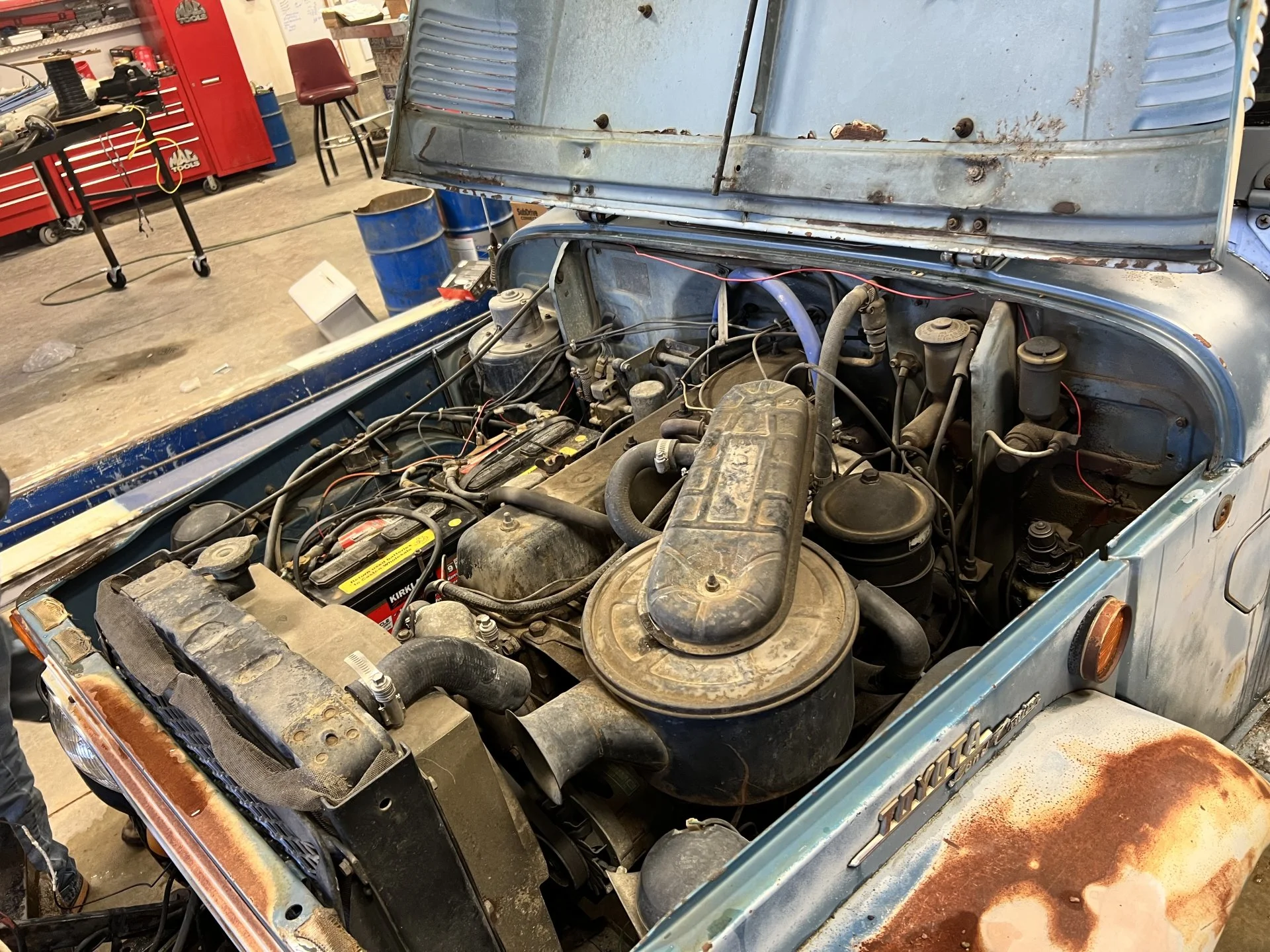

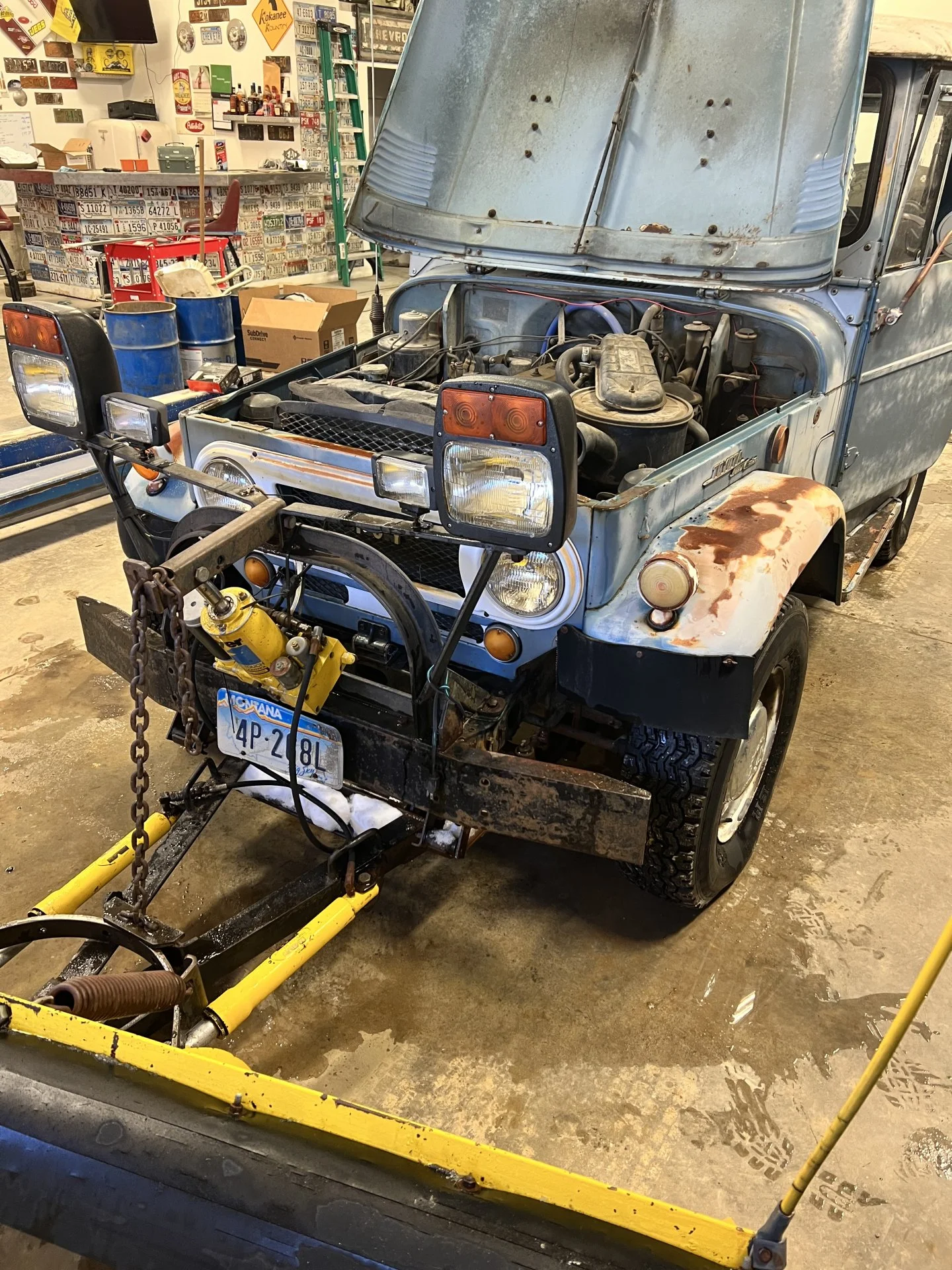

Hello all!
I am now a new proud owner of a 1969 FJ40!!!This is my first 40. I have had a FJ62 in the past and currently have a 200 series as my daily. I want to start this thread as a way to keep track of what I have done and get some lessons learned from all you veterans.
A big shout out to @rkymtnflyfisher for helping me pick her up. I really wanted to drive it home when I got her. Unfortunately we ( by “we” I mean me) tapped a little to hard on the thermostat housing trying to free it up and cracked the housing and began leaking coolant from the block gasket. So we headed back for a trailer 😪.
After I replace the thermostat housing and stop the coolant hemorrhage, what should I do? What do you guys start with when you get a new rig? I’m guessing all fluids, brakes, belts etc…
I would like to keep this rig fairly stock but would also like it to be modern day reliable as best one can.
You guys and gals are awesome and this community is so much help. Thank you in advance!!

Perfect thanks!! It actually runs and drives. I test drove it before I bought it. But like I said I unfortunately cracked the thermostat housing and didn’t get to drive it home. PO said the carb has been rebuilt.
Nice. Then I would replace the housing and driving it. You will find what needs to be done. It looks awesome already. I would enjoy it a bit and just take your time.
Love it! That thing looks like it will clean up nicely. My personal experience with the non-boosted brakes is not the same as mentioned above, my '69 with non boosted single circuit master and 4 wheel drums stops great. It actually has a much better pedal feel than my '71 with booster and front discs.

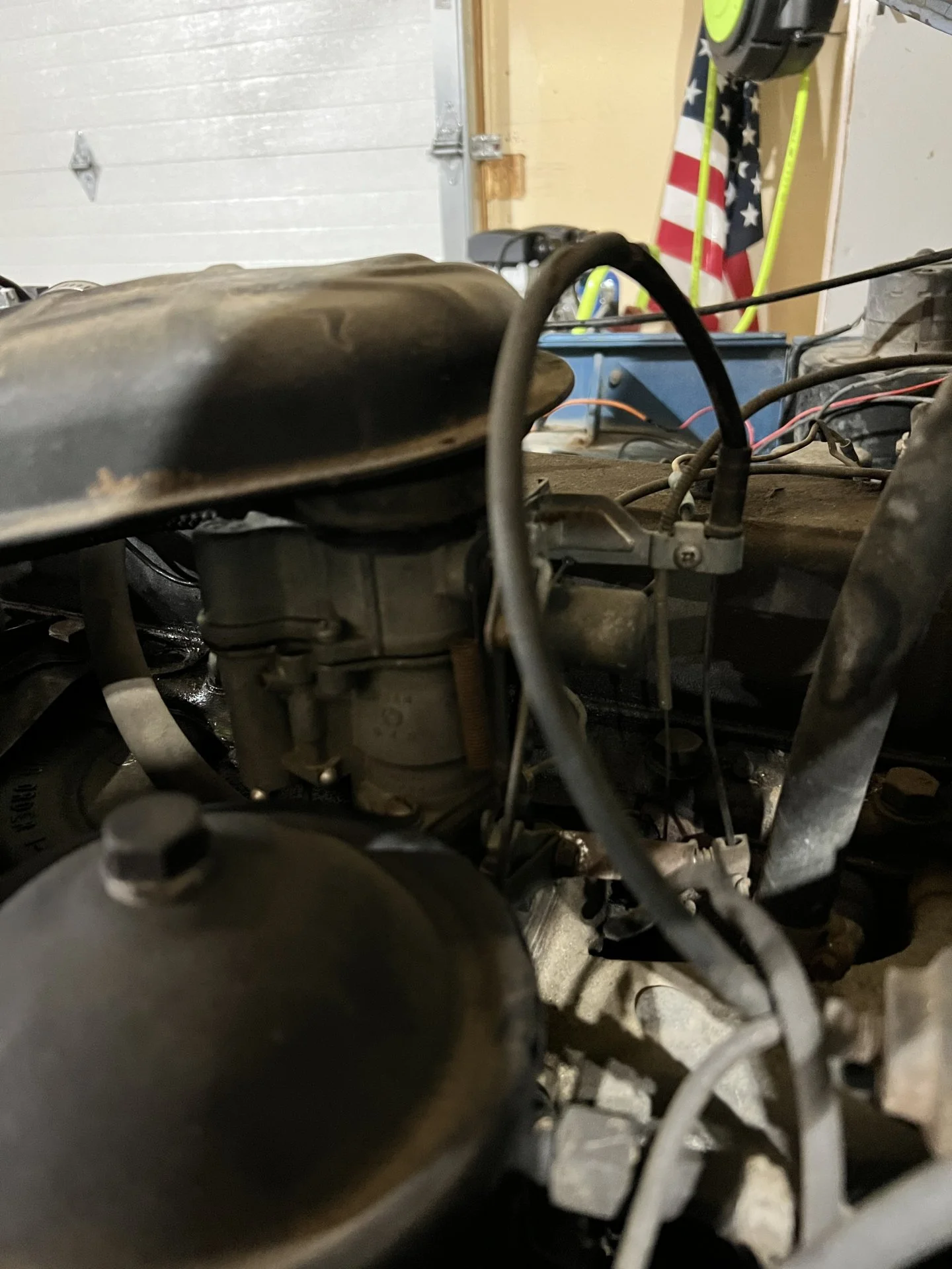

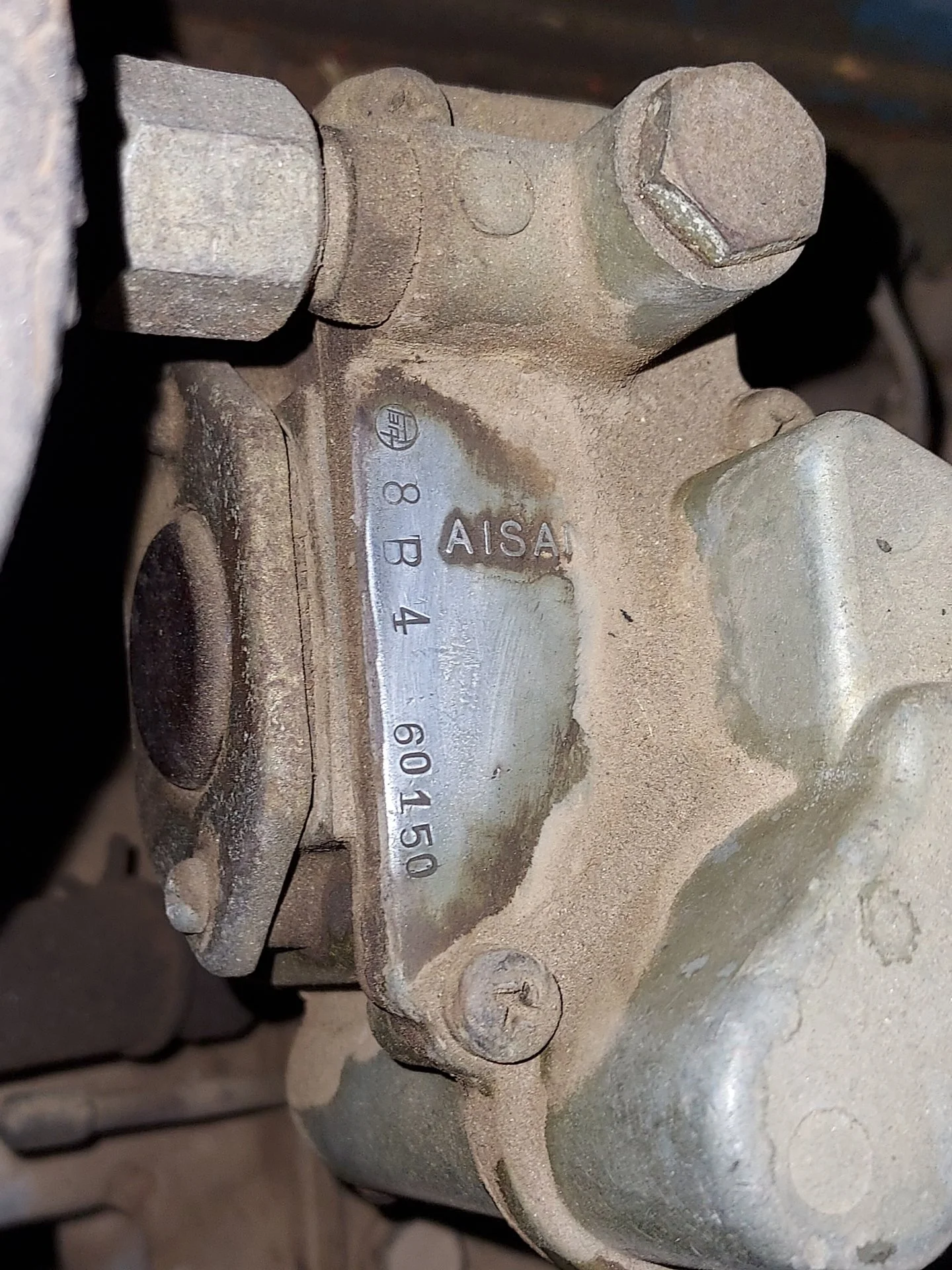

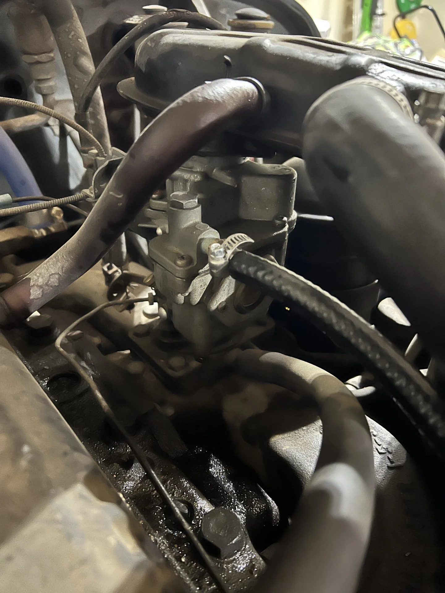

Not sure about the carb. Check out the pictures below. You tell me…
Vin# fj4060214
Correct early 69 single barrel. 👍 You got lucky, as they used a weird 2 barrel from 3/69
I ended up having an odd ball single barrel carb on mine. Rochester if i remember correctly.
