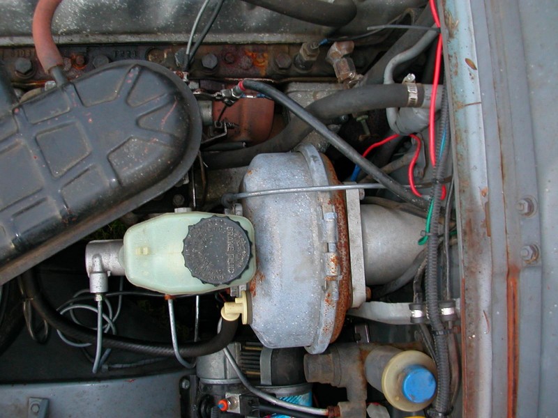

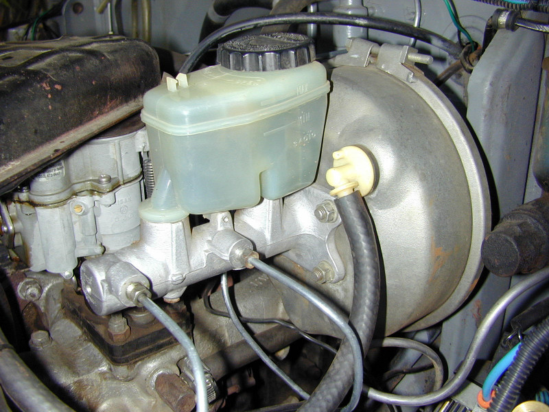

I recently finished the lower half resto on my 67 FJ40 with disc brakes all around. The issue I am having is what master cylinder do I go with and do I go with a booster. the rig has a fresh (72 F engine, 3 speed) with the 32 - 36 weber with factory air cleaner. All of the plumbing has also been replaced. I was looking at the Man-A-Fre dual without the booster and also one of these, I am not sure about fitment.. Any advise would be greatly appreciated..
th
Is that master from BTB? I'm interested in that as well for my build to keep all the parts easily replaceable, but I have drums in the rear. Looks to come with a proportioning valve, so it might be good with any set up.
...via IH8MUD app
th
fitment is a problem if you have the fin on the firewall
Per DSRTRDR, you will encounter fitment issues if you have the firewall rib. You will need to utilize a spacer or modify the firewall. Also if you are running the factory air cleaner it may interfere as well. I haven't completed my upgrade yet, but I am not planning on running a booster and I am using a Toyota dual MC from a later fj40 with a proportioning valve.
we used a 4-Runner booster (from the junkyard) on my 40 when my booster failed recently - it fits the '72 master cylinder and clears the 1F aircleaner that is mated to a 1F carb and 2F motor; a little bit of massaging was required on the small firewall rib in the '72, because the 4-Runner booster has a slightly greater diameter
Would you please post a pic if possible?
67 Pickup, with 2f, 1 barrel and 3 on the tree, disc brake front end
edit, I found an old post which says what I used
booster is from a 74 fj40, master is off a V6 mini truck, adapter for booster(3 bolt to 4 and clears the rib) is from Wardens.
also added an adjustable proportioning valve for the rear drums, not sure if it was needed.
used the existing hardlines that run under the radiator, then soft lines from the frame to the caliper. Not sure what we did with the 9mm to 10mm
