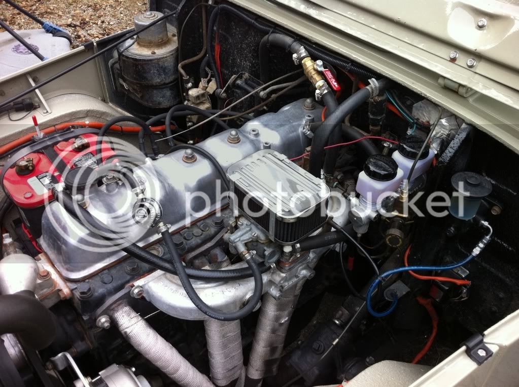

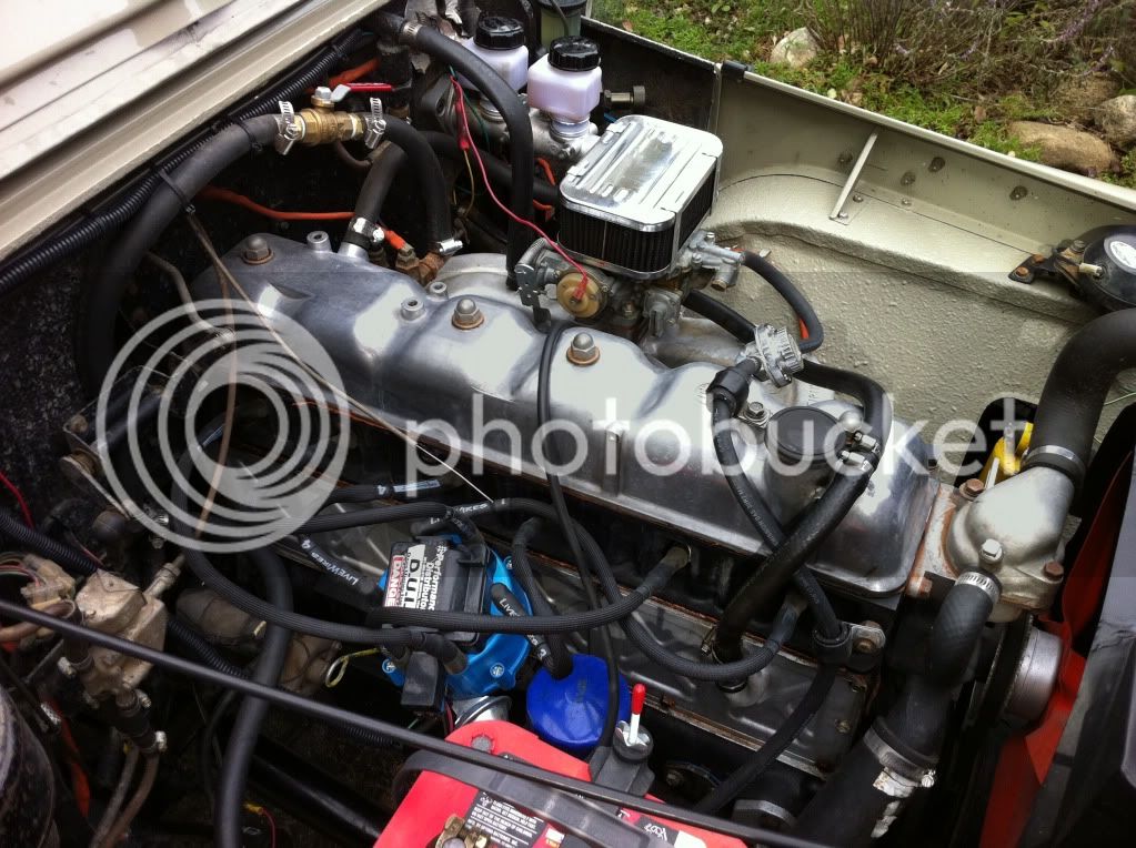

Johann,
Here's the picture I promised. I don't think you'll have clearance problems with that carb.
Pat

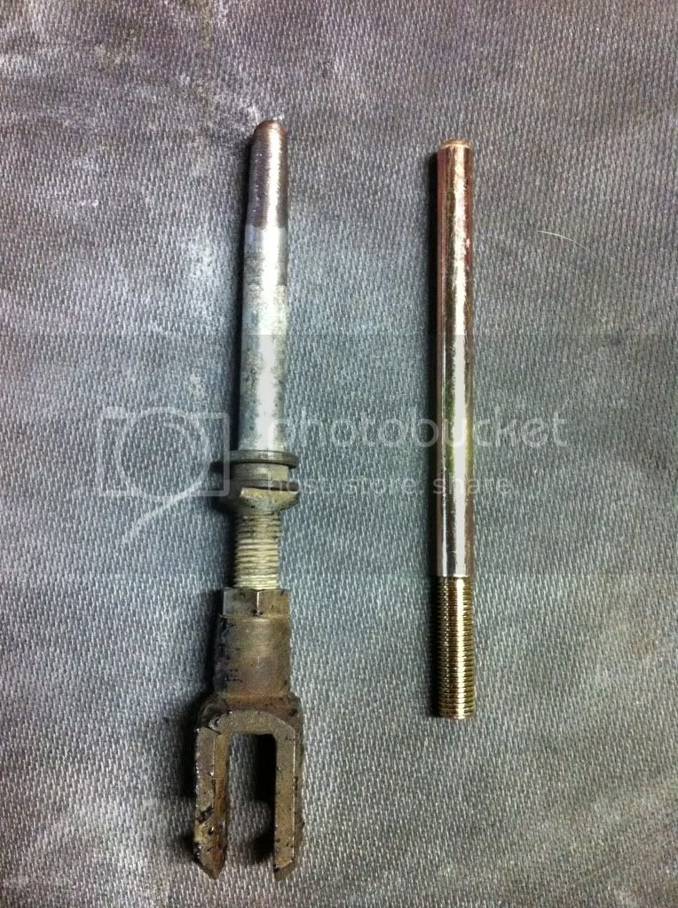

In your PM you had asked about the difference in the stock pushrod and the one that came with the Wildwood master:
If I could have found the end fitting to fit the new rod I would have installed that. I may end up making one but the old one works fine with a little material taken off.
