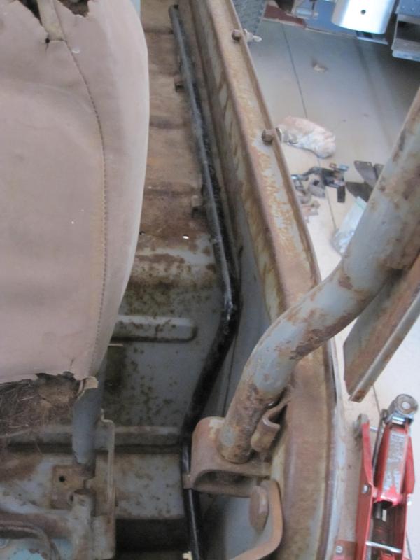

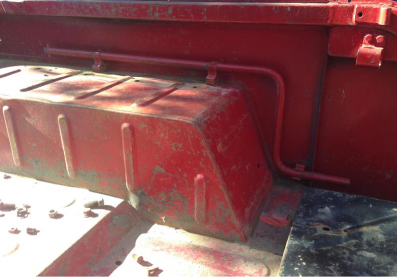

The starting handle on most models was stored on the driver's (left) side of the rear wheel well for the rear 2 clips , the front one was either on the side wall just behind the door opening or on the floor next to the driver's seat rear bracket .
Later model Aussie market (1981) was integrated in with the jack storage mounting rack -
These parts are nearly impossible to find and includes the starting handle and front bumper guide . I'm already making bumper guides and have them for sale on MUD as well as Fleabay - have a starting handle on it's way to be copied to spec so I can match it exactly . The front bumper guide cannot be distinguished between the OEM original and my copy - spent a lot of time getting them right and make them by hand . Just looking to copy all versions of these rare storage clips , seems so far we've figured out there are at least 3 versions ....
