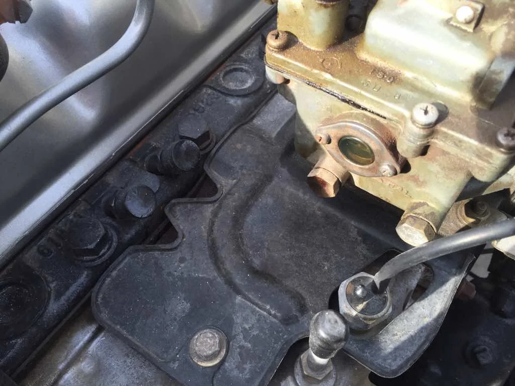

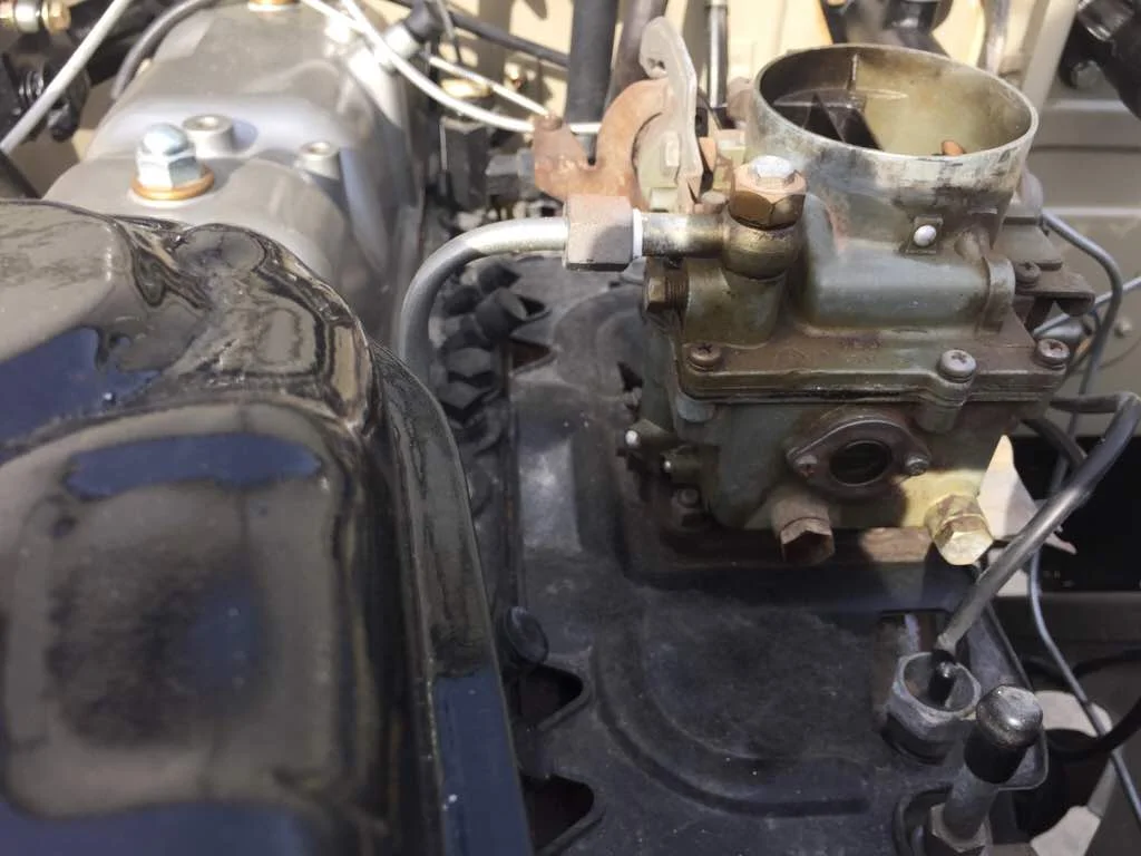

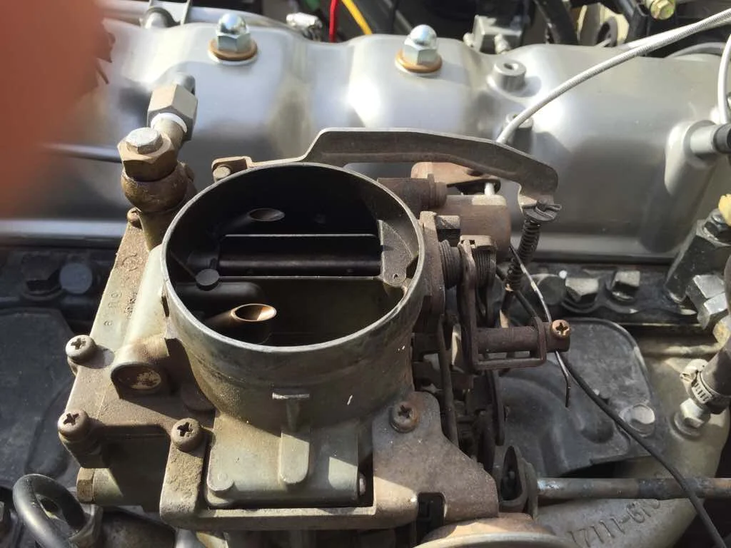

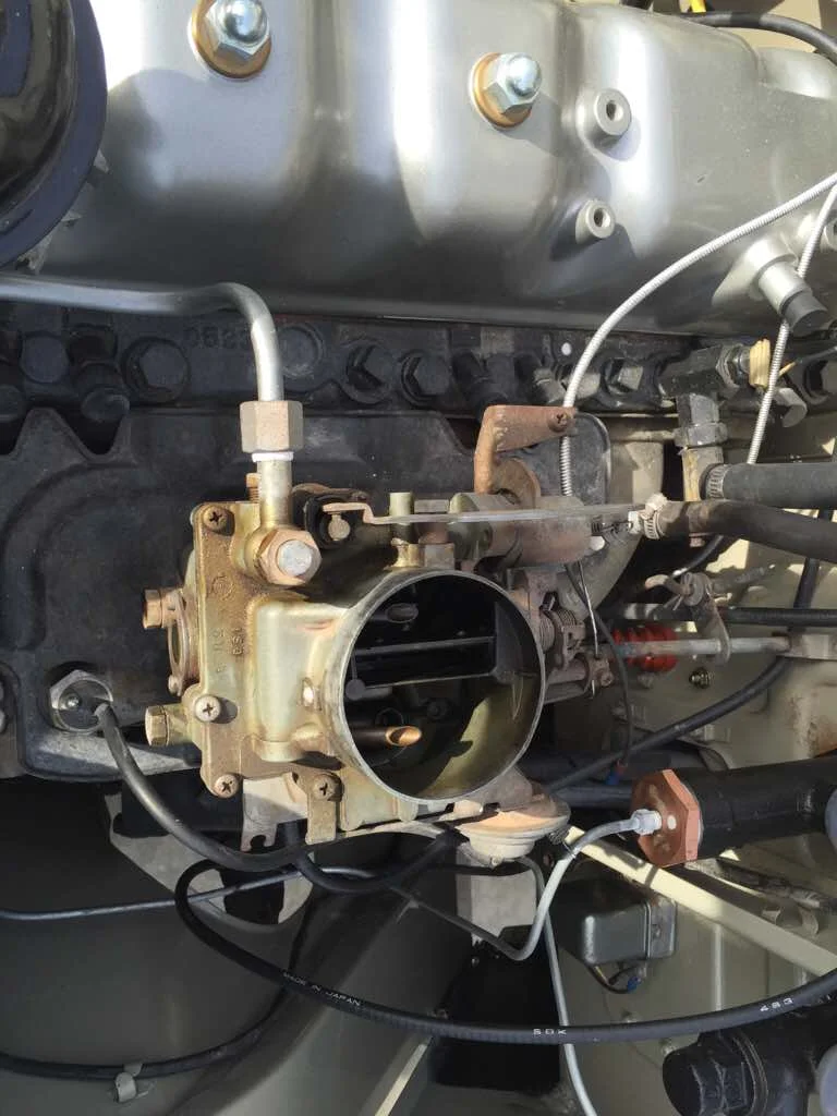

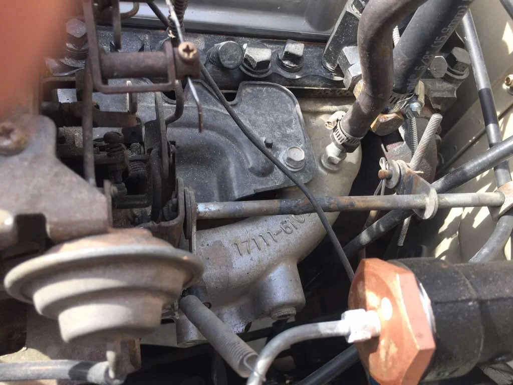

Carb help needed! I have a 79 2F and A carb manufactured in April 73. The carb is not retaining gas in between starts, is leaking gas in the front area where date code is, and the spring operated by the choke cable is shot.
What is or are my best repair or replacement options?

Thanks for the reply! I apologize for not being more clear but I don't know enough about carbs to ask an intelligent question.
As you will soon see, I don't know the part names. From what I can tell, the vertical,rubber bellows(foreground in last pic maybe accelerator pump???) is worn and leaking. Also the choke mechanism (to which the Choke cable is attached in pics 4 and 5) springs appear to be shot. When the choke cable is pulled, the mechanism pulls downward rather than horizontally. Lastly it is not retaining gas in between daily or weekly starts although the only leak I can see is from the bellows. Once cranked, i can cut off and restart but not after a day or so in between.
I am concerned that my problems extend beyond a rebuild kit or my ability to repair. I was hoping to replace the carb (prefer to keep Aisin) or send it out to have it professionally repaired.
My mechanical skills are limited to parts swapping at best. I can take a "unit" off and I can replace a 'unit". When I start trying to remove 'parts" from a unit is where I get into trouble.
any help or suggestions appreciated!
