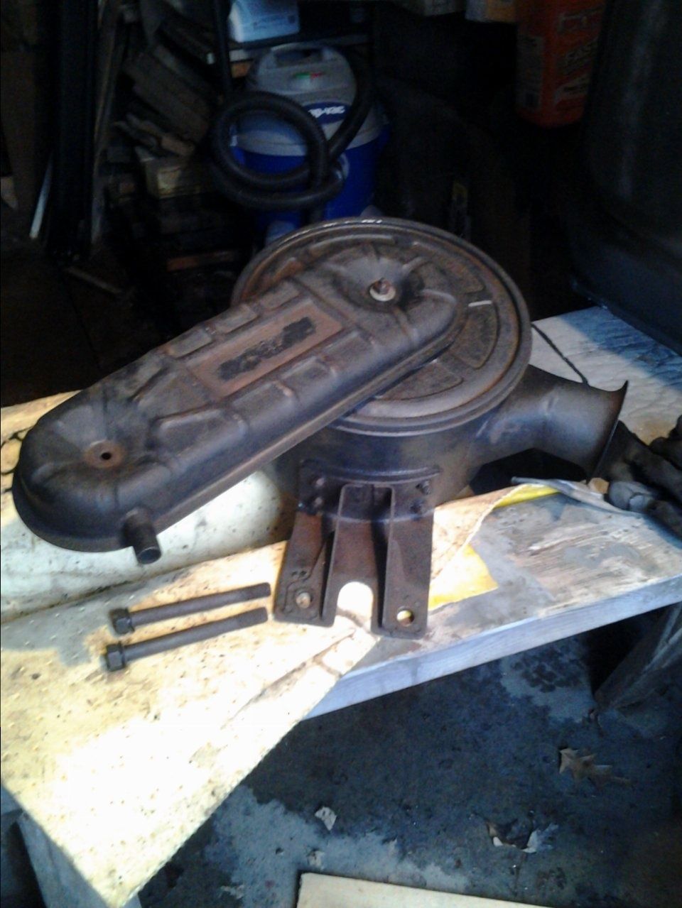

I need some help from the 25 section! One of the limitations of being a part-swapper as opposed to a mechanic is I'm quickly in a bind when I can't find it in a book. Leaky is a 66 (9/65) with a 2F. 1) Is the air cleaner assembly correct for 66? 2) Any guesses as to why the welding on the end above the carb? 3) anyone have a spare they want to sell or referral(as opposed to grinding welds,etc) ?

There is an air cleaner for sale here that appears to be the same as what you currently have, although you shouldn't take my word on whether it is correct for a '66 or not. It looks correct, but I don't know for sure: https://forum.ih8mud.com/threads/ut-fj40-1973-1967-parts-oil-pan-1f.812805/#post-9286651

Thanks my friend! I'll remove the crud, find the code and decipher it. Thanks for the lead on the air cleaner assembly-definitely different than the one I have as mine does not have the lateral "selection lever" (road vs off road ??) in the body/bowl portion. I am hopeful someone will let me know what assembly is correct to the 66 model.

Somebody must have drilled a hole to use on a Rochester carb maybe... Then when they swapped in the 2f the closed up the hole with welding a metal disc on it... If you look under ... Is there a hole?

There is a hole indeed-good call !!! Any opinion as to whether this assembly is correct for the 66 ?

Thanks- Based upon your earlier tip,I'm guessing the second tube/nipple (which also was capped off )and the hose retaining clip( bent back) were PO mods to accommodate different carb/engine configuration and rendered unnecessary with the current combo. I am going to try and clean it up with a flap wheel and grinder. you may well see a future WTB post if I get carried away.
First take the time to expand all the pictures you uploaded. Problem with not expanding them you click on the picture every picture on the page is there and smaller than the expanded pictures. Air cleaner I'm guessing is 70-72 range. Many a 73. 3/69 to 9/69 is a different air cleaner. Before that was a one barrel. The carburetor could be from that time frame. My 2/73 still used the cable not linkage for gas pedal to carb. Thought that lasted thru the 73 model but could be wrong. 1/75 and later carburetor used a stud out top to secure the air cleaner in the US market. As for the patch on the air cleaner what does it look like on the inside? maybe a hole drilled for a stud and large piece used to patch. This many years later it could be a lot of things. Picture Johnny posted I believe is a 3/69-9/69 two barrel and not a oil bath. I have one stored away. Correct air cleaner would have been a one barrel oil bath which I also have store away. Destin's thread on his 64 will have picture. 9/67-3/69 had one barrel air cleaner with replaceable paper element. Unless your having issue with your VR I wouldn't do anything with it. On my 9/67 (68 model) I had replace the pulley on the alternator when I replaced it years ago. The one on the replacement caused the VR to go crazy until I installed the old smaller pulley.
Thank you! I will heed your advice regarding the photos and VR. I will check and photo the top of the assembly as well as decipher the carb #'s. My suspicion is that "Leaky" is a thoroughbred wantabe in a mixed-breed's body. With that being said, my intent is make what I have look better as replacing with model correct would likely require mods( single to 2 barrel carb configs/oil bath to paper,etc ) and I may be worse off.

Progress-s-l-o-w-l-y. Before and afters. Thanks for the help with the air cleaner/carb ID(cast in 73). I ground down the welds, blasted and painted (gloss)the air cleaner assembly. The gasket was toast and was replaced with 1/8 rubber sheet. Removed and cleaned VR and painted. Driver's side of engine compartment painted satin black. Replaced the rear lift gate springs with gas lifts per MUD threads- gone from resting on the spare and a head gash waiting to happen to auto open and 2-handed closing.Next comes repainting the valve cover and replacing VC nuts and seals and repainting the middle section with plans to replace/refurbish accessories
