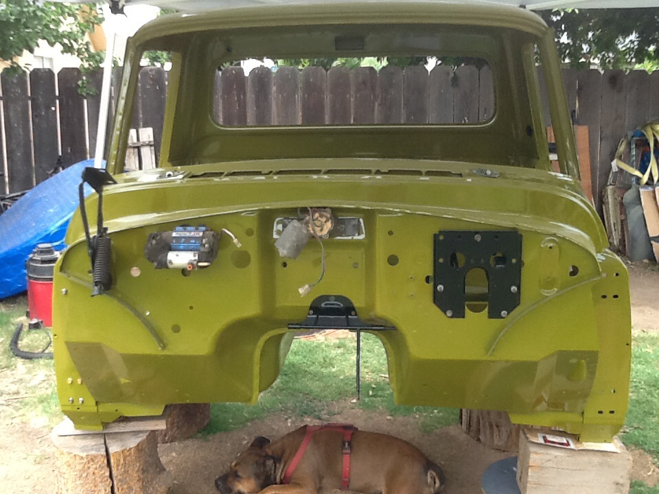

Sent the firewall pad back, it wasn't even close to being right. The label said 61-68 International pickup, and big truck. It isn't likely it would fit both anyways.

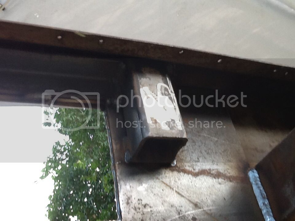

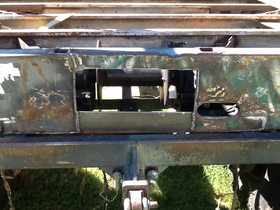

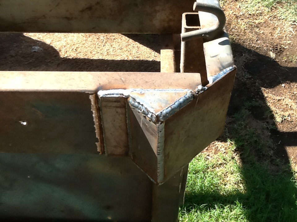

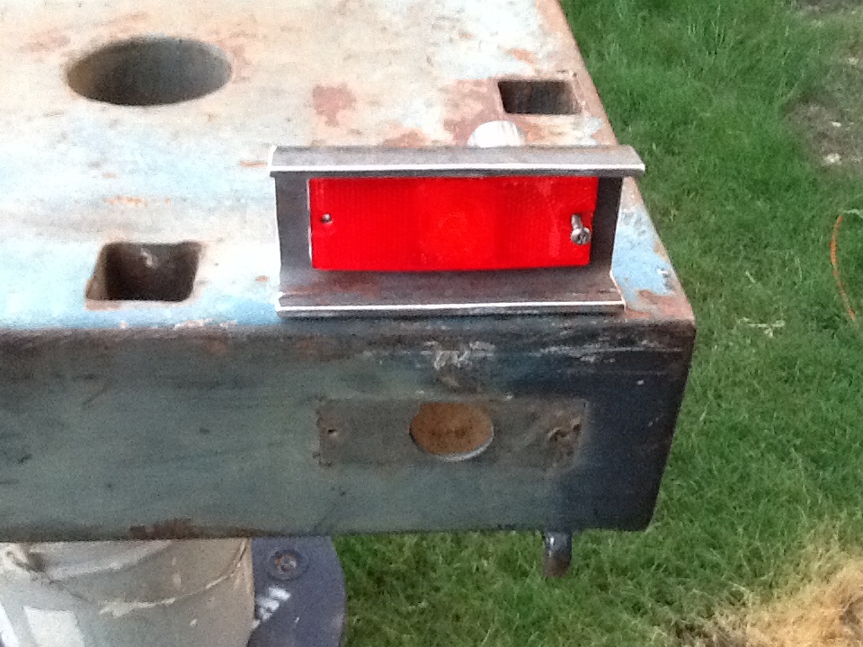

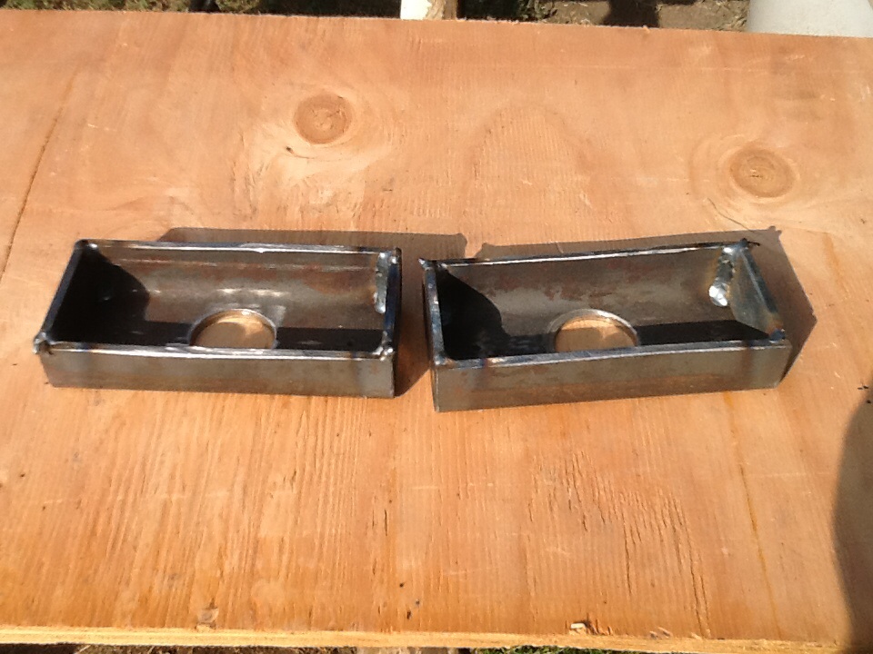

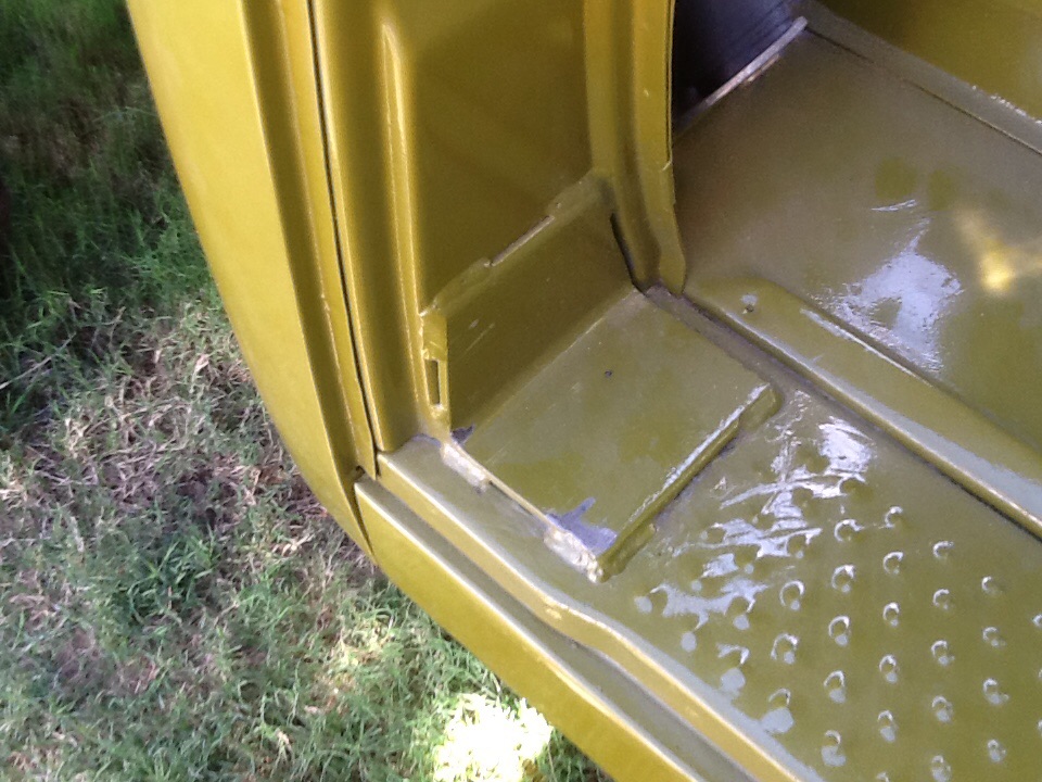

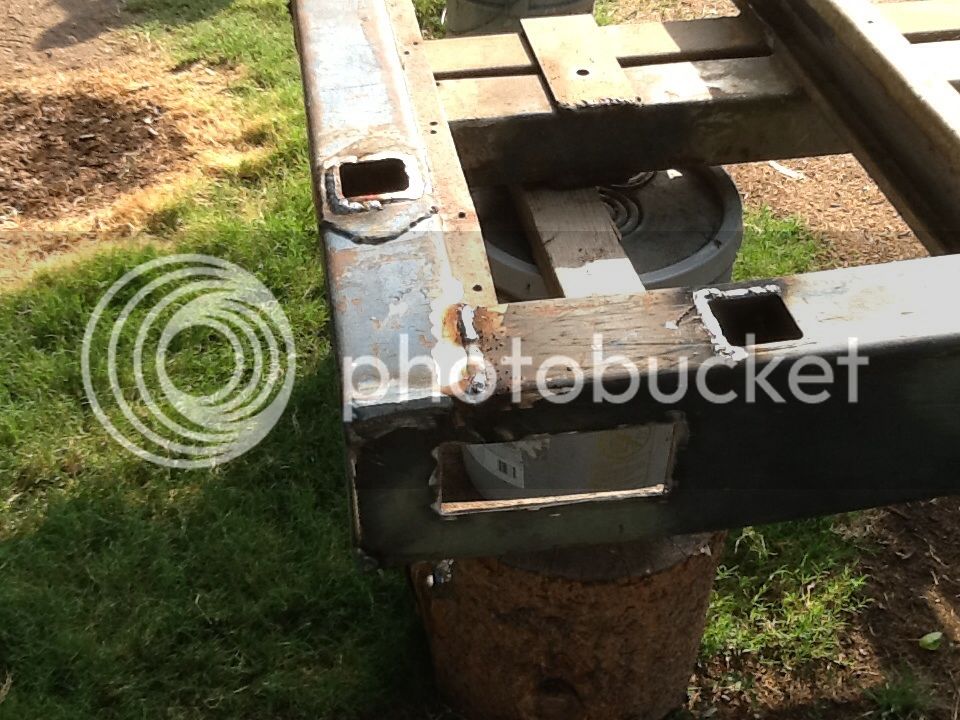

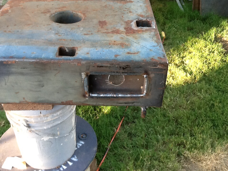

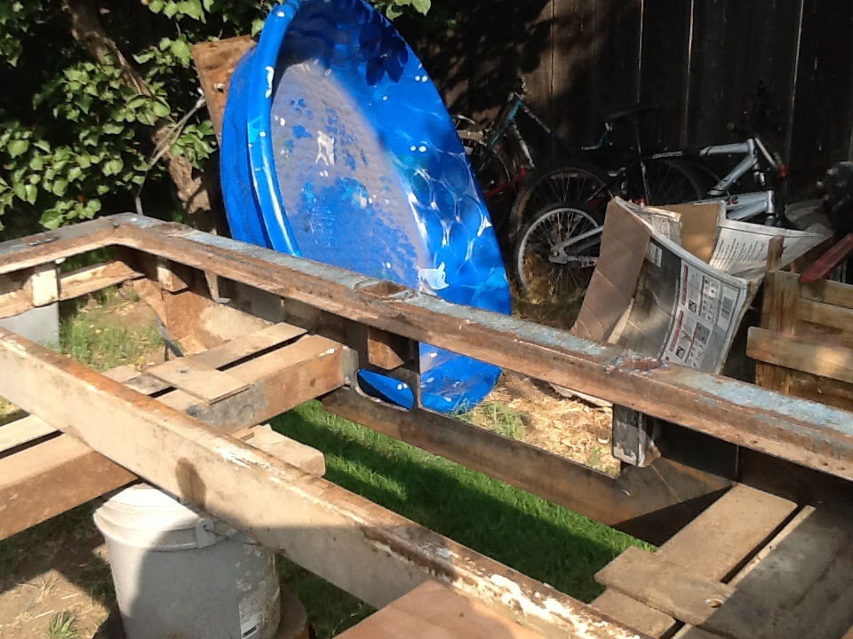

My welder friend was over yesterday, welded up the recessed light boxes.
Put the 1/4" plate in the back, and added in the missing back gate socket.
View from the inside.

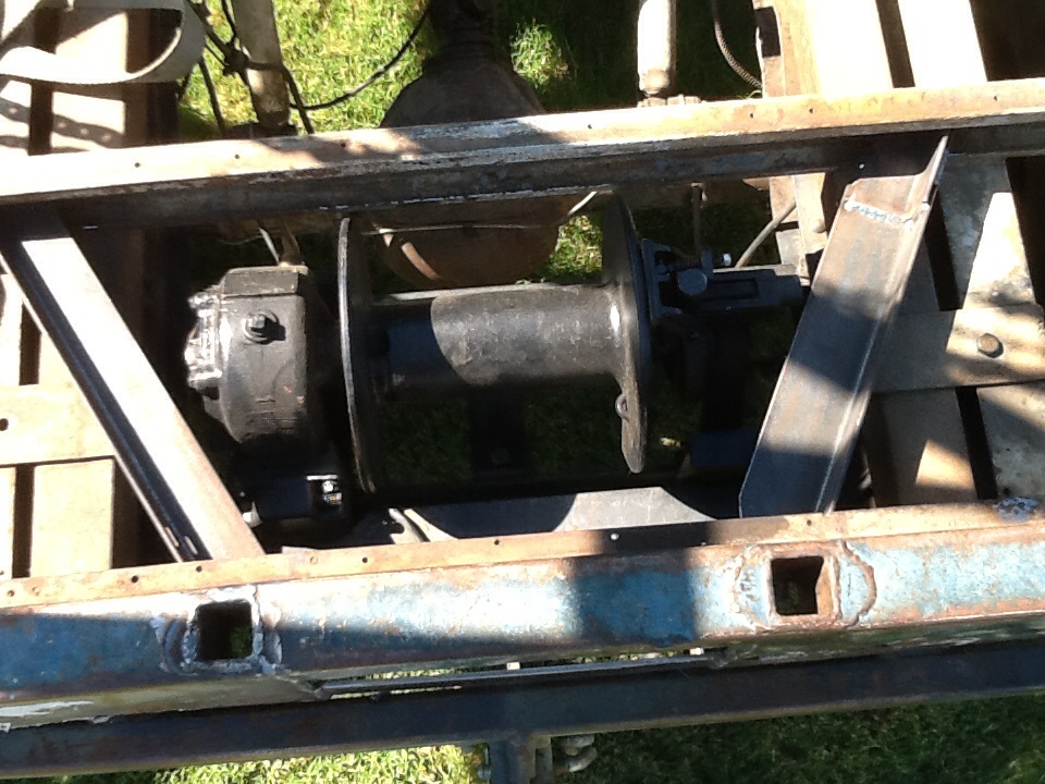

There were a bunch of cracks that got welded up.

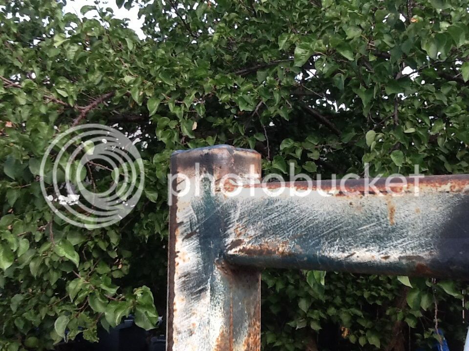

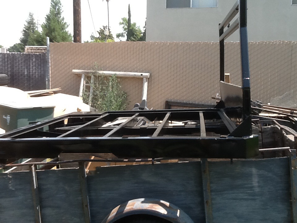

Shortened the headache rack pieces sticking up.

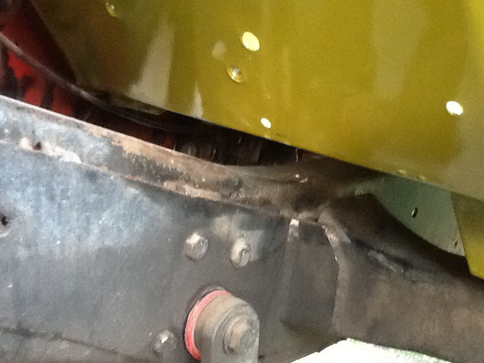

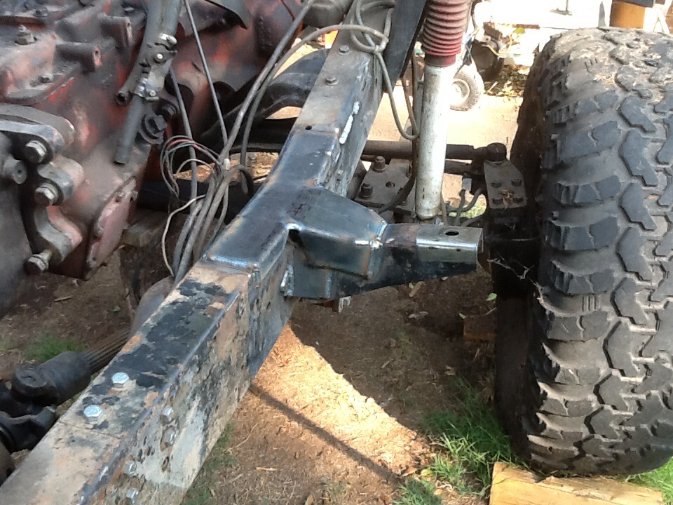

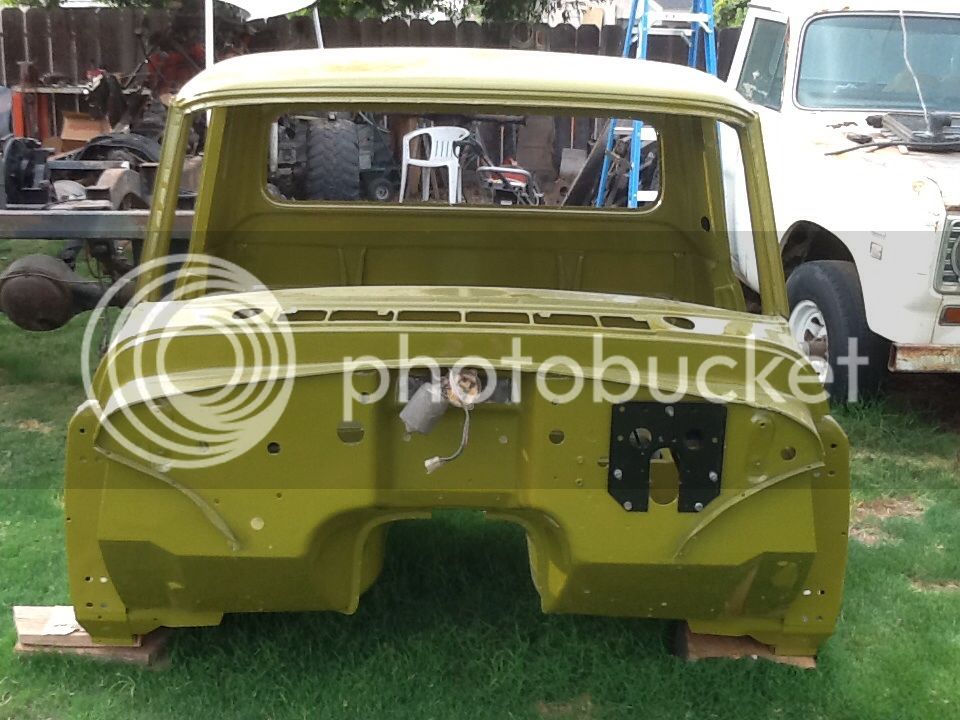

I put the cab back on and shimmed it up enough to get the clearance between frame and cab that I was told on an IH forum. It took 1.33" on the drivers side, and 1.565" on the passenger side. I'm not gonna weld in that much spacer. I already took the cab back off, will remove the mounts, put the cab back on with the correct spacer between frame and cab, bolt the frame mount to the cab, then weld the mount back to the frame with a piece of angle iron on each side. That oughta do it.

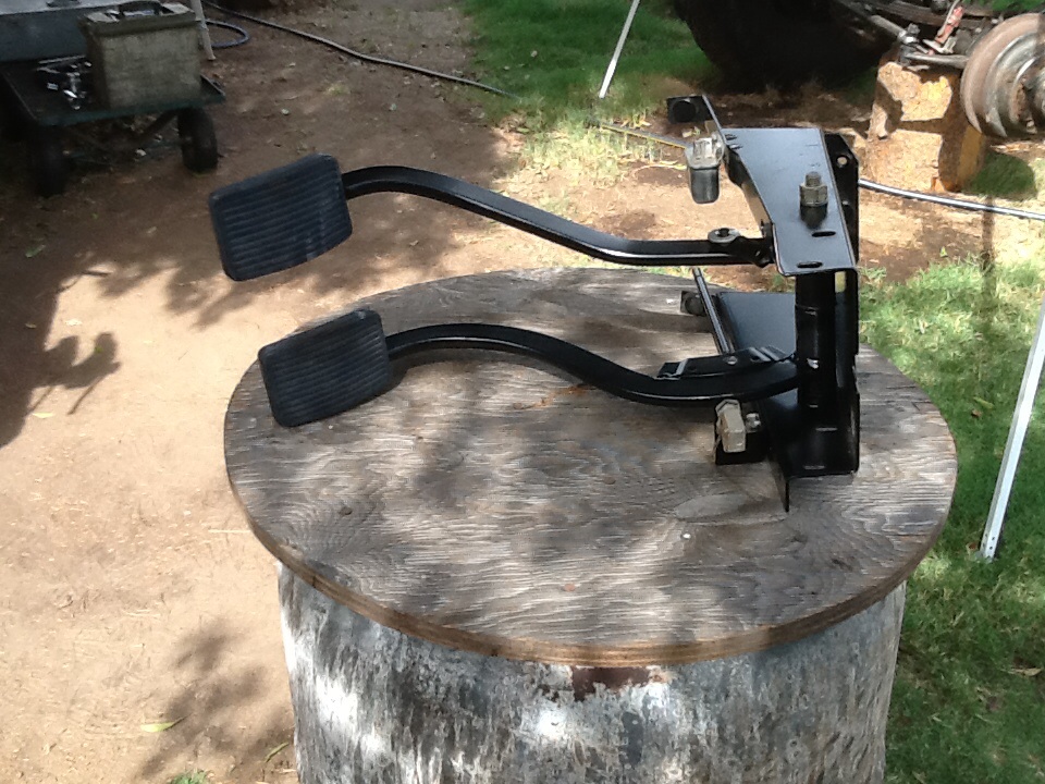

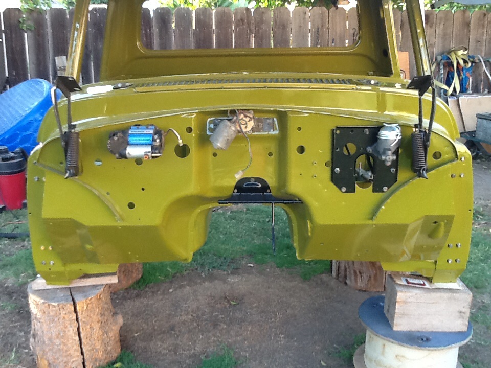

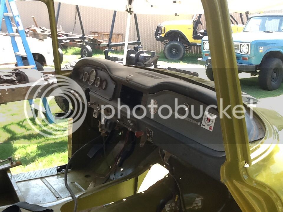

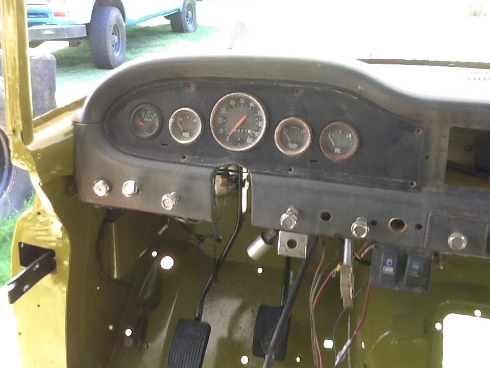

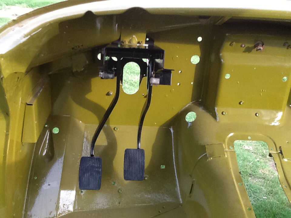

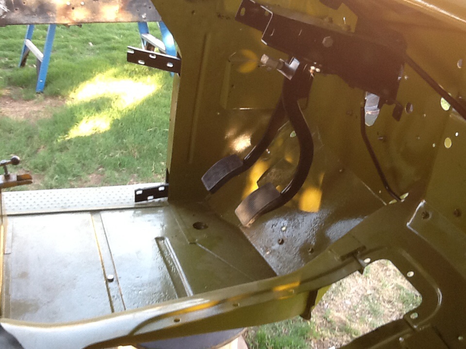

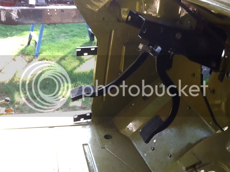

Got the pedal assembly back together, this is the new one that will allow separate brake and clutch master cylinders.

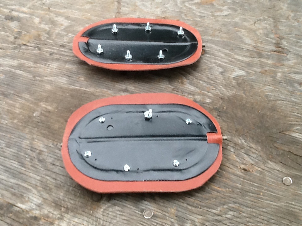

Also put on the windshield wiper motor.

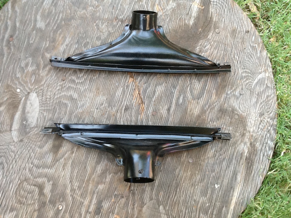

Got the defroster vents on, I grouped all the little tiny fasteners so I could find stuff easier.
The rod on the new clutch master cylinder was too long.
Someone on Binder Planet gave me the correct length, and I shortened it. Looks good now.

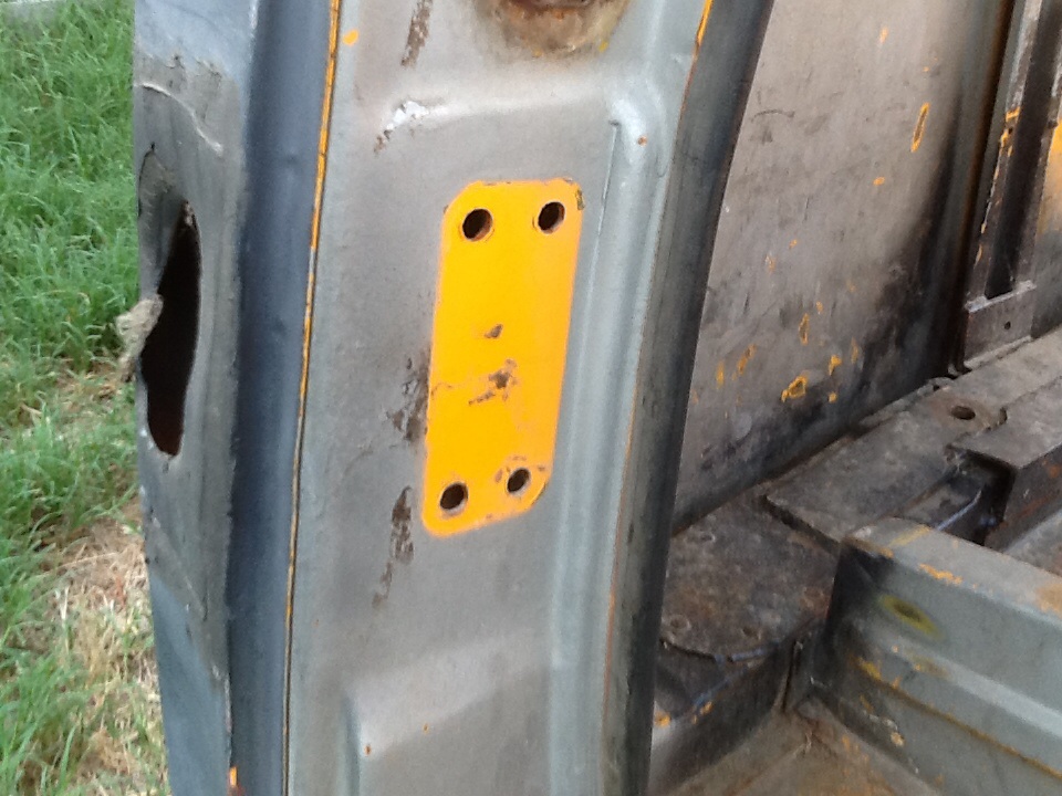

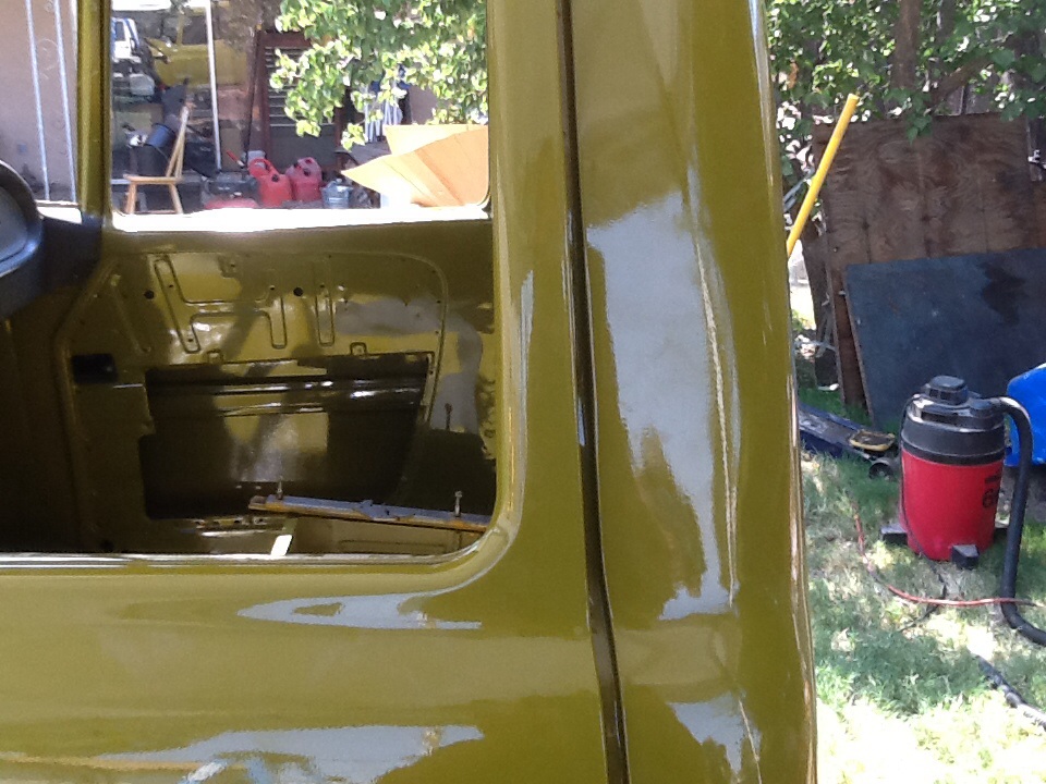

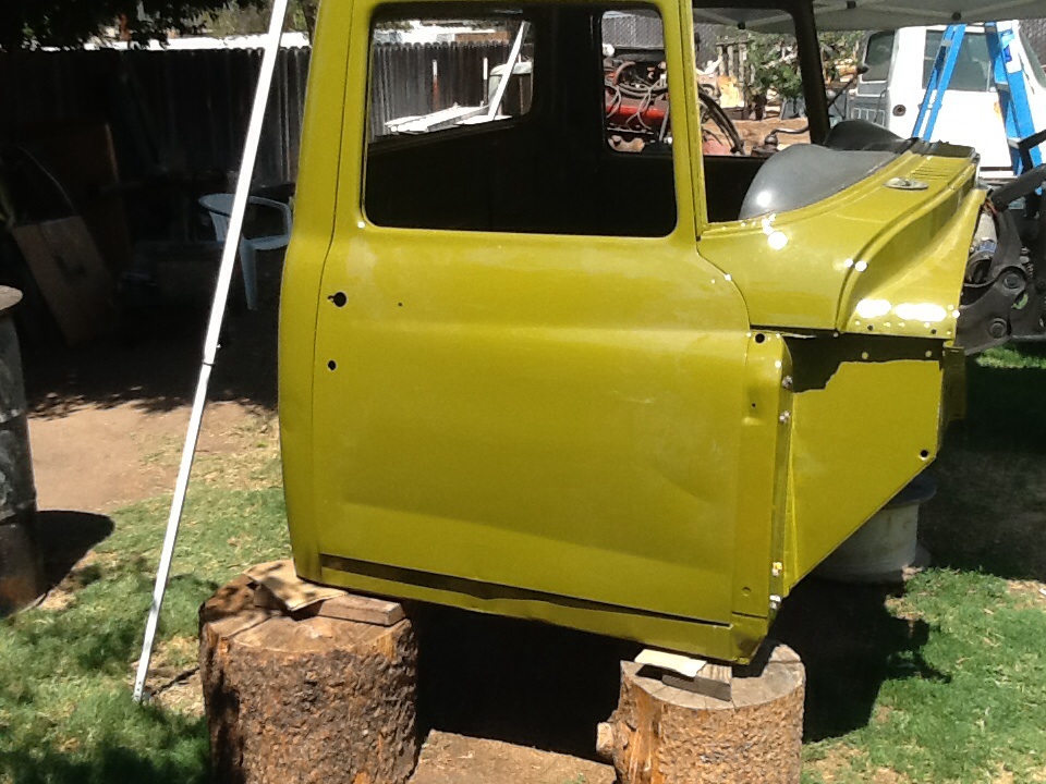

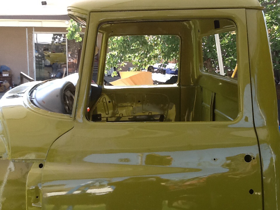

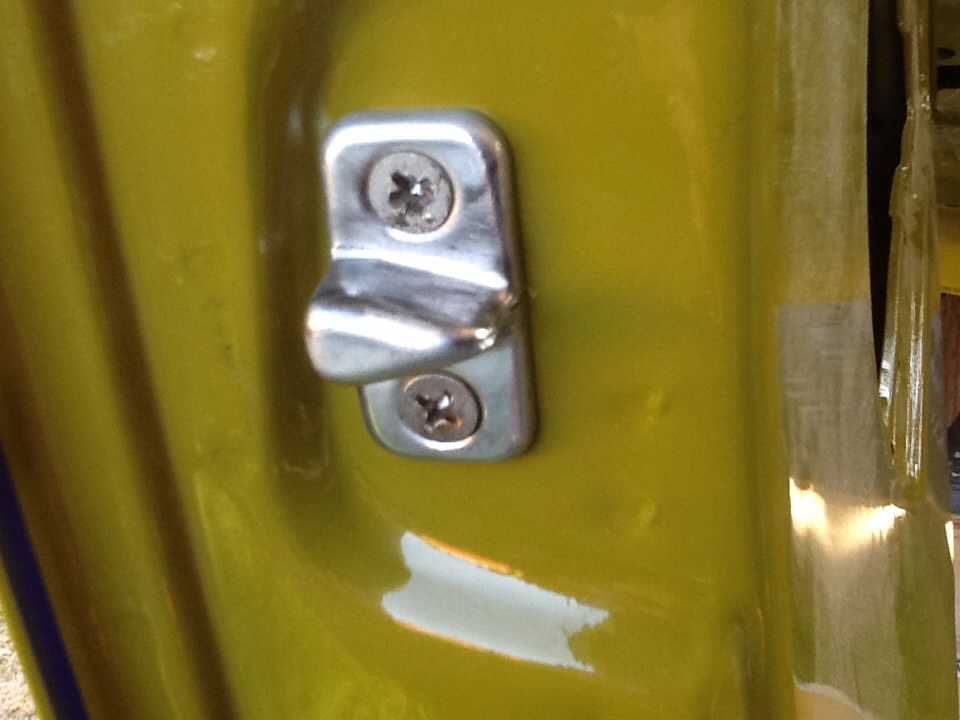

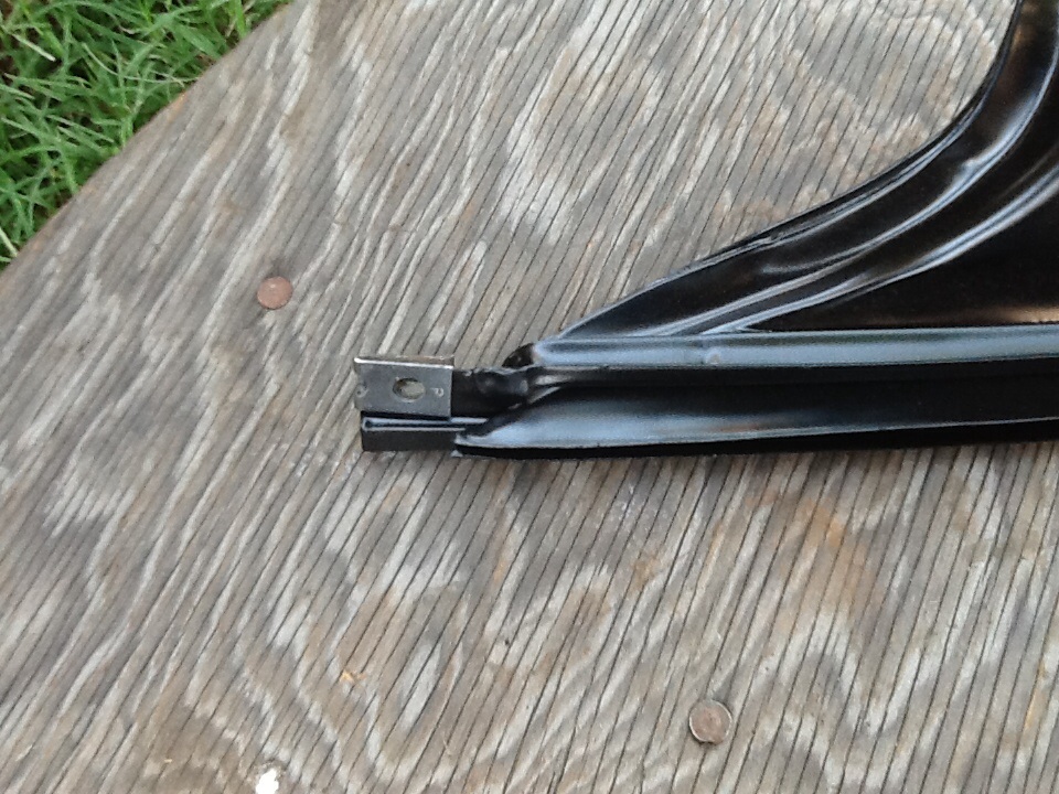

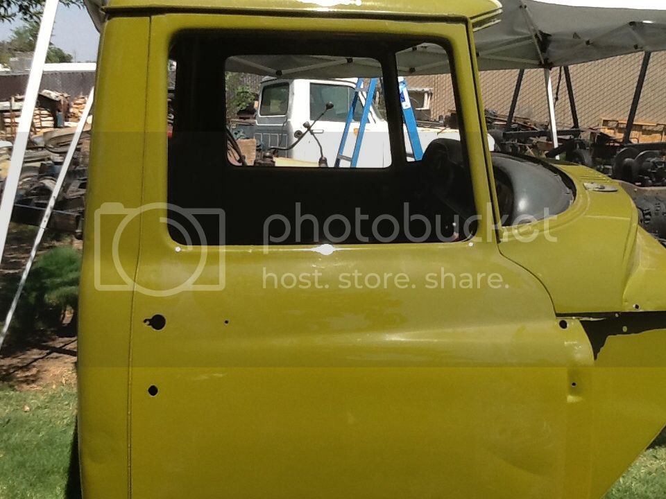

The doors have holes for this.
The old cab had holes for the mating part.
The new cab doesn't, I think it's important enough to drill them.

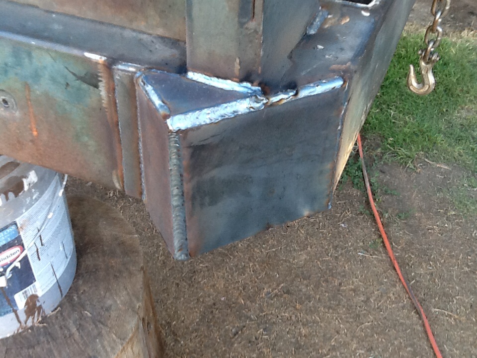

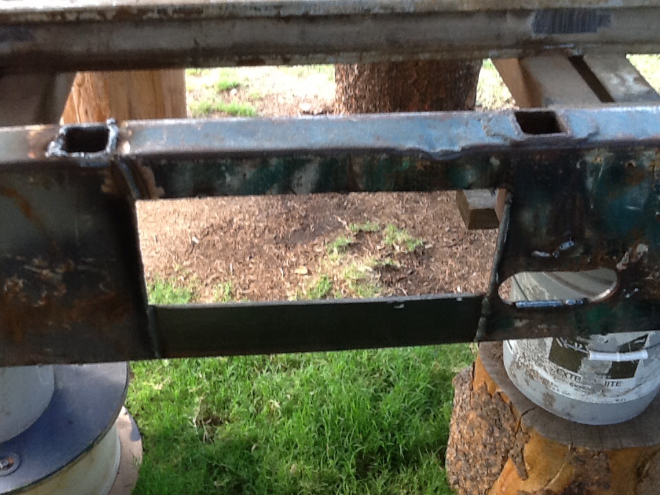

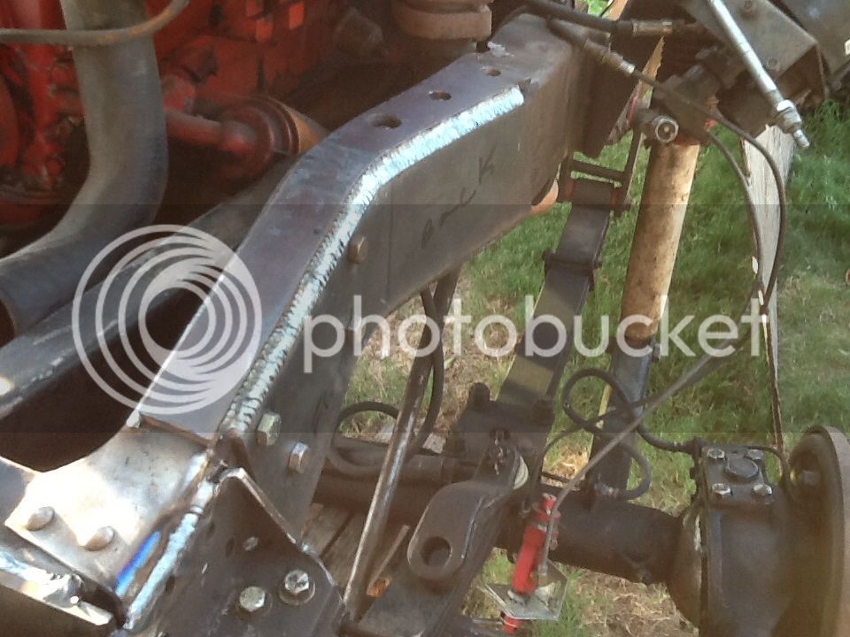

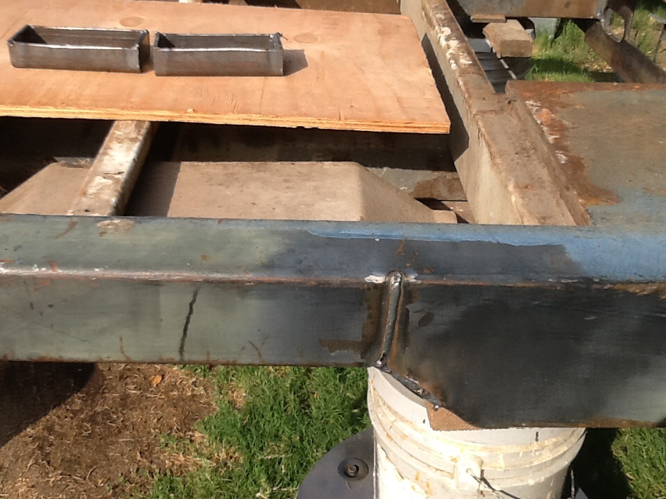

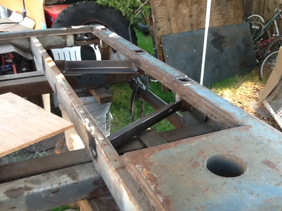

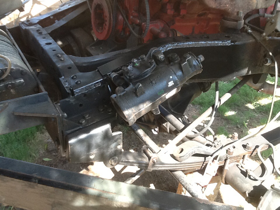

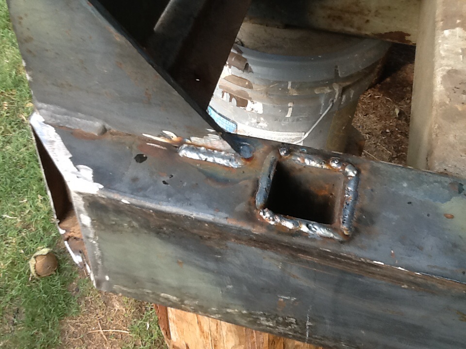

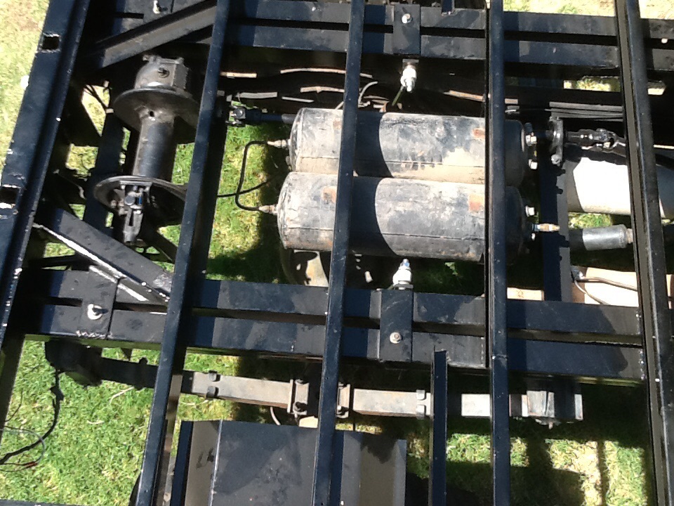

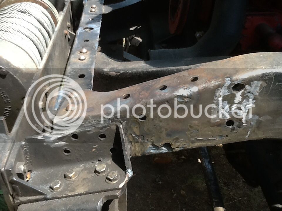

Welded up the cracks in the frame, also plug welded to the inside plate.

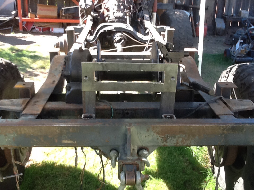

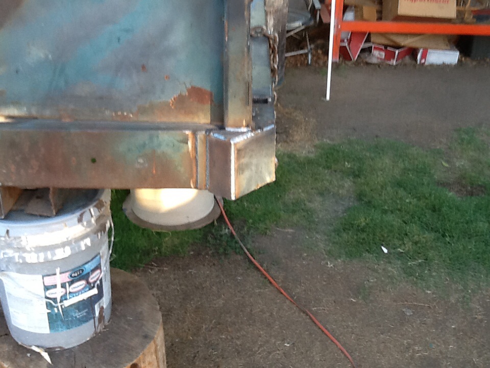

Welded the plates on.

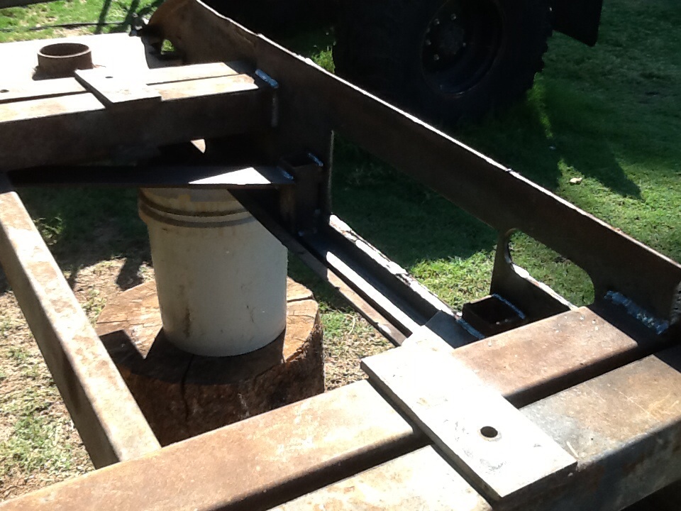

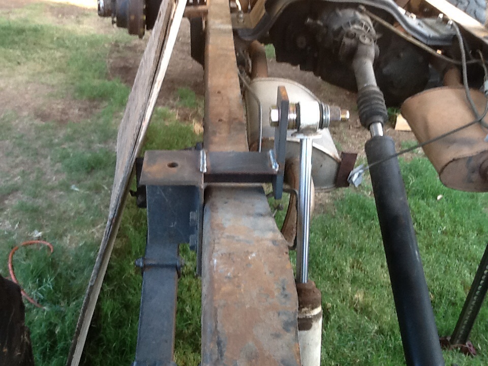

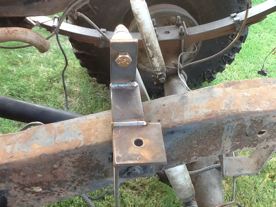

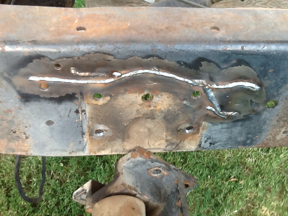

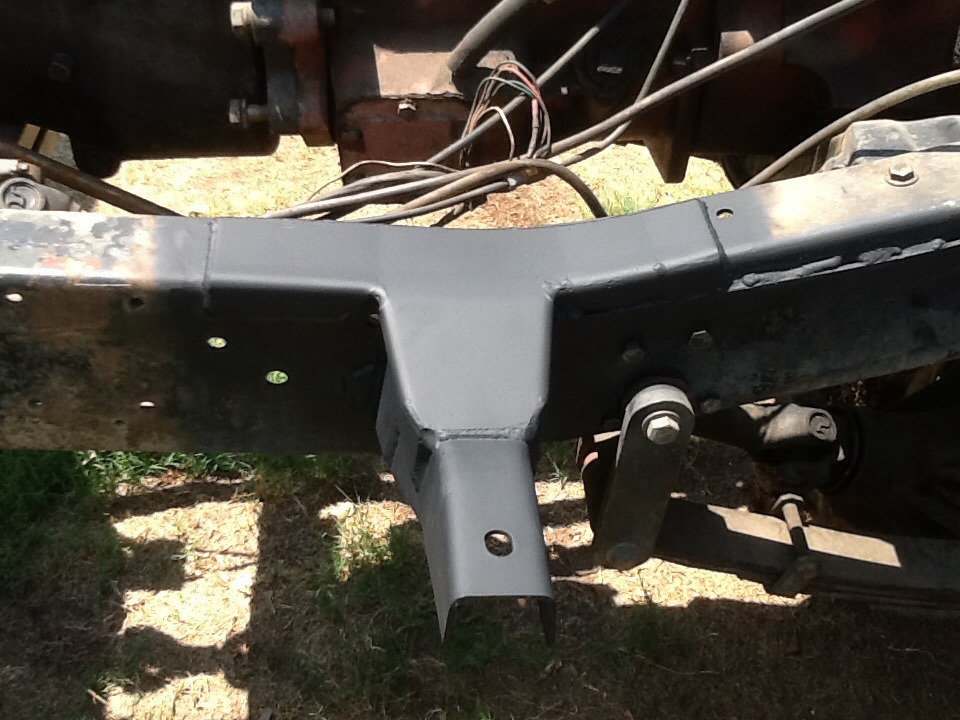

Welded the cracks where the rear spring hangers go.
Rear shock mounts.

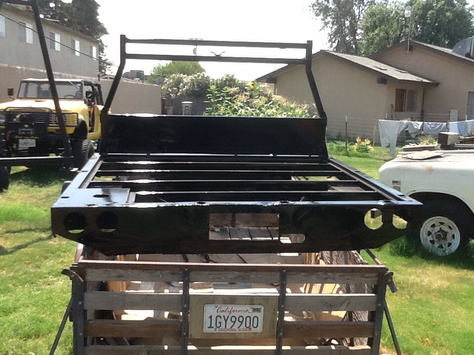

The bed got painted.

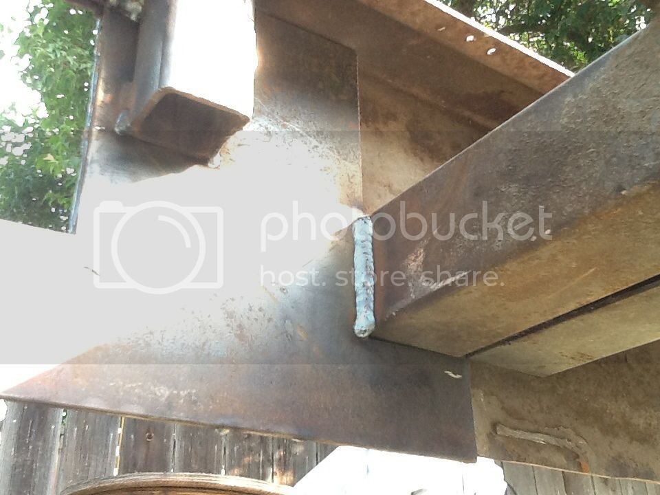

I put a 1" spacer between the seam and the frame, with the front cab mounts removed from the frame. Bolted them to the cab with rubber in place, then welded pieces to reattach the mounts. After that I removed the cab and looked at the mounts, the area the rubber goes onto was more level, and the mount was matching up to go on top of the frame like it should. They weren't matching up at all before. Then we made this piece to tie in to the top.
Also put the box on to determine what hardware was needed. It needs to be longer now with the added plates, couldn't find the old hardware. I already went and got what I need, except for a 1/2" stud 4" long (couldn't find one).

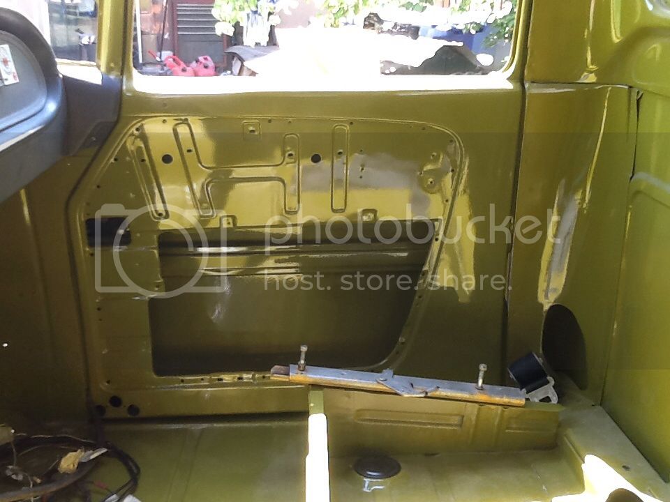

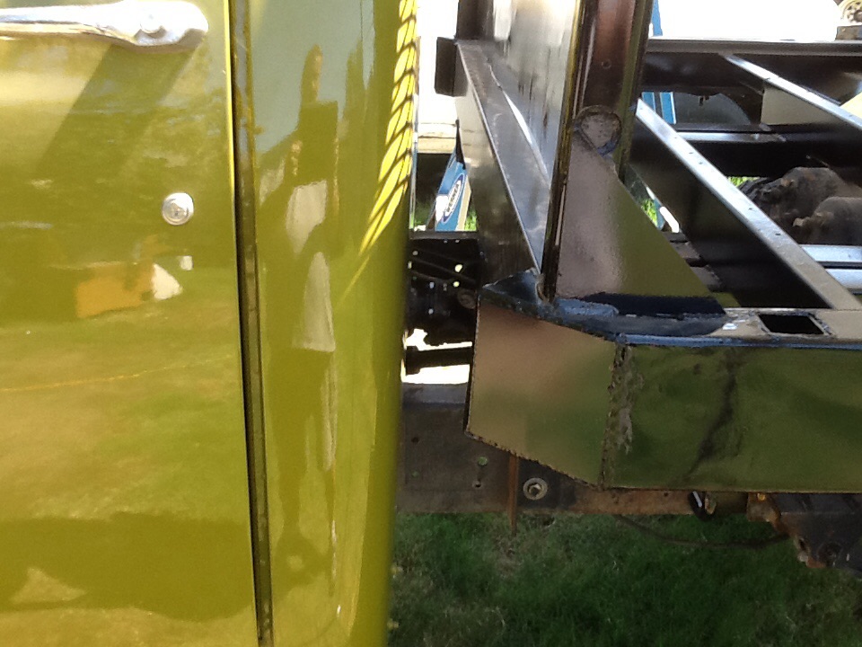

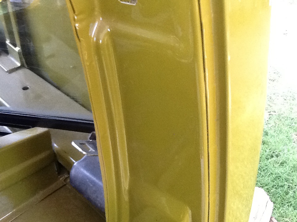

There's no room for this reinforcement angle, either it needs to go or the door needs to be clearanced. Since this corner came apart before, I'm leaning on clearancing the door.
