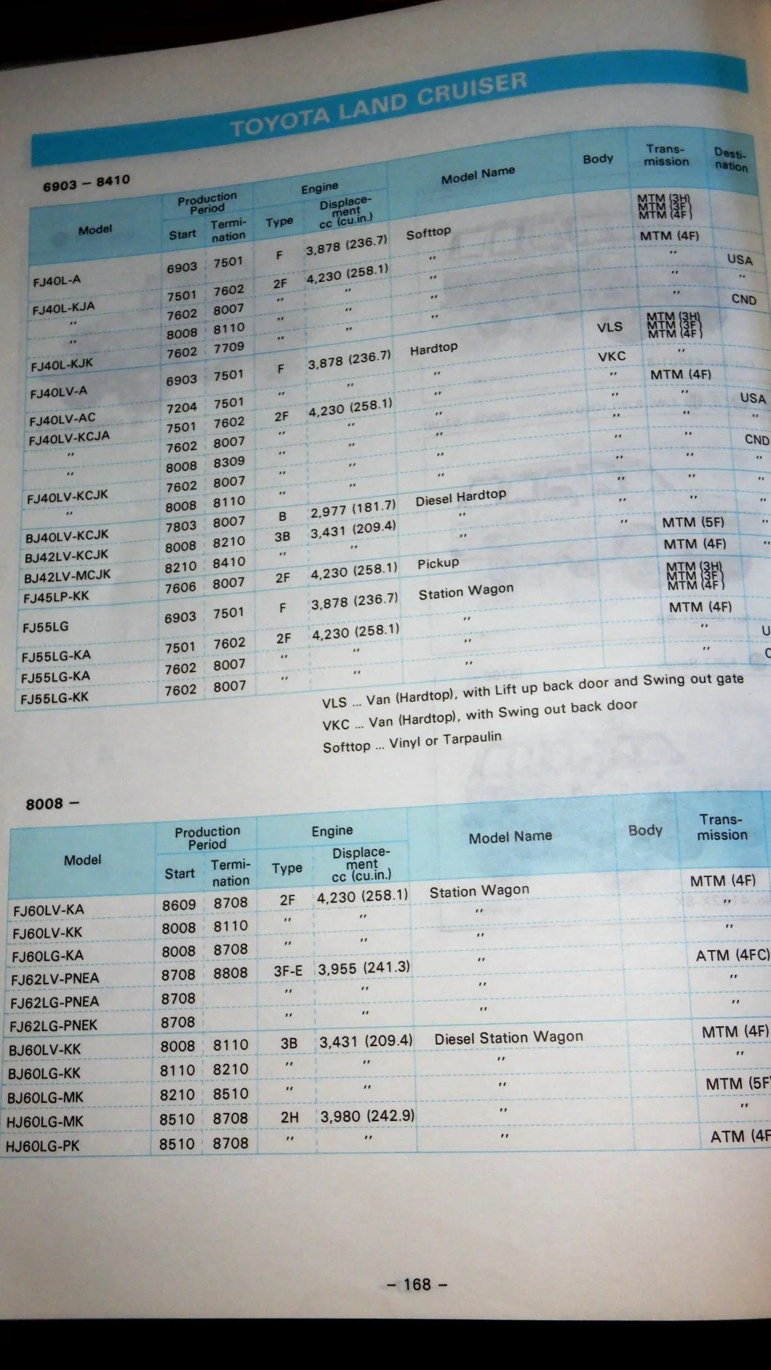

Look at My Model identification guide page below under Soft top
to see if u have a match FJ40L-A

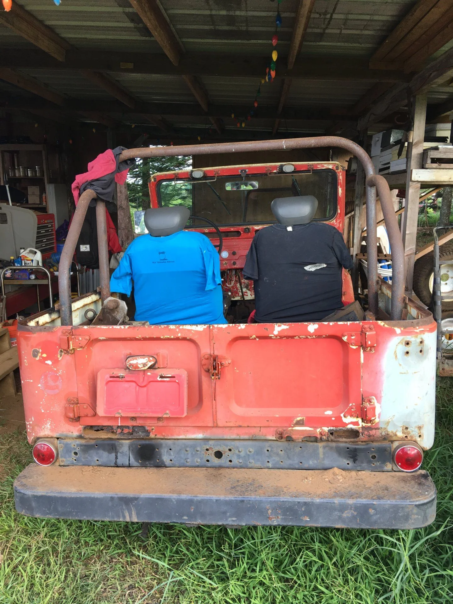

This is also an FJ40L - the back however is not a tailgate, but the 2 small half doors. This whole thing would probably easier if I had photos.

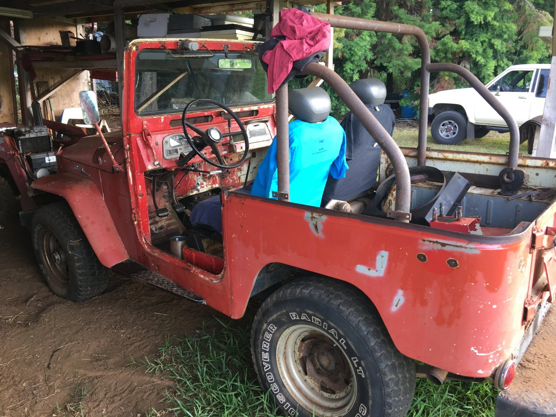

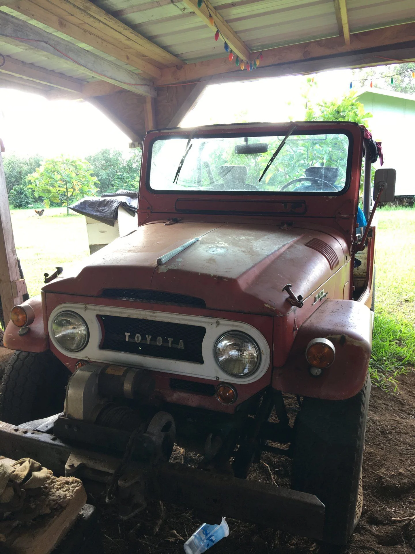

Here are some from early on in the restoration process. I will get full pictures this weekend and post. Super stoked on all the responses, Legends.
The FJ came with hard sides, fiberglass top, windshield cap, hard top door frames etc. All the same red, all seemed original. SO I just assumed it was set for a hard top. Keep in mind that I bought it like what shows in the pictures, so the previous owners did not have the hard top on,
Probably not an FST, then. Correct hardtop for a '64 would be corrugated (ribbed) sides without rear corner windows.
Yes, yes it would. ;)
Hard sides for this are not corrugated, and the sides it came with have the corner curved windows. Starting to sound like this FJ is not to specs.
Not surprising. It is, after all, 55 years old now. Lots of stuff gets changed over the years. Very few '64s are still (or again) as original these days.
Lots of people even added corner windows to corrugated sides.
