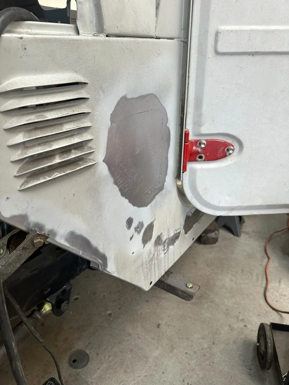

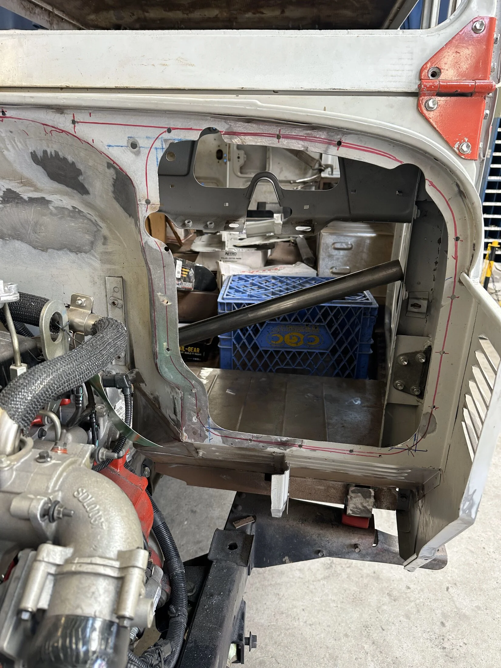

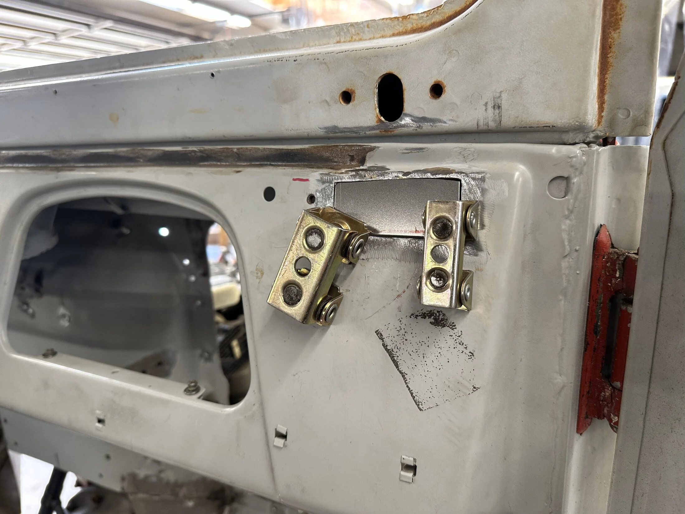

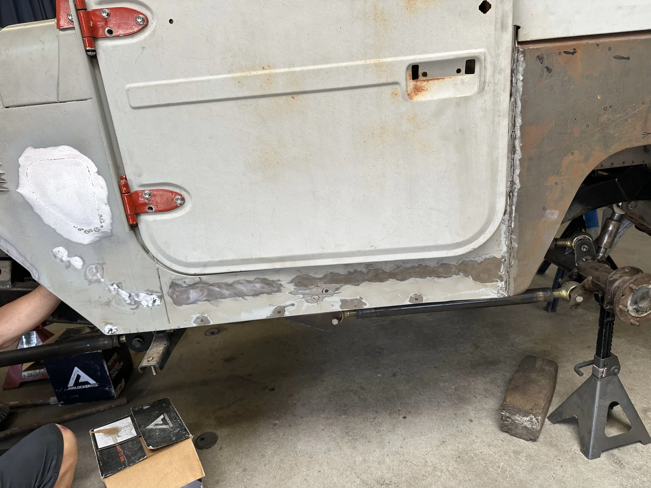

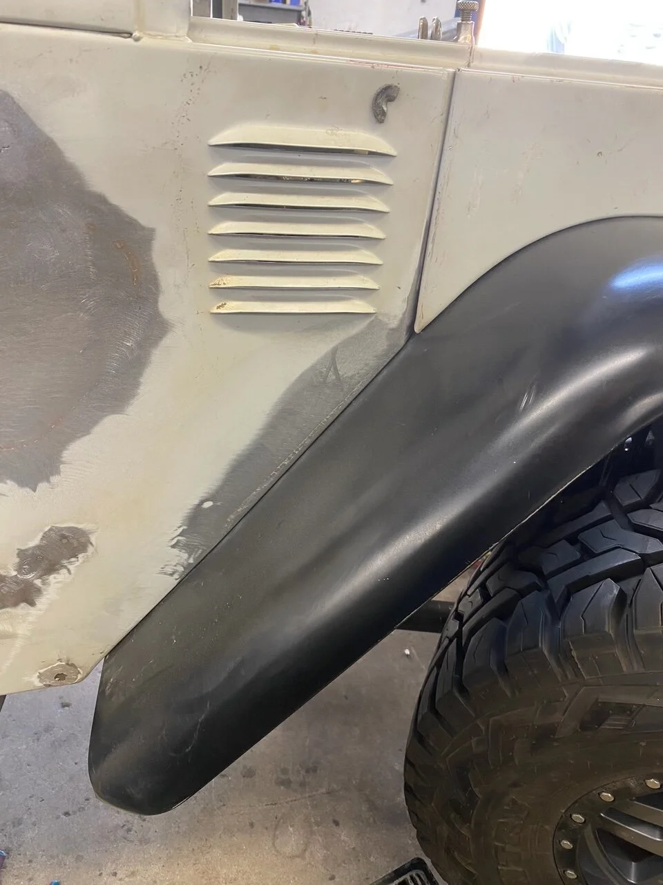

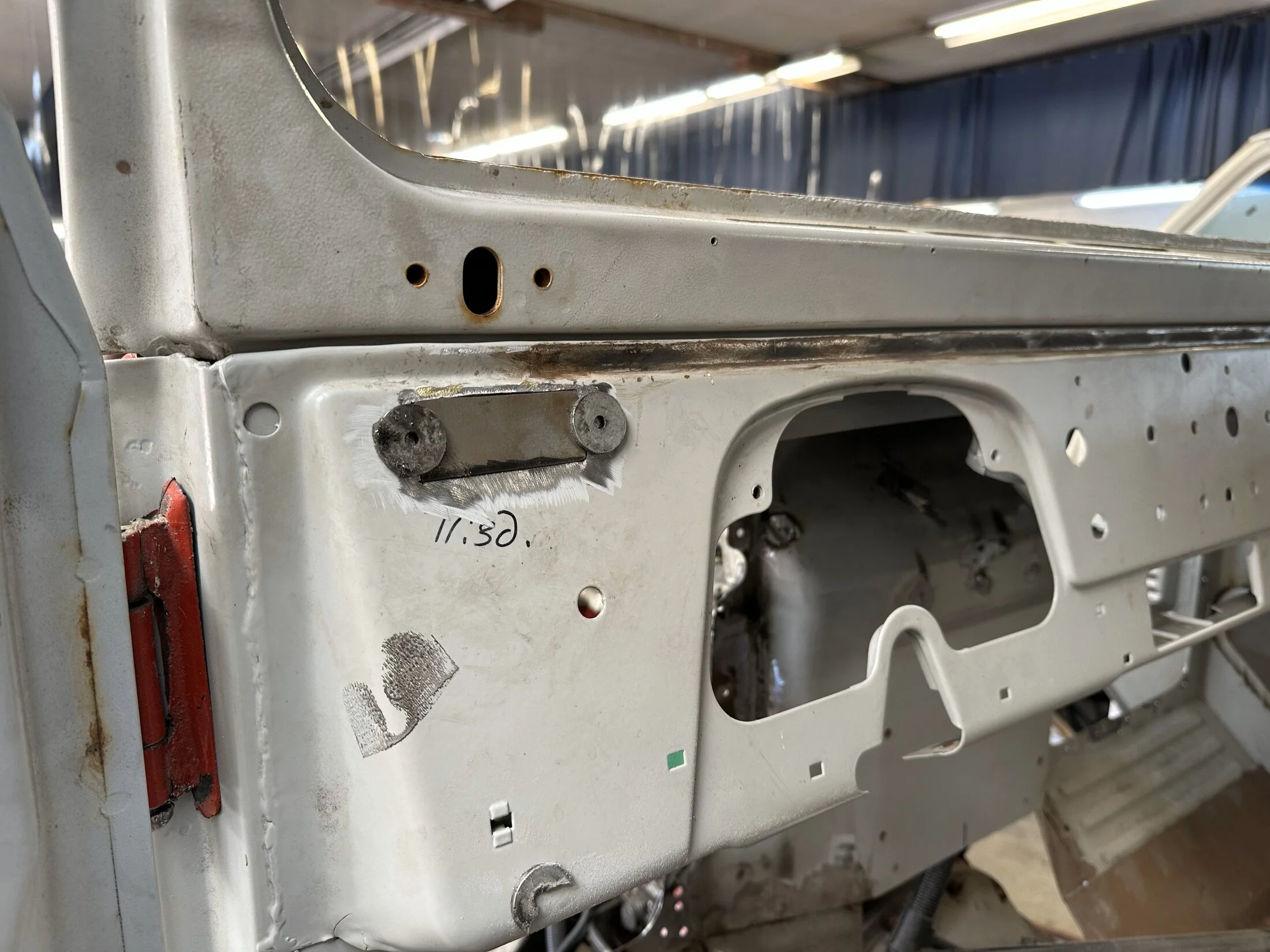

I’m in same boat as you except only driver fender is off on mine. Let me know what you/they plan to do. Appears if body lowers the slots will be closer to the holes on yours… lots of tolerance slop to get there but some voodoo also.
He is going to adjust the hinges and make it lineup

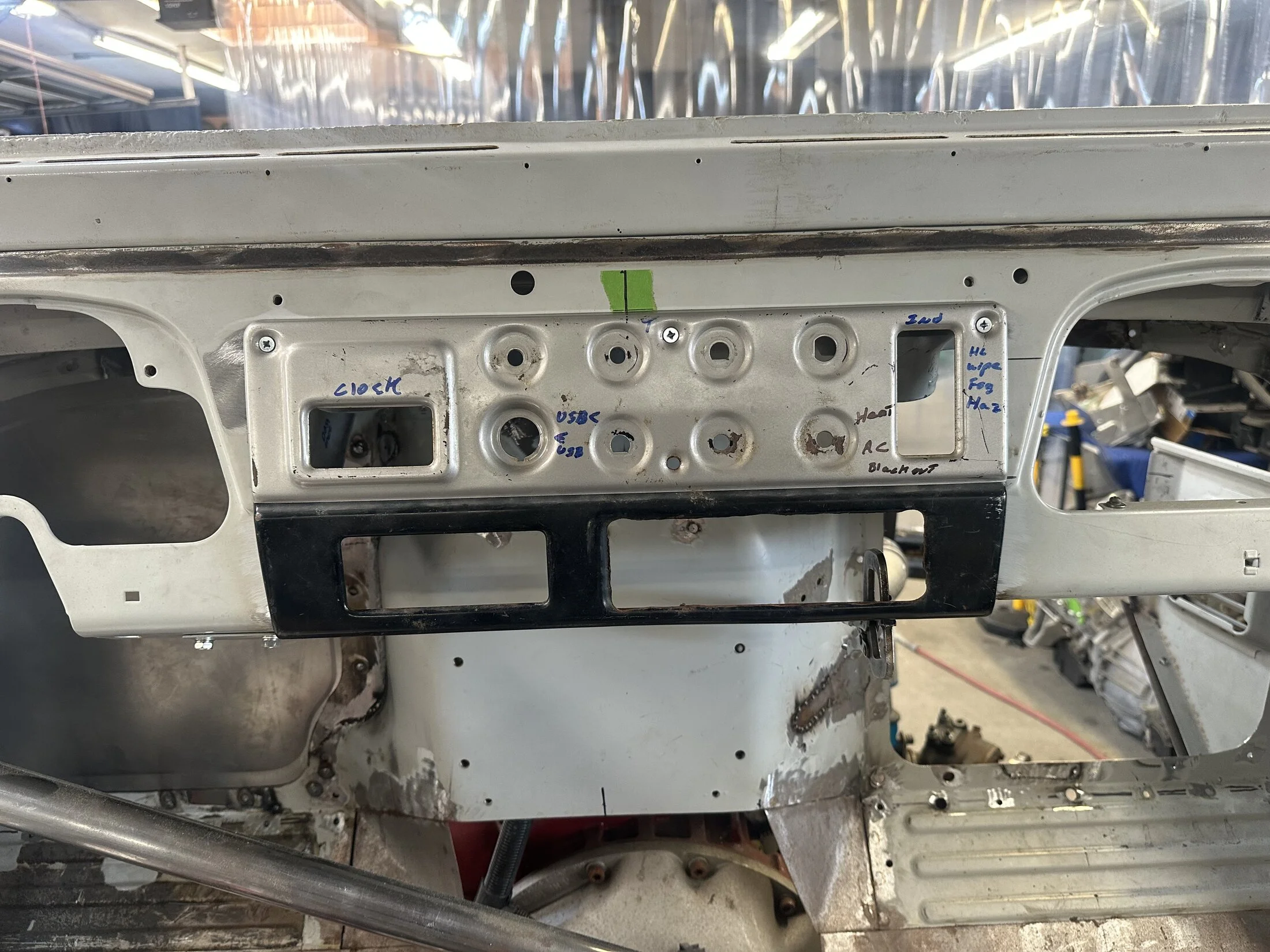

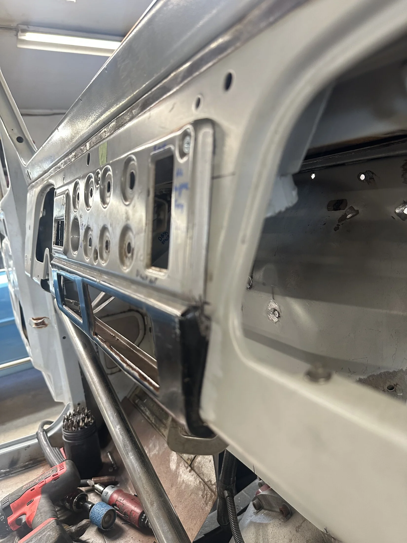

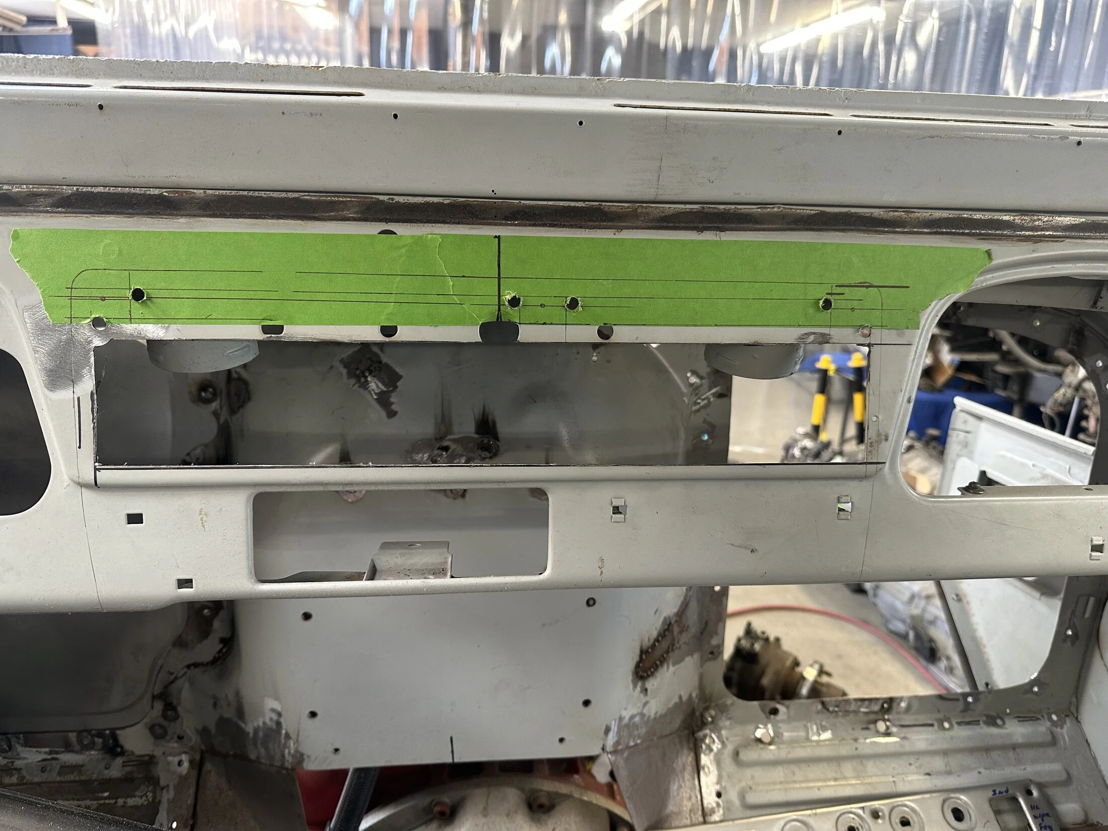

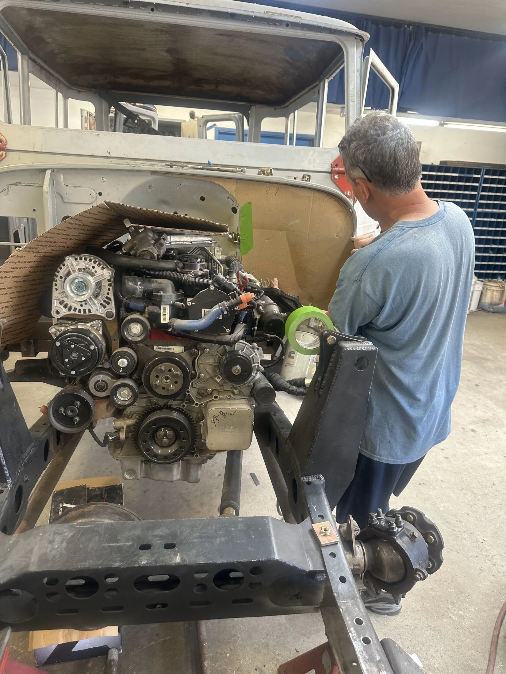

Body Mock Up
More Pics...

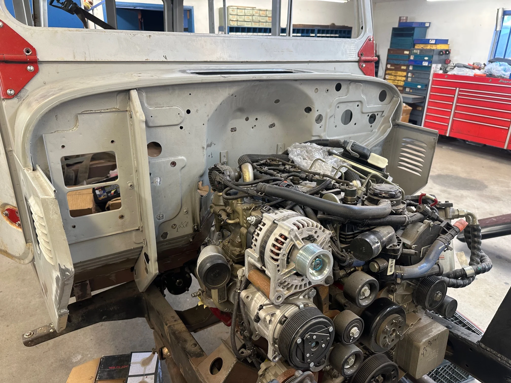

No AC here. I love my kick and cowl vents.

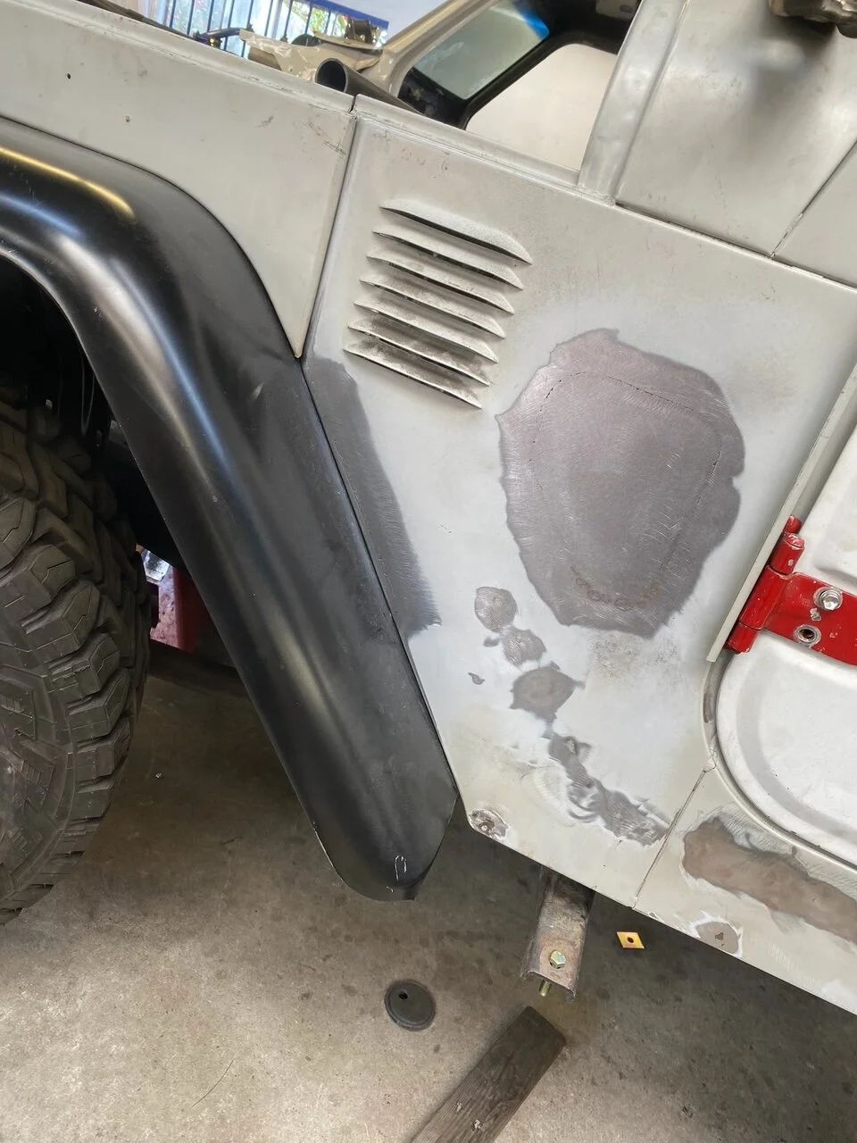

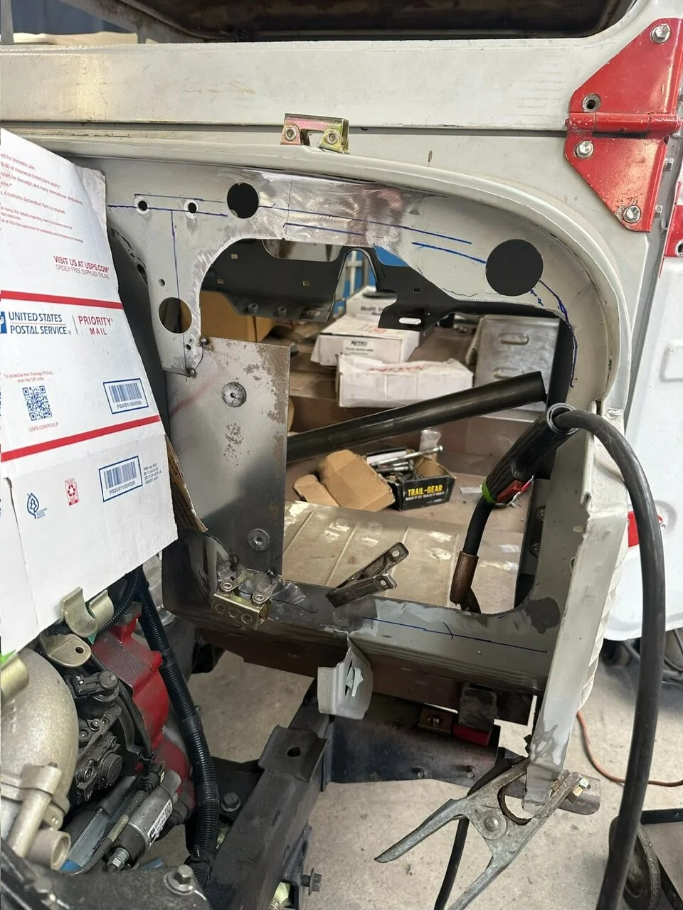

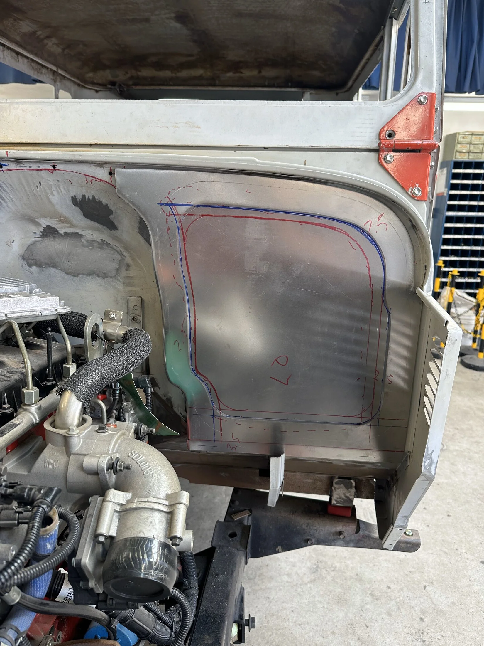

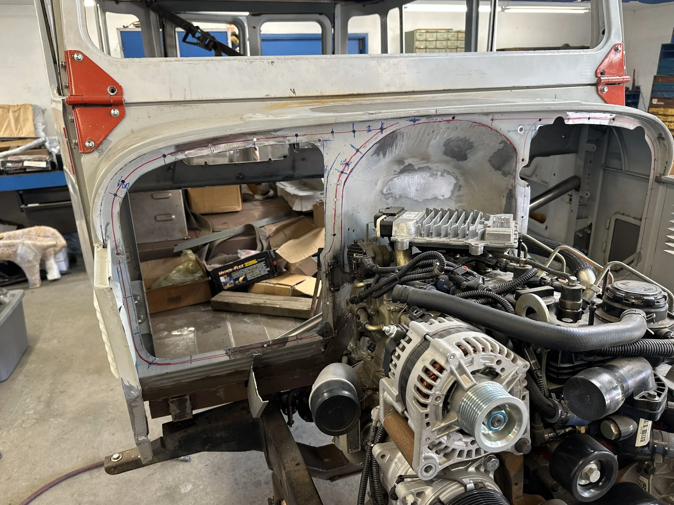

I debated about a lot of things on this rig, but as you will see in the coming weeks I have decided to clean up a lot of the panels and original body lines, and make more of a unibody construction. Much to the dismay of many purists on here. :oops:

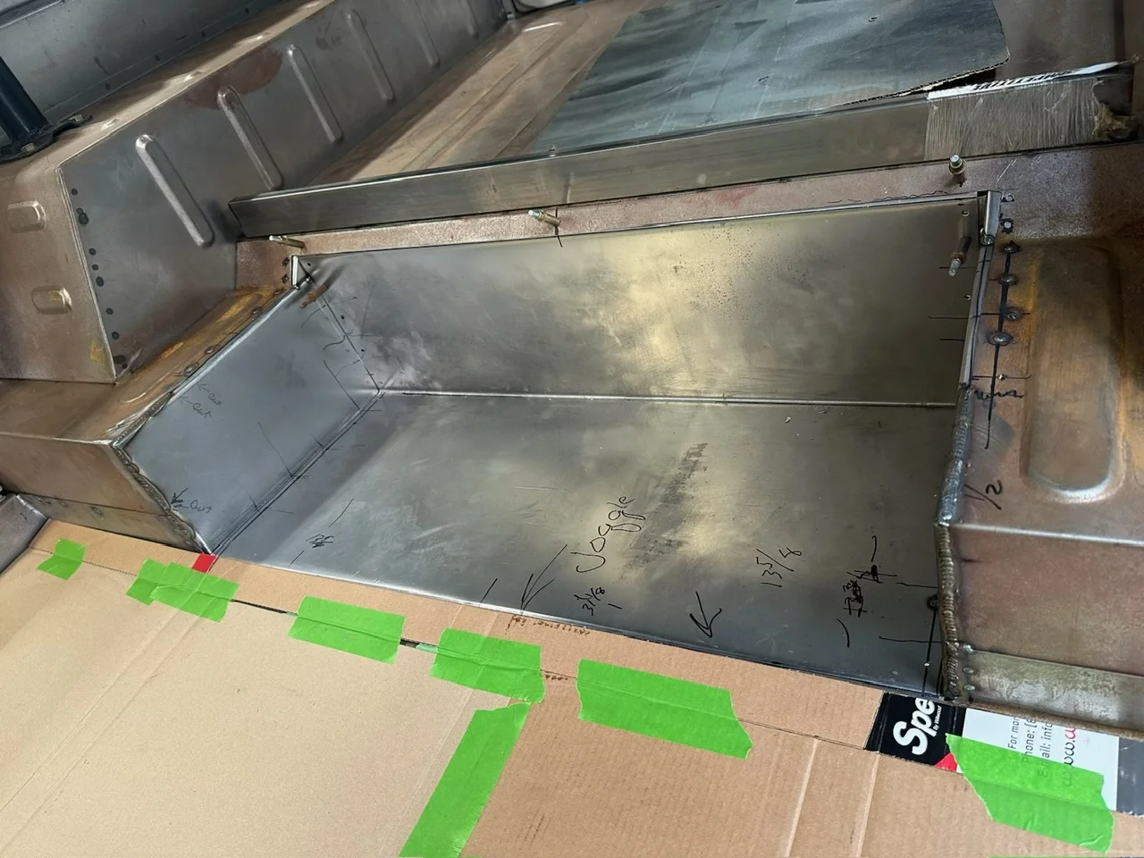

Fuel Cell
Finally getting to the point where I can fab the fuel cell. Looks like I can get around 48 gallons (@ 7.1lbs/gal ~ 340lbs) in the current model. The Cummins R2.8 advertises 25.8 mpg (~1240 miles/tank) but without the catalytic converter I think I can get closer to 30 mpg (~1440 miles/tank). Of course at the current average of $5/gal in the great state of California I will be breaking the bank to fill it up. (~$240)

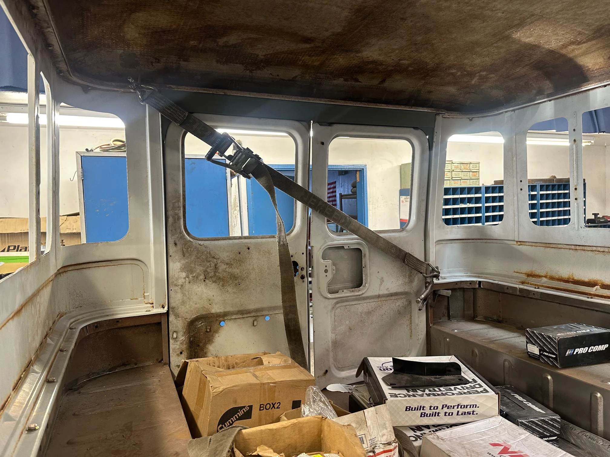

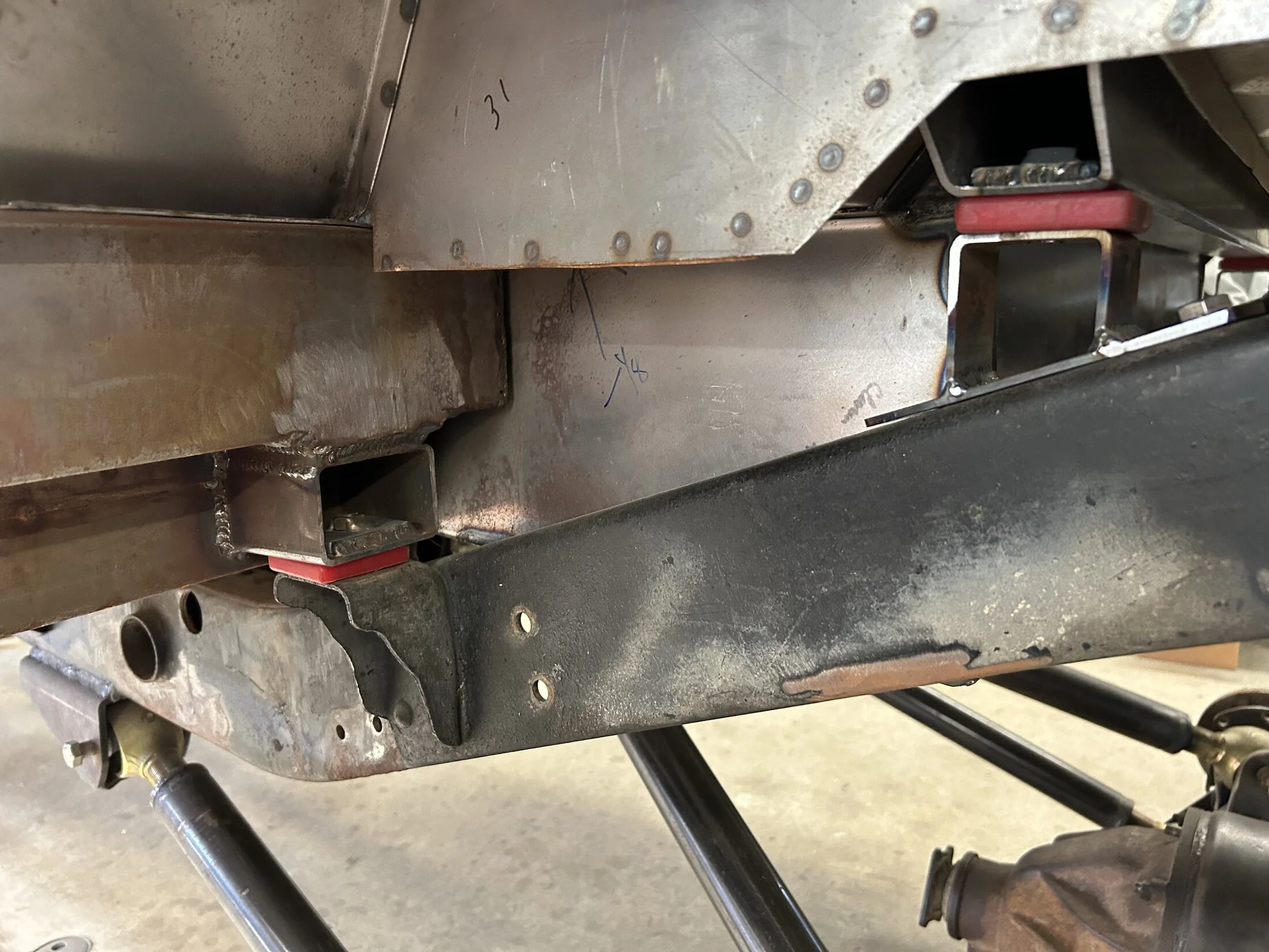

Brian, that floor relief is really thinking outside the box! It’s going to have an AMAZINGLY low COG. How is the tub crossbed supported with the main box removed?
I’ve never been a fan of that main box, with its hidden seat and seatbelt mounts, and its interference with shaping the rear wheelwells. But I’ve always considered it non-negotiable.
I am more intrigued with your build than ever!

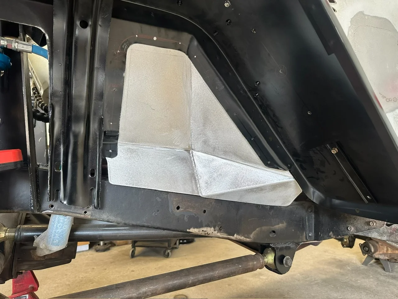

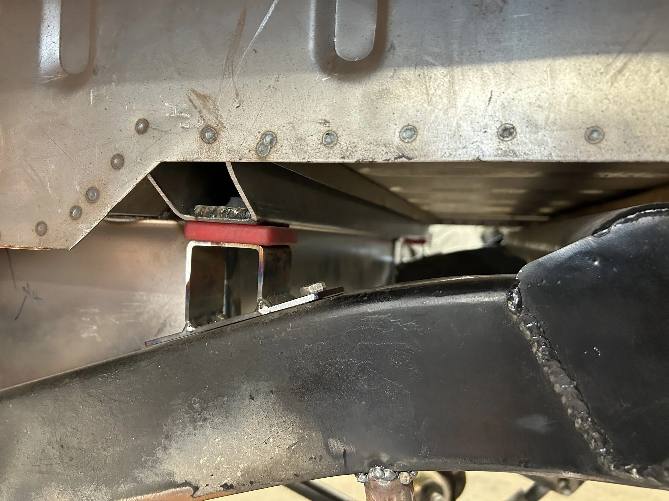

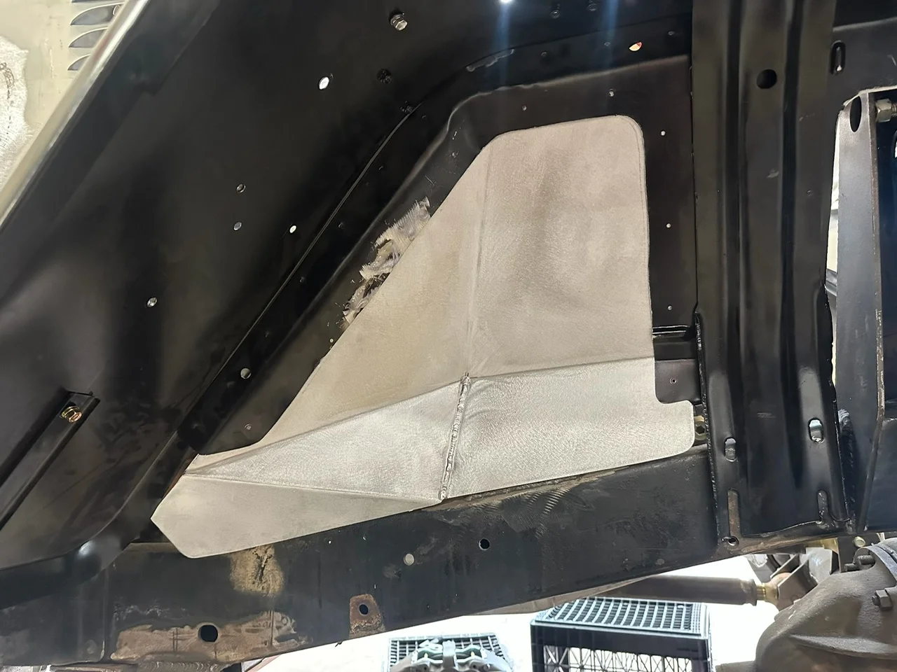

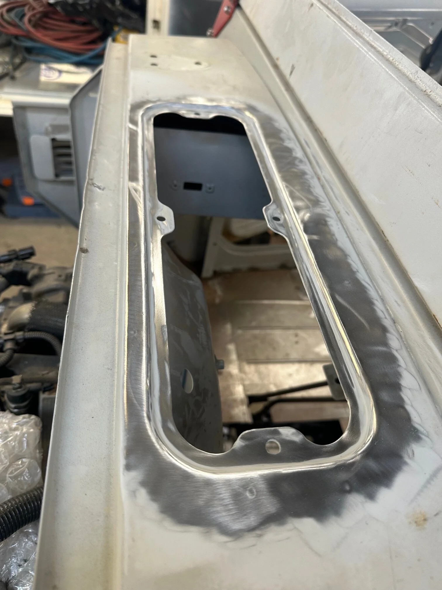

Mark,
Is is a pic of the underside behind the tank well. There will be another cross member further back as well.
