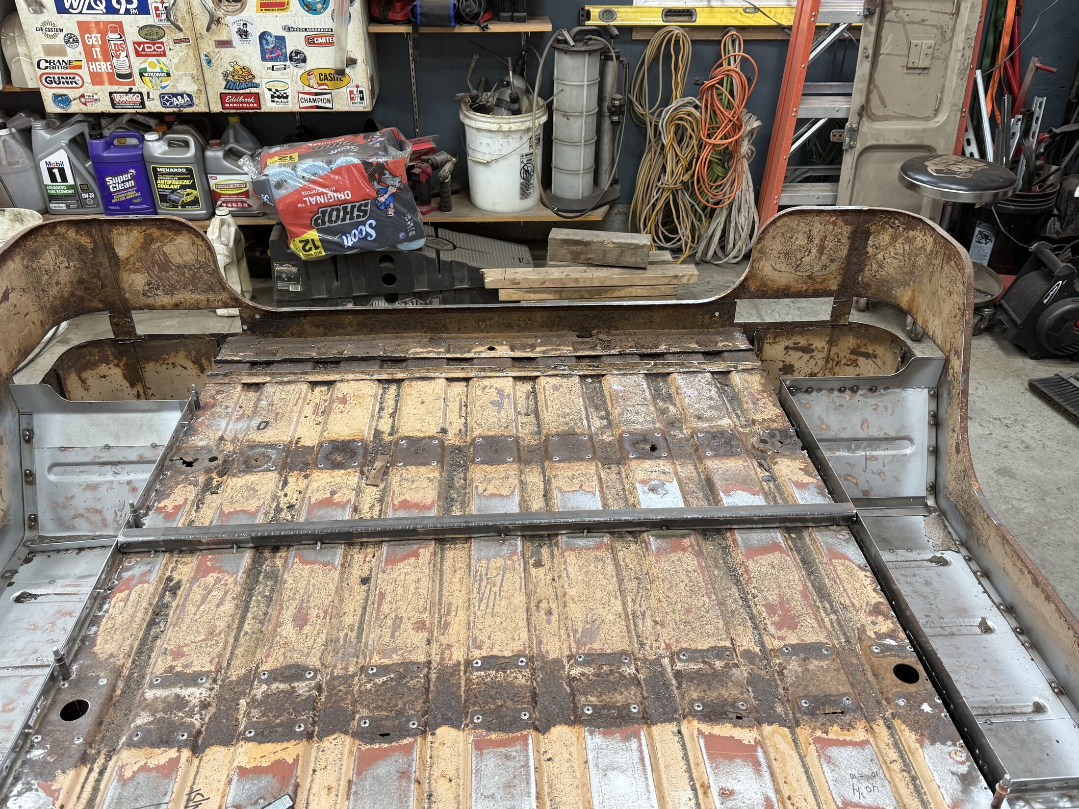

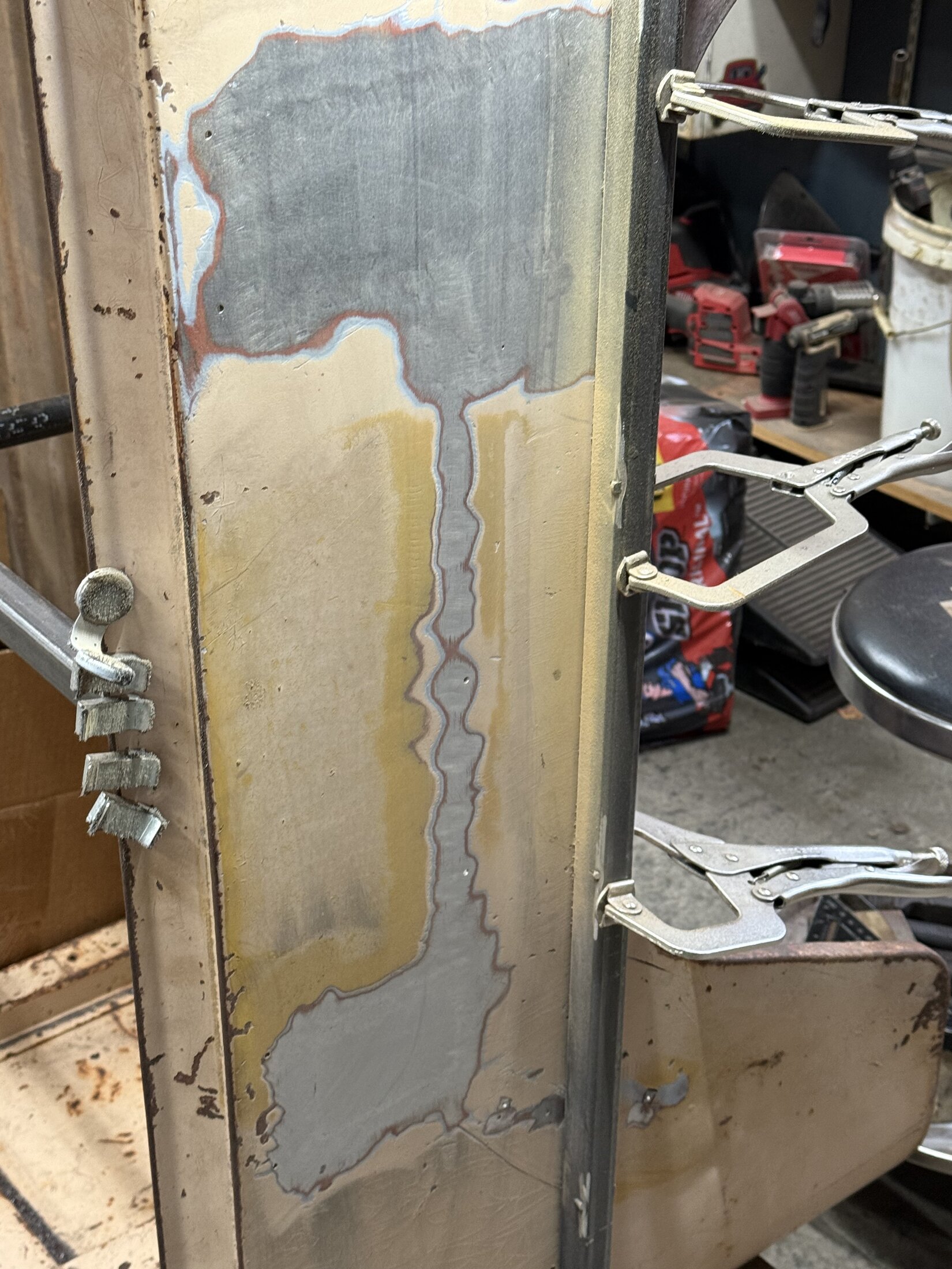

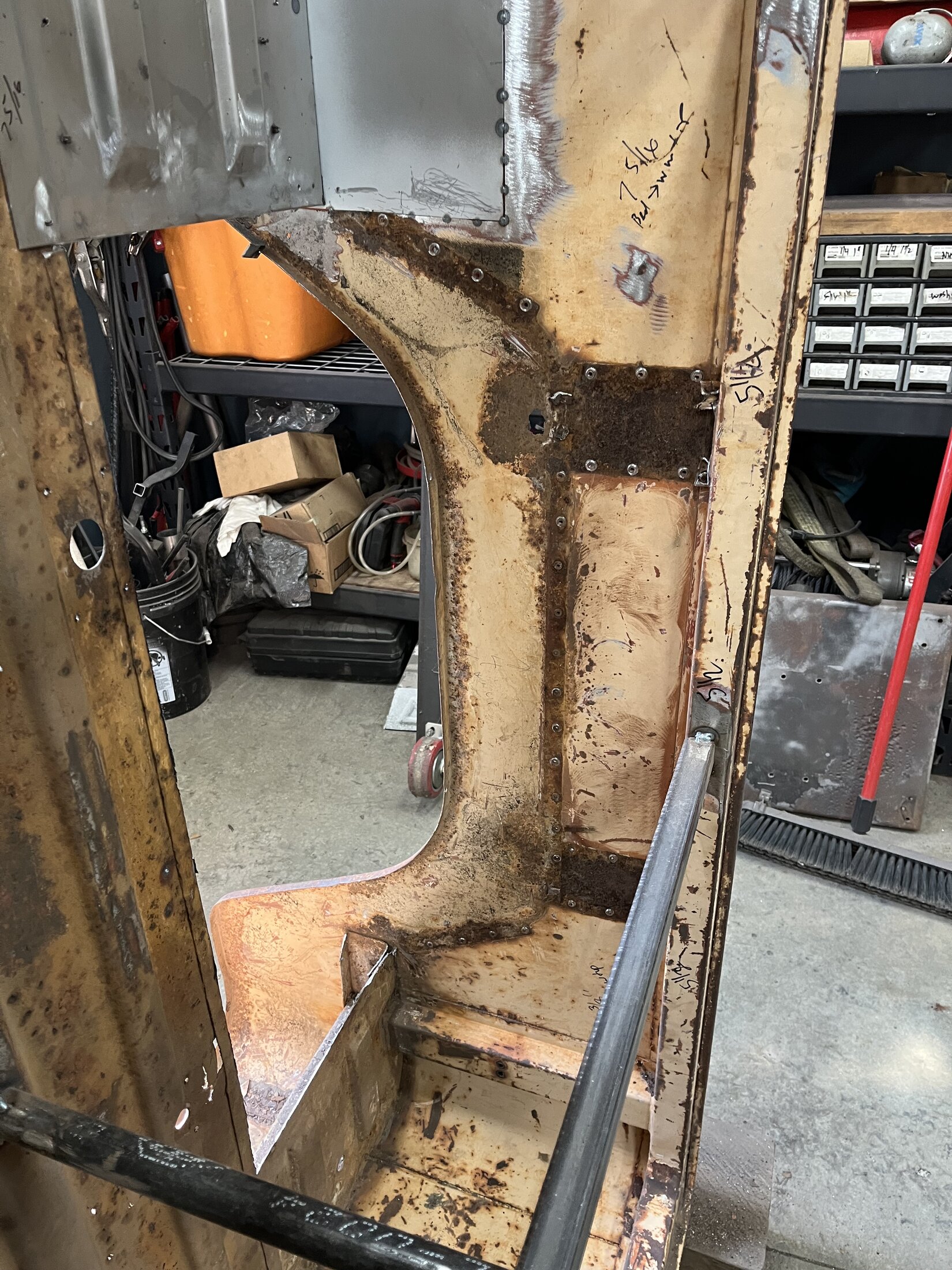

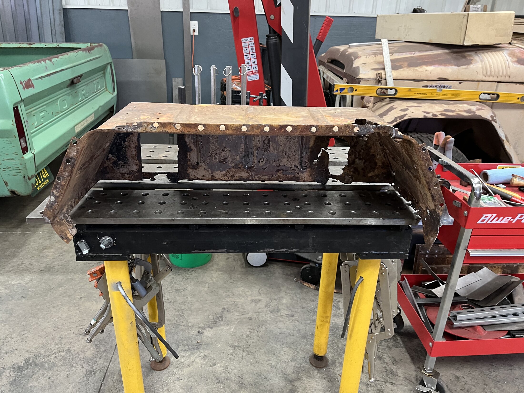

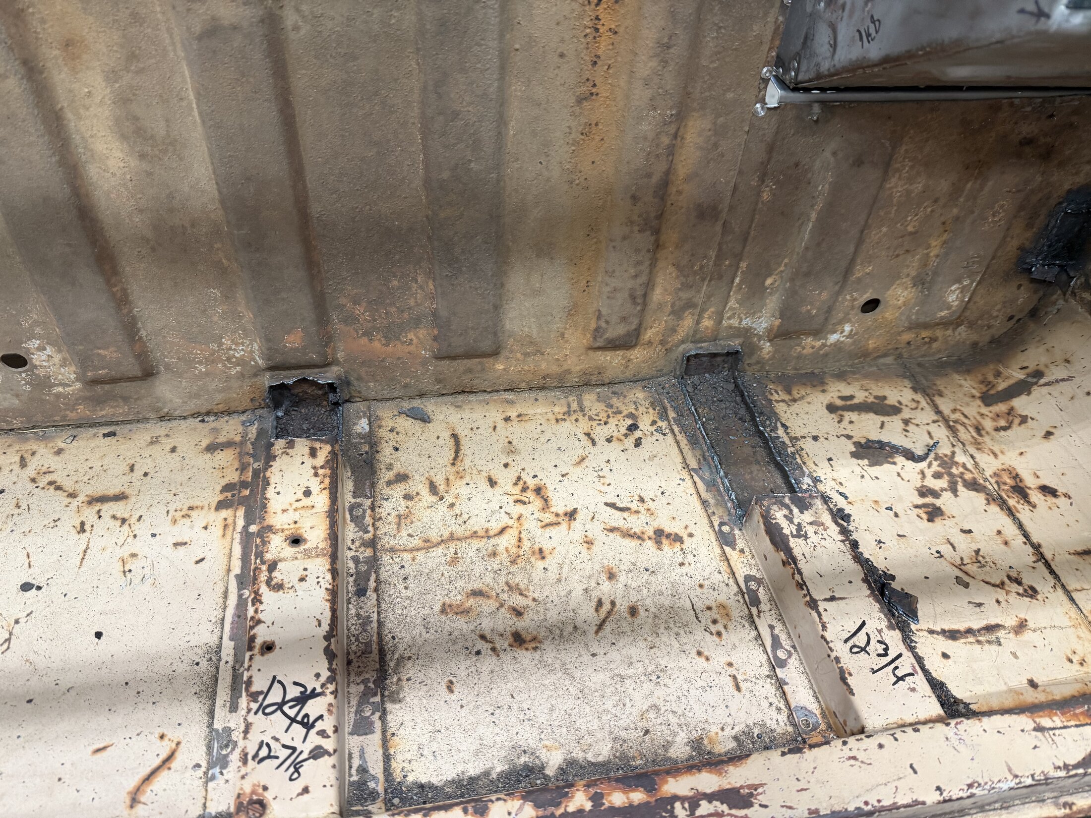

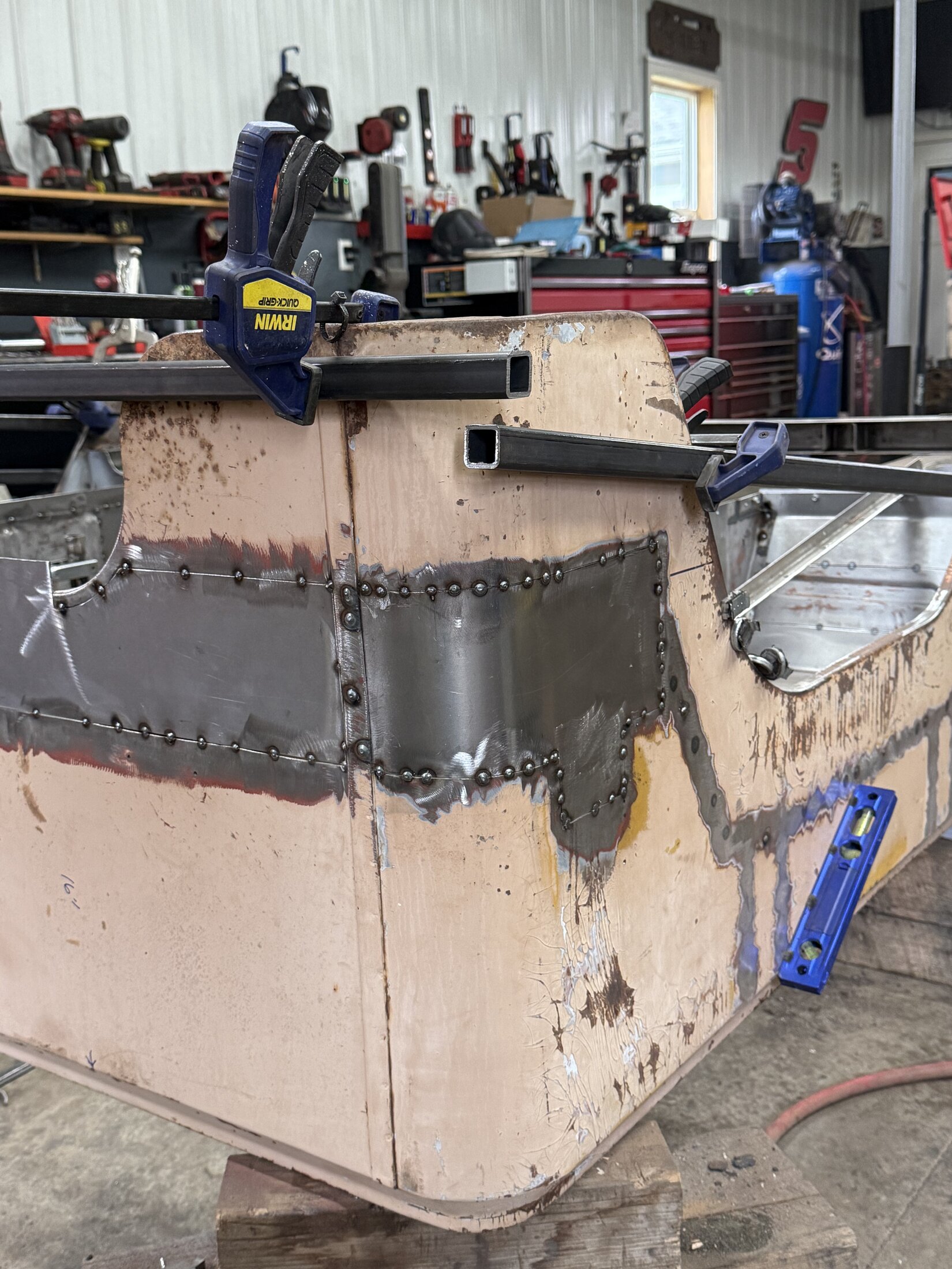

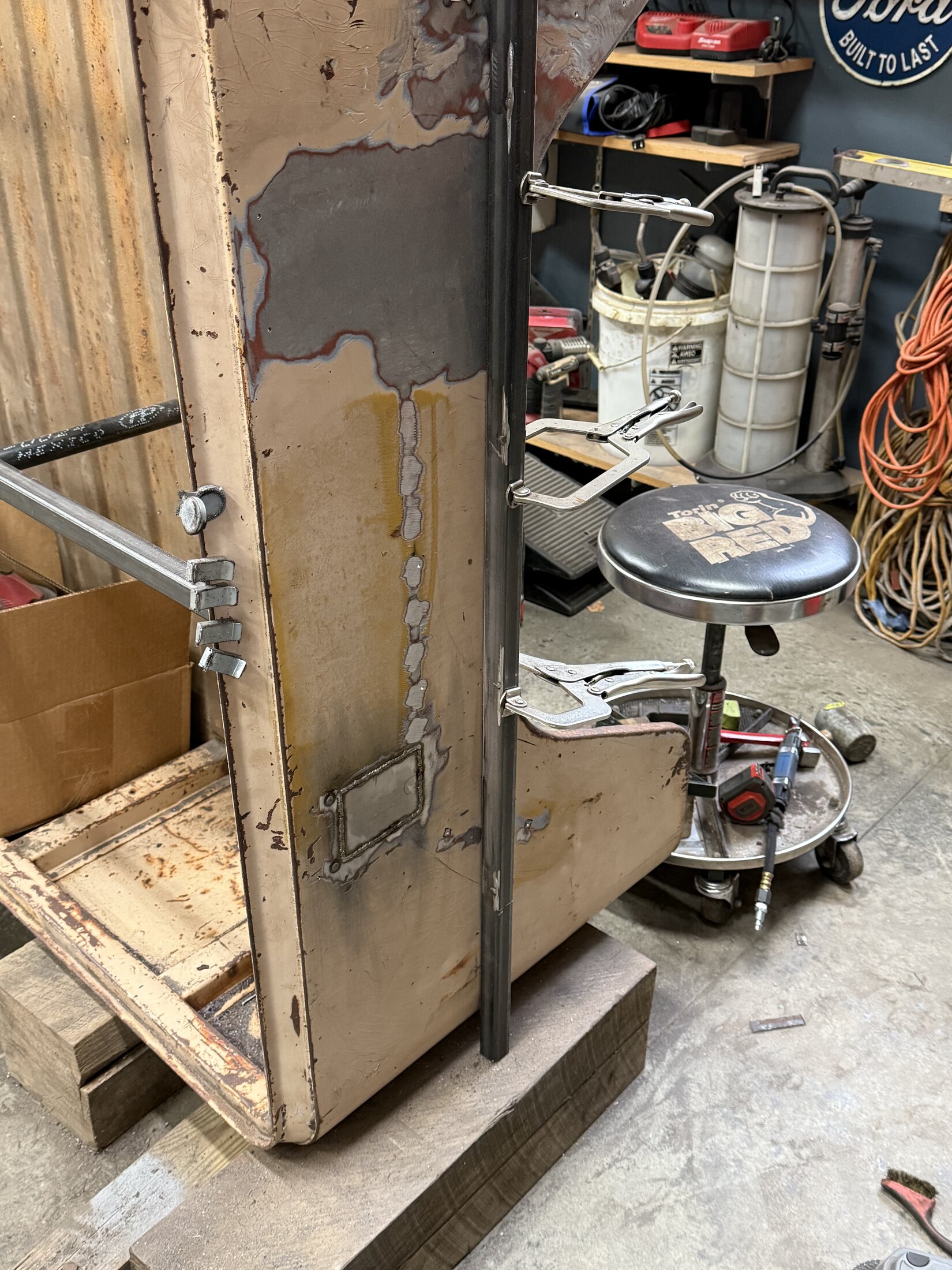

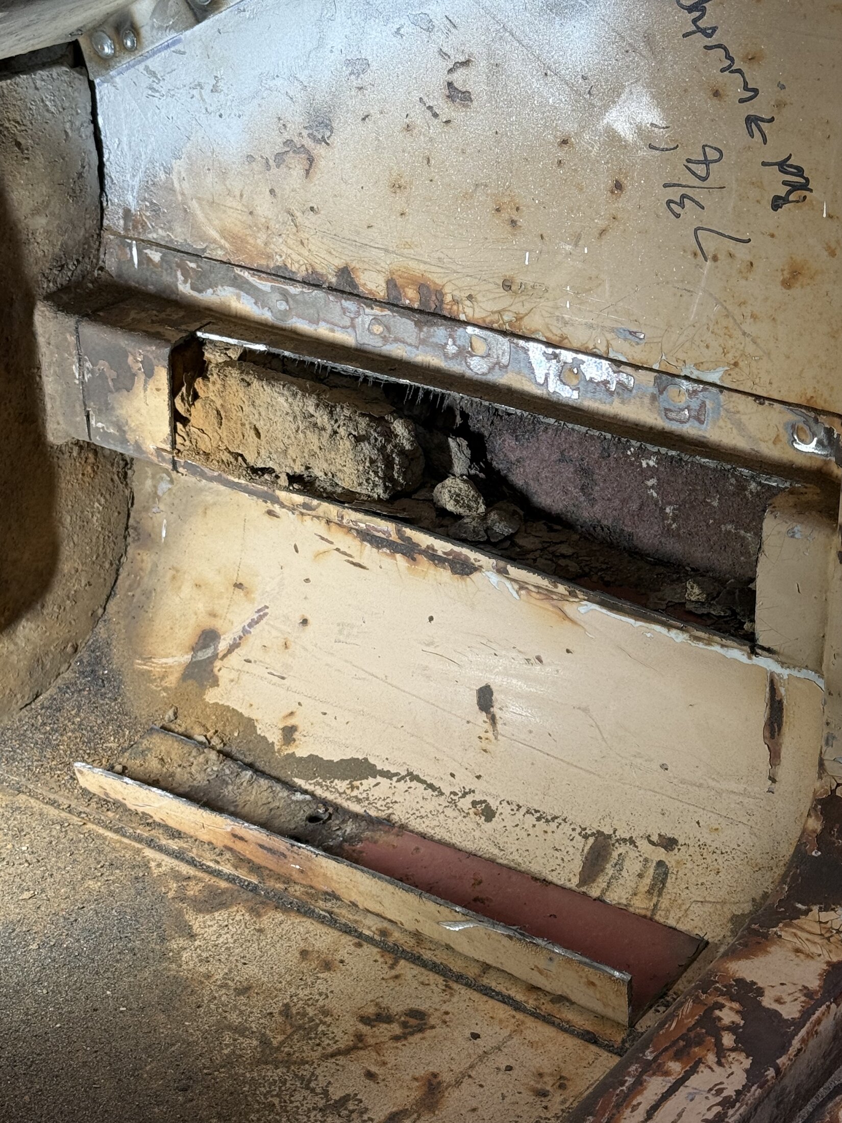

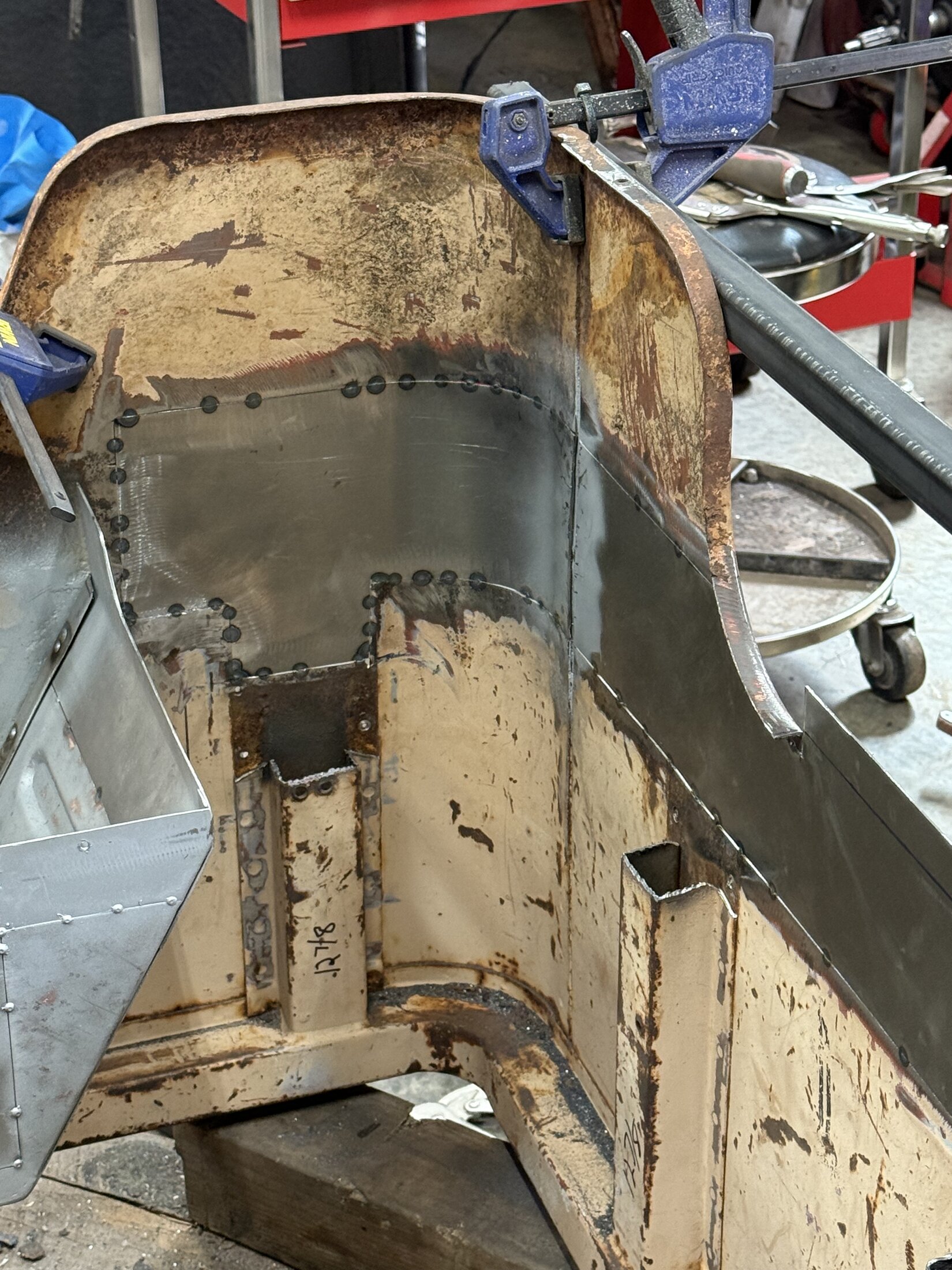

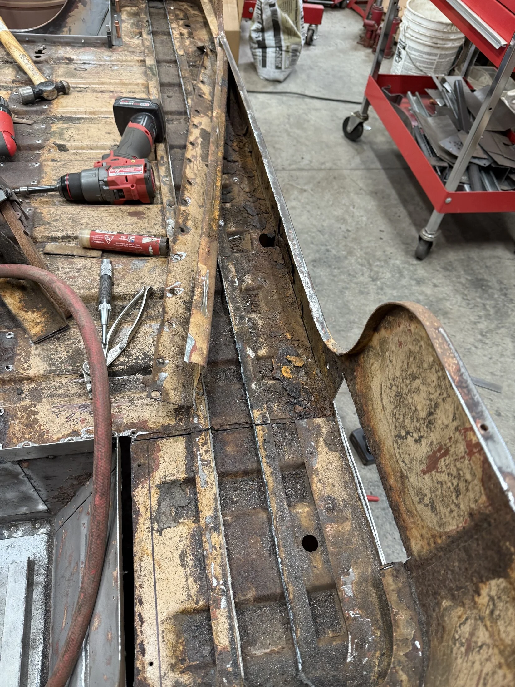

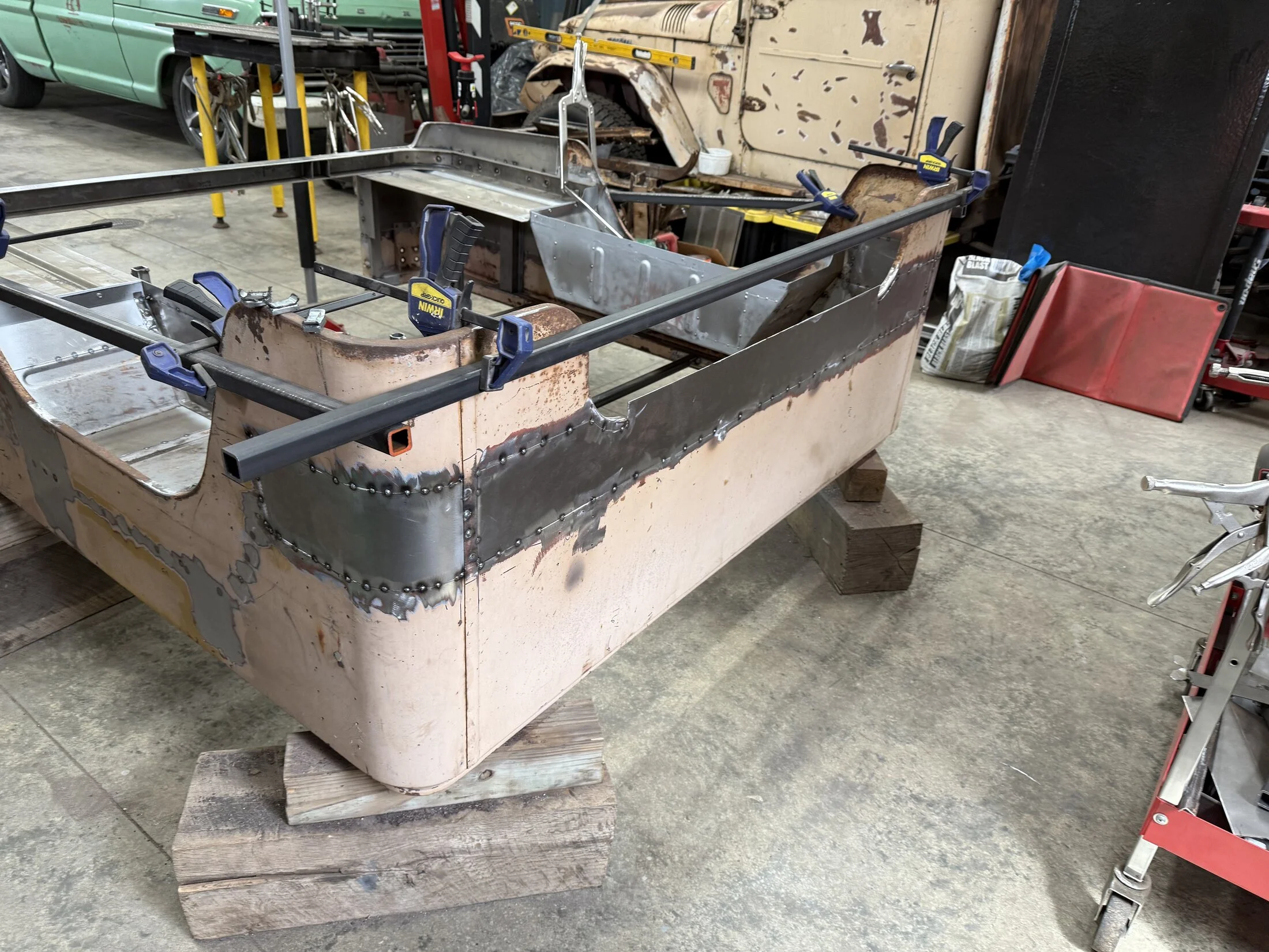

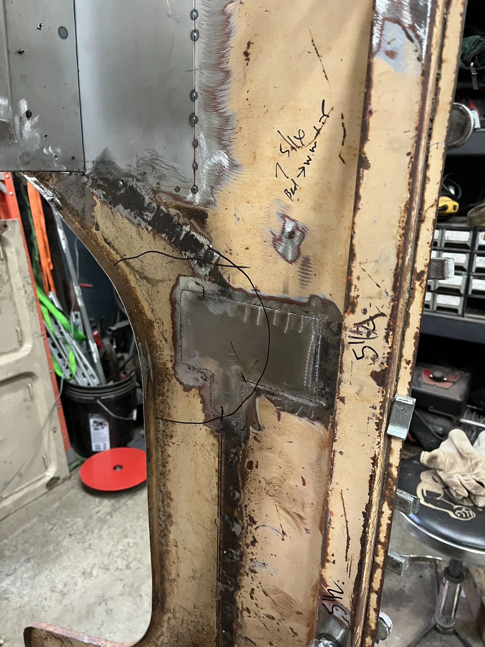

Welded in and removed other side. Not very excited about doing this again. Also thought about those Aquala beds again lol.

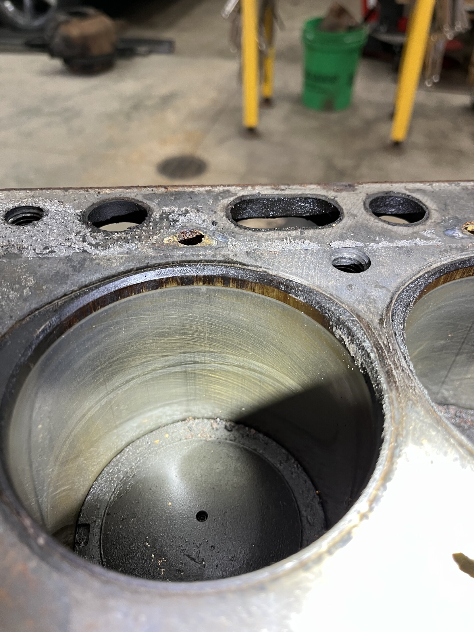

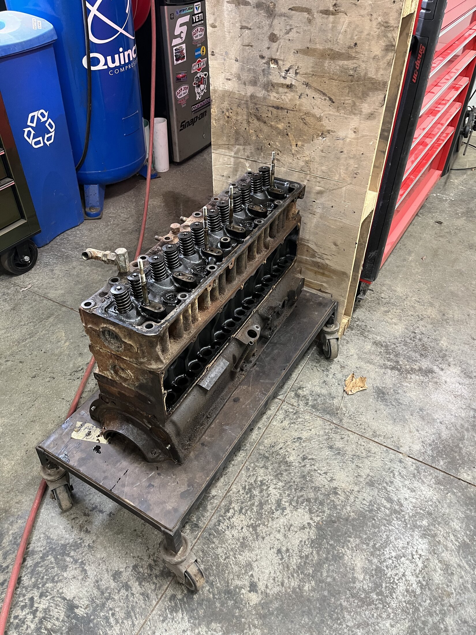

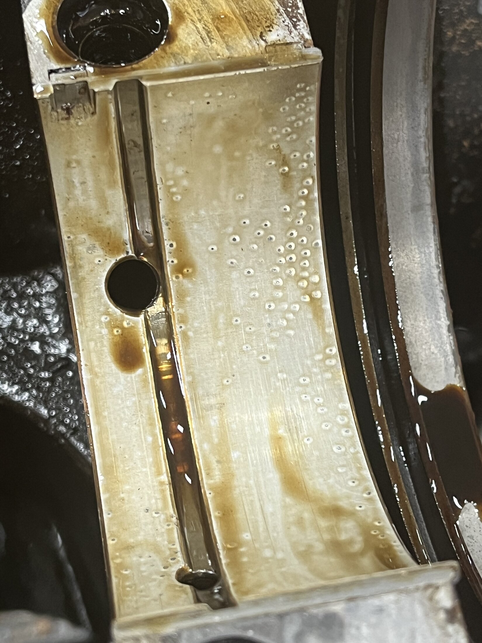

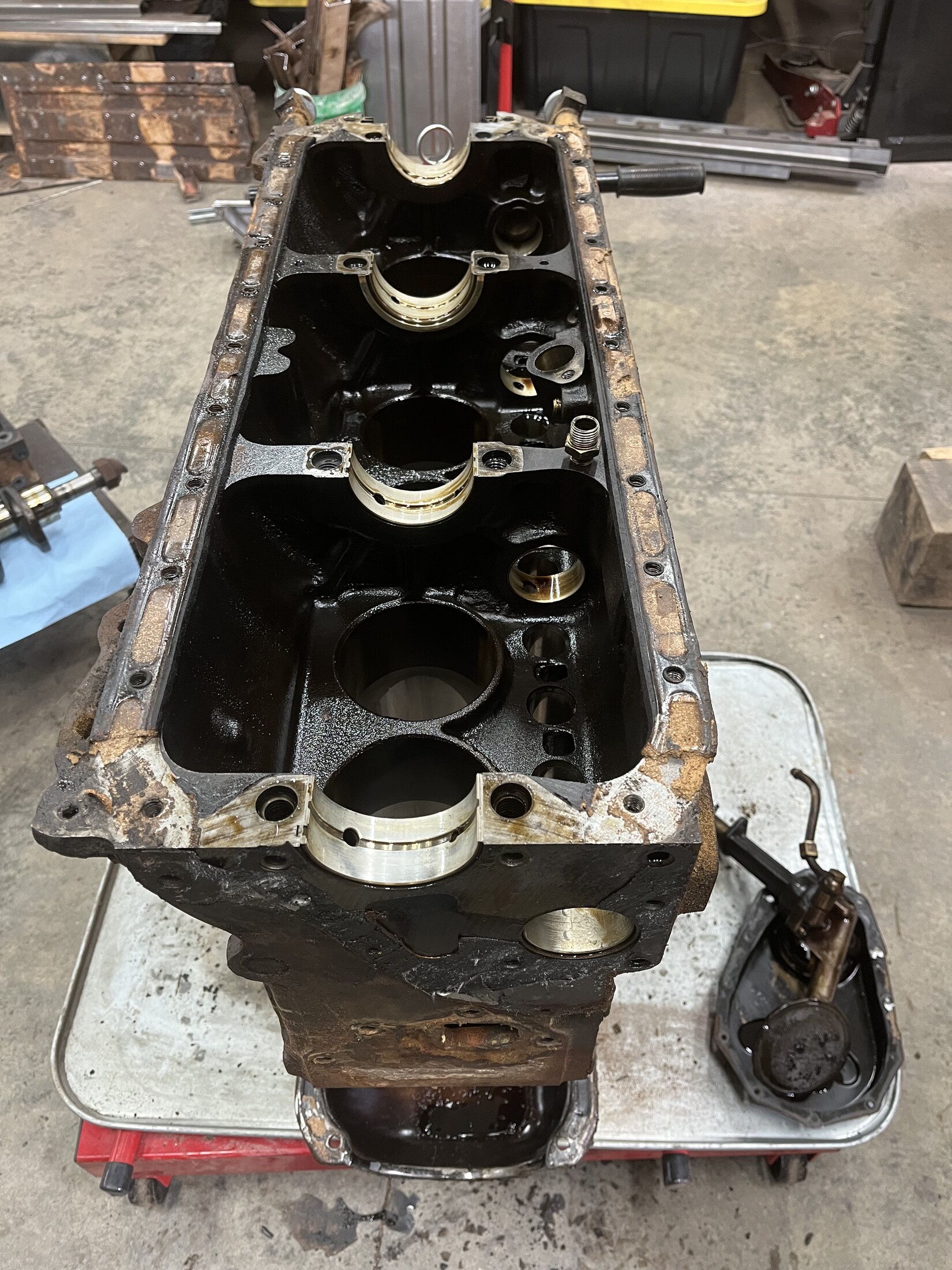

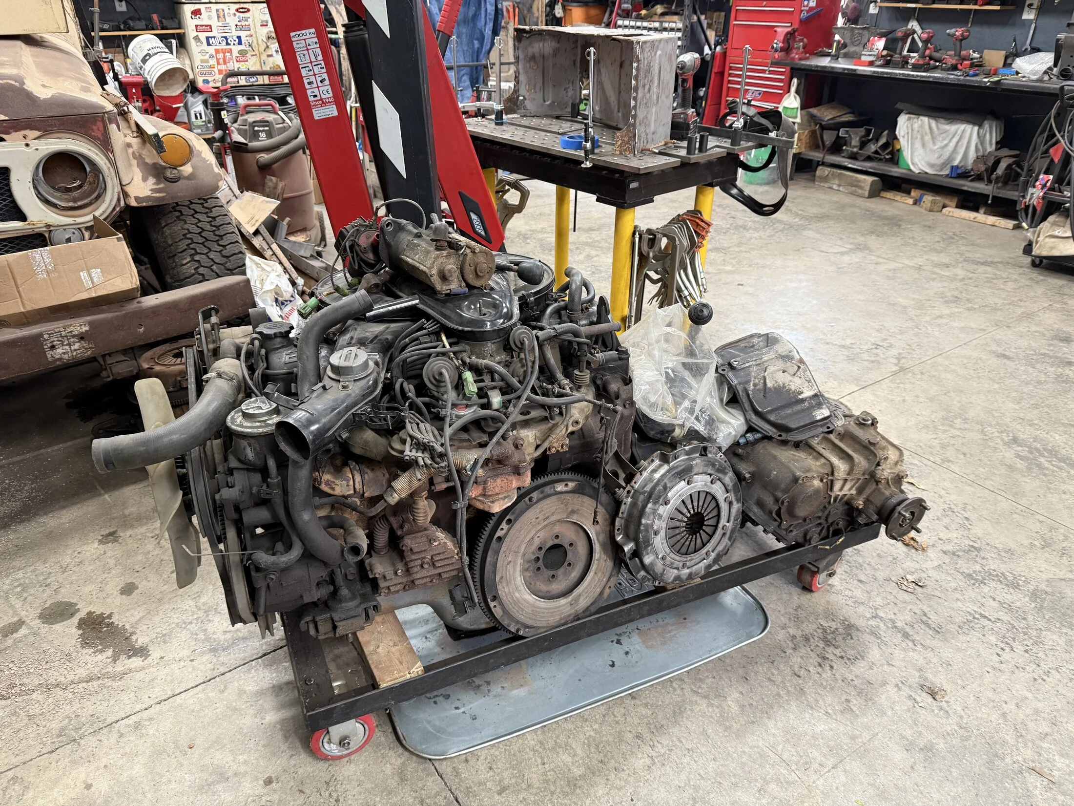

Finished up motor disassembly. Everything measures within tolerance. The main bearings have some bumps on them not sure what thats about but will install new. Taking head and block to machine shop. Block going to hot tank, new cam bearings, freeze plugs and hone. Head normal refresh check for cracks. Now back to metal work.
