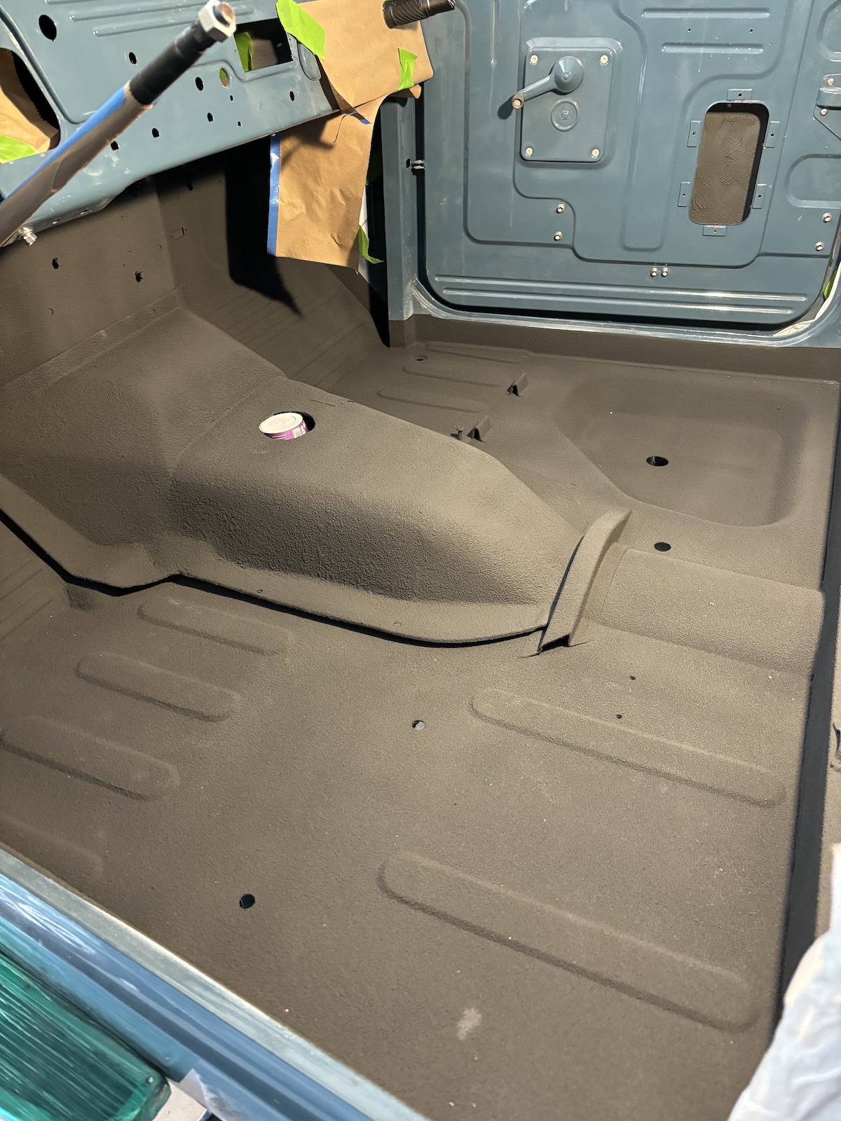

So prep on the floor went on and then an application of lizard skin prior to a repaint of the floor.

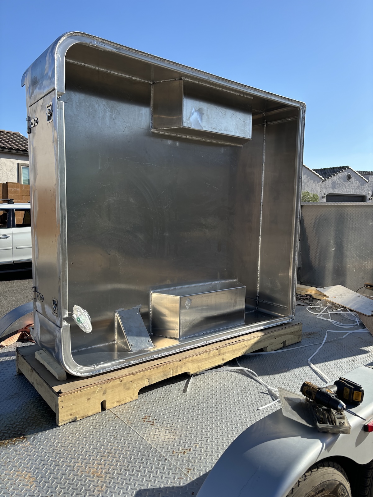

And in the midst of that work our solution to the bed arrived from Aqualu...
You have to cut the top horizontal part from the vertical sides and glue it to the top roof flange. The rest glues to the door as normal.
What ya gonna do with the old bed?
Owner wanted to sell it... and it's already sold to someone who DM'd me a few days ago. Ha! The MUD vultures are quick.
