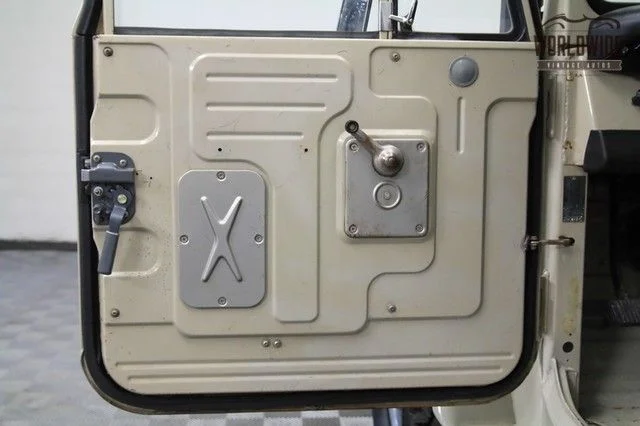

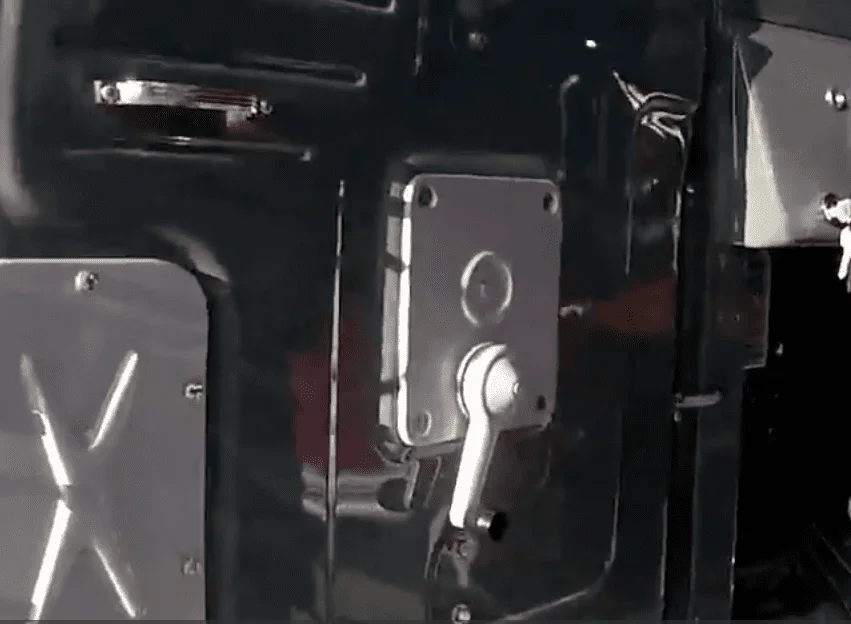

@tahoe40/45 those are the change over doors that have the slide regulator style door catches on the later winder regular doors, they are correct for that period of serial number

I know those are the correct doors for the year(even with early catches), I meant that the drivers side regulator is on the passenger side and vise versa. This was done on a Cruiser i had years ago, and sometimes the window will slip off of the regulator arm.
BTUMAN Im not bashing the work on this Cruiser, it looks really nice. Just was trying to help by mentioning that the regulators were reversed.
