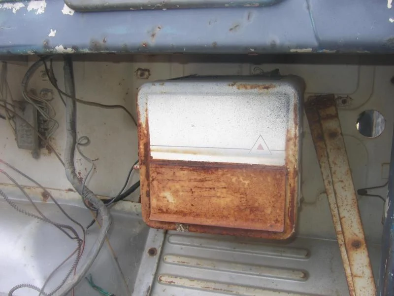

The heater is around 71-73. Maybe 70. The defrost handle to the driver's is the give away there.

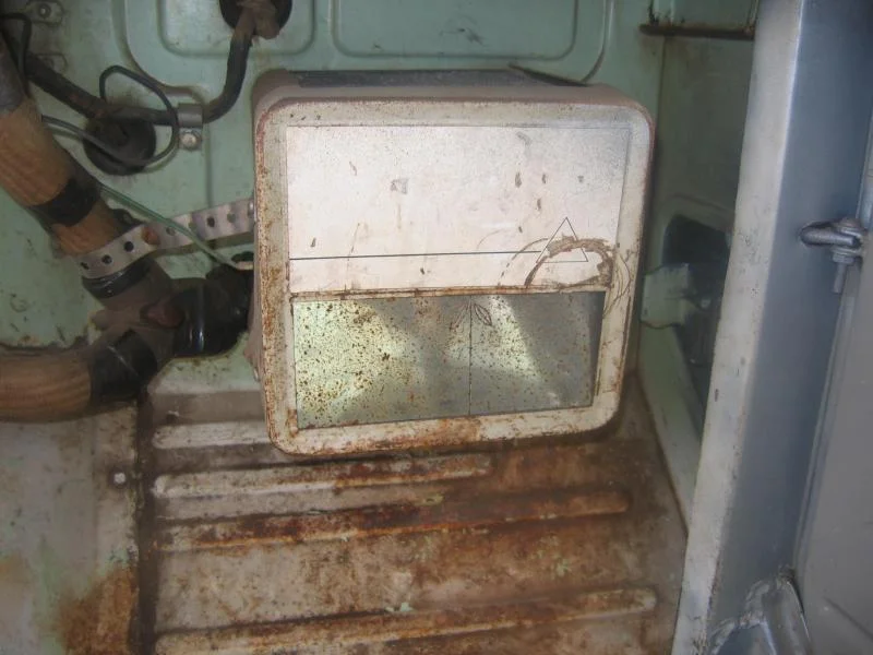

No heater really is listed for the the pre 64 2X/4X series. I know a heater was a option starteding in 65 and others have posted that they had a 64 with one but everthng else was a aftermarket. Most of mine came with some kind of a heater I think one or two the same as this one. All I know is Fox and I have a Nippon Denso heater that may or may not have been factory installed. It's not showing in the parts book. The defrost vents started with the 63 model year.

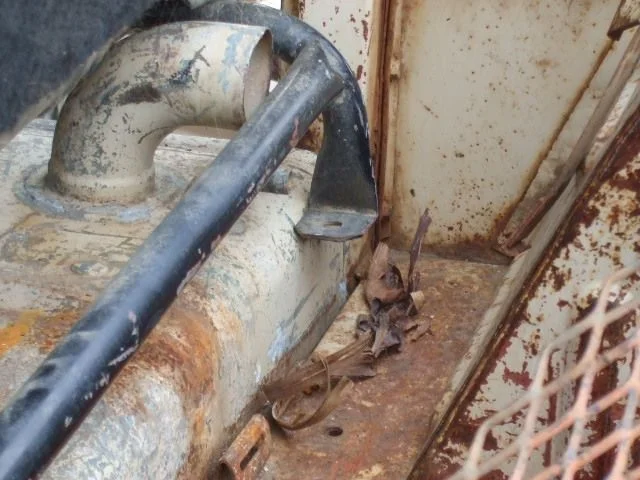

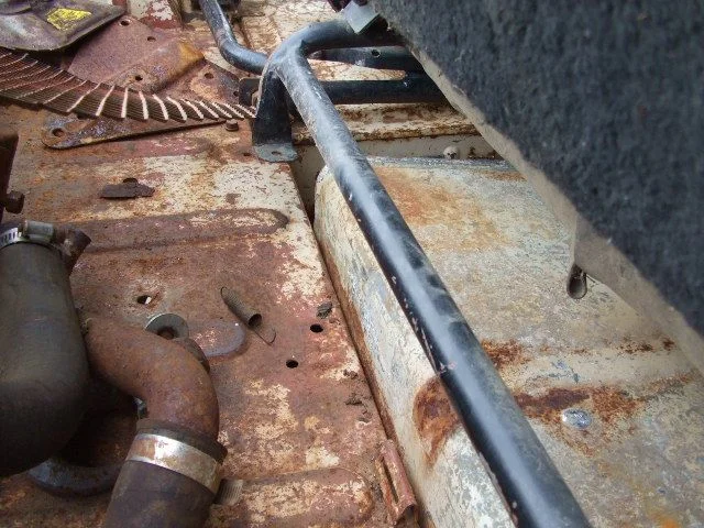

Not sure I will have to check it out this weekend. It's not bolted down just sitting in place. I've got a 68 seat in town besides the 64 and 62 seats. I know I using a set of 71 FJ40 seats in one of my FJ25 and it wasn't hard to do. It's a soft top model so the fill neck is in a different place.
I remember I had to use long bolts and washers. This a use around the cabin and forest roads. Just has lap belts. I would probably do it better if this a DD like Gene's LV and used on LA freeways. But I not worried for aroune the cabin. I can post pictures of how that one is installed. I do know the leg by the fill next switched which side it was bolted on in the mid sixties.

My 64 has the exact same heater. No blower cutout in fire wall or vent in the tub.

Here's two of the same heaters. One is from a 62 soft top tub. The other is from a 65 45LPB. Both are from the mid CA area. The third is a Denso heater that was in one of my FJ25. Don't know the story on it. Not sure where it was installed.
