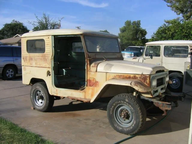

I think I found one 6 miles from my house. A guy jsut called wanteing to convert it to the flip up door door instead of the Bi-Fold. And he wants smooth sides on the side of his rig instead of the "some thing that looks like a tin roof".
I'll get some pics and post so you can let me know if it is the correct one.

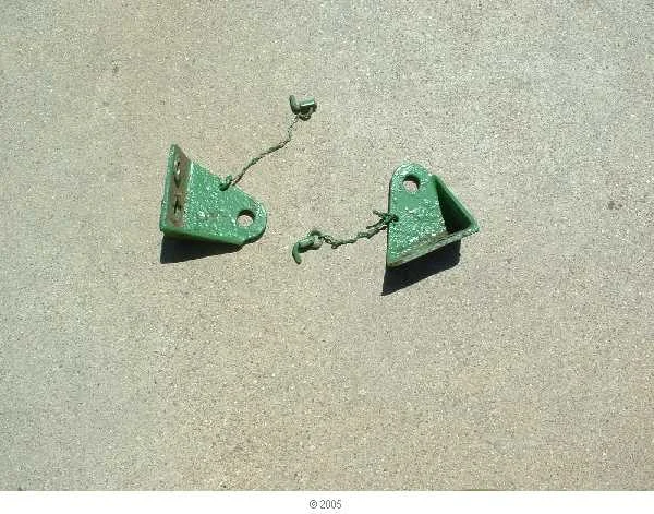

No pin on the chains that I have found.
I have the Stamped bezel.

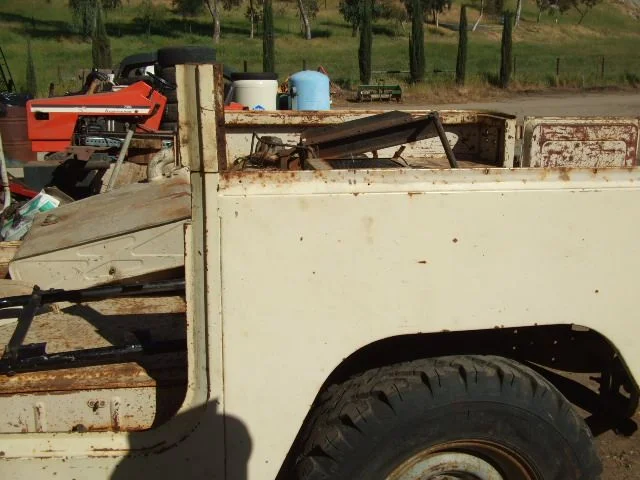

The correct hardtop for this is one with the corregations on the side and the bi-fold door in the back?
That's correct. The 63 and earlier side panels were different to fit over the high B pillar on the tub. The 64 and 65 side panels didn't have the cut out.

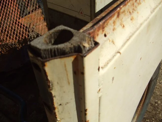

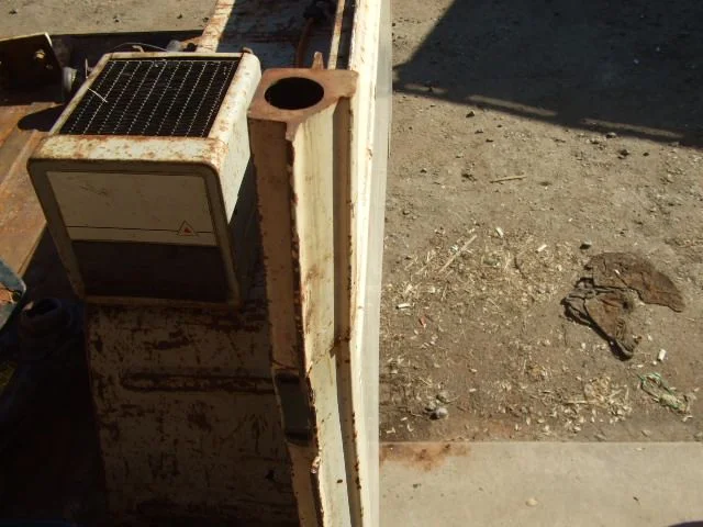

Interesting if these tall door posts were cut. I have been looking for a very clean '64 tub, and thought this might have been a good deal...price would have been great...oh well, mine is not too bad (still very drivable, but not perfect), so slowly I keep looking.
So then he does need the older top with the high posts, and now he'll need to find a couple posts to weld back on.
The 64 had the normal B pillar. The 63 model year not the 63 production year had high pillar. I do have a couple of 64 hard top sides that need a little work that should work depending how they cut the high pillars off. I did notice there is no ashtray so it's earlier than my 63. Both are hard tops. I PM you my VIN when I get home.
Dan, on the first picture you posted in post #3, you can just see the post we are talking about behind the driver's door. It should be a tall post if this is an early '63 (like the green '62 pictured below) but it looks like the short post (like on blue '64 pictured below).
If the guy you just mentioned has a '64 or early '65 top, it might just fit as is. If he has a '63 or older top, you might need to build a new post, or find a couple tall ones off a parts rig, and weld them back on. Either way, if the price is right, you can't go wrong with an extra top for parts.

So then you need a '63 or older top, with the space for the high post/pillar, as on the green rig pictured above.

Is this what the pin would look like?
This is on the lever on the dash.
There should be a pin on the end of the chains. That goes into the hole in the seat base to keep if from slipping out of the bracket. I can post a picture tomorrow. Too late tonight.

Cool that you found one of the pillars, you could probably lop off enough off the '64 tub to fix the passenger's side of the '63.
Actually, TLC had a '63 corrugated top for sale not that long ago...maybe he can help you with that other, missing, pillar??
I think we need to trade VINs. Without the defrost vents thru the windshield no ashtray I'm beginning to think this is a true 62 and not an early 63. Happened all the time back in the early days for Toyota here in the US. They weren't selling a ton of them in those days and got called a later model when titled. Later they got the brass tag with the VIN plate but I've never seen a brass tag on the real early cruisers. Two of my FJ25s are titled as 61 but Toyota never put out a 61 model of the FJ25. They were all 60 or early models. Toyota's 61 model was the FJ40.
I'll try and post pictures of the defrost vents and the pin on the end of the chain tonight. The pin for the hi/lo lock is not the same.
