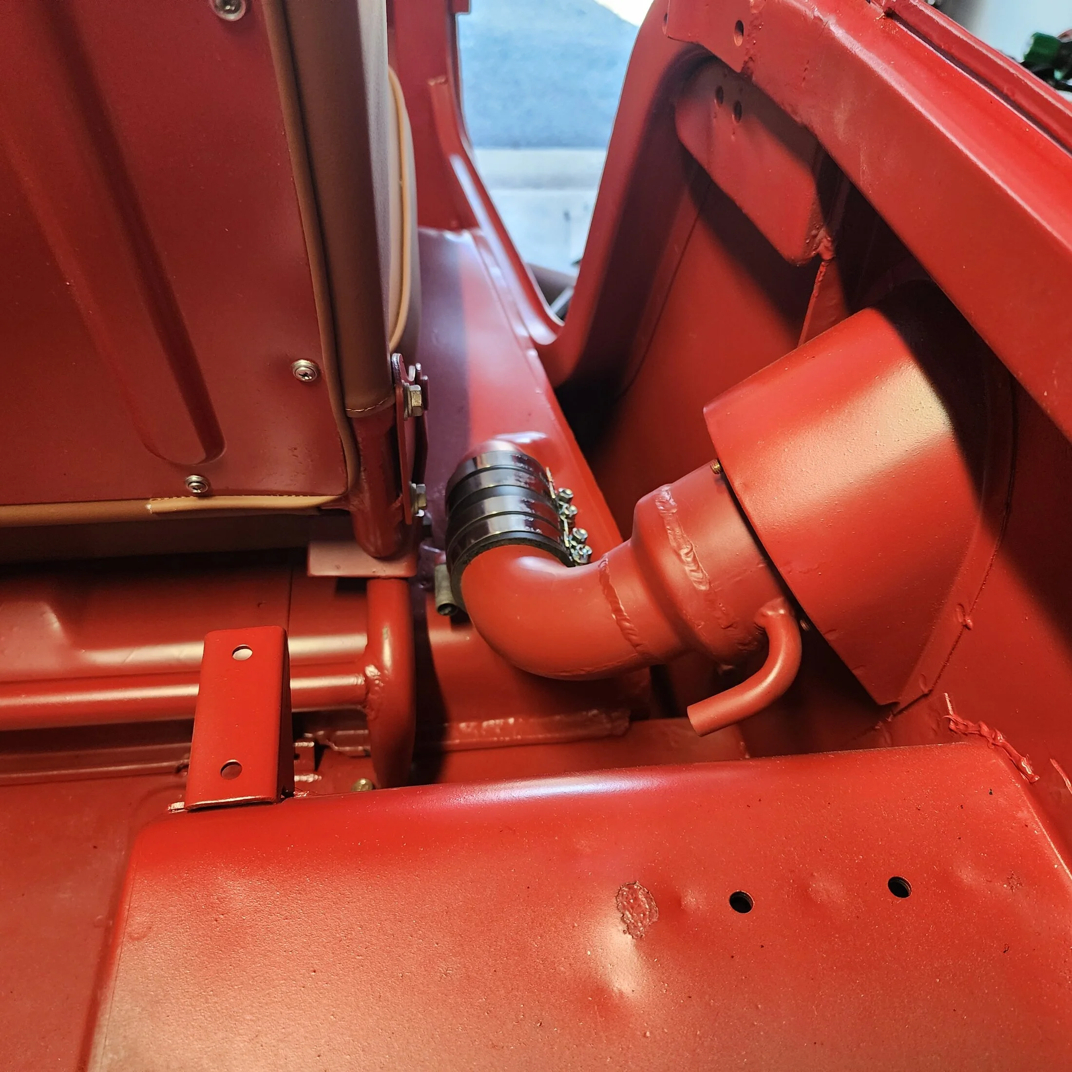

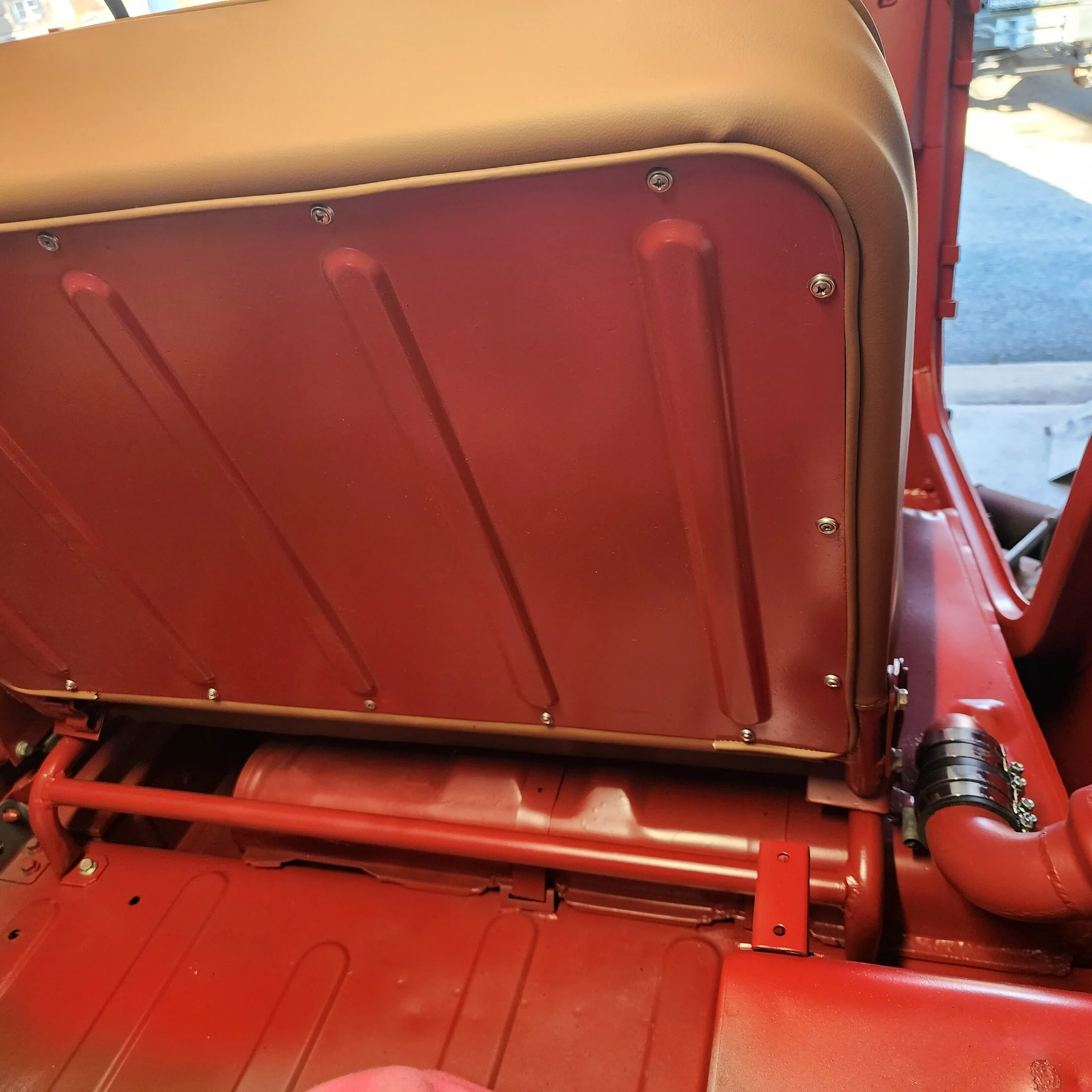

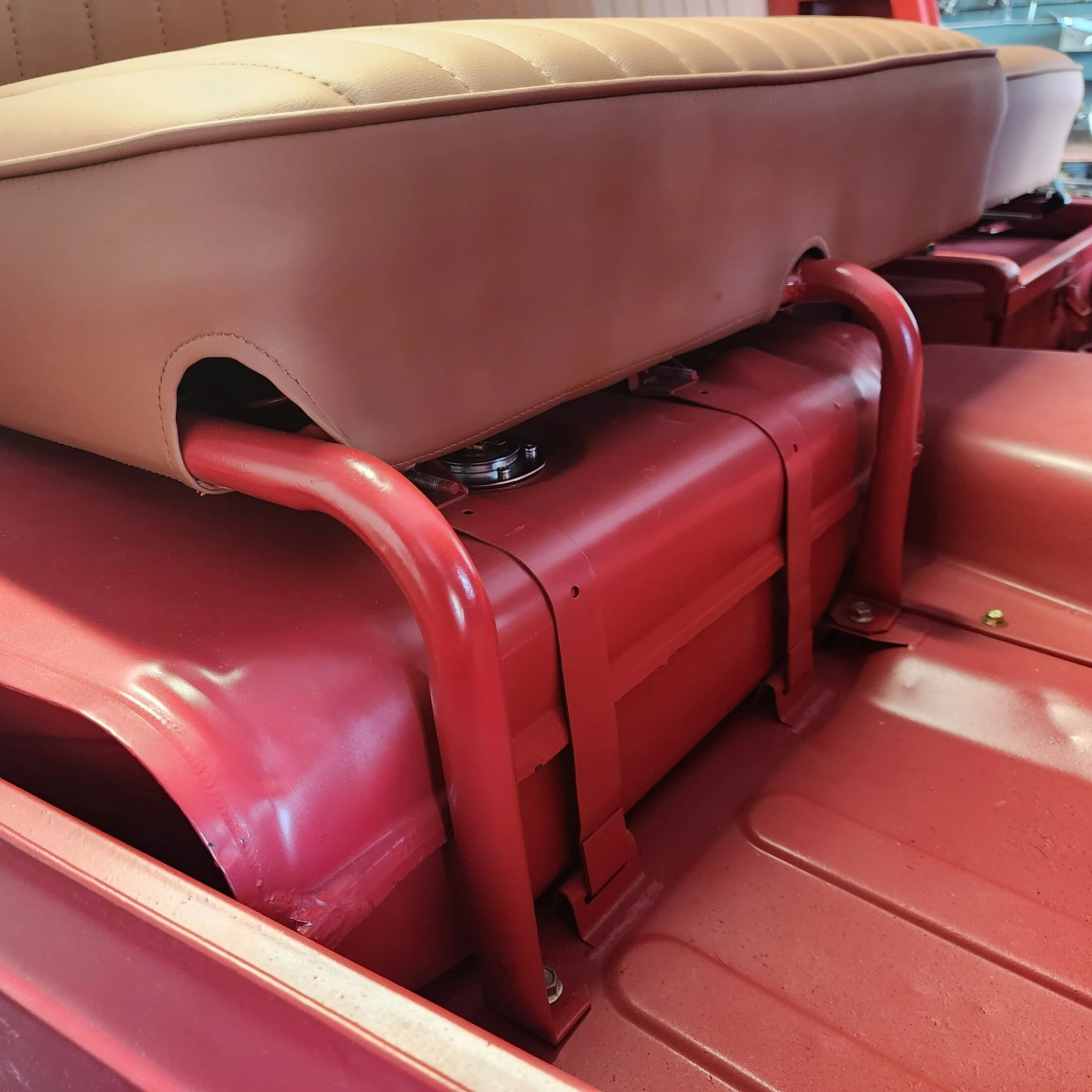

Gas tank and passenger seat are in for real now.
Dont forget the felt padding on the gas tank straps.
I don't want something in there that's going to absorb moisture and stay wet.....it will get rained on during the summer.

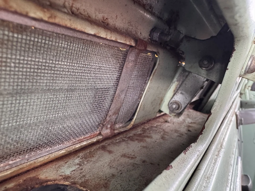

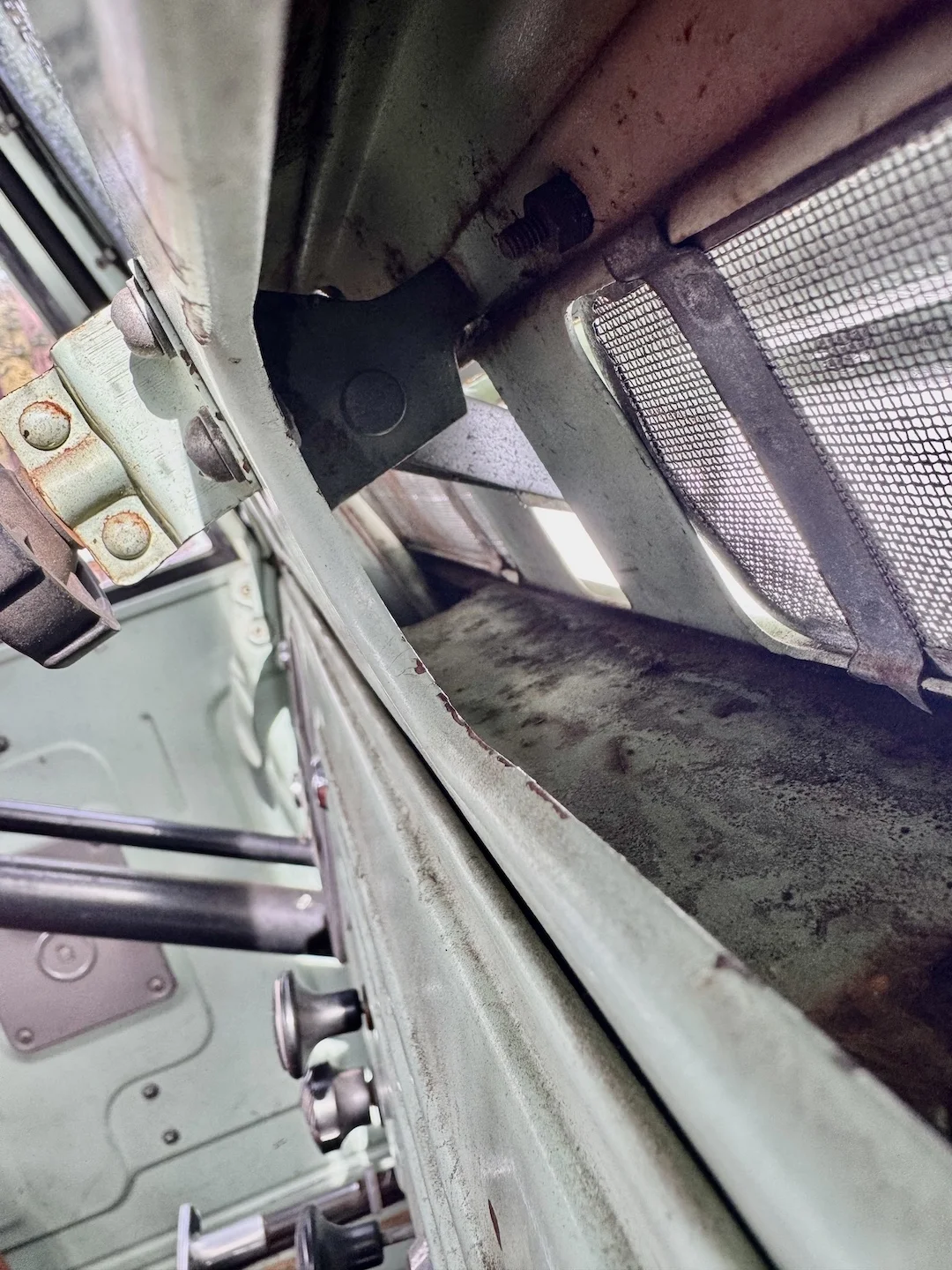

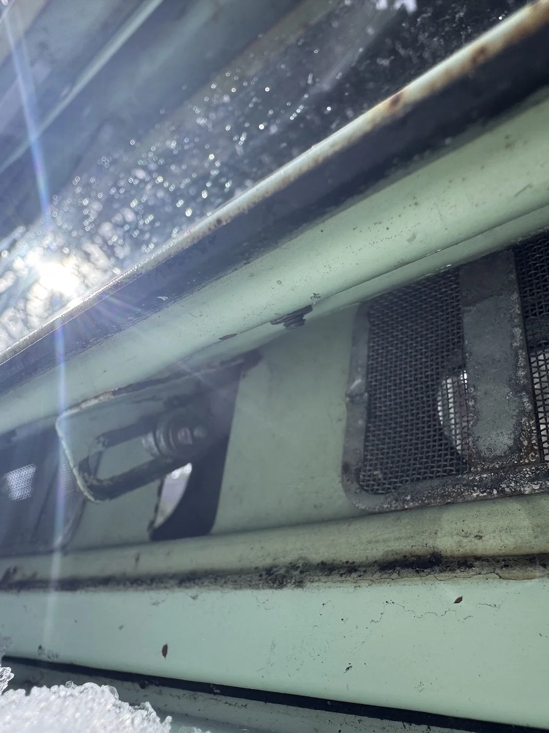

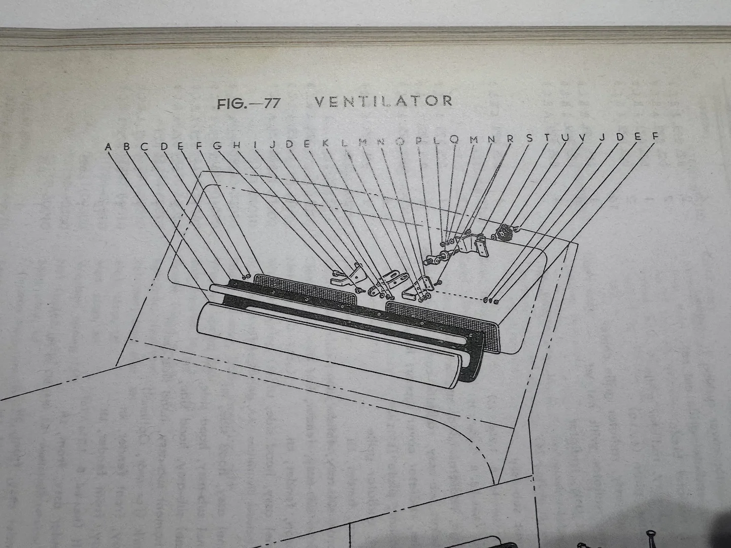

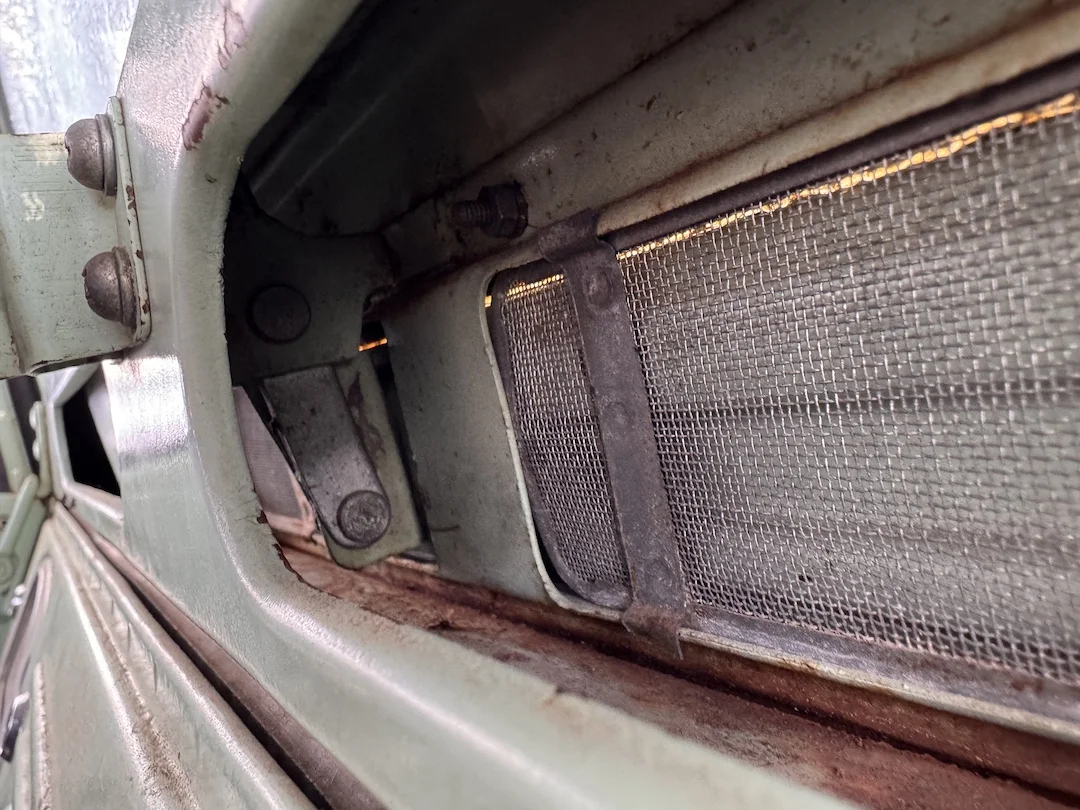

can someone post a few pictures of the linkage arrangement for the windshield vent?

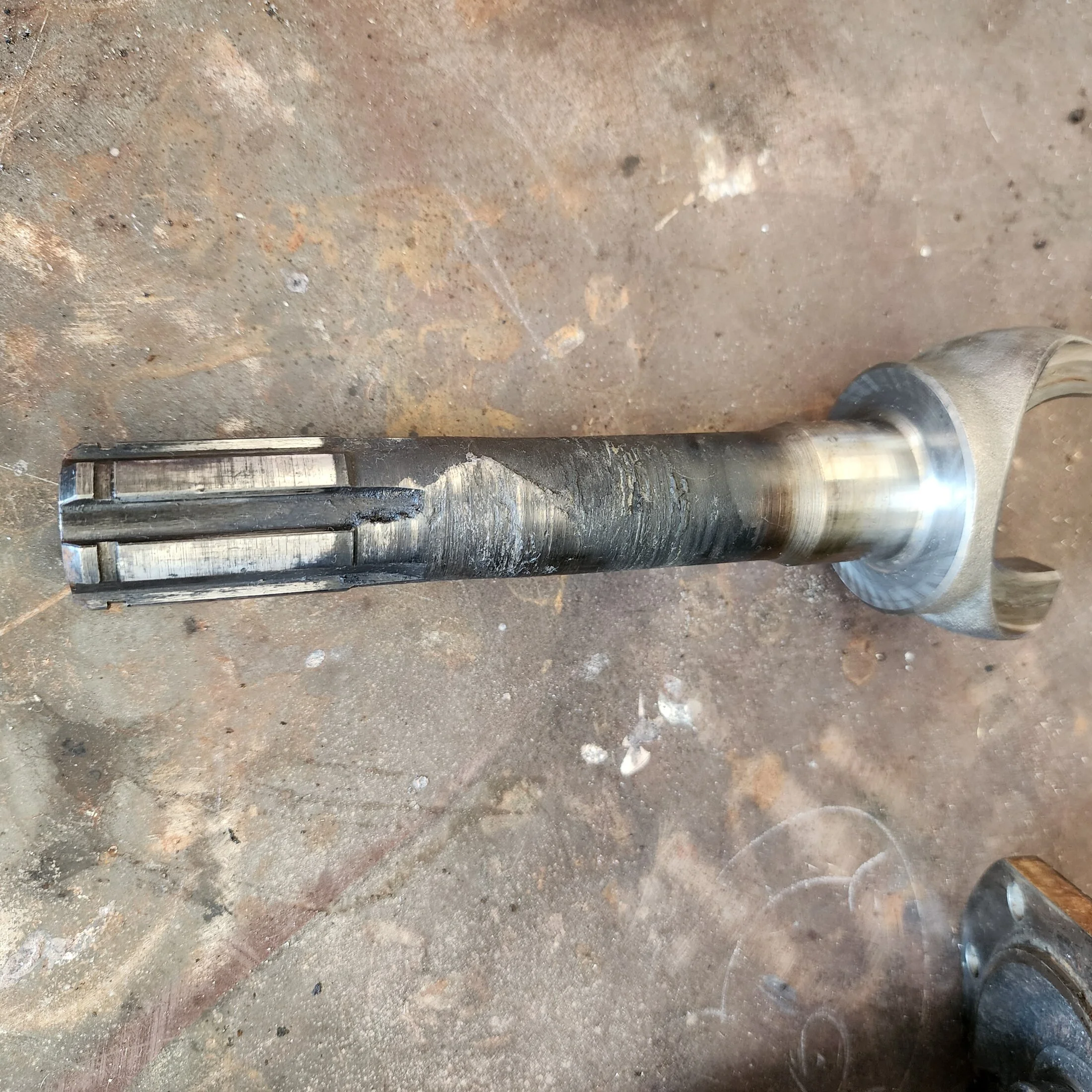

Bent stub end.
