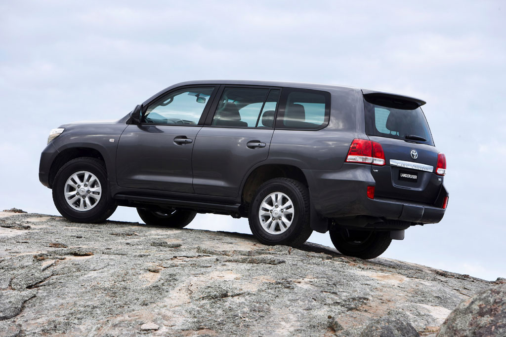

Those are actually 200 series wheels. You can buy the center caps from your local dealer. 4260B-60030
2008 Toyota LandCruiser 200 1
