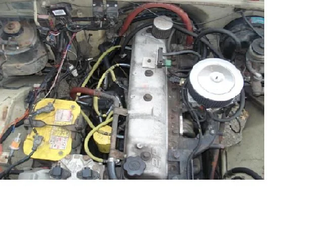

I just had to post this... I took my first long drive to calculate gas mileage with my new TBI setup, and got 17 mpg! :D This was mostly on a country road, going about 55 mph, about a quarter of the trip was in traffic in town.
Bullsh*t, you're saying... and I would be too. A year before I removed my carb, I was getting about 10 mpg (not running well). I expected a jump in mileage, but I really didn't expect it to be so significant.
Anyway, I'm running 31's on my cruiser at the moment, BFG at/tas. I think that if I ran 33's, I could get that up to about 19-20 mpg.
- Matt

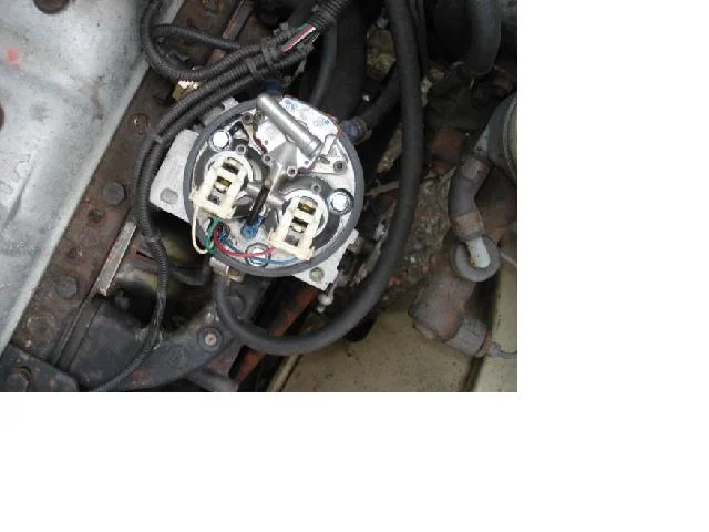

Yeah, the power is a LOT better all around. Take that with a grain of salt, though... before I did the TBI conversion, my carb was jetted and tuned for about 400 feet above sea level, and I live at 5000 ft. Never could get it running smoothly here in CO. However, John at Coyote Cruiser here in Fort Collins took it for a drive and was impressed with the power all around, so it's probably not just me.
The conversion was easy to do, with good instructions. I'm pretty much a newbie at mechanics, and it took me a couple of months to complete... working on the weekends and scrounging at the junk yard when I felt like it. Could have been done in just a few weekends if you knew what you were doing... probably less. I had a manual from Downey, the two tech write ups on this forum, and that was about it. When I started the conversion, I didn't even really know what a throttle body looked like... just went to the junk yard and started removing things that looked right :)
Anyway, my junk yard parts only cost a couple hundred bucks, and that was most of it... from the throttle body and injectors to sensors and fuel pump and computer.... I did buy a few new parts and the throttle body adapter, though... so it could have been cheaper.
I think what really made the difference was getting the cruiser on the Dyno (took it to Lundstedt Automotive in Fort Collins) and having the chip tuned professionally. It ran before I did that, but not well. That was a bit pricey, but well worth it.
Suppose that I ought to mention that I was driving the landcruiser in Parachute mode; front doors off, hard top on, ambi-doors on (and closed). Don't know what kind of difference it made, but I doubt that it helped :)
- Matt
