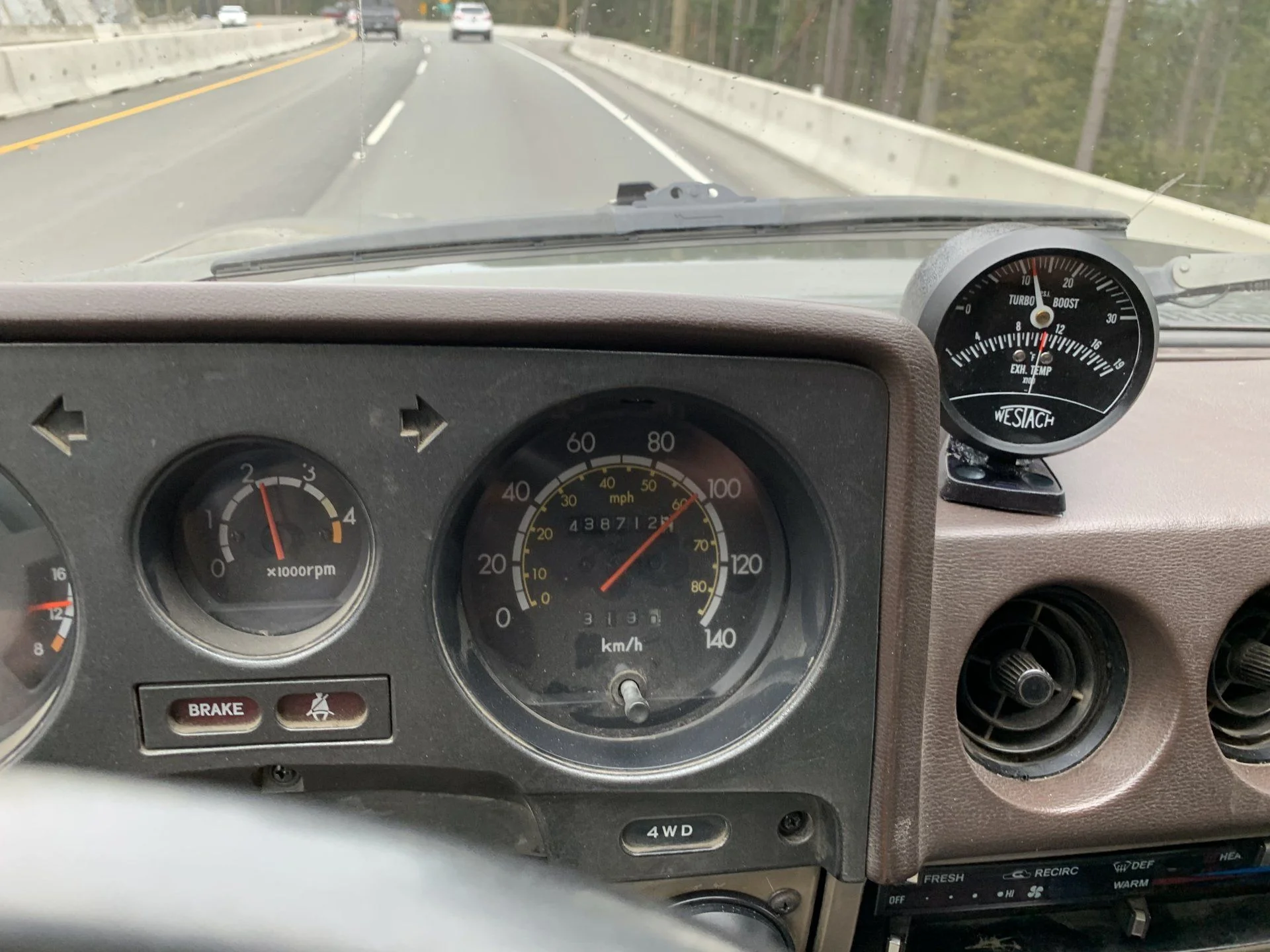

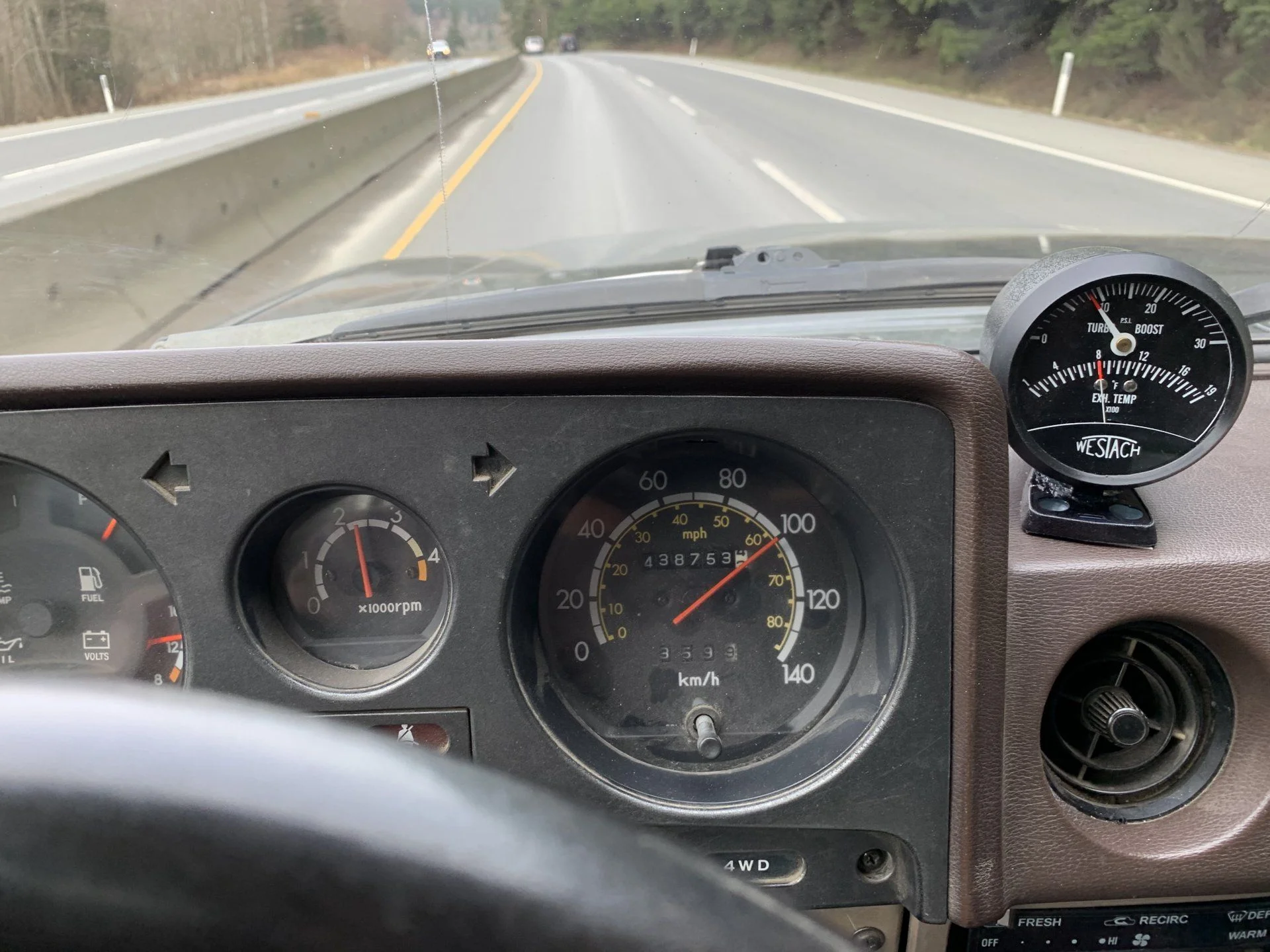

Here is pulling up a 6% grade and the second is just cruising, both 5th gear. After 1200 kms of hot rodding, pulling my trailer with ATV and other cargo back and forth over the Malahat, averaging 10-15 kph faster than I normally would have driven, still getting same average fuel economy. Can’t wait to run a nice long road trip without 150 stops and starts.
View attachment 2235985View attachment 2235986
Wow, nice. Thanks for providing the reference! :)
Can you also show temps? cheers.
