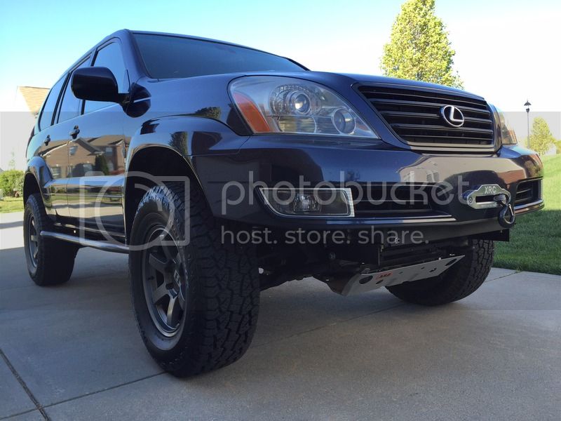

Just have to get the rear control arms in, realign, and put the skids back on.
That is a prado bumper...you have to cut a fair amount of sheet metal off to make it work on a GX.
Looks great! What lift did you install? Any write-up on installation? Thanks.
Just the standard Bilstein 5100's and Toytec 2" springs up front. In that pic, I just did the airbag trick in the back, but since done the Metal Tech spring conversion and 5100's with Toytec Superflex springs in rear (and added OME trim spacers for an extra 3/4"). Also moved the Bilstein clip up to the 3rd notch (1.75) to help with the sag from the weight of the winch.
I have KDSS, so install would be a little different - but this is a good reference for do it yourself: How To: Lift Installation (on KDSS equipped vehicles) - Page 2 - Toyota 4Runner Forum - Largest 4Runner Forum

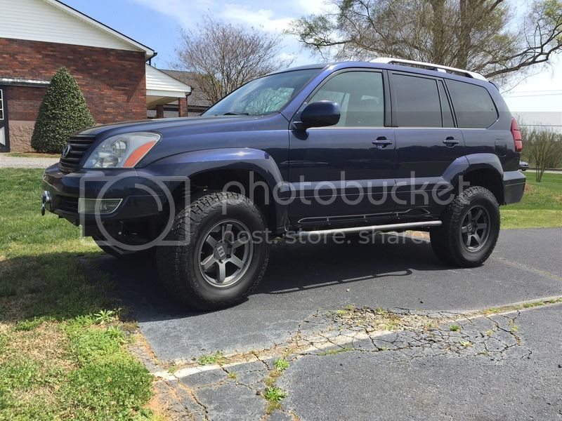

Here's how it sits today...
Love the way you cut the side steps! Would you be willing to post some up close up pictures from below to show how you cut them? I would like to do mine the way you did.
I have searched MUD for more details on cutting them but haven't found much on specifics.
Check out Orion's build thread, near the bottom of the first page, he's got some info on how to do it. See link below.
