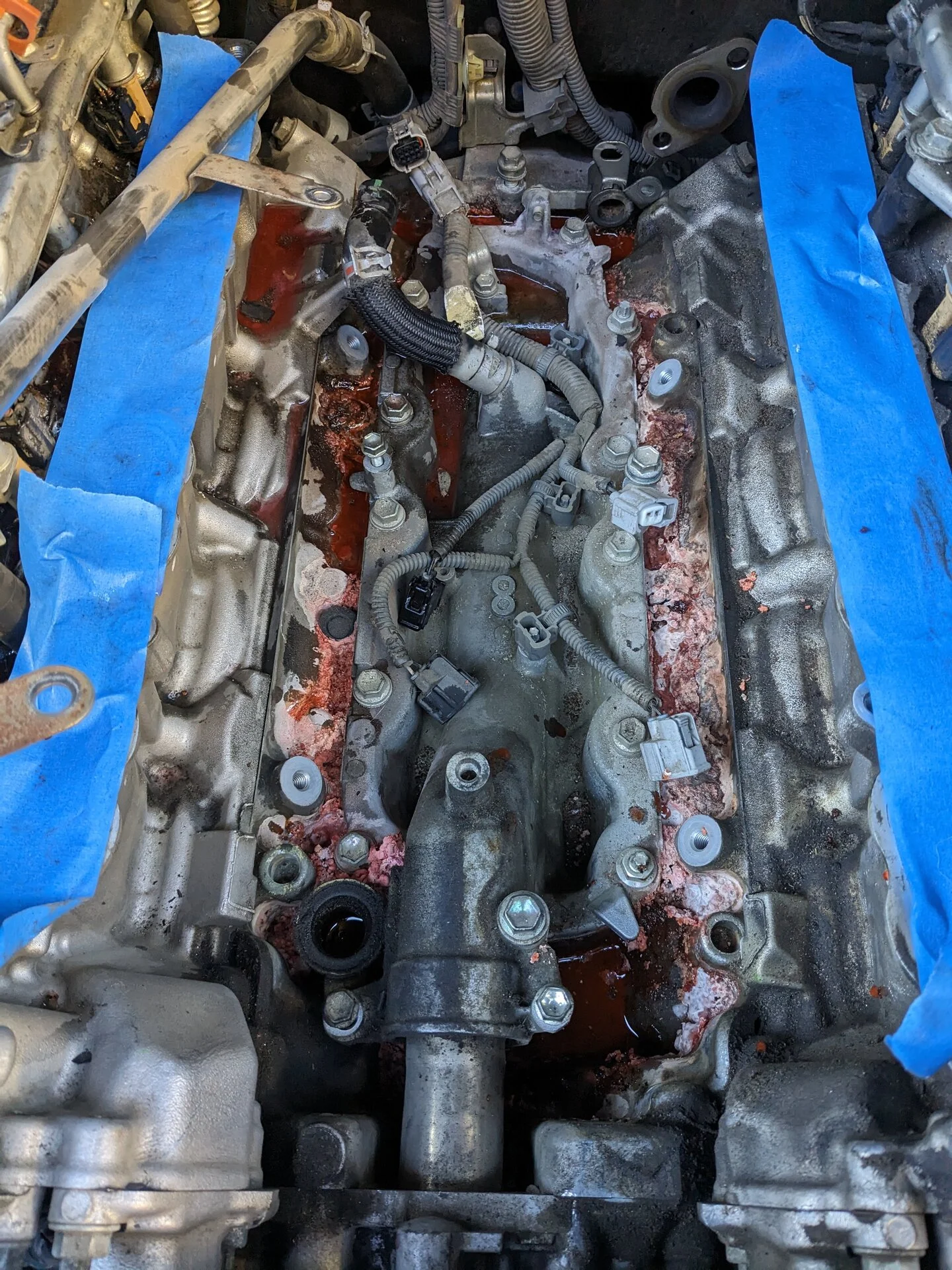

Then the dreaded valley plate leak struck.
Took that opportunity to replace the entire cooling system, new radiator, water pump, thermostat, and all kinds of hoses

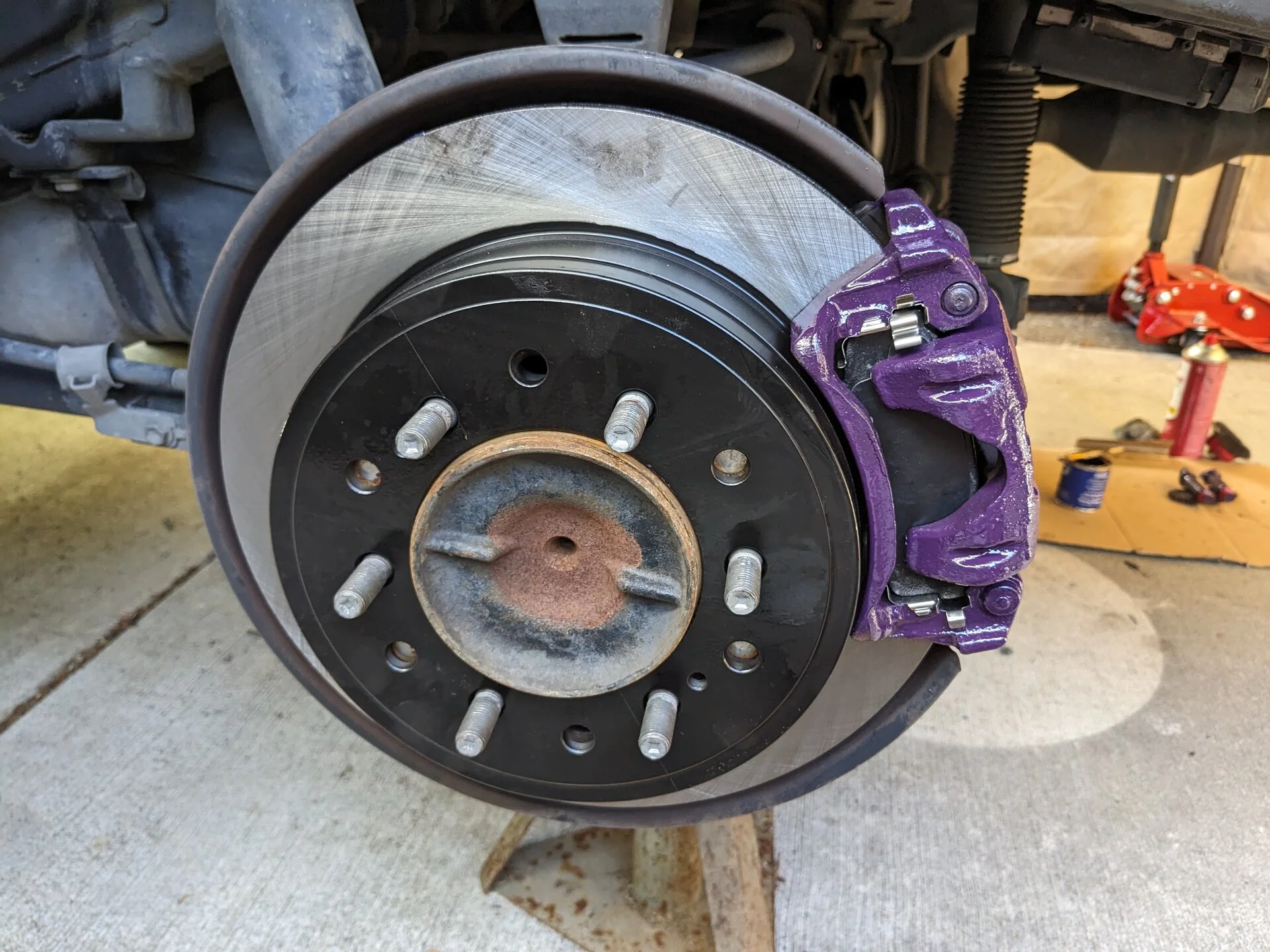

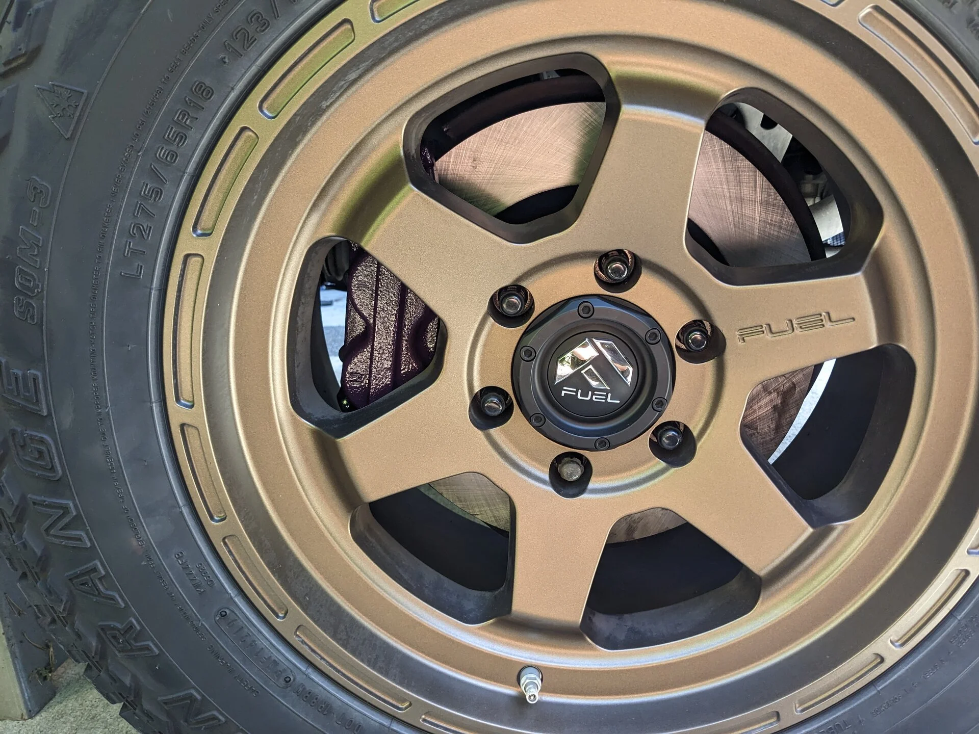

Since we had it ripped apart anyway, I decided to do a few other things while I was waiting on parts. Brakes are easy, and the wife likes purple, so blam.

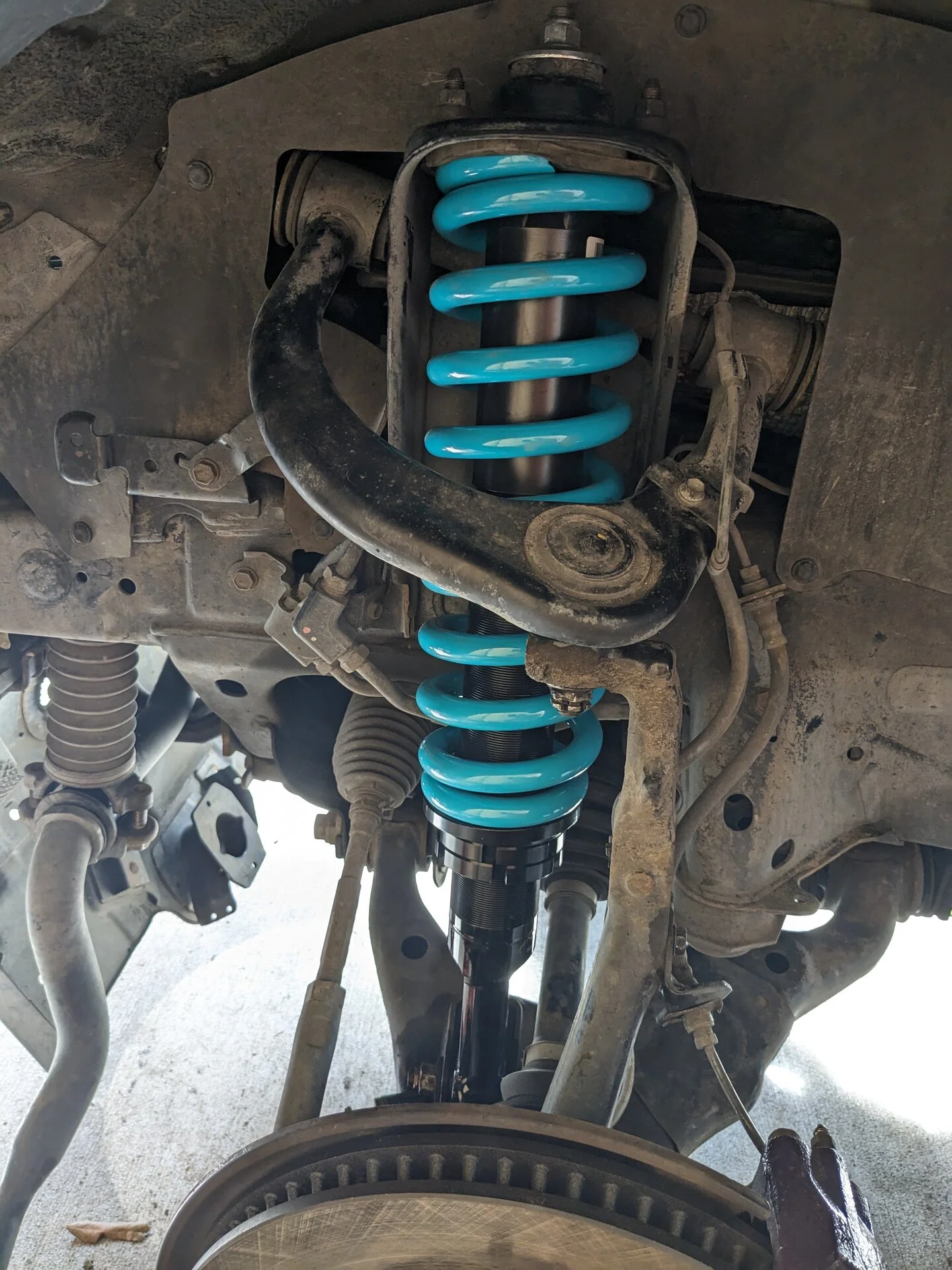

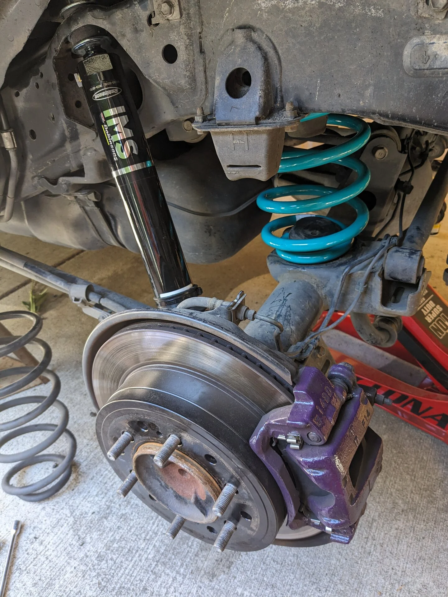

Then I thought, well, the wheels are off, so why not lift it.
So on went a Dobinsons IMS with the heavy duty springs

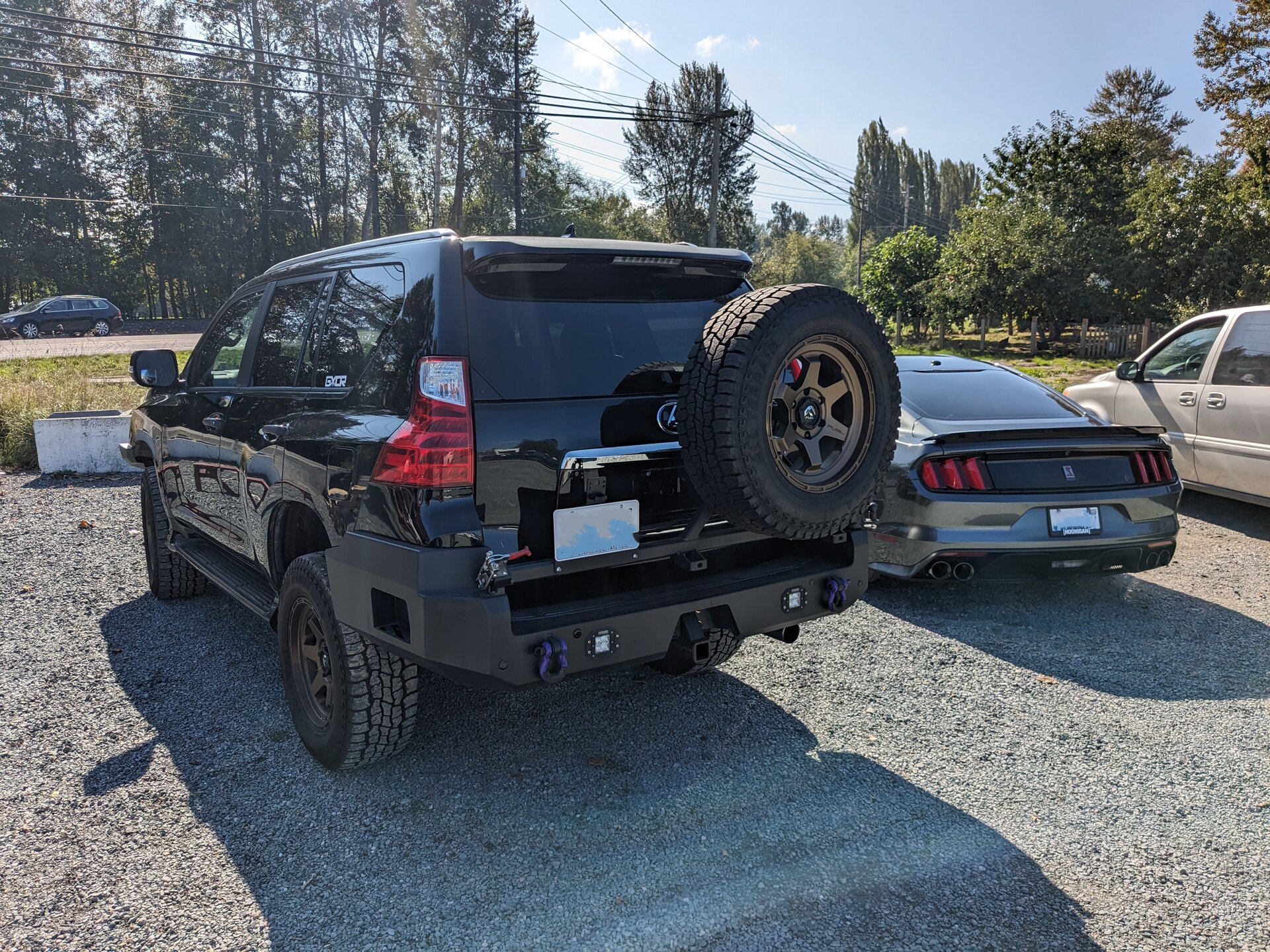

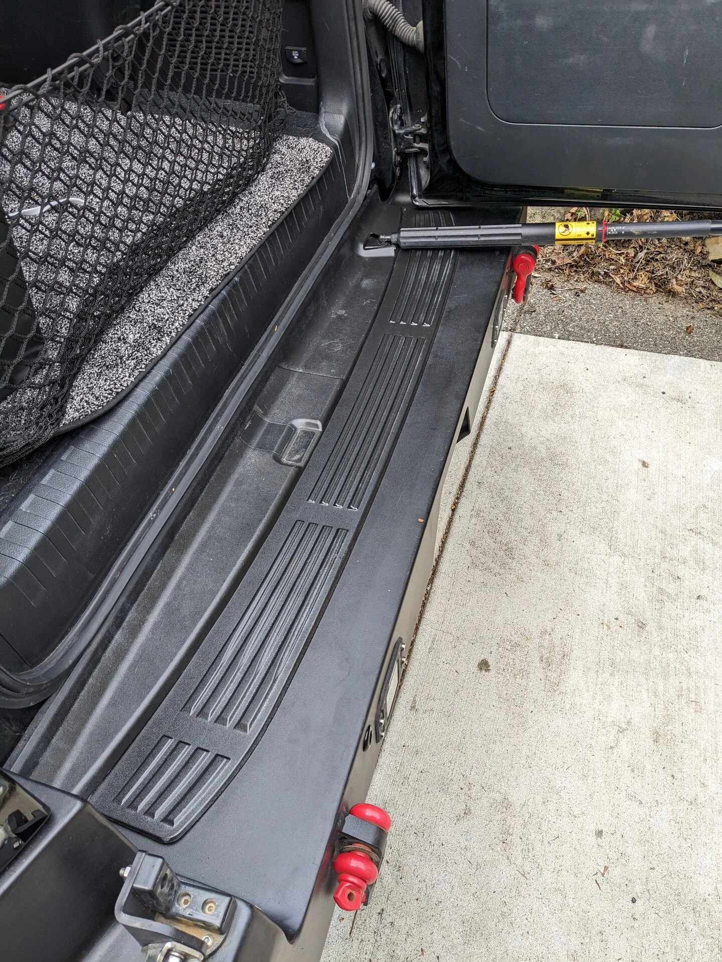

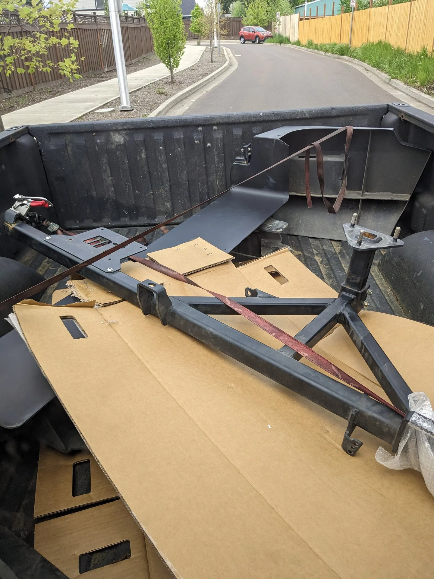

And those springs would be a waste if they weren't carrying anything. Found a clean used Metal Tech rear bumper with the swing out, and scooped that up.
With a swing out spare, that also meant that I had to get a matching wheel so the wife could flex on the poors at Starbucks. That hurt my soul a bit, but again, do the kids really need collage?
I was happy with the way I was able to adapt the rear OEM bumper trim onto the steel bumper, makes the back look much cleaner when you open it.

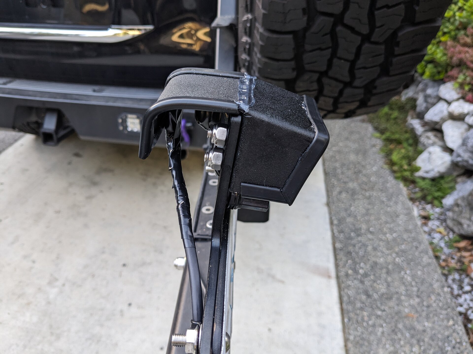

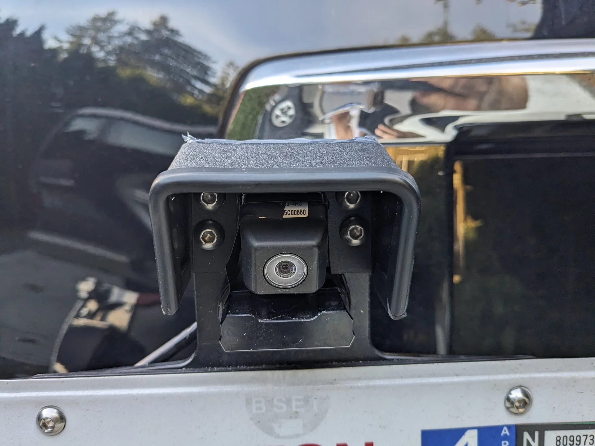

Rear view camera was blocked, so I fabbed up a cover and mounted it with a plate bracket from Amazon. The plate bracket has a light too, so that made things easier.
The center hole needs to be bored out slightly, then the OEM rear camera fits.

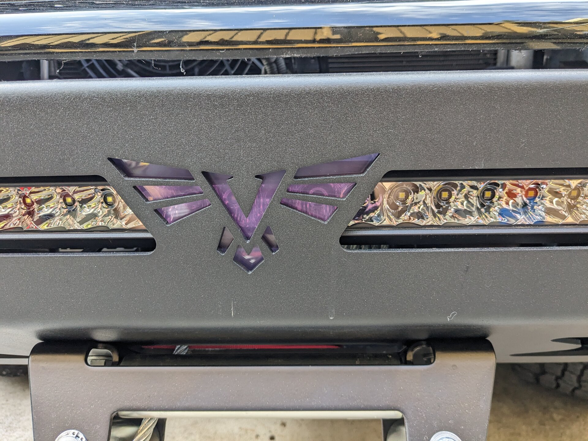

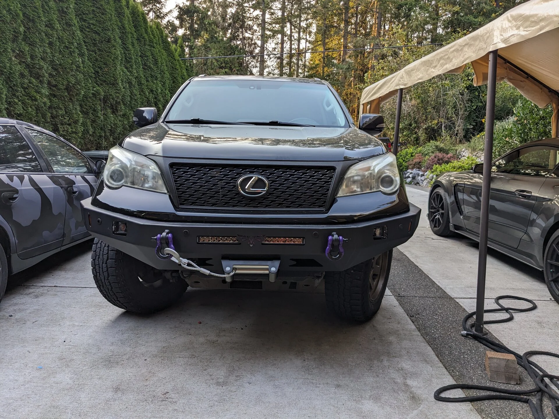

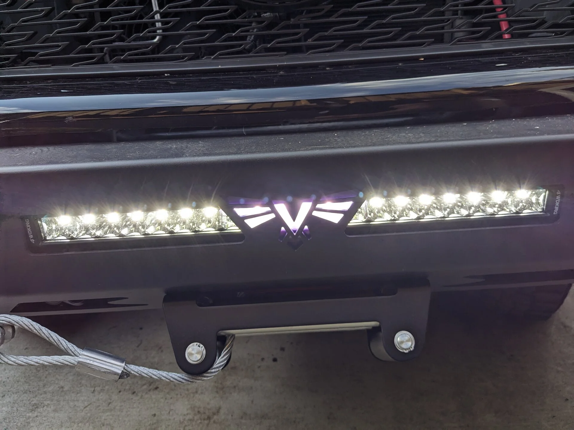

The rear bumper was lonely, so I hit up Victory for a shiny new front bumper as well.
Cutting the front bumper cover was a little nerve wracking.
Did I mention that my wife likes purple?

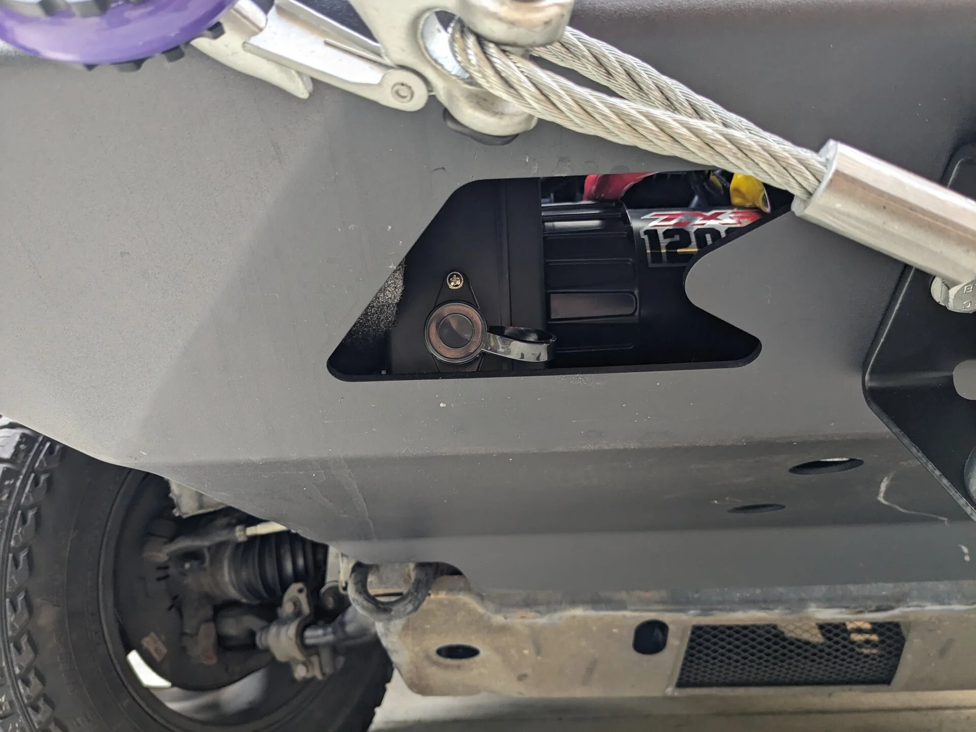

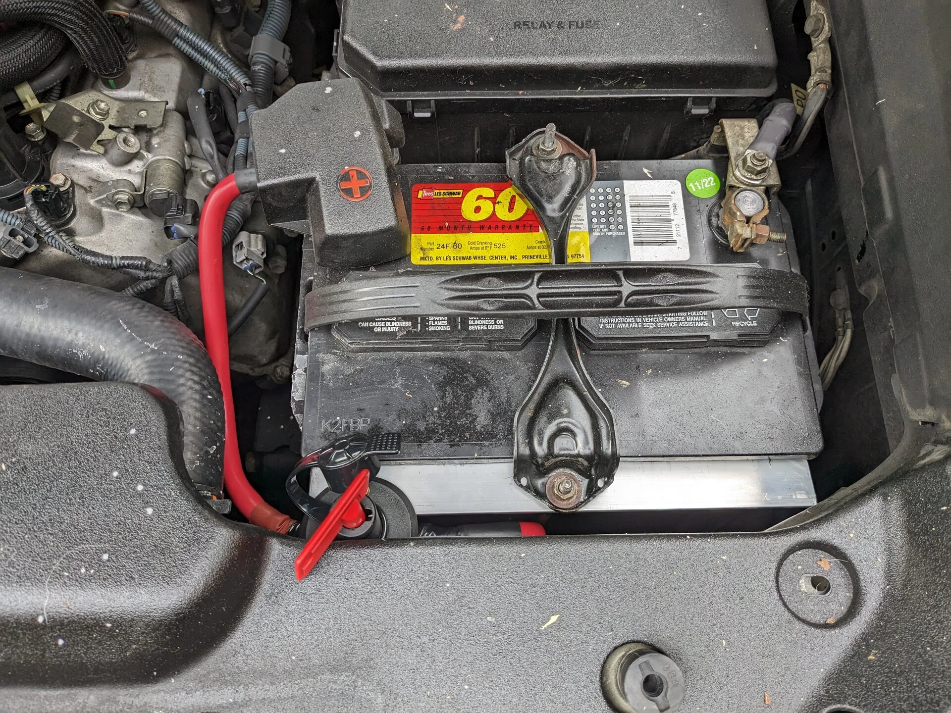

I had a badlands winch laying around in the garage, so I tossed that in. Wired remote access through the front bumper, and a keyed power cutoff at the battery.

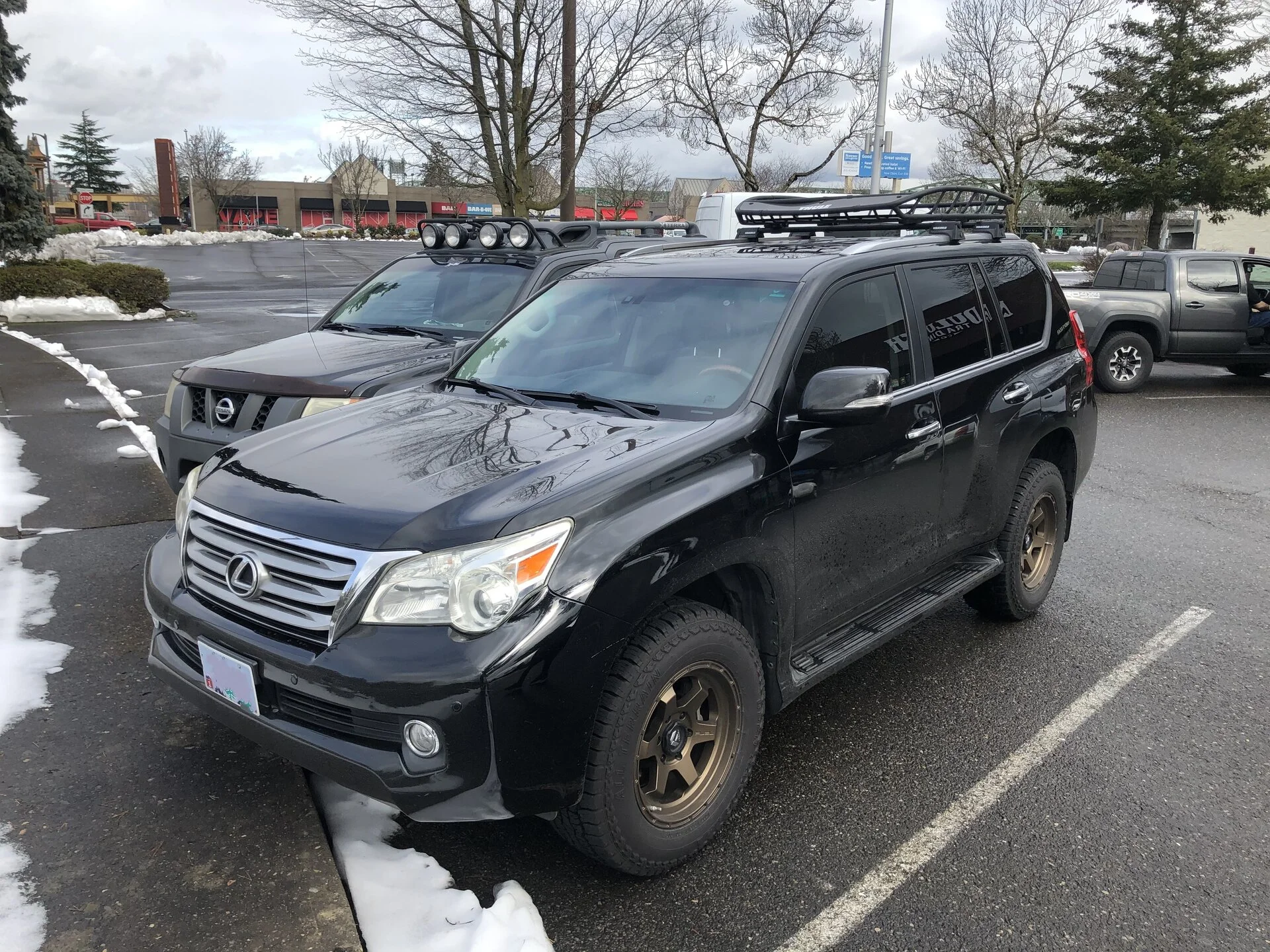

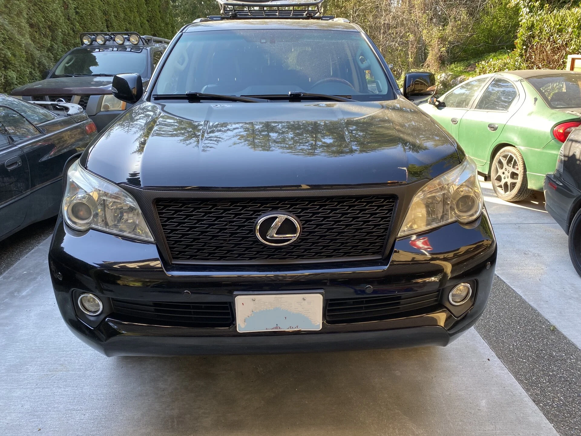

Need a couple of beauty shots of it with all your mods.
Side, and three quarter views?
Awesome stuff so far. How's the build quality on the Victory rear bumper?
Have to throw this here in response to the way you wrote up the build:
The rear is metal tech, the front is a victory. I'm pretty happy with both so far, they both went on well and mostly straight. The metal tech rear was slightly tweaked, but the previous owner smacked it pretty good and I knew that when I bought it. I'm probably the only one that would notice it.

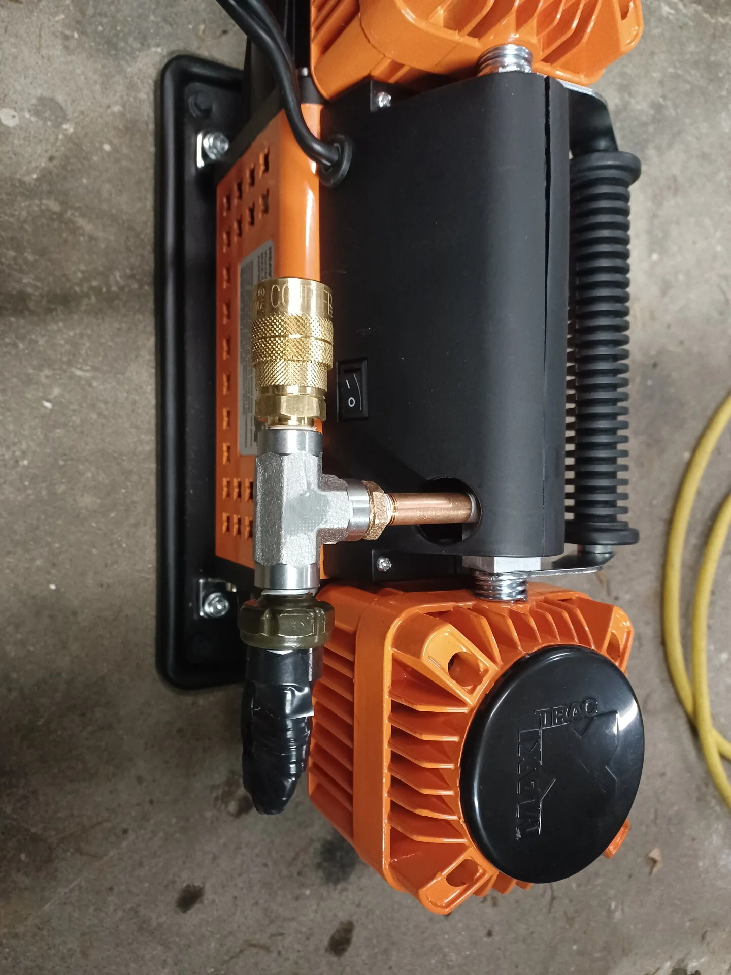

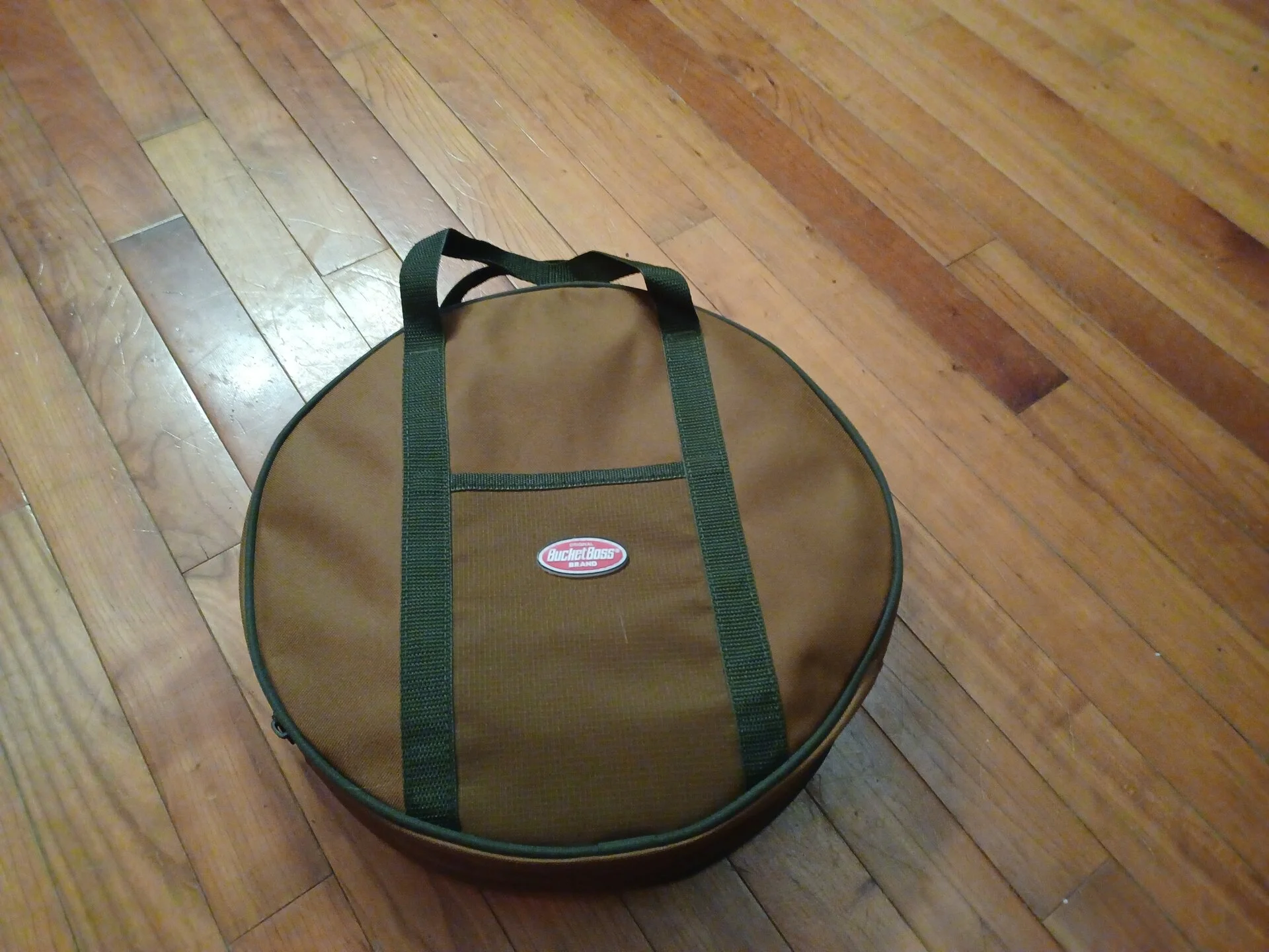

When you have multiple rigs, you don't always want an onboard air compressor. Built this setup a while back, goes in the off road kit.
Maxi Trac air compressor modded with a standard QD fitting, better wire, and high pressure shutoff switch

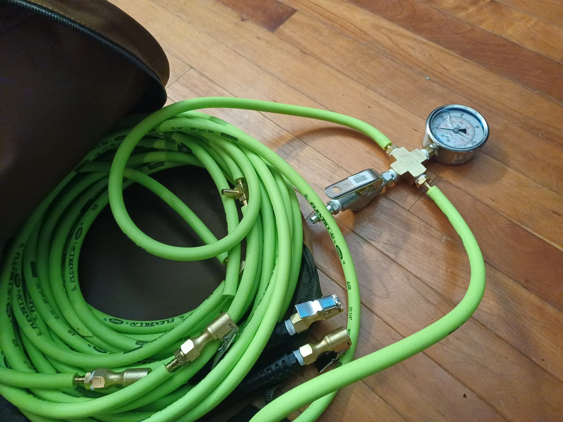

And a four way inflate/deflate setup with a liquid filled gauge and a bucket boss bag to keep things organized. It does have hose clamps, I bought the wrong ones initially and was waiting to get some more when I took that pic.
This setup allows me to inflate 1 or all 4 tires at once to any pressure, and deflate any or all to any pressure. The other cool thing I can do with it, if the air compressor dies and you have one flat, you can hook up the lines to all the tires and it will equalize them enough to drive on with no power. I've used this for the last couple years on all my rigs, and it has no problems even when I'm filling the tires on my HD truck up to 80psi. I've also got a couple of other fittings for inflating or cleaning, and a smaller hose dedicated for random work. The high pressure cutoff switch is probably the best thing I did to the compressor, keeps it from winding itself out at high pressure when I'm working on stuff.

I built my own 4 tire inflation system also, but I used these Haltec valve chucks.
They are way more secure than the ones you presently have, been there with those other chucks. Also, these chucks will shut off the air when you remove them from the tire so you're not loosing air from the other tires when you remove one of the valve chucks.

When you order them, be sure you get the ones that have the shut-off valve in them other wise when you pull the chuck off your valve stem, you'll still be blowing air out from your airline, whether it's straight from your compressor or to three other tires, you'll lose air.
Haltec has the same chuck with flow through and they look the same.

These have the air shut off in them as well. Those chucks look pretty solid though to. If I break these (im a few years and a BDR into them with no problems), I'll check them out

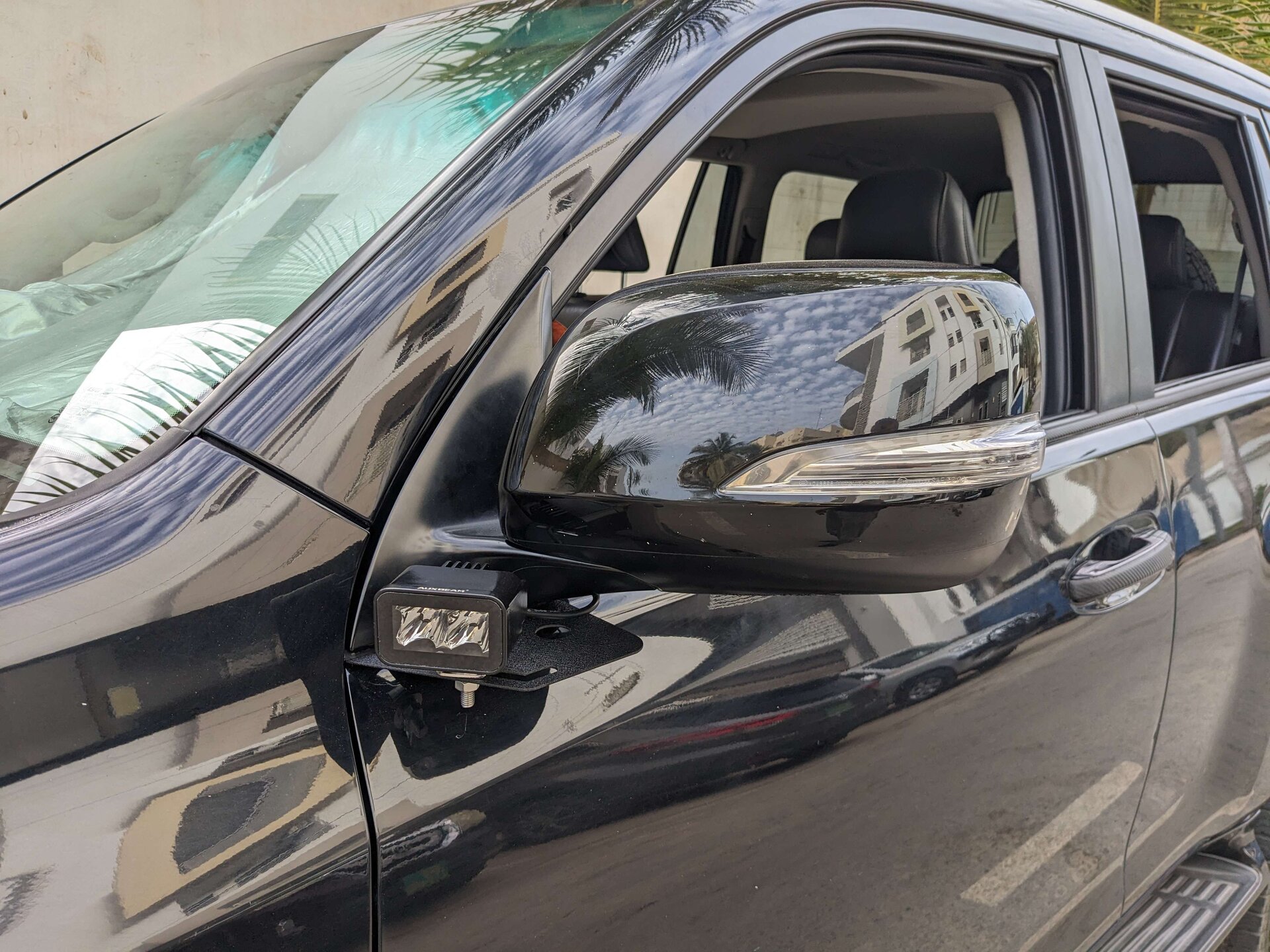

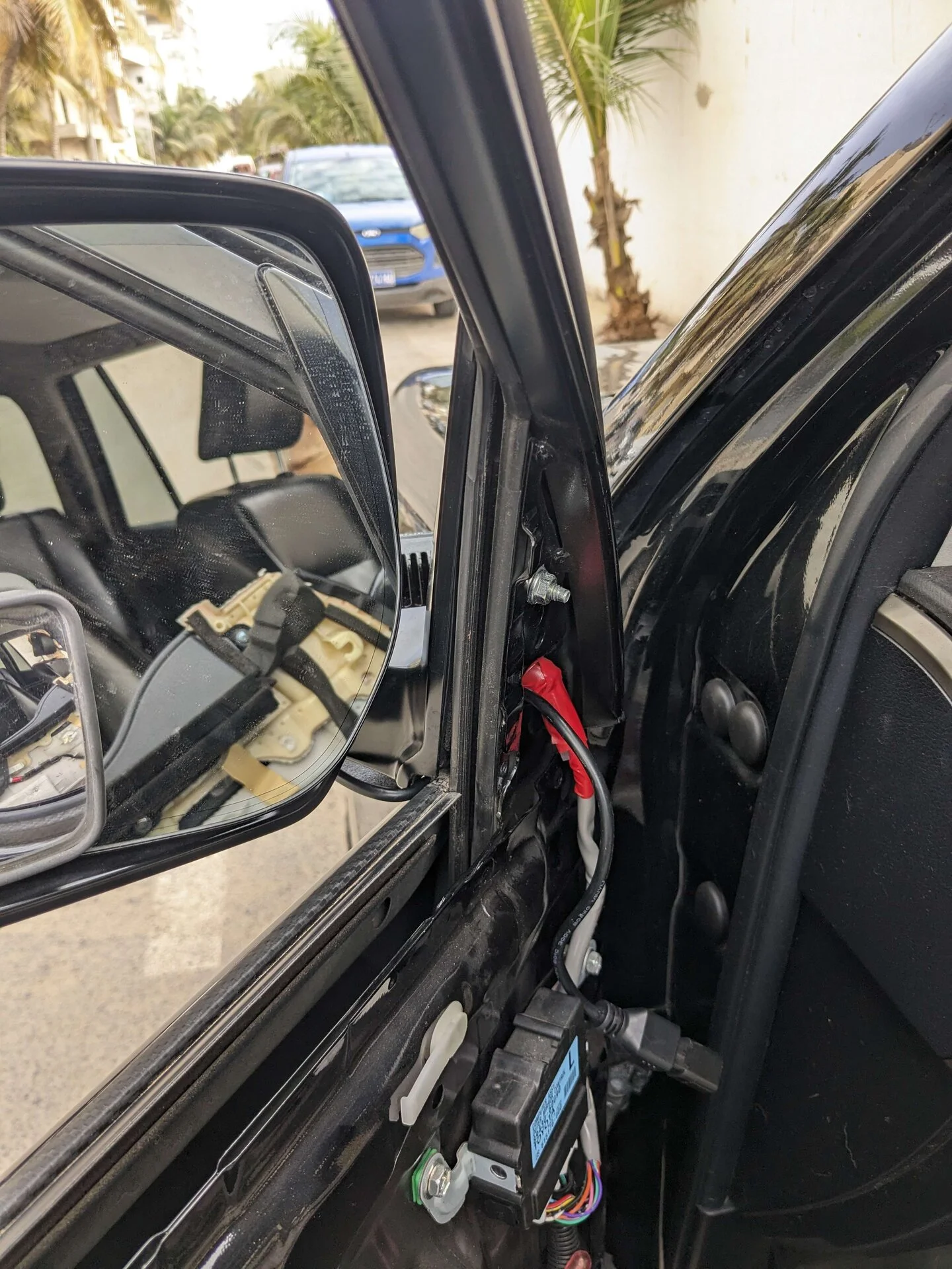

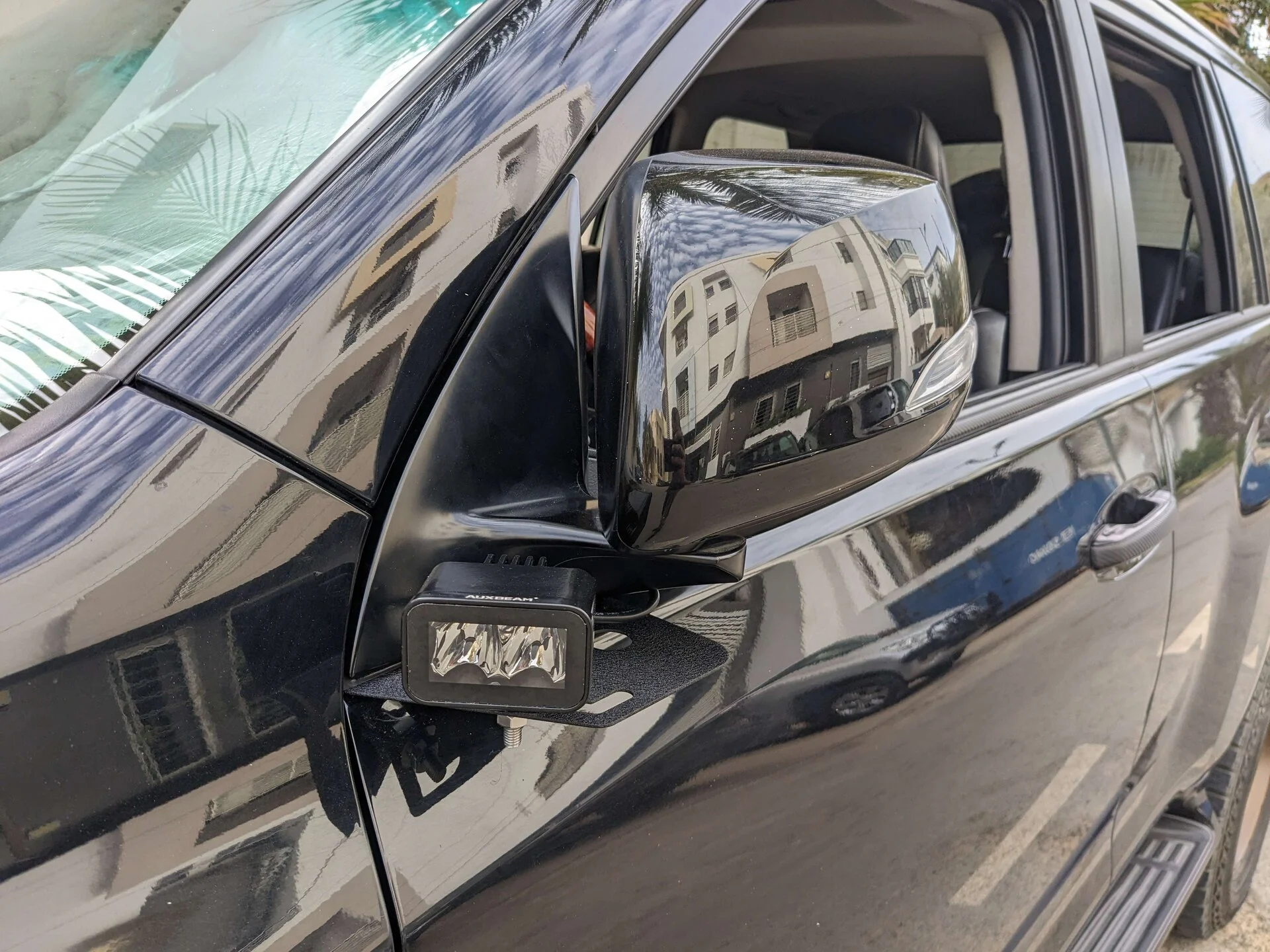

Ronin Metal works ditch light brackets
I am not a fan of glare, so hood mounted ditch lights are not on my list of things I wanted. But then I saw the brackets from Ronin, and figured that I would give them a shot.
The good: Nicely cut and powder coated part. I wouldn't have minded if they were a bit smaller, but these will fit a variety of lights.
Also, everything is tucked nicely around the mirror, even when folded.
The bad: This isn't Ronin's fault. The clearances on all these parts are very Lexus. You probably should cut a channel to run the wiring behind the mirror housing, I just didn't torque it down all the way. Sub optimal, but I don't have access to my regular shop. Also, running the wiring through the door is going to suck, I need to source some odds and ends to do it right, so it's going to be a bit until I actually finish the install.

Looks like lots of lighting options from the top picture showing some unused slots.
