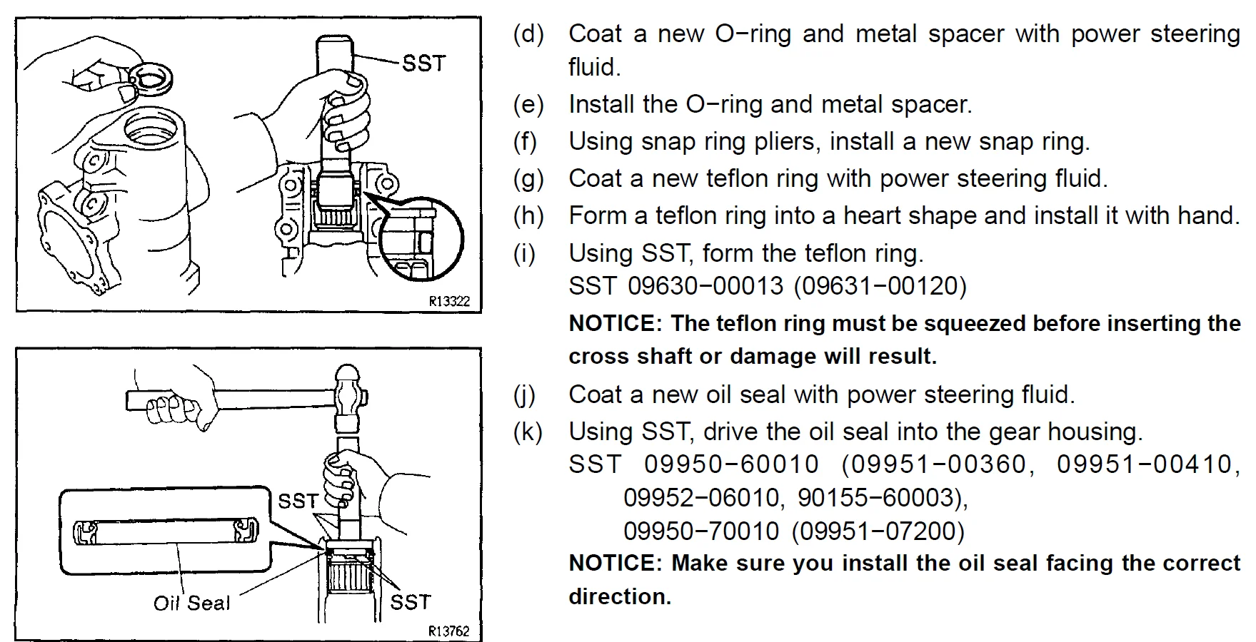

This is kind of off topic for this build, but those worm gear Teflon seals that don't come in the rebuild kit, what exactly do they seal?
I rebuilt a basically perfectly good box thinking it would fix an issue I'm having with a power assist ram extending with enough force to cause a drift to the right when driving, so my suspicion is maybe those Teflon seals on the worm gear.
If that's the case then I guess a new valve assembly is on the list for me 😔

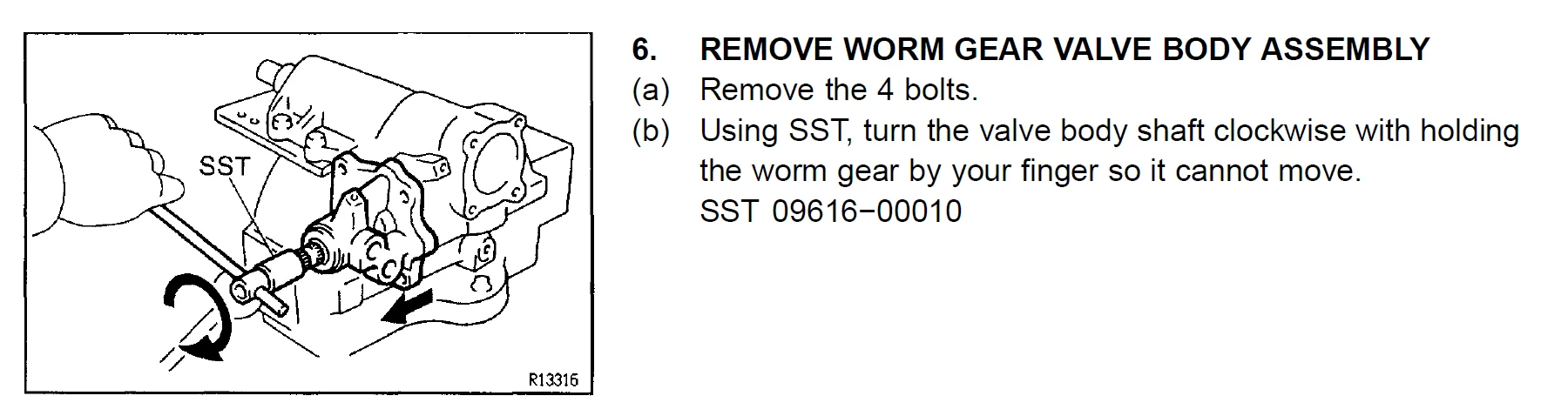

Getting ready to do this myself. Is there a part number for the shaft nut SST?? I can't weld or i'd just make my own.
You mean this one?
...or this one?
Not having done this, I can't tell if the nuts are the same on the 80 and 100 series, or not.
@OGBeno would know
There appear to be a plethora...
...of SSTs, I mean.

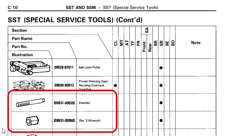

If you mean the ine at the top for adjusting backlash. I have always just used my fingers to tighten until the bolt does not spin freely and back off a little. Then stake two sides so it doesn't move.
I can't for the life of me find my FSM right now. I'm refering to the one that box rocket made by welding a nut to a socket in the original posting.
PM me your address and I’ll send you the one I made.
Really??/ that would be fantastic... thank you
PM sent
This is what you're looking for:
They are both included in the set above them, in the list.
He beat me to it
Anytime
