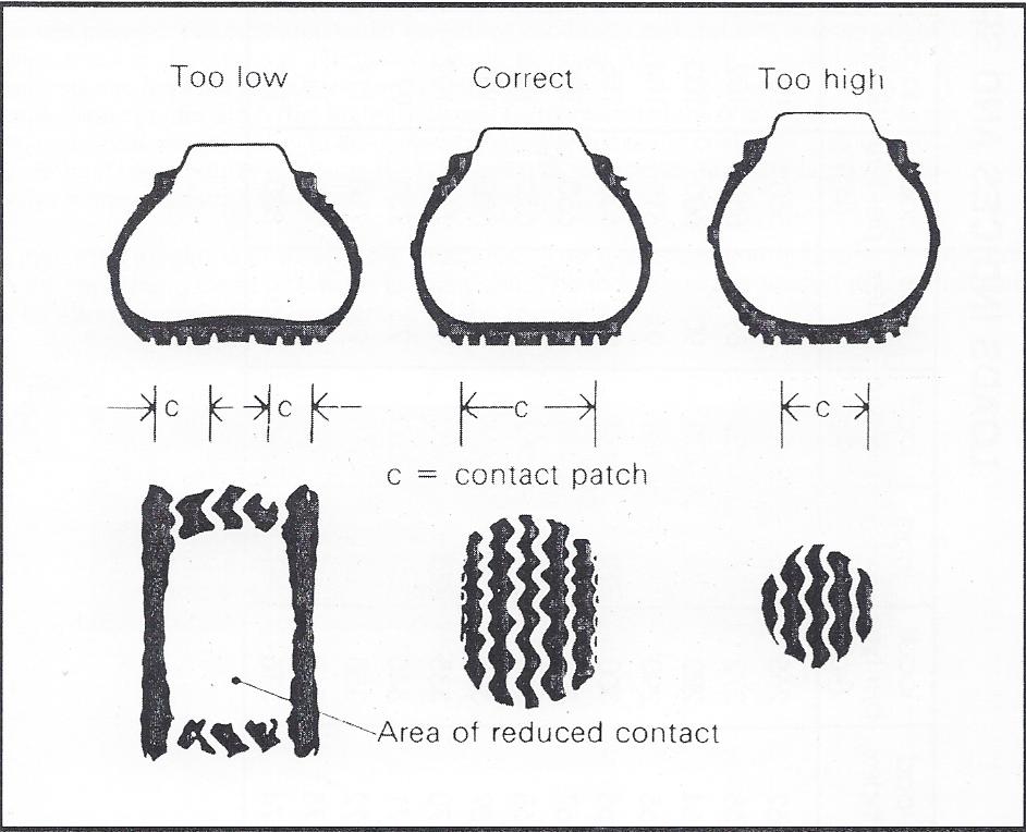

Your tire PSI should be based some where in the vicinity of the vehicle manufacturer and what provides a correct contact patch.
Such as in this simplified diagram.

Your tire PSI should be based some where in the vicinity of the vehicle manufacturer and what provides a correct contact patch.View attachment 1720315
