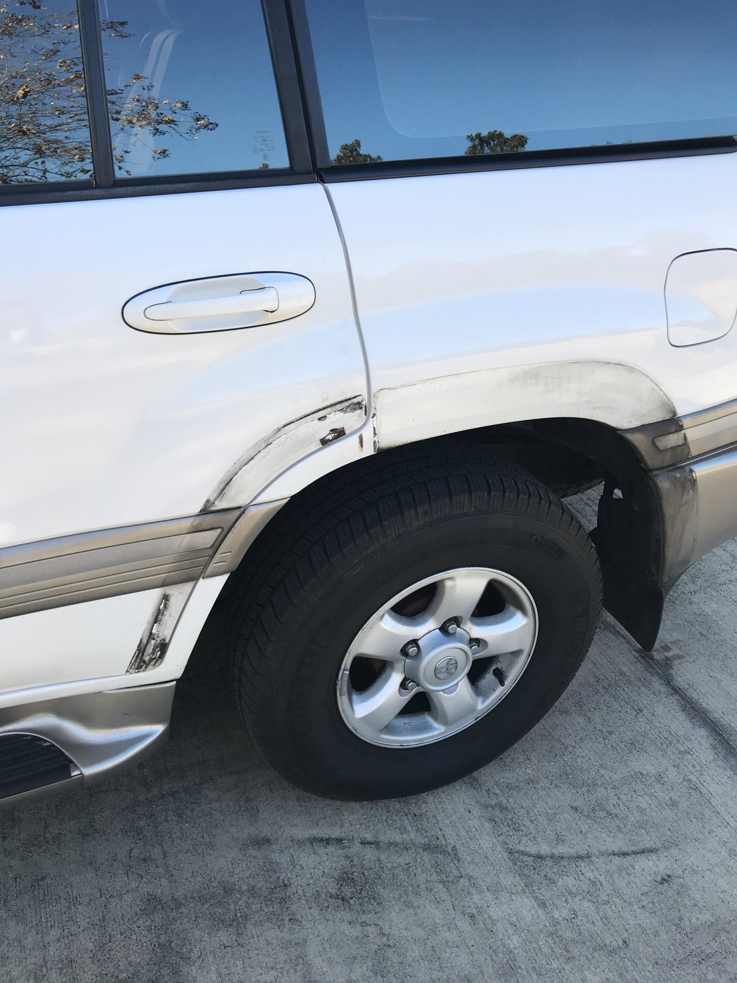

Pulled fenders finally. Got dark as I finished cleaning/ washing. Need to buff some more and paint one bad rub spot.
