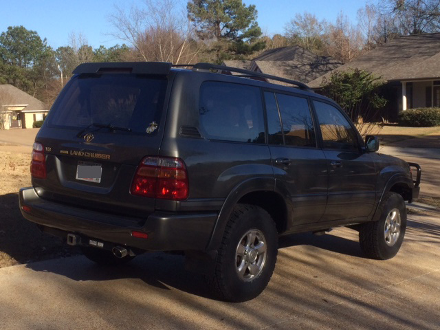

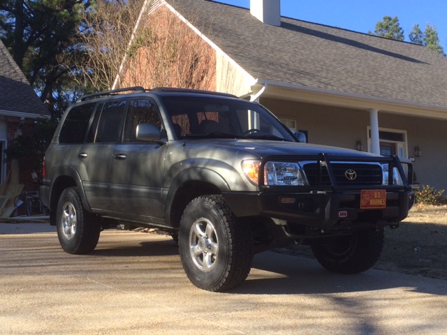

Another satisfied 49Tire customer. Picked it up today. I ordered the "Starbucks Poser Package." OME, Ironman FCP, Dueler ATs, ARB bumper. Spouse did not mind the lift too much. She just has to get a running start. Great job gentlemen.
Thanks for the business!
