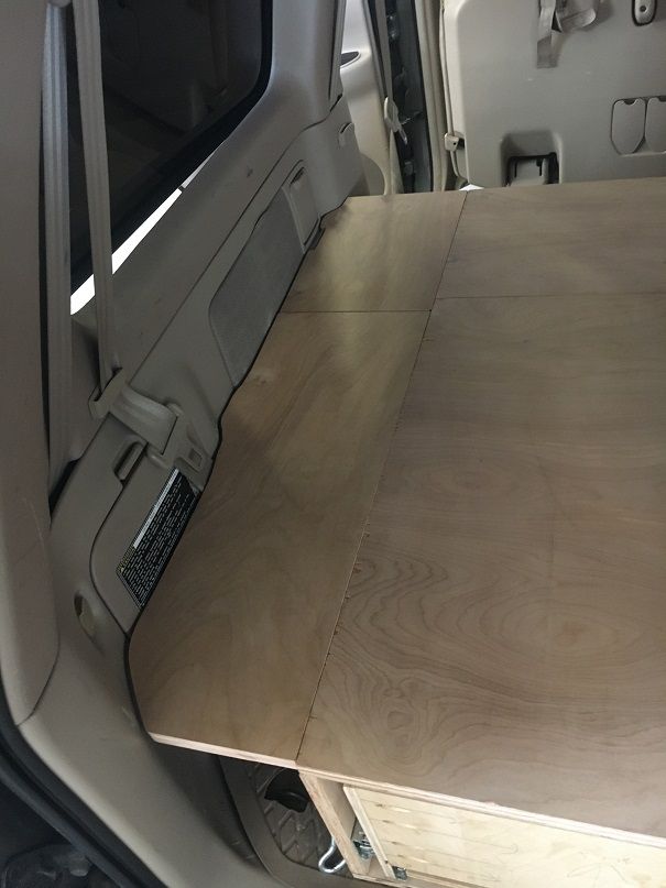

I decided to go with two identical drawers, a hatch accessible by the rear seats, and wings that can lift out for easier access to storage. Going with the stout method, I used 3/4 birch plywood for the entirety. It's not light.
Initial assembly:
My measurements were 40Lx42.5WX11.5H.
Second step was drawers. Again, they are 3/4 birch. Heavy enough for the gold bars I am going to store in there. I wanted the interior length of the drawers after assembly to be 24 inches. I got 4 beefy 24 inch sliders from an overstock/damaged packaging store for 1$. One set is TCH, one set is Accuride.
For the rear hatch I wanted the panels to lift out. I got some strong magnets and inlaid them to the box and the lids using epoxy. There are six magnets total in each lid. It's plenty strong. No sliding around. Fully accessible hatch.
I wanted the hatch to have some length to it to fit longer items. I will likely throw our mattress pad/bedding in there so there will be no need to get access to it when you are set up to sleep
I also made the box a bit higher than some of the other ones I have seen. I plan to elevate the middle row of seats somehow to make it as flat of a sleeping surface as it can be.
Onto the wings. I was conflicted on this... Whether to do hinges or lift out magnets like the hatch lids. Ultimately I think I will do lift out again for easy access to storage.
On one side I split the pieces into two, kept it one solid piece on the other. Not for any reason... I just wasn't sure what I would like more.
Cut them with a jigsaw and finished them on a spindle sander.
Got a start on the front face. Next step is drawer fronts.
2 things I've been trying to decide are which latches to use and what to finish it with. I am leaning towards some sort of bedliner.
