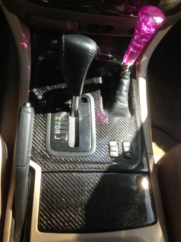

Well it does lower the tcase lever...actually the 1in is quite noticeable and at least on my truck makes shifting the tcase lever a bit tougher...nothing I would complain about but definitely different than stock.
I agree with the above which is why I'm looking for a 1/2" kit. No way would I be happy with unsightly gaps, especially with stock tuperwear bumpers. I figure I can cover 1/2" enough by slotting the stock mounts of the bumpers.
I'm also assuming that the transfer case lever will drop down by 1/2" or 1" depending on the body lift?

I'm also assuming that the transfer case lever will drop down by 1/2" or 1" depending on the body lift?.
Fortunately, they make an extension.

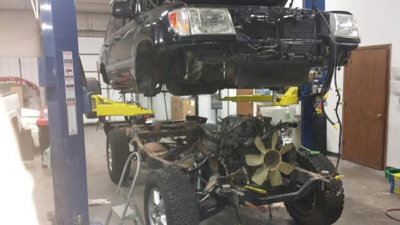

1" Body Lift is done. It was a pretty big undertaking. Doing the actual pucks is no more than 30-60 minutes, everything else is an 8 hour job. I see no reason to even attempt this by yourself. It's a 2 man job, but only for the lifting, puck install, bolt remove/install and generally someone to go around and check for things that might be binding. The steering spacer and radiator brackets are a one man job, but time consuming. I actually have not done the steering spacer yet, but very badly need to. The lowering of the radiator is a chore without removing the main battery and tray. I would remove them both if I had to do this job again.
Couple notes...
If you run the newer style Slee battery tray with the extra bracket, you need to remove the brake line bracket where it attaches to the UCA on the passenger side. There is not enough play in the line to stretch around the bracket. I'll post some pics and a write up as soon as I can. I just removed the brake line bracket, opened the folding tab, fed some more line through and reattached after the lift was done.
Also, Remove the radiator brackets/bolts prior to the lift. Just let the radiator sit there unattached while you raise the body.
And don't forget to remove the bolts for the steering linkage below the rag joint. I did not do this, and now I'm scrambling to figure it out. The 2nd intermediate steering shaft is touching the body where it goes through the firewall, and it sounds/feels like the wheels are falling off. I'm not 100% sure about adding this spacer now that the lift is done. Maybe someone who's done it can chime in.

If I secure the steering wheel (I need to turn the wheel to access the bolts that go through the rag joint) and separate that joint (I have to cut the hard black boot to access the nuts and add the spacer) will I be able to push the steering shaft down and in towards the rack to make the necessary gap? And, should the shaft be matchmarked, or will it not spin once free?
Hi, thanks for the right up.
Yes match mark the steering wheel and be careful not to turn the wheel. The shaft should move fairly freely once unbolted but, yes unbolt the linkage prior to the lift and its a lot easier.

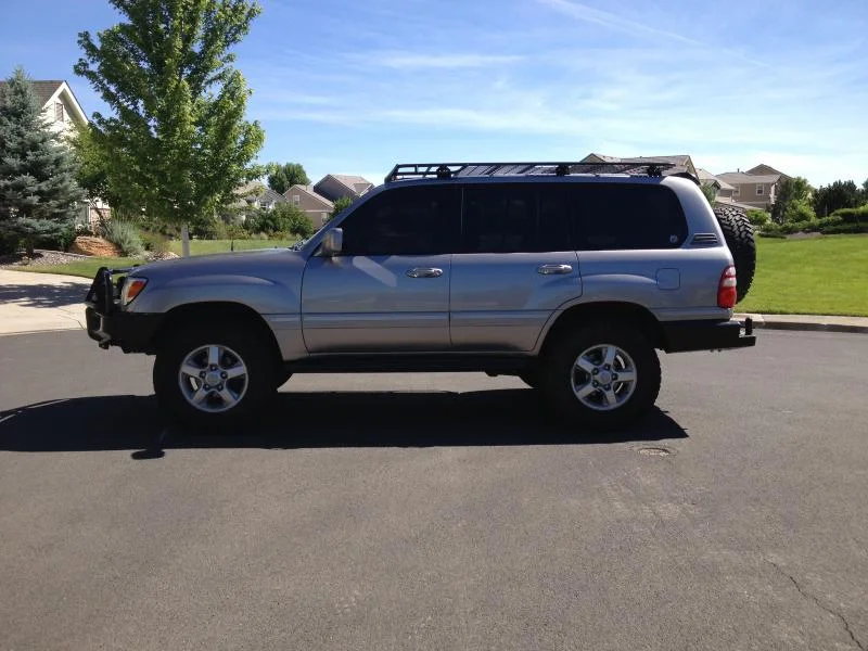

I have some pics to post. Just been really busy. The after pic looks just like the body is 1" higher ;)

.5" or 1" is dependent on what you're doing I guess. This is not something I'd want to do twice, so the 1" was the way I was going. I think you'll see less issues by just going .5", but if you're running 35's that may not be enough. It really is an all day job. Maybe if you do BL's on 100's for a living you could get it completed in 4 hours, but there was no way I could do that. If I would have taken pics at every step, I would have been 12-15 hours. It's a lot of work..... not really difficult work, but time consuming work. Maybe I'm just slower than most. :meh:
I do have a bunch of pics to share and I hope it will help the next member out. Thanks to Spresso for being one of, if not THE first person to do this stateside. Its a big undertaking when you're not sure what will clear and what wont. Bluecruiser helped me out by telling me to stop being a fruitcake and just start taking things apart, and Jonathan for texting me every day to find out if I did it yet. Its pretty unnerving to see the body rise away from the frame and hope that nothing breaks, just pay attention to what's happening and don't rush. That's how I found the brake line issue with the aux battery tray.
As far as driving afterwards. I don't notice anything except the aforementioned steering issue (which is pretty bad) Looks wise, there are gaps at the bumpers and sliders. I can adjust the ARB and the sliders. The Slee bumper will need to be removed and cut. I'm *considering* doing that to improve the departure angles.... but that Slee bumper is perfection, and I don't know if I want to mess with it. I have an 80 series buddy with a new super duper plasma cutter and he's begging me to try it out. I don't know if I mind the aesthetics of the gaps, but gaining an inch of height on the bumpers would be nice.
A full write up with all the pics I have is coming. Here's a before/after.
