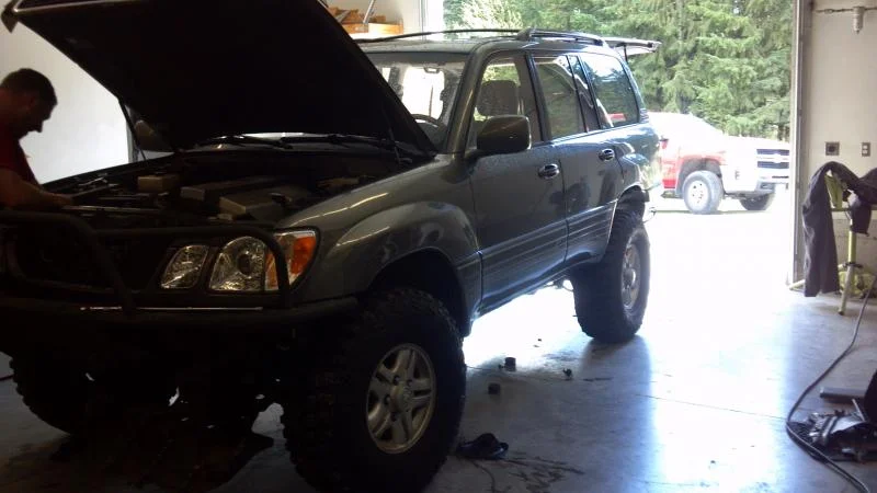

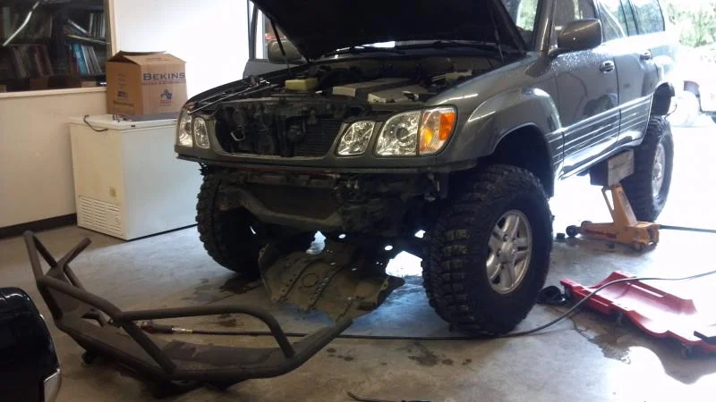

Apounder was kind enough to provide his Land Cruiser/ LX470 for a body lift test fit.

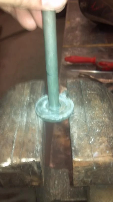

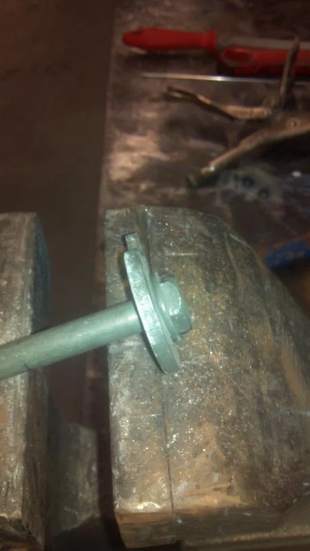

We already have a body lift available for the 80 series, a 1" and 2" and it is the only complete kit available, including radiator drop brackets, steering extension and transfer case shifter extension.
http://jonesysautoclub.com/shop/product-category/offroad/jonesys-off-road-featured-products/

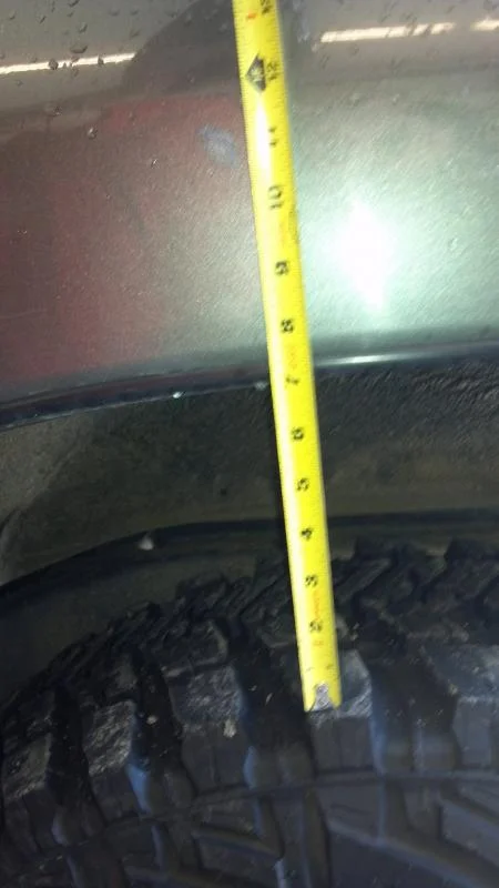

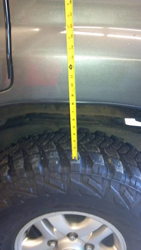

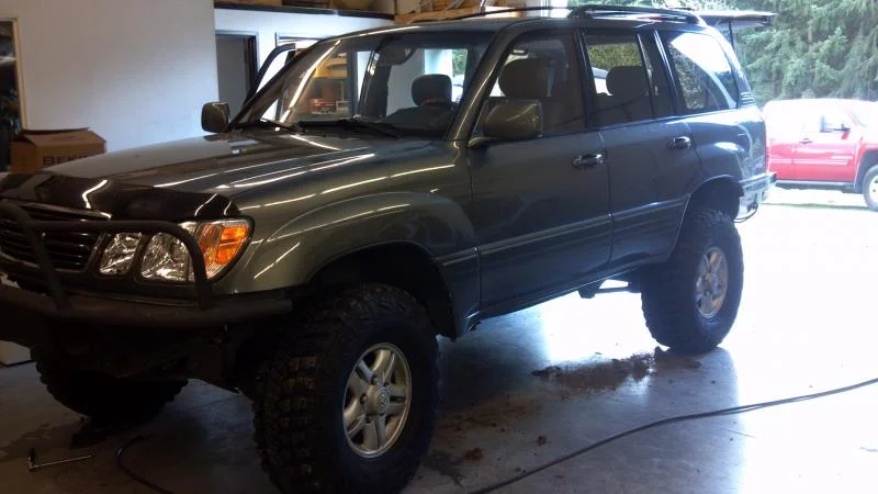

Apounder was very interested in a 2" body lift but, we were only able to achieve a 1" BL. While it is less than our original goal, the 1" yielded great results.
This is the only 100 series BL lift kit available, see what is included.
  • Heavy Duty Standard Hardware, standard grade is stronger, and cheaper (for you and us)
  • Rust free polyurethane pucks
  • Black Pucks, because who wants bright white pucks under their truck!!??
  • Large pucks for greater contact surface area
  • Aluminum steering extension
  • Annnnd RADIATOR DROP BRACKETS!!

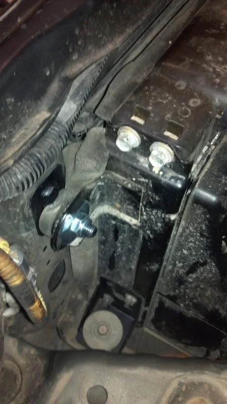

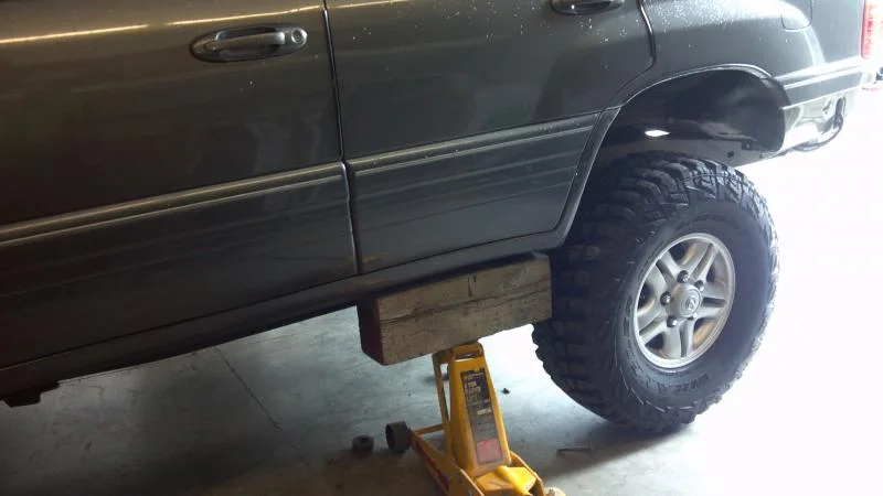

Paflytyer has graciously agreed to document his install. I apologize for not taking more photos of the install, it was done and over with before we knew it.

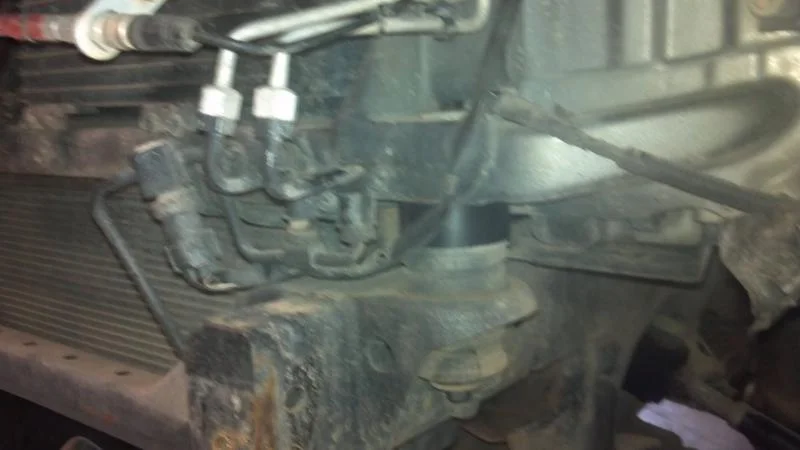

I'd say this is an easy install, the only issues are the interior trim panel clips and removing the front two seats. The radiator drop brackets are very exposed but, you may need some help holding the radiator to install brackets, its a juggle.
That's about it. Maybe a 4 hour job with a friend?? :cheers:
