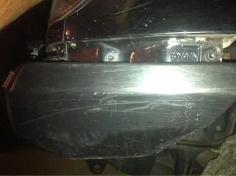

anyone have upclose pics of what the body gap looks like with respect to an ARB/ BIOR bumper or maybe even a stock bumper? Apounder's bumper is a one off so i can't really get the proper reference i want.

Not super close-up, but it is what I have on my phone. I have the BIOR bumper.

That gap looks like hell, I would have to do something. Too bad the body lift doesn't come with a kit to raise the bumpers 1" as well.

On the Ironman there is both pitch and height adjustment. Not enough to cover 1", although you could slot it to cheat some more space. My guess is that slotting would work on ARB and TJM as well, but not on BIOR or Slee.
It's not a bracket issue. Most aftermarket bumpers would require major surgery to return the gap to stock. Cutting and rewelding while adding material. Slee, BIOR, ARB, Ironman all would be similar. I've studied my Slee bumpers extensively and there is no way to do it easily.
Agreed. I have thought about it, and looked at the ARB mounting system. It's doable, but would be a pain. I can deal with a small gap, but not 1"+.
i think i can deal with the gap if i knew of a type of rubber moulding/door seal that i could place there.
The cool thing is you can see the Toyota stamp that most people don't know is there. ;)
