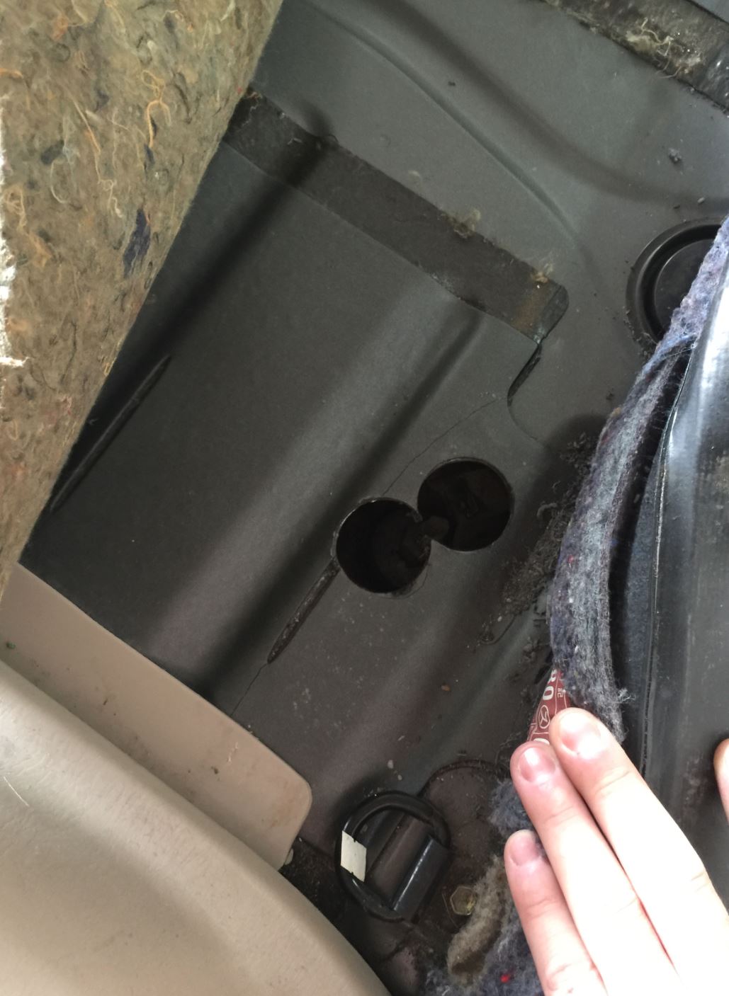

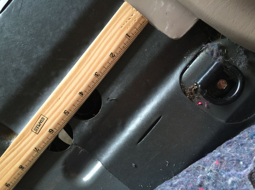

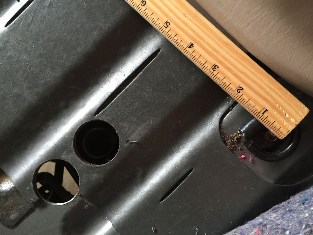

I wanted to share my experience based on the info on this thread. On my 98 LX, the dimensions were a little different:. It definitely made the job super easy!
Driver side:
About 4 inches to the rear from the front tie-in loop and about 4 inches towards the middle of the vehicle.
Passender side: 3 inches back, 5 inches in
Passender side:

Completed the new shock/spring instal over the weekend using the holesaw method.
Didn't do any measuring, just eyed the pictures in this thread and drilled the second rib in from the side and bingo - straight above the top nut!
