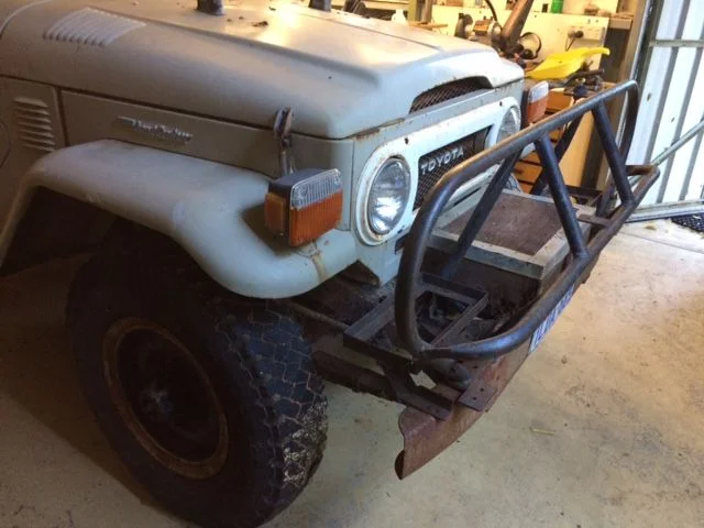

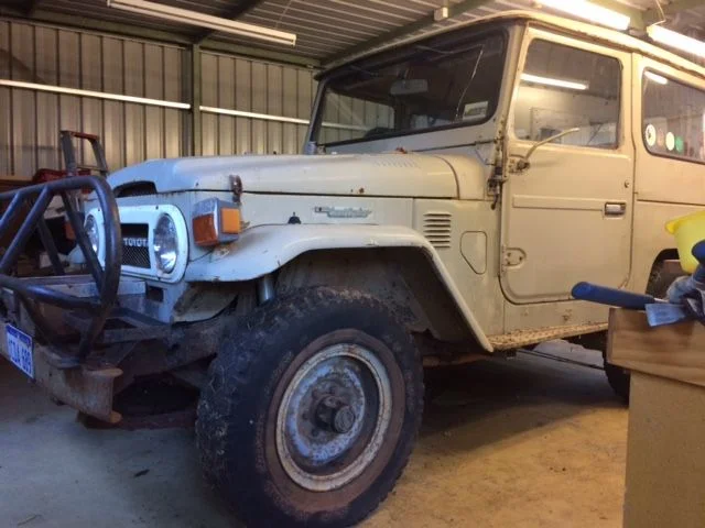

I was lucky enough to pick up a 10/74 FJ40 in June of 2017. It is my understanding the truck spent most of its life in country Victoria but the last ten years in Perth, Western Australia.
After a months reading this forum, tinkering along I thought it was my turn to document my progress and open it up to all the contributors for any tips, hints or lessons learnt you may want to share.
When I picked her up, she wasn't running and hadn't for 2 or 3 years. Thankfully the PO also gave me the Haynes manual
My first aim was to get it running... and stopping. I was pretty surprised at how quickly I was able to achieve this.

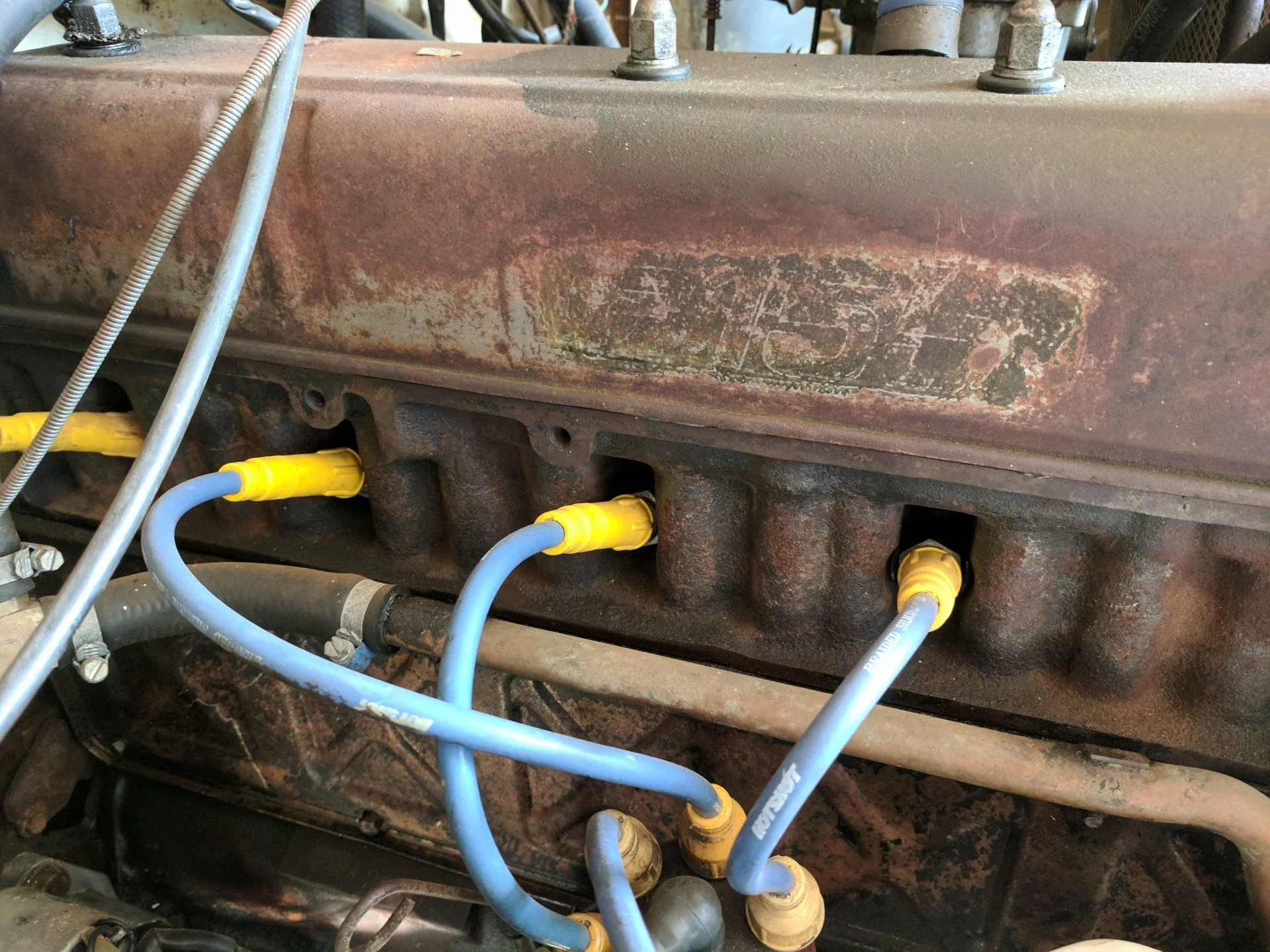

  • New spark plugs
  • New fuel filter
  • New oil filter
  • Charged battery

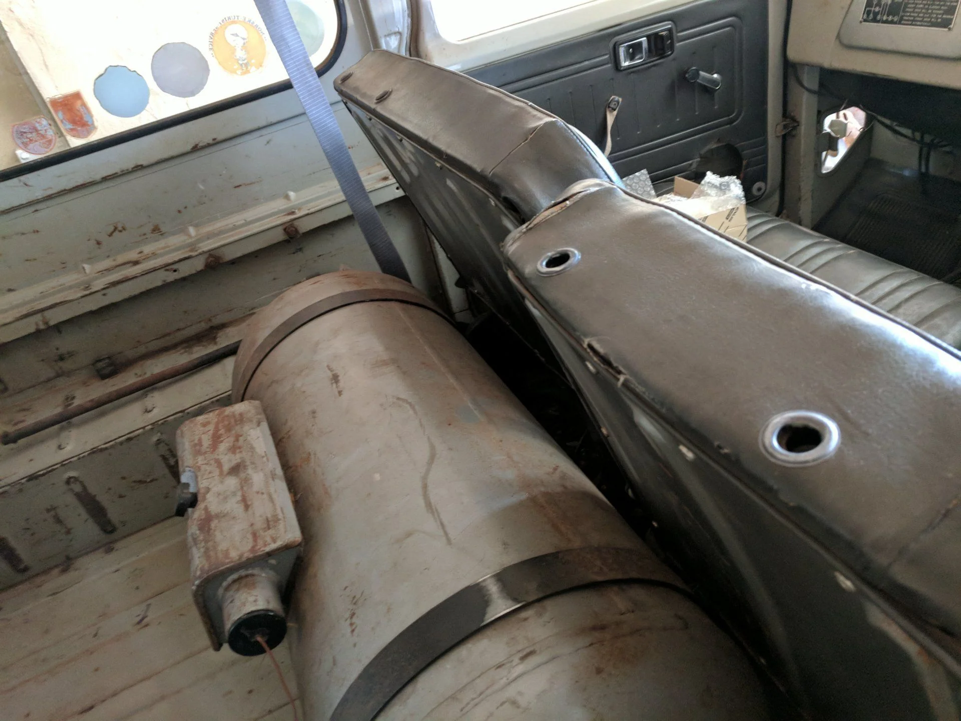

  • The PO has installed gas(LPG) I want to remove it - Job for the professionals

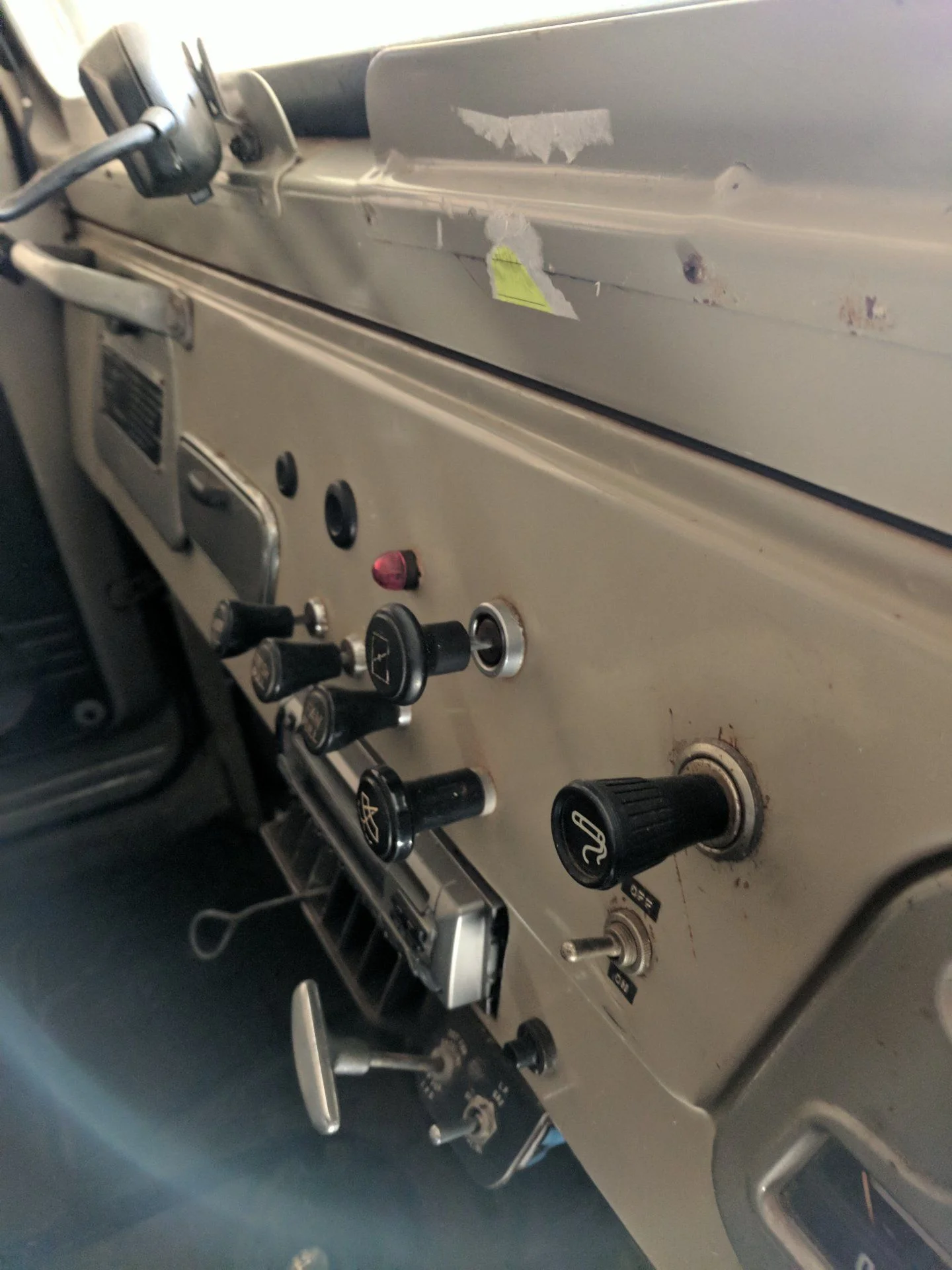

  • Fix choke - pushed out, can push it back in. Anyone had this issue? If so how did you handle it?

Does anyone have other general maintenance recommendations? yes - brakes, steering and all oils changed and checked regularly (which you have already done), just the usual stuff. I had some choke issues on my 2F; link to the choke front he carry was buggered on mine.

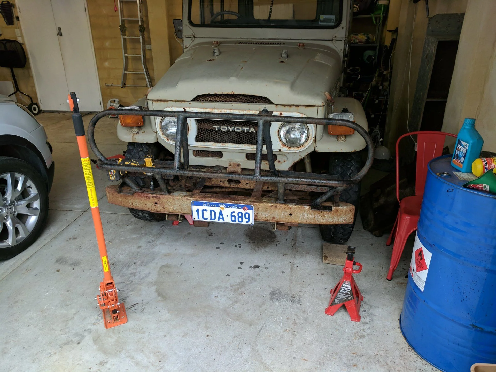

Had a real win this weekend, was able to finally crack the transmission filler plug. The breaker bar was the winner, not sure if the 3 weeks of penetrating oil helped or it was pure persistence. That sound was amazing though!!
Also pulled of that big ugly bullbar, not sure it will go back on.

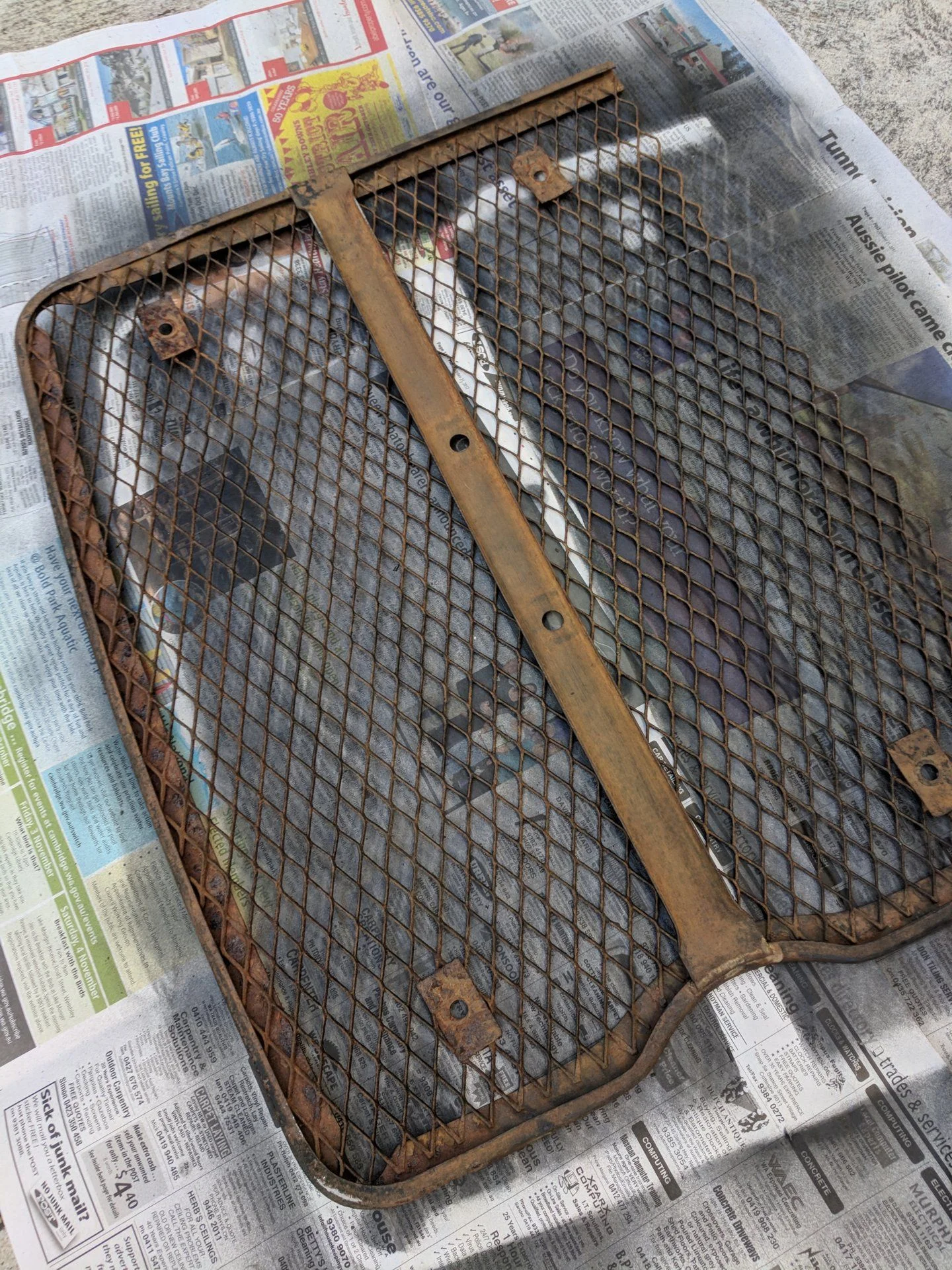

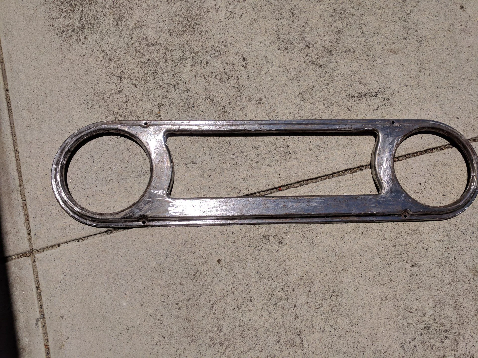

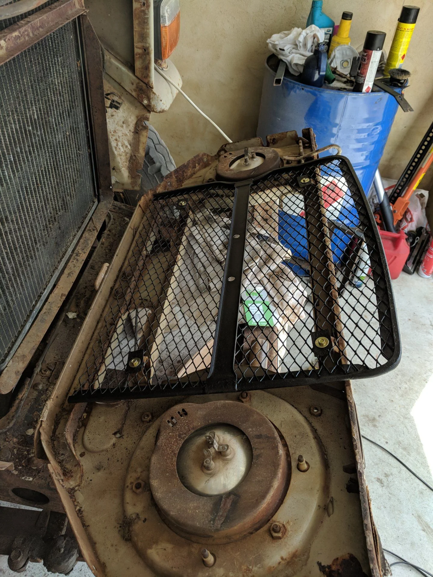

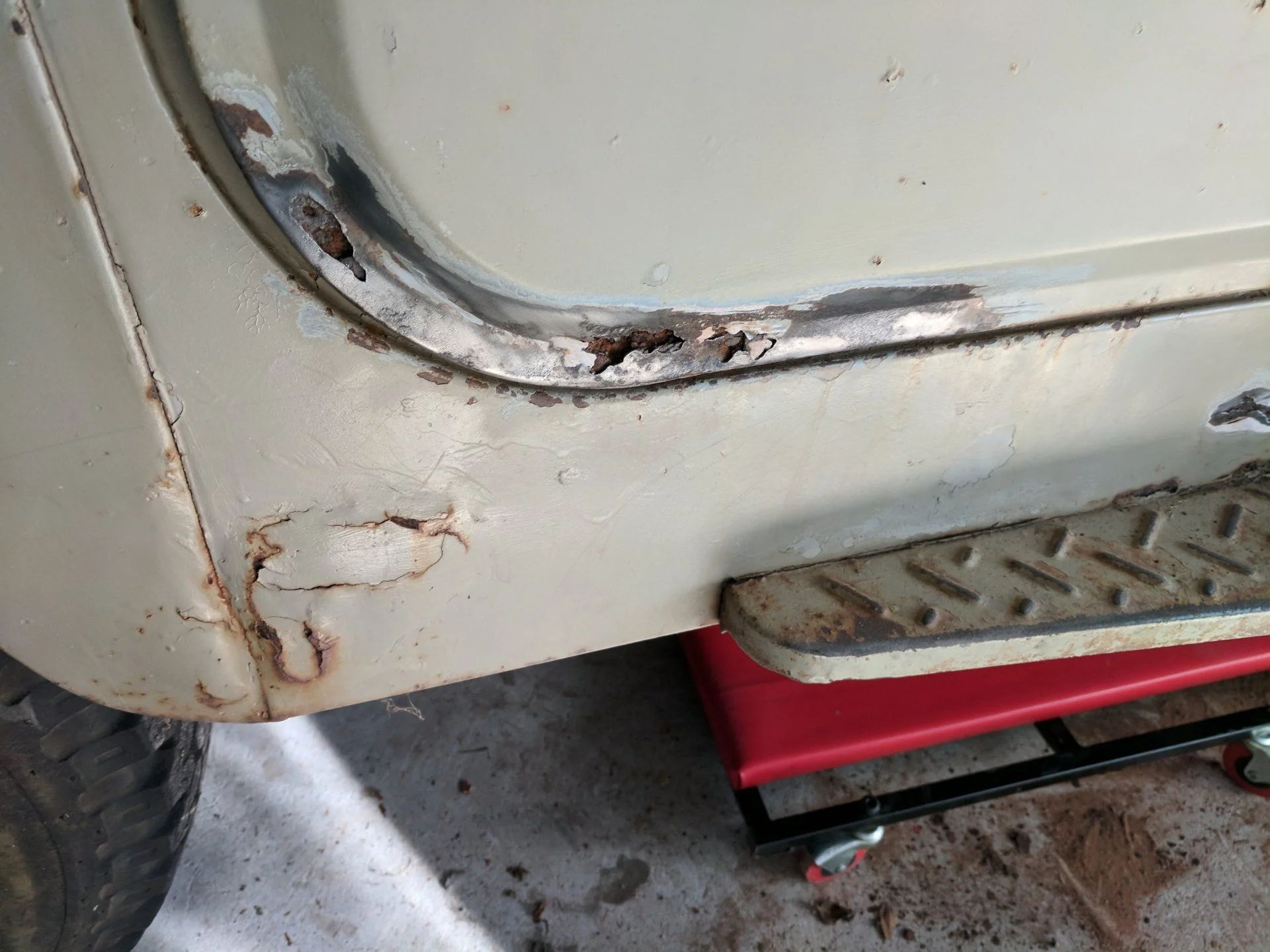

So I made a decision to start small, start something I could and would finish. I was inspired by the "what did you do this week" thread and sanded and painted the grill and light surround to get a feel for body work.
I used a rust converter on the grill, sanded back the I surround as much as possible and applied a rust kill before the white paint, couldn't find a grey rust converter in a rattle can. not really happy with the white. Might need a top coat of different paint.
QUESTION: what's your thoughts on zinc screws and should zinc only be used in the interior or not at all due to dissimilar metals? I've got some stainless bolts coming so planning on using them for all exterior bolts.

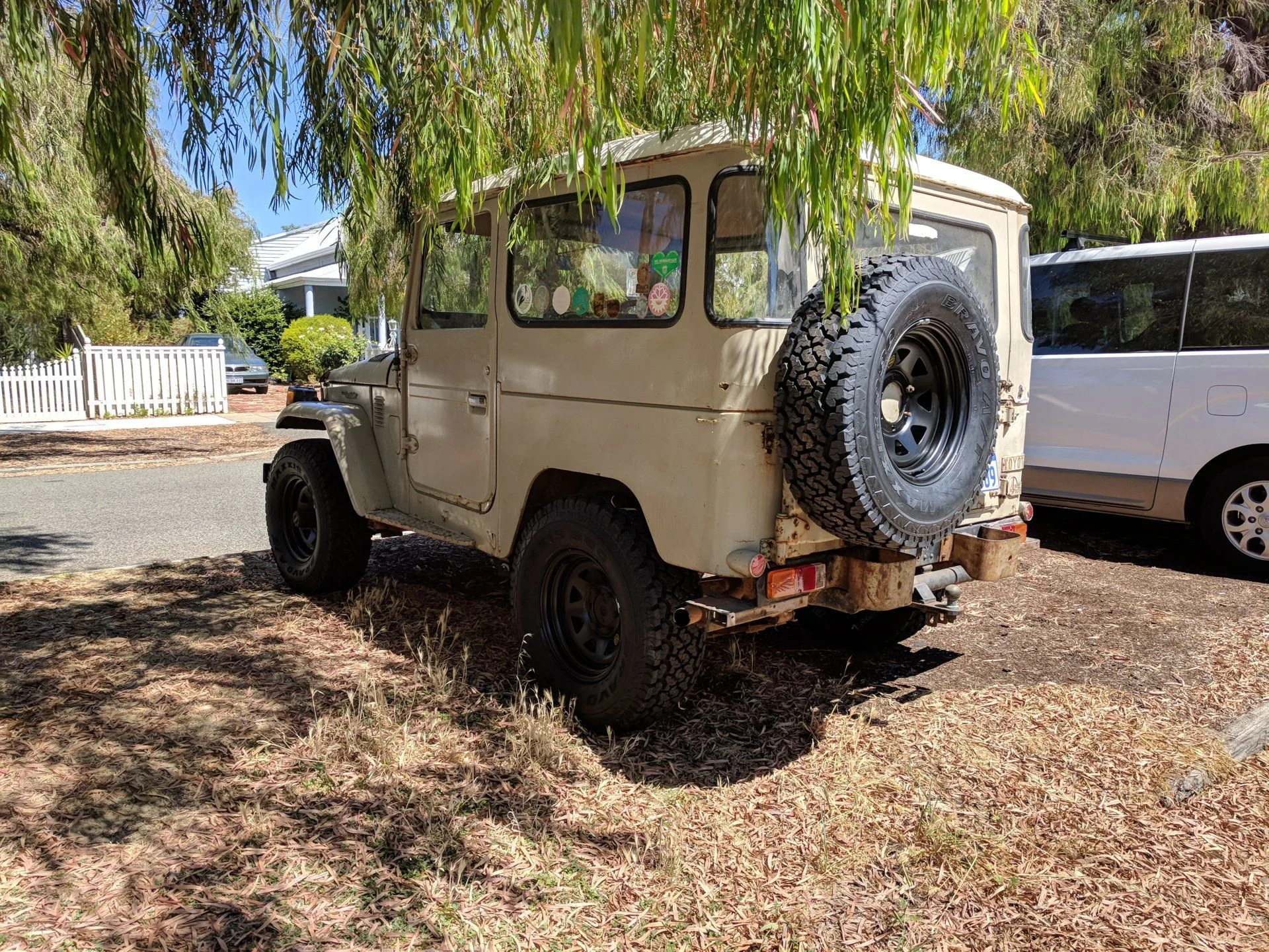

Update.

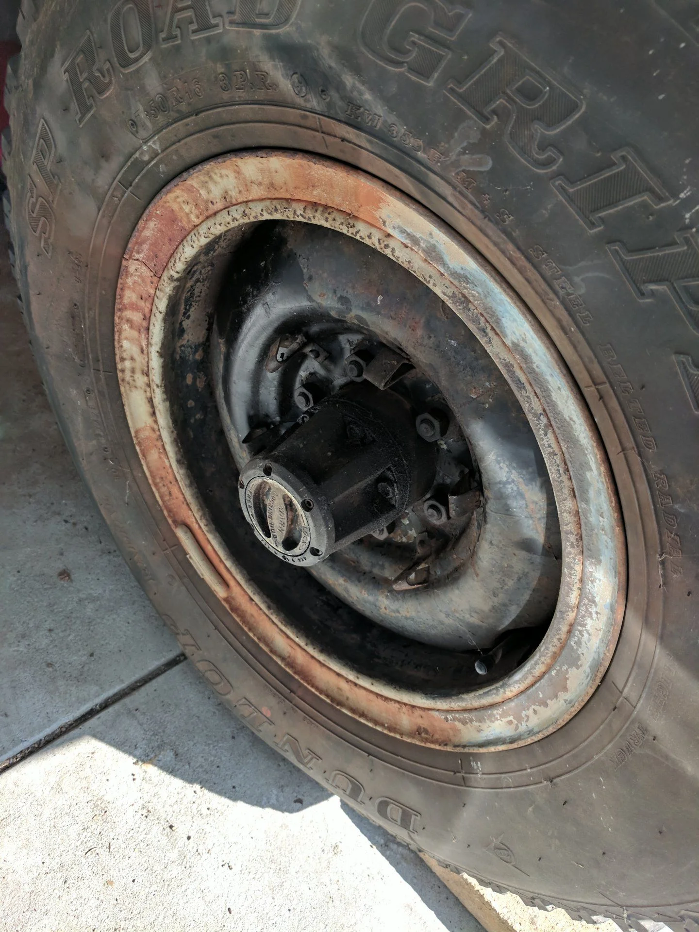

Wheels, tyres, windscreen and seat belts!

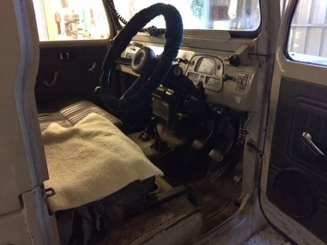

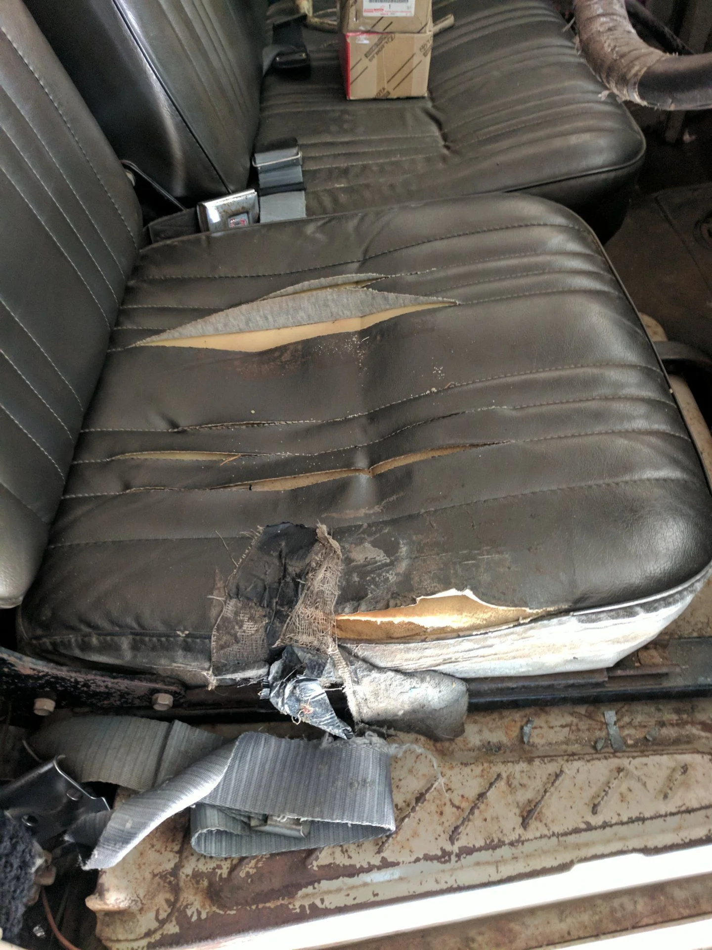

Pulled the passenger seat to install the new seat belts, perimeter of floor pan is not in great nick, fair bit of sunlight coming through. Gave it a quick wire wheel and then rust converter paint to keep it at bay for a while. When/if the full body rolls around there'll be a fair bit of welding!
Finally figuring out a way to clear snapped bolts. Prevention is always better than cure, but with these old girls prevention is not always possible. I generally use the acetone + trans oil combo but when the bolts snap, I run with the drill out about 80% of the bolt and then hammer + nail punch time. I alway run a tap over the thread to clean it up and then install a new bolt. Haven't used an anti seize as I have a feeling they will be removed in less than 8 years.
Anyhow learning how the old girl drives, synchros in the gear box are shot, but nonetheless I have a surprising amount of confidence in her. Still waiting to take her on a 100kms + drive.

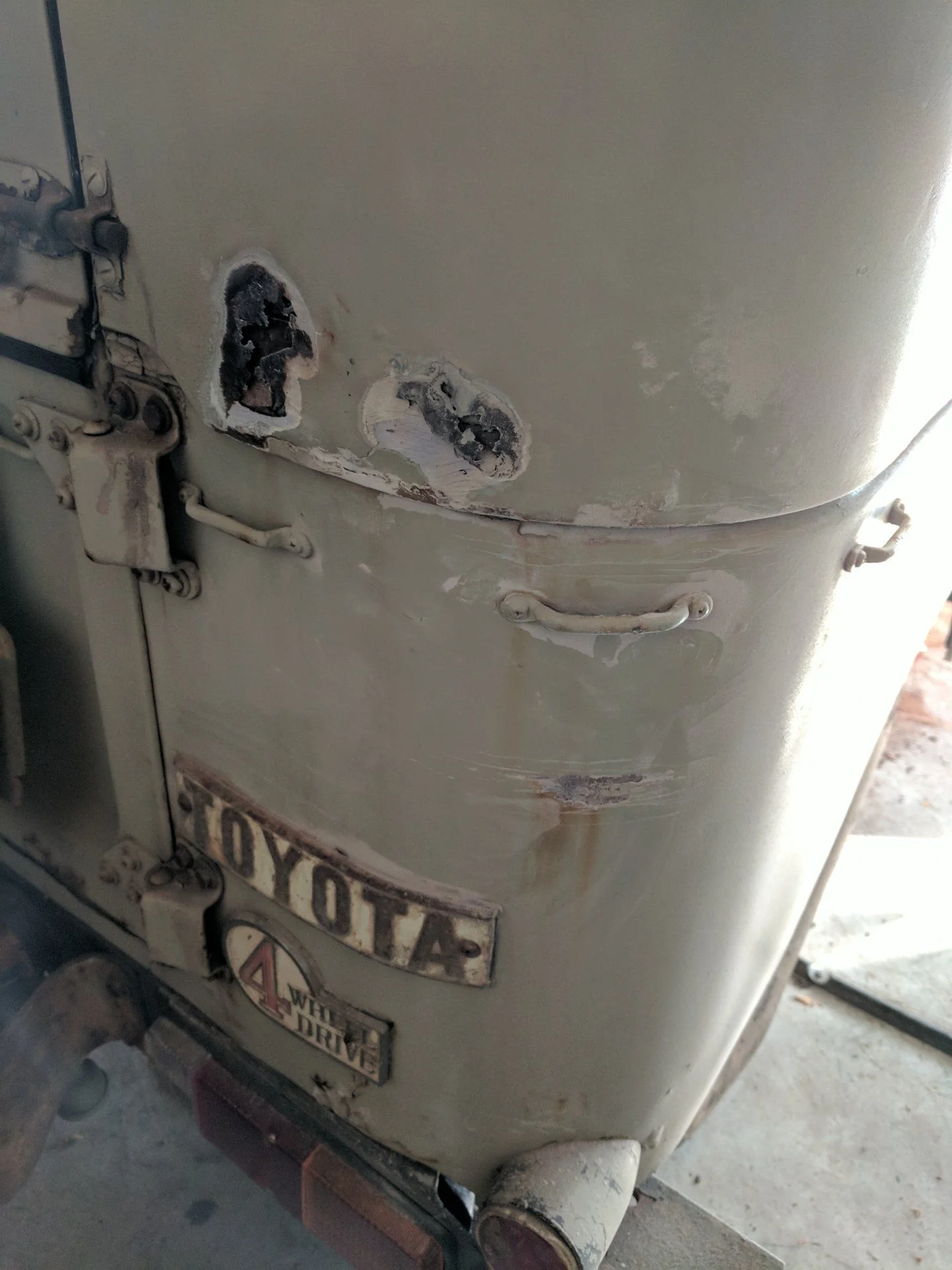

Pulling small bits off and sanding back to bare metal and painting. Thinking of removing the bubbles in paint to show the truth behind. Will treat will rust treatment for now.

Just something about a '74 ... great rig, thanks for posting up! I didn't see anyone else address the choke cable issue. In my experience, its usually the cable at the dash end. I spray with WD-40 and work the knob a bit, spray, let it sit a bit. Spray the firewall side, linkage at the carb, anything you can get to and then work that knob again (pun not intended). Let it sit a day, repeat. Eventually it'll free up. I wouldn't use the acetone/trans fluid mix because it'll probably eat the paint. And here in the northeast USA, just about any bolt that comes out goes back in with anti-seize. Especially those fine thread spindly little things holding the bib, bezel, fenders ... and the other exposed screws and body bolts. Grrr ... I've snapped more of those little devils than I care to remember. Looking forward to seeing your progress!

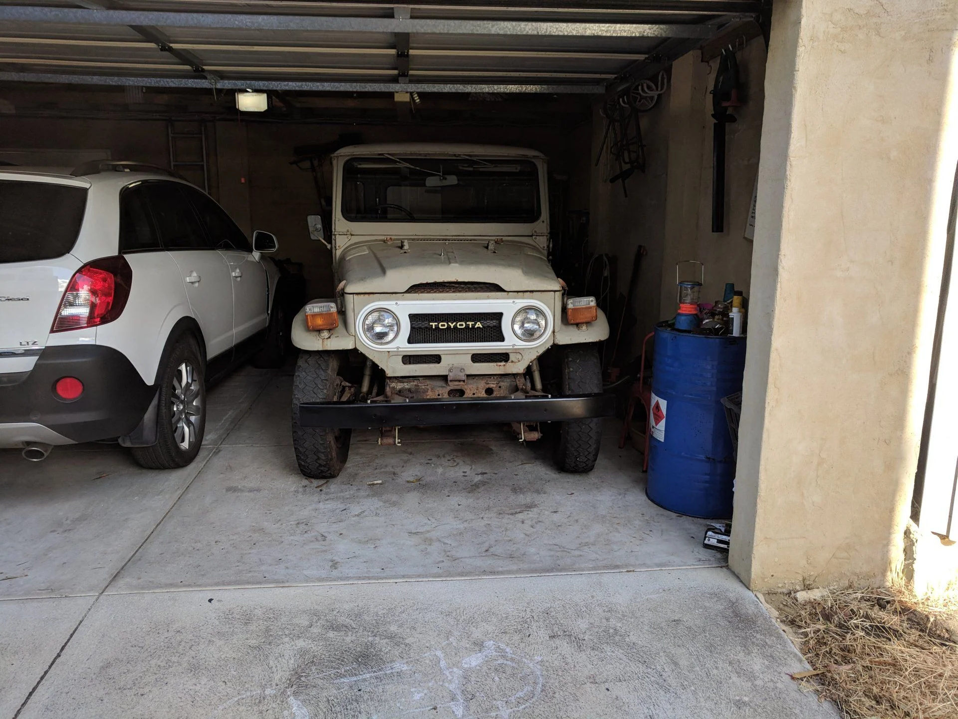

Really battling myself to frame off or not at the moment. There's enough major items that require work (gearbox, rust on the back frame diagonals, panel work etc.) that if I start one I might as well do they whole thing. Comfortable enough with the cost and time off the road (and understanding it will take longer and be more expensive than I can imagine), it's just the space required.
Is a frame off Resto possible in a 1 & 1/2 car garage? If a single car garage was a single bed, I'd have the equivalent of a king single. With a small bit of bench space and storage tossed in for good measure.
I should be able to hang the roof and body from the roof.
I'll pull it apart, probably do the diff/knuckles, maybe reco the gear box etc myself. Clean up, weld and prep as much of the steel as I can, but send out everything major for paint.
