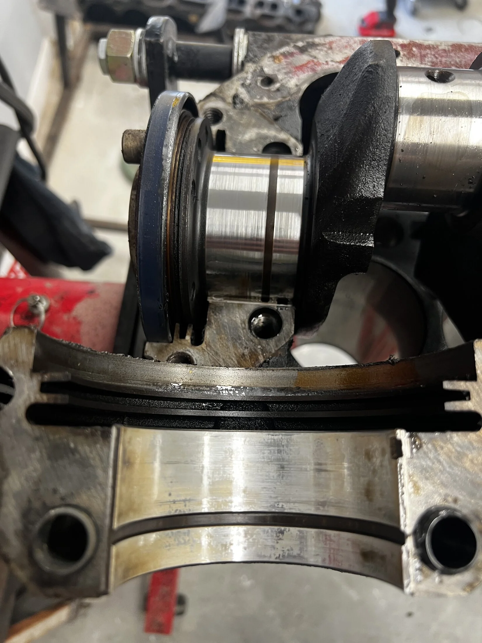

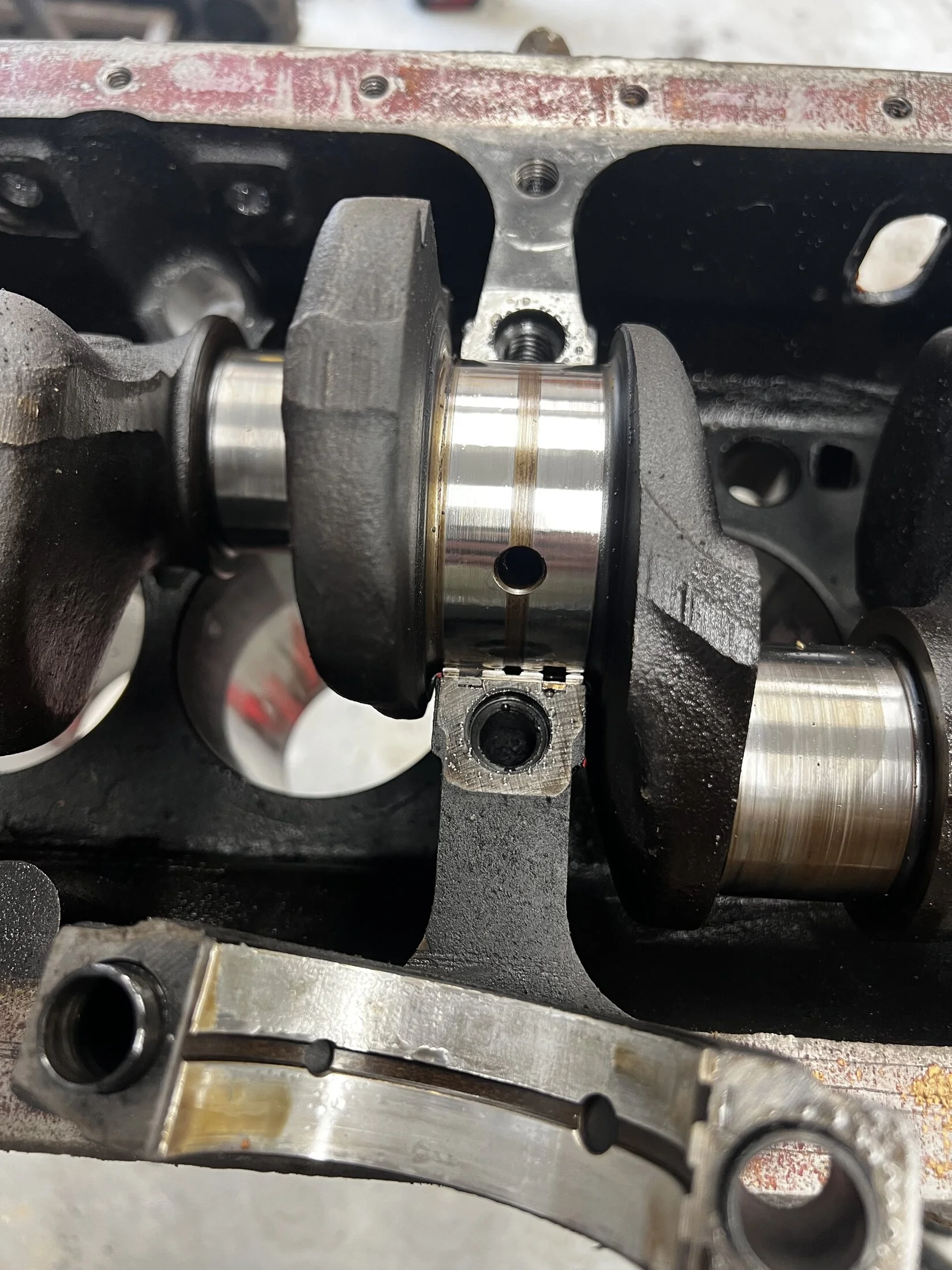

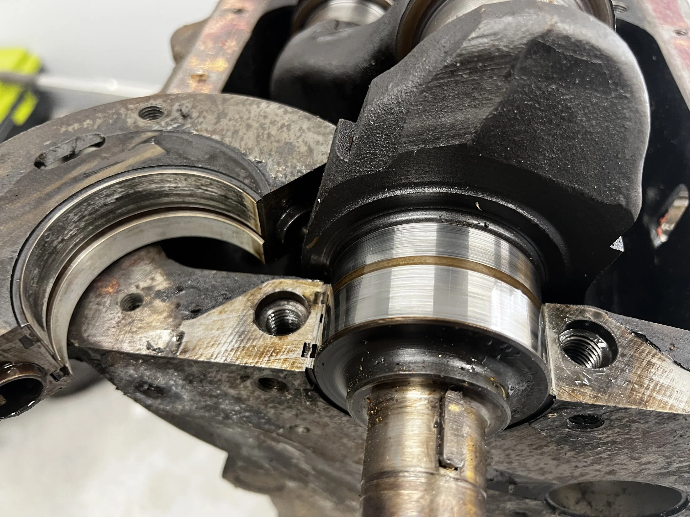

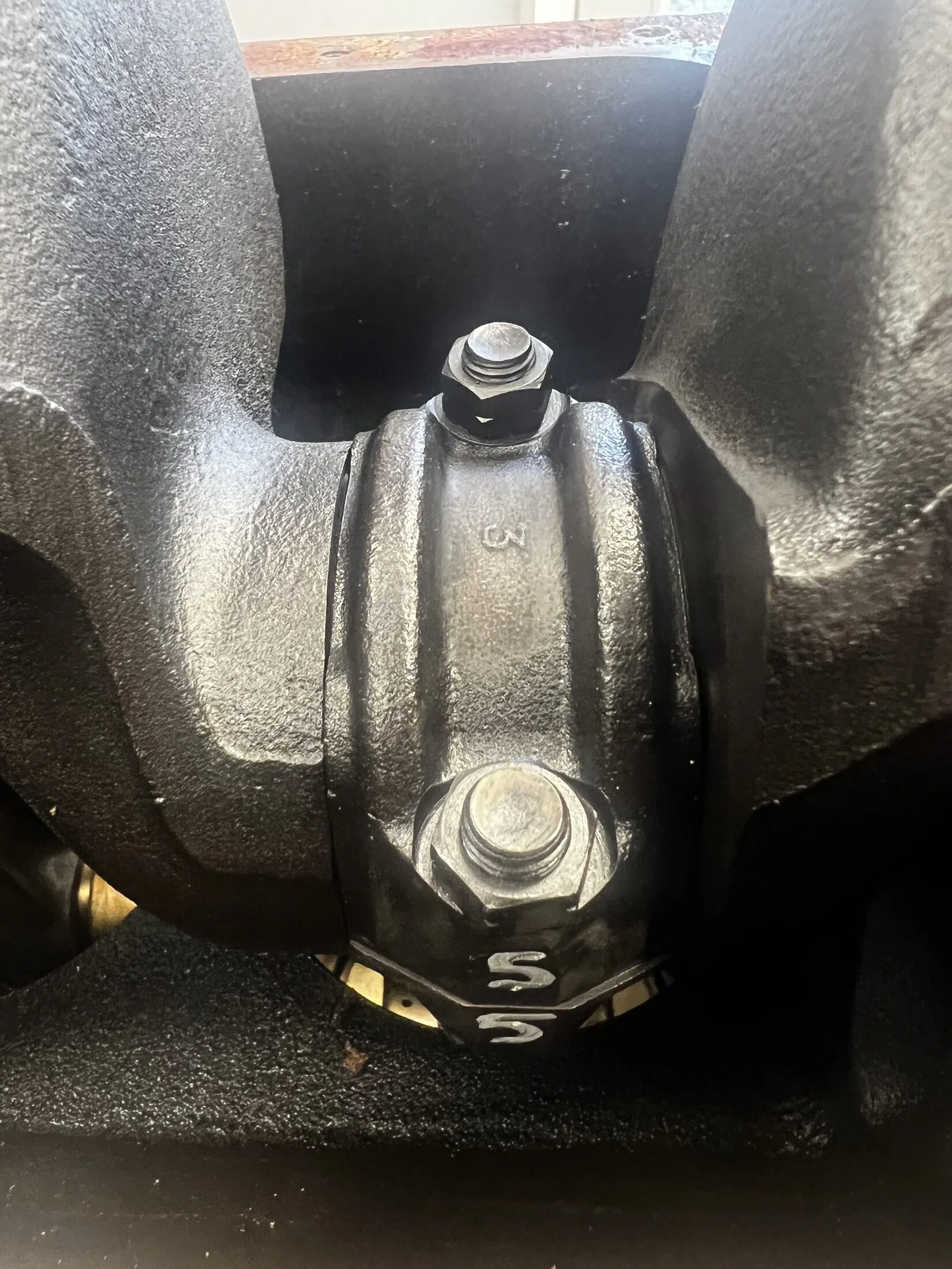

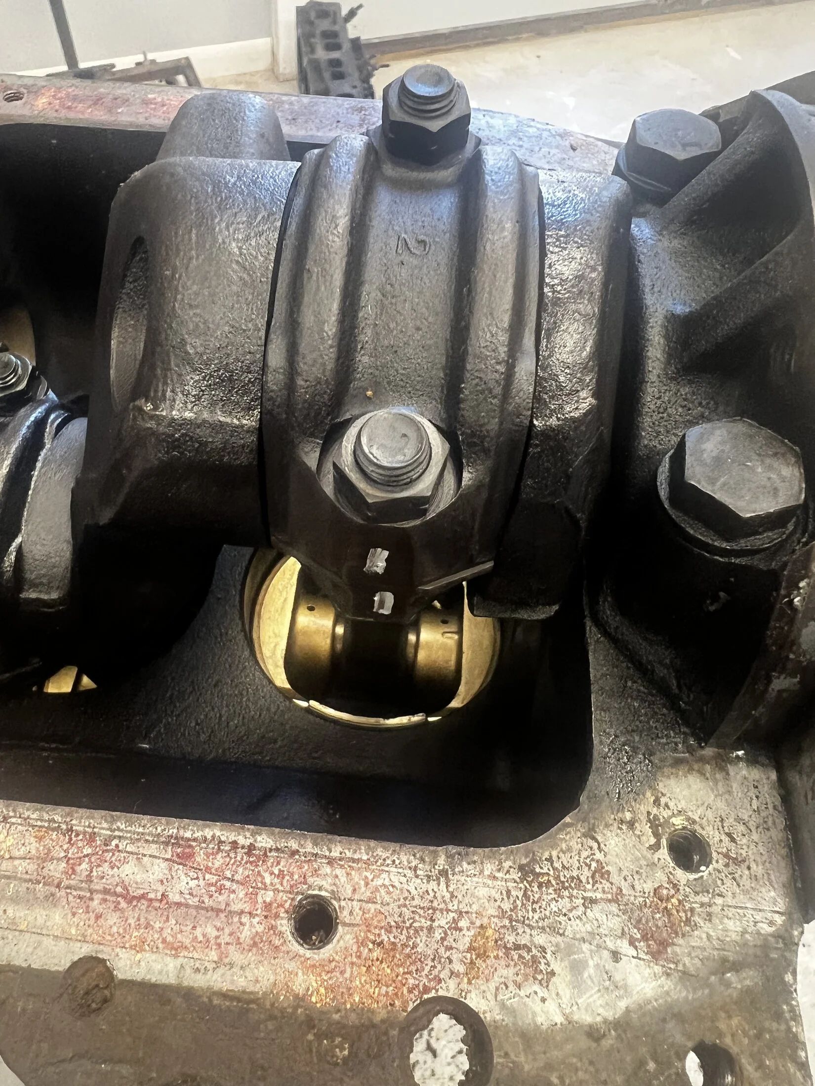

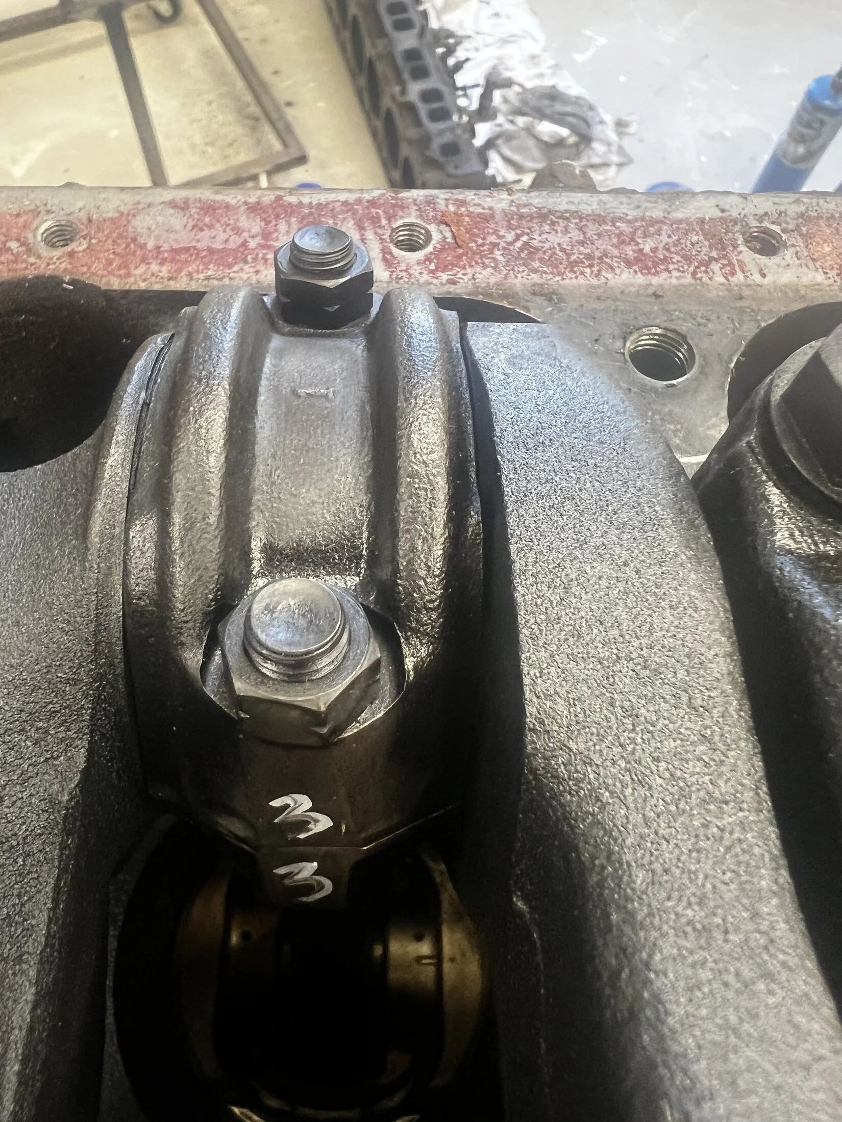

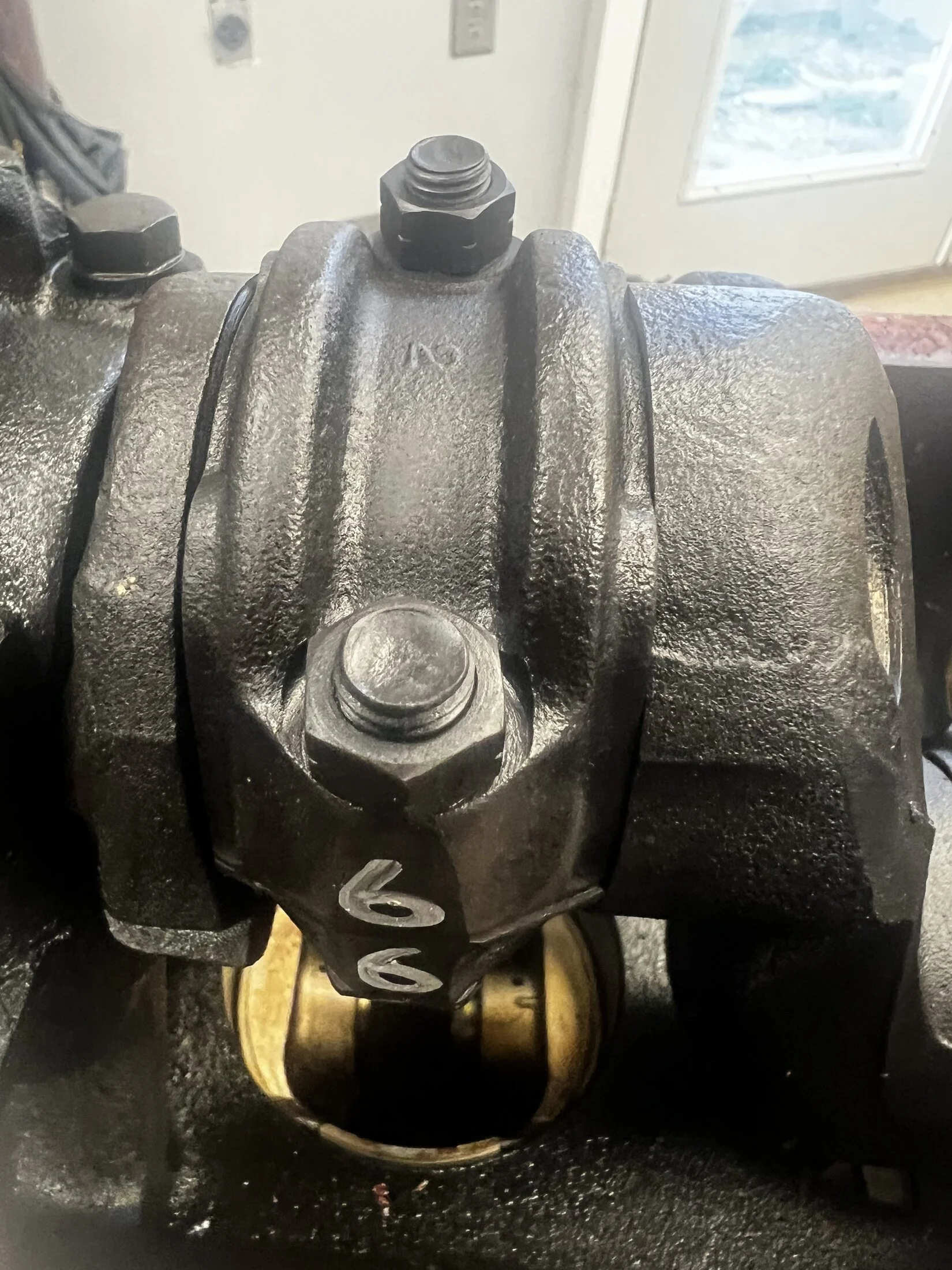

got all the pistons out of the 2f. A few rings were broken, but bearings all look great. Interesting that some of the caps have a cast number that doesn’t correspond to the cylinder. I marked each cap/rod with a punch and paint just to be sure they were kept in order. You can see some of the vast numbers on the caps.
I ordered some hastings rings and plan to just hone and reassemble. Cylinders and piston measurements checked out. But, should I go ahead and put in new main and rod bearings? They seem good. My only concern with new is introducing some error.

The crank, depending on its condition, will be as important in determining how to move forward. I'd probably not introduce a new main bearing with a tired crank. It either need fixing or just reassembly. Lapped valves, new rings sets, honed cylinders - that is probably all that the home-builder can effectively seal up.
Not sure about the camshaft, but, I think that the lifters might need a regrind?
If your planning to hone and reassemble I'd strip down the blk, make your mess and throughly clean and inspect all the components and correct anything suspect.

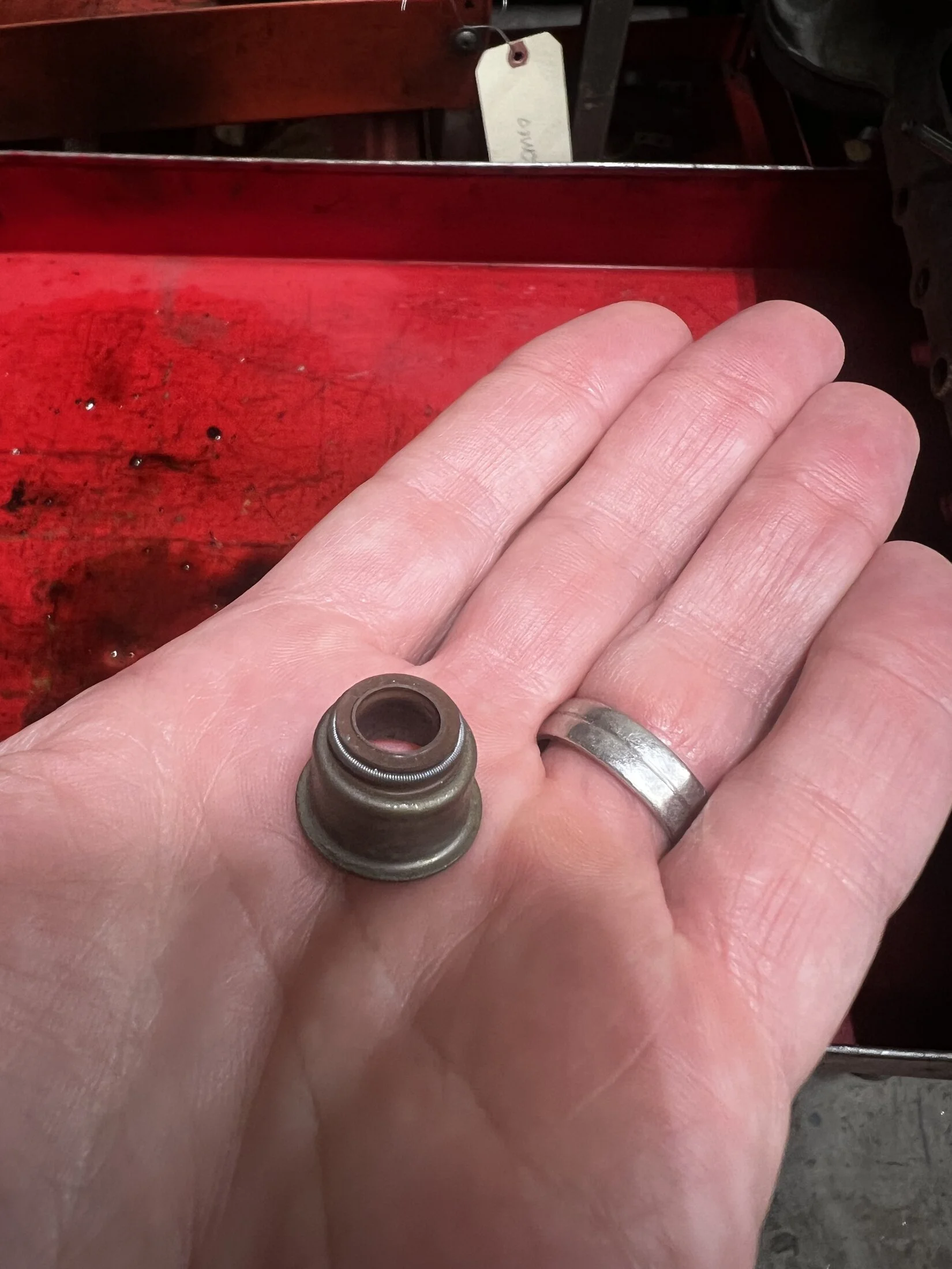

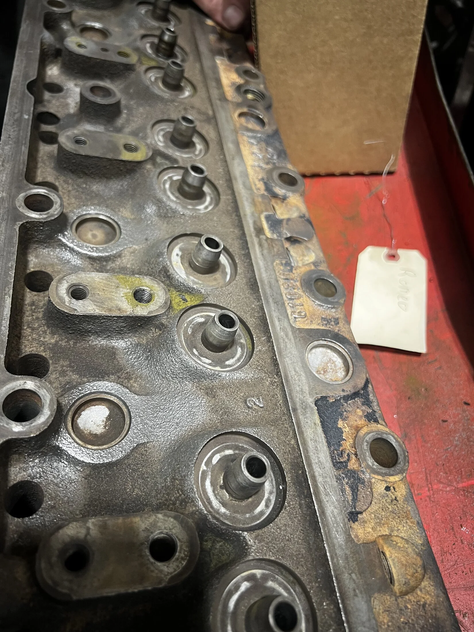

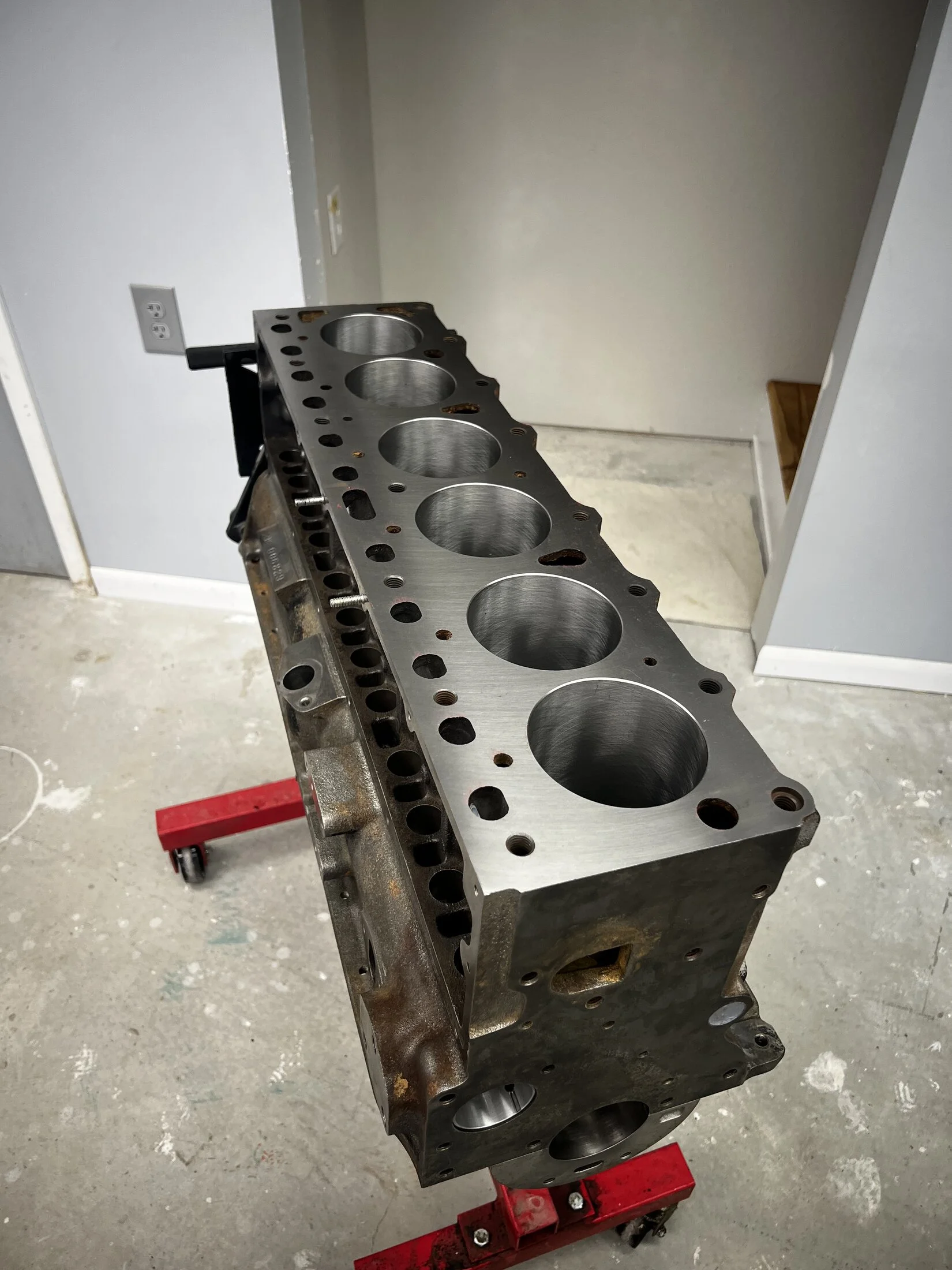

Update - block had to be bored .040, found some domed pistons, crank got machined for 010 undersized rod and main bearings. Head is good and is getting a valve job. The OEM valve seals won’t fit the valve guides though. Can anyone confirm that these valve guides do not look OEM? I’m thinking not based on the long taper, which is preventing the seal from fitting onto the larger OD section of the guide.

A '75 head uses a different style of valve guide and valve stem seal. Umbrella or deflector-type seals up until about '76. You can use the metal positive-type stem seal, it just can't be pressed on the valve guide.

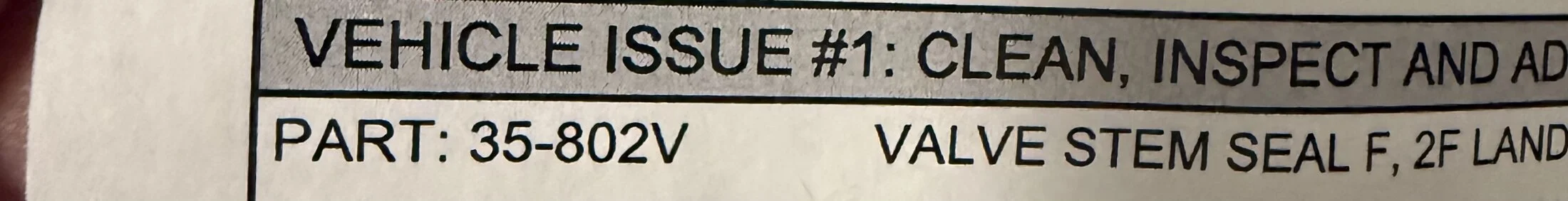

I reached out to Cruiser Outfitters for their thoughts. There’s another post where Kurt shared the photo below of the different seals that are available. I have the one in the bottom right. Do you think I need the one on top right? It looks taller. If valves guides aren’t OEM, though, I’d prefer just to replace those.

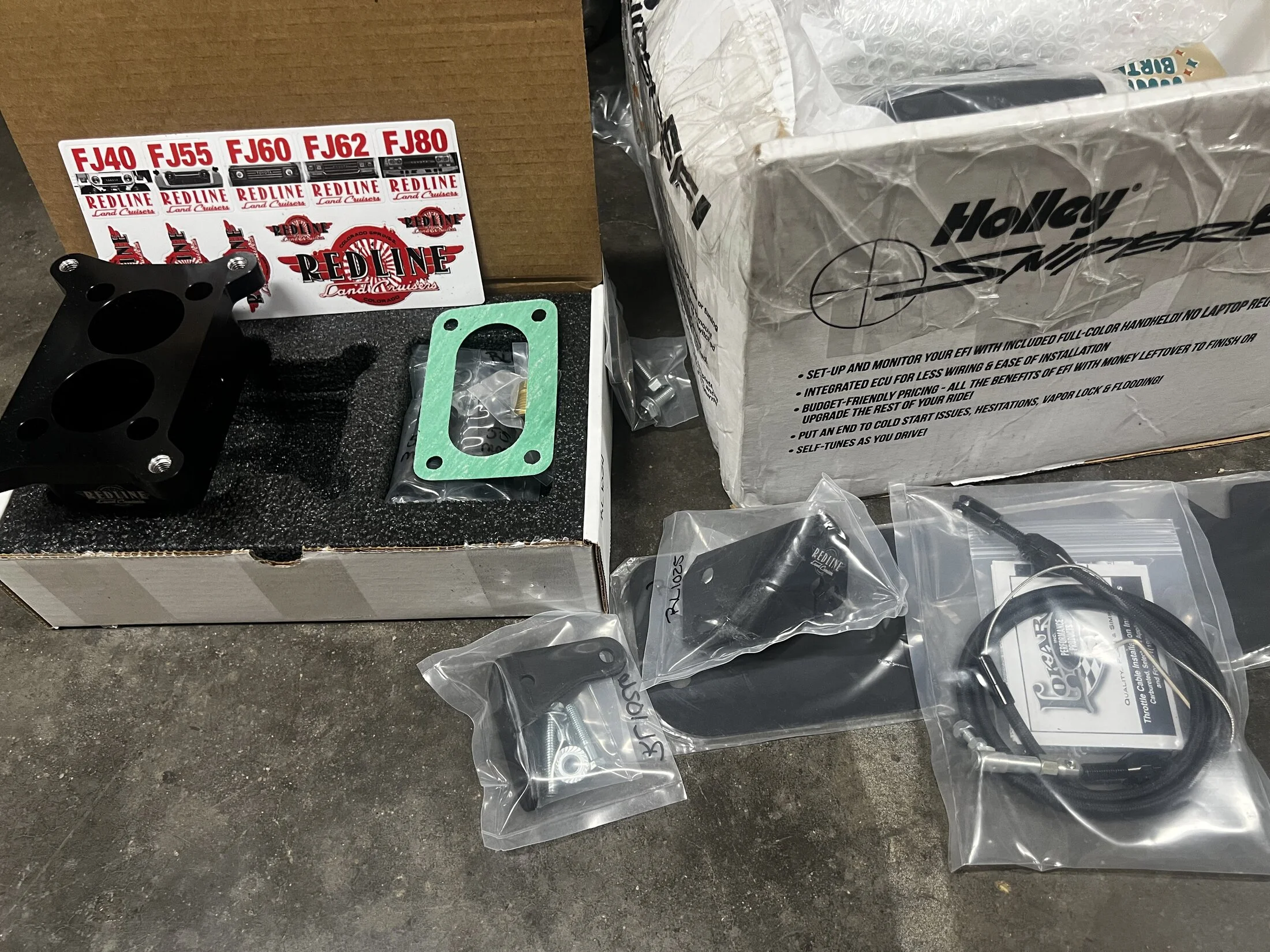

Valve seals sorted out thanks to the crew @cruiseroutfit. Just had the later model seals which don’t fit the head. Also got some OEM plugs for the air rail holes. New oil pan about to go on. Some goodies coming from Redline for an eventual sniper addition. Rebuild coming along well now.

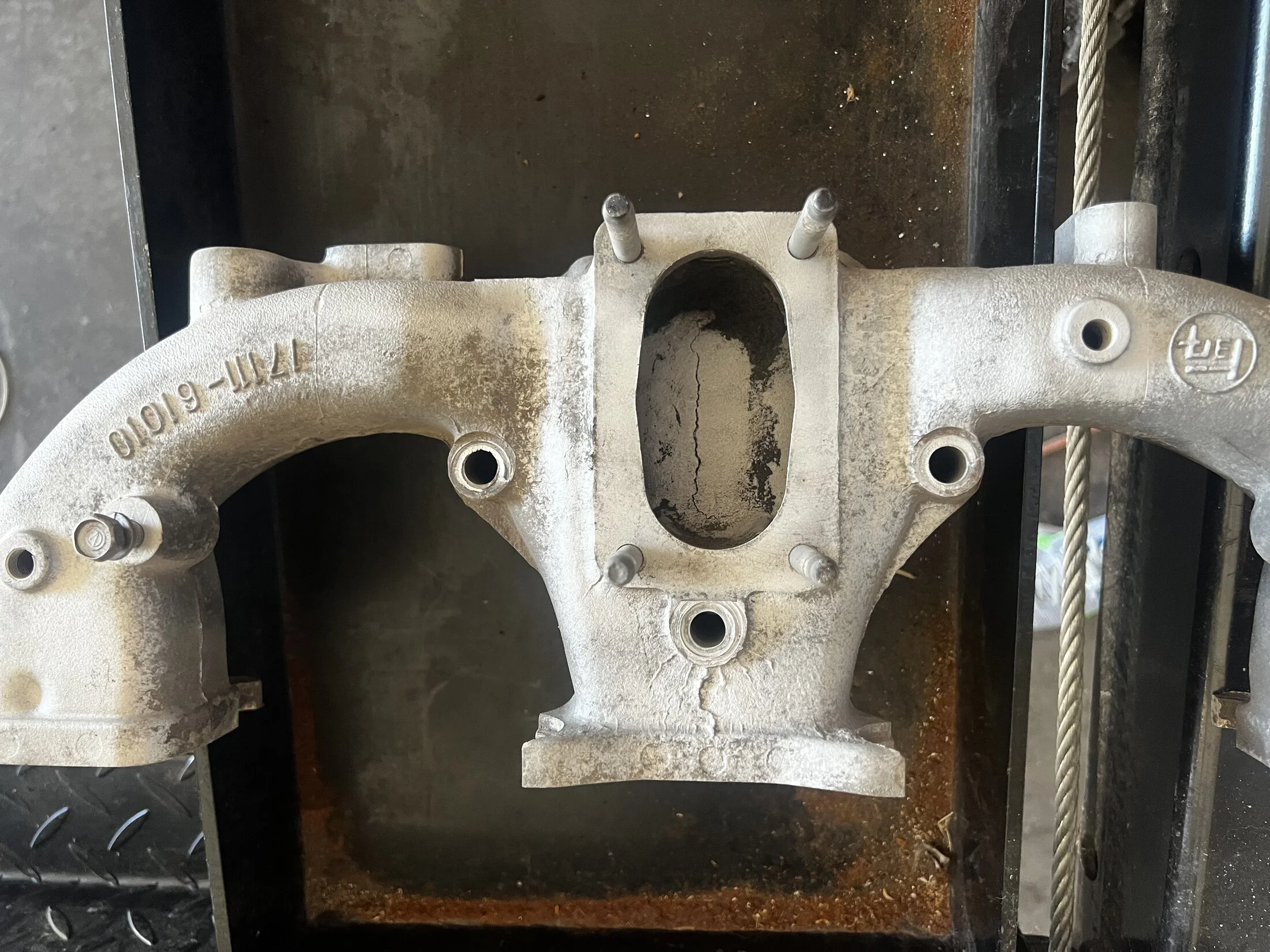

Some goodies showing up for the eventual sniper addition. I dug an extra intake out of storage, but it’s also cracked. Looking into repair or replacement. Also have a good exhaust manifold. What’s the consensus on headers vs OEM? Plan to keep the OEM exhaust manifold unless there’s a compelling reason to go with headers. Cracked manifold and sniper stuff…
I ended up sending the intake off to @cruisermatt for a crack repair. Service was fast and price was fair. I also decided to pick up some 3FE exhaust manifolds.

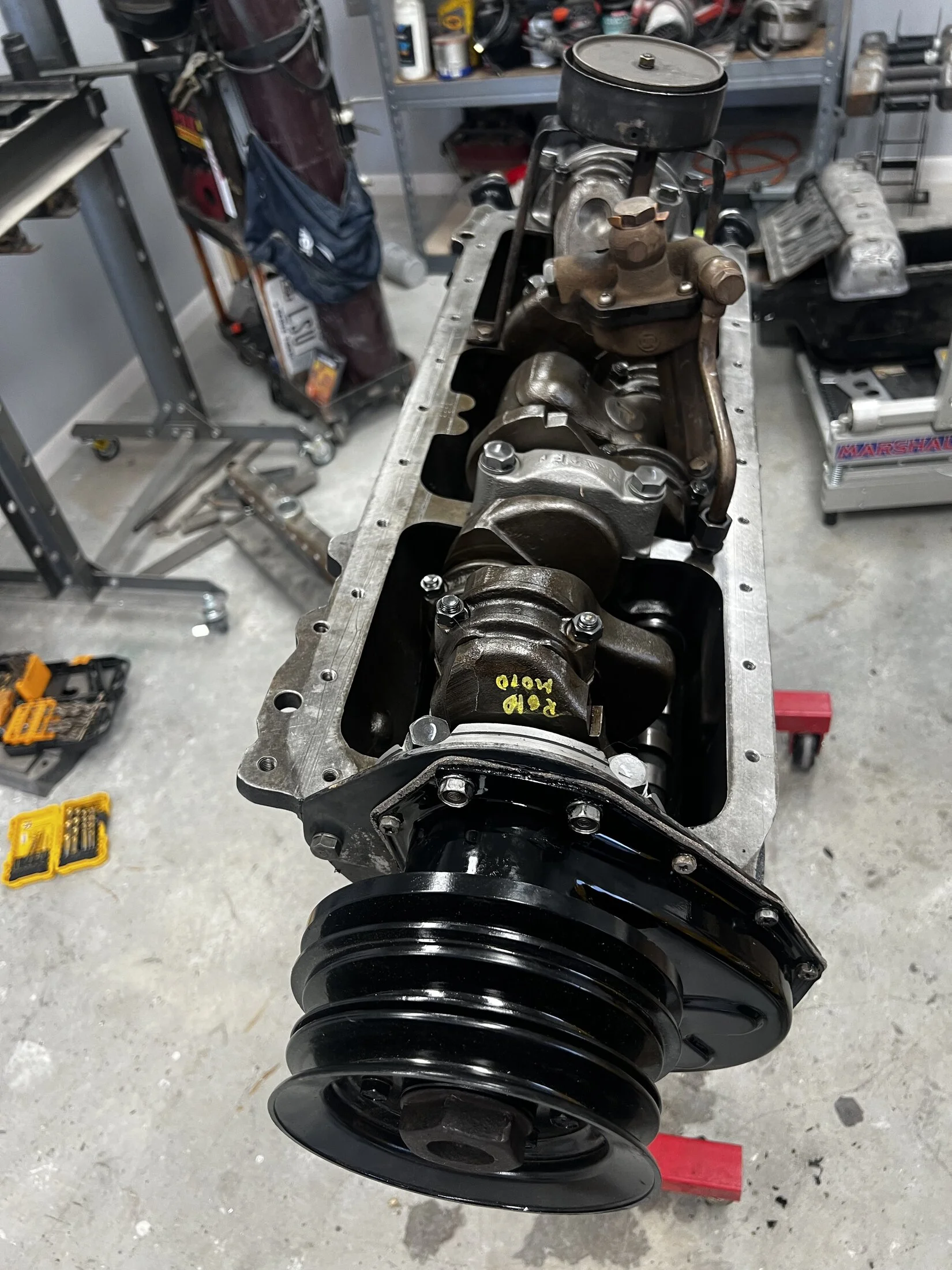

  • While attempting to adjust initial valve clearance , I noticed that the slot in the distributor hole/oil pump looked odd. I stuck a flat head in there and found an odd loose piece of metal.
  • I attempted to fish it out, but it might be larger than the hole
  • I pulled the oil pan and brand new OEM gasket :(
  • Pulled the oil pump and started disassembly
  • Ordered a new oil pump, which has a different pick up, but will see if; A. It works as is, or B. Can be swapped into my original assembly
I have not yet figured out what the metal is. My suspicion is that it is one of the ears of the shaft where you can insert a flat head to prime the pump. No idea how that would have broken. I’ll confirm when I get the new pump. The little screws on the oil pump were too tight to remove and I gave up after stripping one.

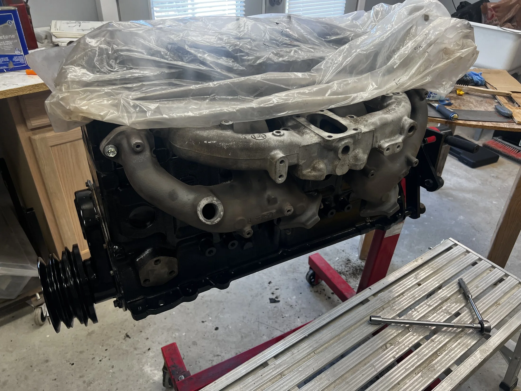

Some general progress pics

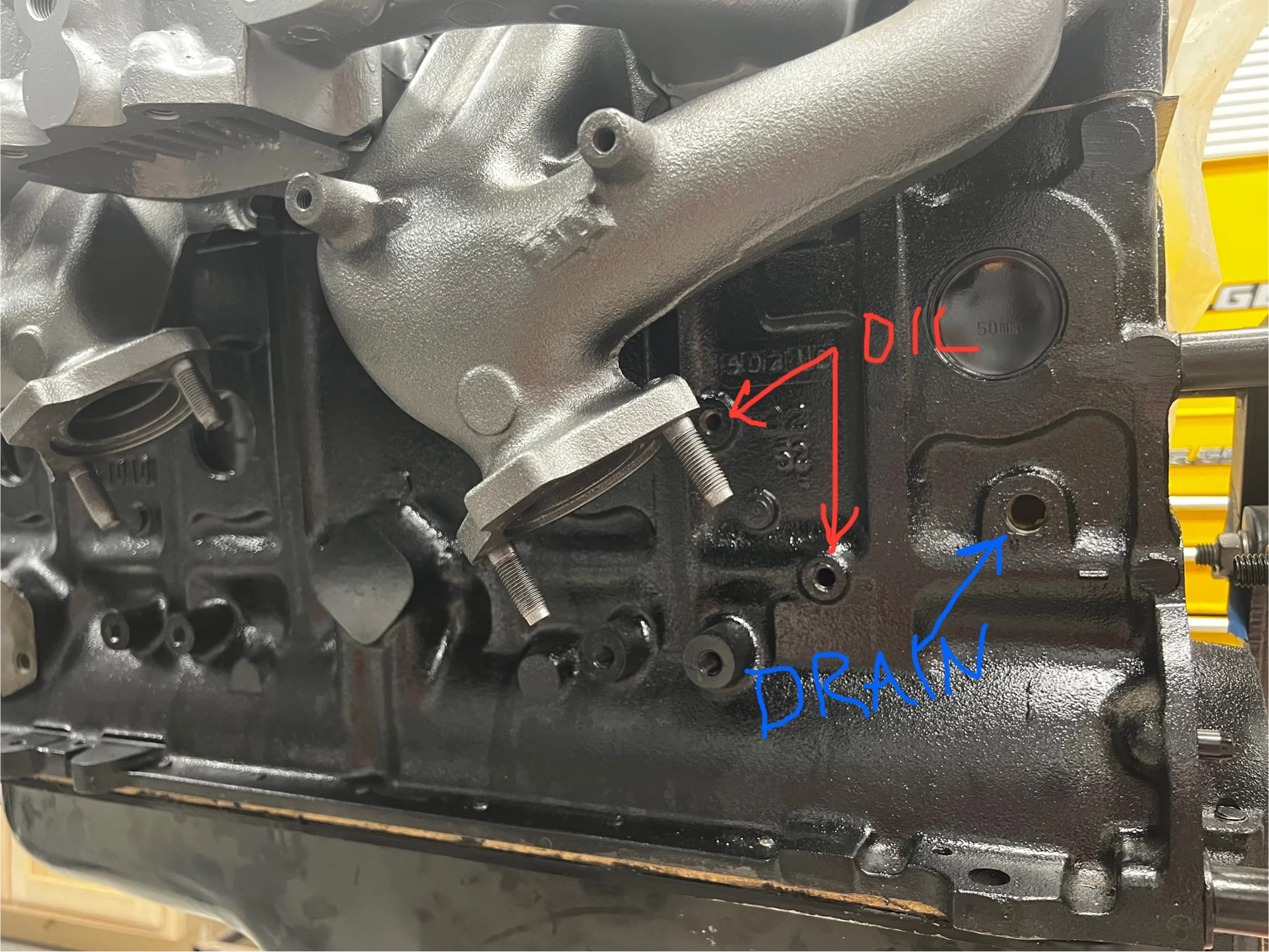

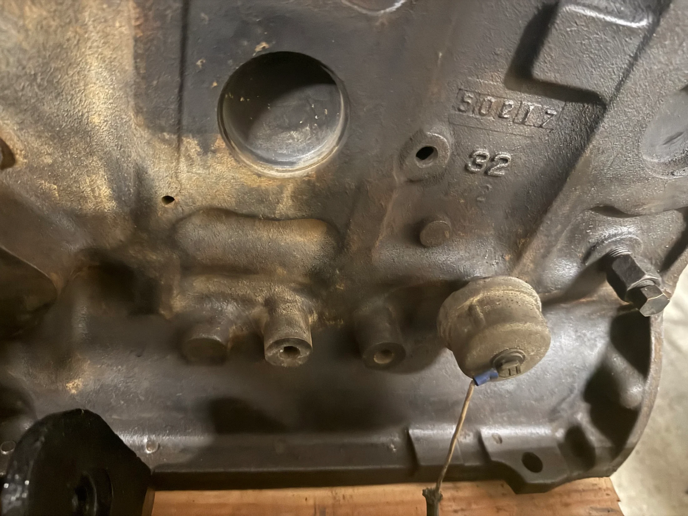

I’m trying to sort out these two holes in red. One is the OEM location for the oil sender. Was the other OEM, or added? It had an aftermarket mechanical gauge and the OEM gauge when I got it. Just wondering which is the original sender location and if that other was added or was plugged from the factory.
