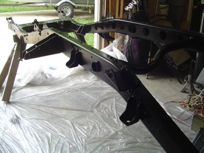

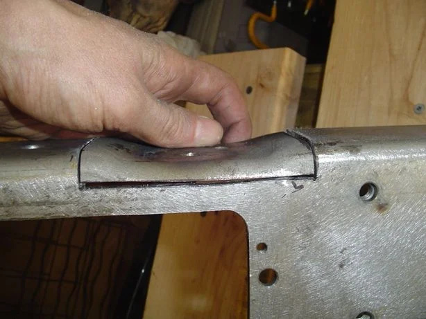

finished installing the rear frame member and put on one coat of eastwood extreme chassis black. heres a few pics of the mod I did to the ebay frame member to make it look like the stock piece and the final product.

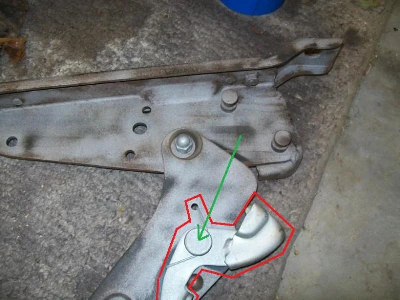

Still working on the seats. I am continually building a bin of parts to get cad plated. While working on the seats, I noticed two parts that were originally plated, but are difficult to get off. The part that releases the seat to be folded forward and the pins/springs that release to let the driver seat slide forward and back. I have these outilined in red and have an arrow pointing to the pin that holds the lever on. The pin is either pressed or welded on. The two spring loaded pins seem to just have a pin pressed in. Has anyone taken these apart? If so, how did you do it and how did you get them back on?
Thanks for any input. Here are the pics:

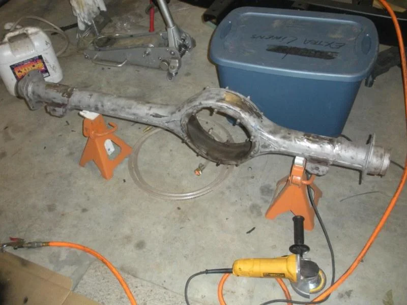

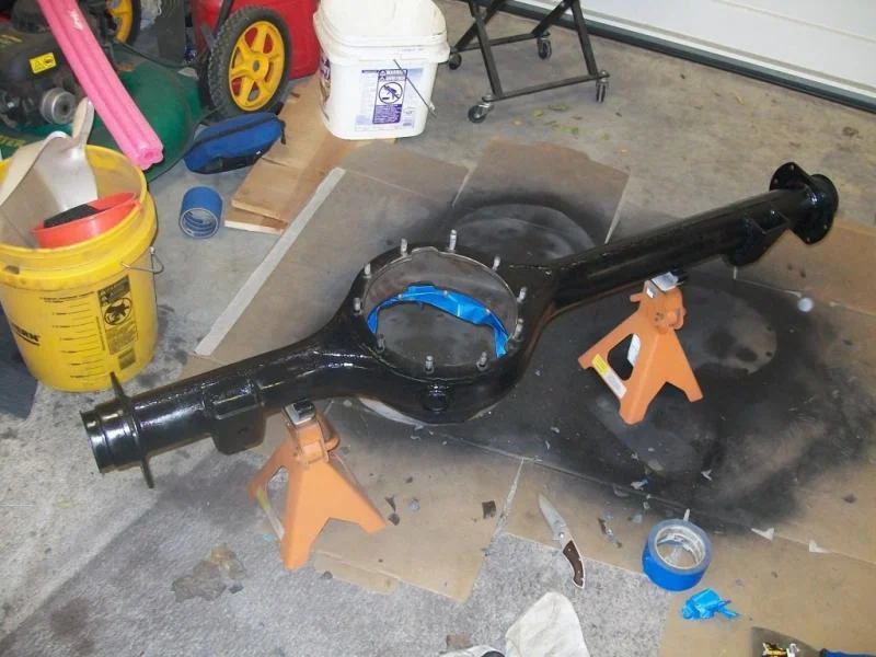

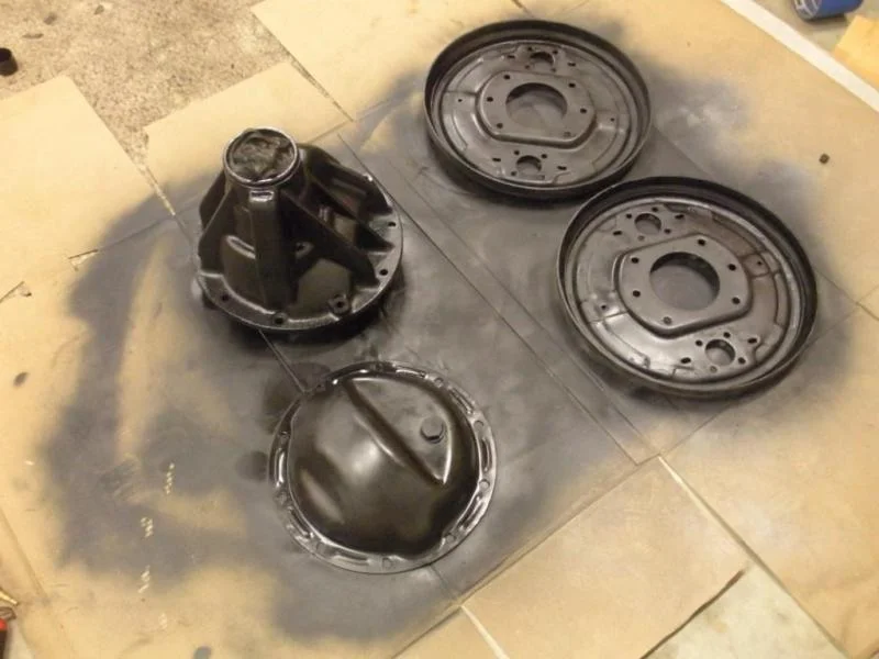

Anyway, I have moved back to the rear axle since getting a diff rebuild kit from Cruiser Outfitters. Blasted the housing, drum backing plates, diff carrier and cover. Painted with eastwood extreme chassis black primer, top coat to follow.

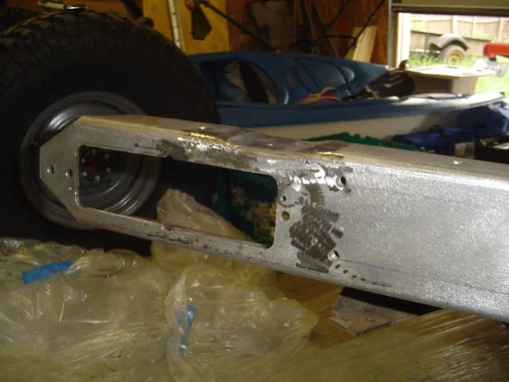

got the rear axle housing blasted and primed. There was a few spots where someone must have welded something to it. I grinded and welded in a few low spots. No more evidence of PO foolery. I've got new bearings and seals and a fresh third to drop in now. Should have the axles back on the frame pretty soon.
Going to the plater today. Ive got a bin full of parts and bolts. I asked about cleaning them and they said they would do it. Im sure it'll cost, but cleaning all of these small parts would be a chore. I also ordered a bolt kit from JIShardware.com. I got the flanged bolts in yellow zinc and will get them plated in CAD with the rest of my parts. I'll update with pics and cost when I get everything back. Heres a quick snap of the axle housing in primer.

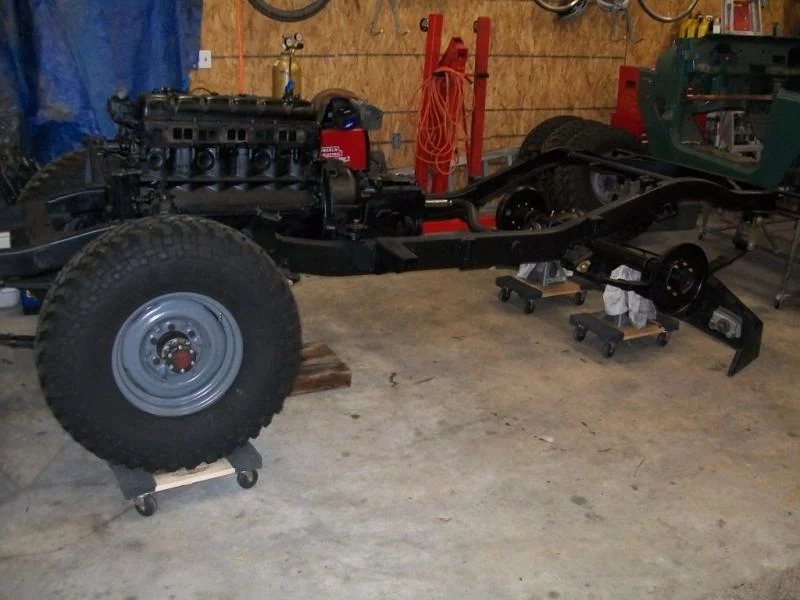

Ive almost got it to the rolling chassis stage. I just need to finish blasting and painting the front axle. Rear axle is bolted up, 3f is painted and dropped on the frame. I ordered new mounting bolts for the engine/trans from toyota. They should be in later this week. I need to get some pics up to show off all of my CAD plated parts. I'll try to do that soon.
In the meantime, does anyone know where I can get some of the underhood decals? Like the one that goes on the brake booster, coil, etc. I know aatlas1x used to sell kits, but I dont see them on ebay anymore.
Here are a couple update photos as promised. Almost a rolling chassis. Just need to clean up the rear axle shafts and slide them in. All new bearings and seals throughout the rear axle/diff.

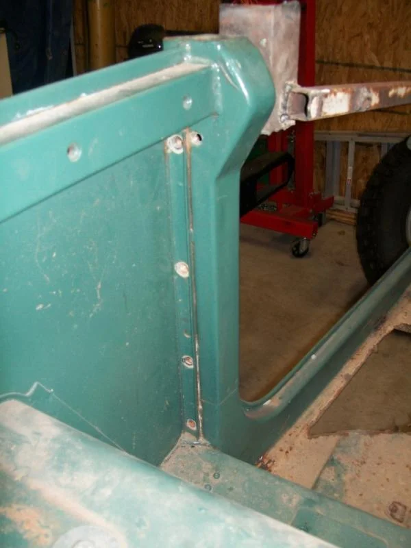

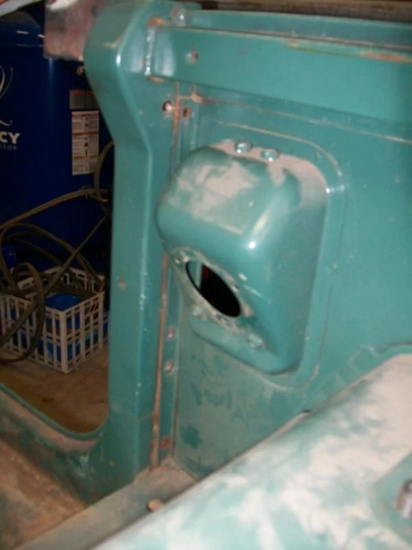

Also, i stripped the body of all fasteners before taking it to get blasted. While doing this i noticed these strips behind the front doors/b-pillars that I havent seen mentioned before and cant find any diagrams that show them. They are right behind the area that the hard top posts slide into. Anyone know what purpose these serve? They seem to be spot welded on and each had 4 bolts holding them on.
Any thoughts on these metal strips in the above post?
