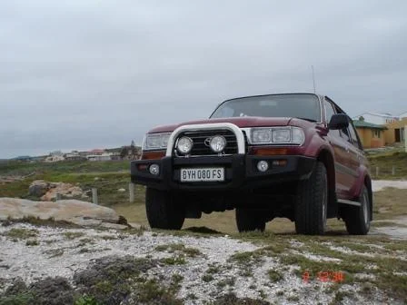

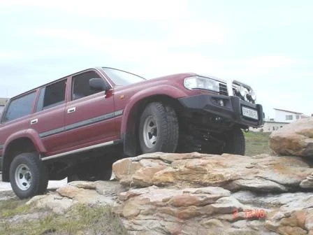

1. What lift Kit / components did you use? Include Spacers.
I selected the 2.5” OME Medium Lift kit.
Kit Included and was installed at Slee offroad:
2 x OME 851 Front Coil Springs
2 x OME 860 Rear Coil Springs
2 x N73 Nitrocharger Shocks
2 x N74E Nitrocharger Shocks
1 x SD24 Steering Damper
1 x CA77B Caster Kit
1 x Caster Bushing Press Piece
I am also using the 1” Mr Gasket Spacers from www.summitracing.com Part number MRG-1285 up front. See spacer install thread https://forum.ih8mud.com/showthread.php?t=51526
2. Why did you select that particular lift?
Wanted to keep it family friendly and at the time did not have any armor. Christo advised me to go with the medium in place of the heavy.
Later found that there is no real spring load difference between the medium and heavy lift springs, so I did not change them after I installed the armor and winch, just added the above spacer:
https://forum.ih8mud.com/showthread.php?t=44674
3. What tire size are you running?
BFG AT KO 285/70/R16’s - Real happy with them (See Tire section in FAQ)
4. Rim specs - 16x8 w/ "x" backspacing
Stock Rims, no backspacing
5. What caster correction, if any have you used?
What came in the kit as installed by Slee
6. Have you had any rubbing issues?
No
7. Did you have any Driveline issues? What was the cause and how did you fix it?
Yes- Turned out both drive shafts needed new Ujoints and to be re-balanced. Change in pinion angle made problem more prominent.
Recommended reading from FAQ:
https://forum.ih8mud.com/showthread.php?t=80904
8. What is your main on and off-road uses of vehicle?
This is my DD. I also wheel this at Moab and in Colorado. I tend to stay on trails rated a 7 or lower on a scale of 10.
9. Are you happy with the performance on and off-road your for your use.
Yes
10. What would you do if you were going to do it differently?
Nothing
11. Any plans on modifying the lift or other related components (Tire size)?
Considering going to 315 sized tires, but I would have to re-gear (IMO) first. So I would re-gear, go bigger tires and then consider at that time need for 4” lift.

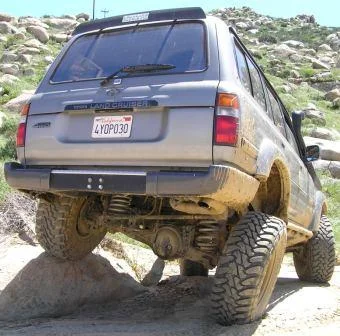

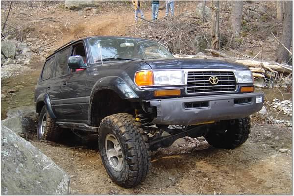

1. What lift Kit / components did you use? Include Spacers, if any.
*I started with the usual bits for a medium OME lift.
*However I placed Slee 4" coils in the front.
*I used Slee front control arms.
*Adjustable front/rear panhards.
I drove to Slee offroad in Co, and we put this setup together to achieve my ends - driveability, offroad ability, and a taller,wider level stance.
36x13.5R16 Super Swamper IROK radials
*Stock 16x8 wheels
*1.5" aluminum wheel spacers.
I installed Slee front control arms.
No rubbing issues with the cut front bumper ends and custom bump stop drops installed - 2" front, 3" rear.
No vibes at all.
Mainly on road/hwy. Daily driver.
Very pleased indeed.
This latest evolution described here solved many outstanding issues I had.
*I may buy 16x9 aftermarket wheels .. fatten out the stance a touch more.
*I would like to add the upcoming Slee front bumper and therefore a small front spacer to relevel the 80 subsequently.
A full writeup of this build can be seen in
this thread.
*Stay tuned for hardcore shots .. I'm usually too busy busting my junk to snap pics. :flipoff2:

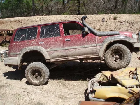

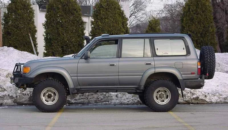

Slee 6" springs
1.5" aluminum spring spacers
1" UHMW body lift
OME N-73L/7100 Bilstein AK7114R04 255/70 valving
OME steering damper
Outback AWR front control arms
adjustable caster using Toyota IFS camber hardware
built around tires 35" to 37"
BFG AT KO 315/70/R17’s on pavement
Toyo Open Country M/T 37/13.5R17 on trail
4. Rim specs
Toyota Tundra/Sequoia Alloy 17" x 7.5" for pavement
Rock Crawler Steel 17" x 9" for trail
What the Outback front control arms provide plus the adjustable caster for the front-most mount
None that I consider negative
No, however, I installed a CV front driveshaft and new u-joints in the rear driveshaft and have Slee adjustable upper rear control arms to set rear pinion angle.
This is my DD. I also wheel this wherever I find myself.
Yes. I am running 4.88 ring and pinions and am happy with that choice.
Buy the kit from the beginning.
3-link or 4-link in the front with appropriate shocks. Run 37" BFG AT's on the street.

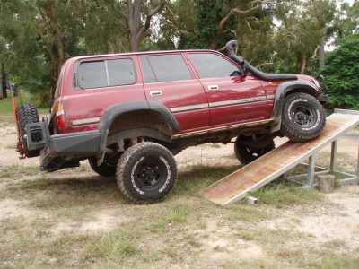

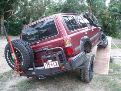

Slee 6" springs
14 inch 5150 Bilstiens
OME steering damper
Rear bump stops
no front sway bar.
Custom modded rear sway bar.
14 inch bilstiens 5700 (?) or are they 5500? the have a remote resivoir and does not use busing but a spherical end.
Looking to run a roughly 37 inch tire.. In running trails that get you high centered or caught on the sliders with 35's and J's going this route seemed logical
37 inch SSR, Grooved and Hammered. Saving coin for something new. Wouldnt really recommend this tire now that there are so many other good choices out.
4. Rim specs
17 inch pro comp extreme alloy. 5 inch bs but i run 2 inch spacers. I am going to go to a 16 or 17 inch steel wheel 2 inch bs once i get new tires
I have custom built front control arms. Looking back I wish i had just done a 3 link. These work better than stock but would have done it differently.
None, I run no bump stops up front
I run a CV joint up front. rear is stock except i did new joints at same time of lift. I adjusted the rear arms back to stock angles
When i built this rig it was not my DD. I am now DDing this vehicle and my toy with some things like a front sway bar, Defenitly getting different tires as these are LOUD and UNBALANCED.
Sure. i have 4.88's, Thinking i will go supercharger in the next 16 months.
Ya so far. Its hard to find the happy medium where you still enjoy driving it on the road yet still have the results off road. I just drove it from utah to illinois and it was very drivable, a front sway bar would have done wonders though
I liked my j's and the progression but doing it once is always better. I have the "stiffer" rear six inch springs, go with the softees
37's seem like a great size. no bigger (anytime soon) wouldnt mind having an extra set of 35's to throw on if there is no wheeling coming up.

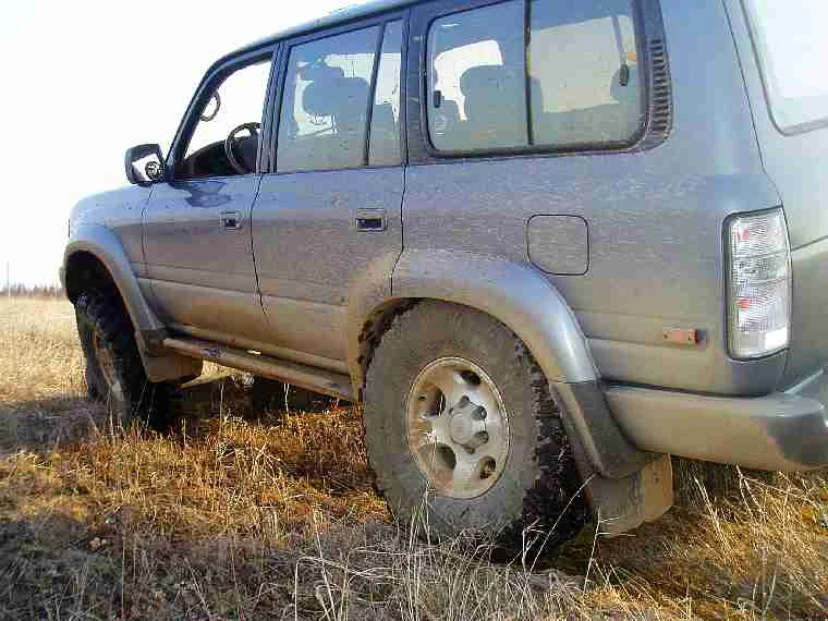

Old Man Emu 2.5" Heavy lift:
2 x OME 850 Front Coil Springs
2 x OME 863 Rear Coil Springs
To improve clearance and improve handling.
It is my daily-driver and gets predominantly highway miles.
Has to accomodate family needs.
295/75 R16 Nitto Terra Grapplers
Old Man Emu CA77B Caster Kit
No
No
Daily-driver and family-hauler.
Camping trips and mild 4x4 trails.
Yes.
Nothing.
No.
My ROTW writeup with pics
Action pics coming soon.
I selected a hybrid setup which netted me 4" of lift.
2 x SOF4FM Front Coil Springs (Slee Offroad)
2 x OME 860J Rear Coil Springs
2 x N73L Nitrocharger Shocks
2 x N74L Nitrocharger Shocks
2 x Slee Front Control Arms
Homemade:
bumpstop drops
brake line extensions
front swaybar removed
rear swaybar removed
Hitch Pin Mod
I wanted a lift that would have the abililty to clear true 35" tires and tackle moderate/mod-difficult trails and still ride nice.
35 X 12.50 X 16 Interco Trxxus M/T
Currently I am running the Slee Offroad control Arms
Minor rubbing on rear mudflap, very minor trimming needed. Mudflap is now gone so only rubbing occurs under full stuff due to not having adjustable trackbars on the rig yet.
As of now, the only driveline issues are some vibrations most likely caused by the fact the original u-joints are on the rig. New ones are on order from the parts shaman and should be on shortly.
Daily Driver, camper, wheeler
So far the on road driving is very good, haven't gotten a chance to "thouroughly" check it's off-road performance. Went on one trip and it performed VERY well. Extremely stable and the front flex is almost matching the rear. The vehicle stayed very level and worked very well.
I would go with Slee 4" coils in the rear, I removed my 3rd row seats, but with my rear tire carrier, and gear it definitely feels softer than the front.
I'm planning on putting the pan-hard adjusters in and changing to 4.88 gearing.
Here is a thread about the differences I made to help get more flex:
https://forum.ih8mud.com/showthread.php?t=95271&highlight=RTI
OME 850 Front / OME 860 Rear / Later Added 30 MM Spacers to Front
Bilstein Shocks
Knew that I was going to run an ARB front bumper with winch so I went heavy up front. No mods to rear bumper and I don't carry any kind of load when wheeling or travelling to speak of so I stuck with mediums in rear. I later added 30MM poly spacers up front to level the truck.
Also - I've lifted alot of trucks through the years and have had problems with lifts over 2.5 inches such as, driveline vibration, alignment, handling etc.. Unless it's a dedicated trail rig I would not do more than the 2.5 inch lift.
285 / 75 / 16 - With stock gearing and available engine power this is as much tire as I feel the vehicle is capable of turning efficiently. They also work well with the 2.5 inch lift - no rubbing, etc..
Stock 1997 wheels.
Can't remember exact degree, but installed as per OME instructions.
Note:First two OME kits failed - poly seperated from metal. New style seems to be good to go.
No - 285 tires.
No. Maintain the 2.5 inch lift max.
Transportation, moderate wheeling, fishing, camping, etc..
Yes - my third 80, I had two 60's and two 40's going back to 1979.
Nothing.
None, unless I decide to retire truck from DD use which I am contemplating. Then I will add more aggresive tires. Probably TRXS MT's, Aussie locker and sliders.
OME 418/421 springs (OZ spec competition springs)
OME N73L/N74L shocks
Superior Engineering 30mm spacers in the rear
Tough Dog adjustable panhard rods
Fitted ARB rear bar that caused the rear to sag from my old 2" lift to below stock height. Decided that if I was going to put heavier springs in I might as well go 4".
285/75R16 Goodyear Wrangler MT/R
4. Rim specs - 16x8 OEM steel wheels powdercoated black
Have EFS 3* CC bushes
Only on the 3" exhaust tailpipe under full compression of the RHR wheel
Not as yet.
Daily driver- to and from work each workday (75km round trip)
Weekend warrior- medium to hard 4wdriving most weekends
Long distance expedition vehicle- Annual 4 weeks leave, big trips
As my truck is on the heavy side I think the L shocks are struggling to control the weight. Before the weight increase the old OME shocks were fine but now I feel I need stiffer valving on my new shocks in certain conditions.
After being led astray by non-mudders and fitting 3* CC bushes I would fit 5.5* CC plates or drop arms first up if I was doing it again. Maybe fit Tough Dog or Dobinsins shocks instead of the OMEs for the reasons listed above.
Drop arms and stiffer shocks as above. I also have a set of Simex Centipede Extreme Trekkers 35/10.5R16s on 16x8s for play use. I haven't tried them with this lift yet to see if they rub but they didn't with the 2" lift so don't see any dramas. Haven't modified my bumpstops yet (I know, it's on my to do list).
Edit; BTW I don't run swaybars at either end and I've strengthened the rear control arms with 30x30x3 steel angle iron stitch welded to the underside of the lower arms.
:cheers:Mick
What came in the kit from slee
No
None
Just retired as DD this month, has been DD since adding the lift in 2003. One weekend/month does about 25 miles of forest trail.
Yes
Add ~ 1" to rear ride height due to the addition of custom/built-in tool storage and CO2 tank storage. Maybe by switching to the heavy springs.
Nope, just gears some day.....
