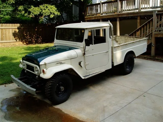

I have two bone stock rigs, both in great shape and running. I bought a 13BT w/5 spd , PTO, and cable lockers to put in my 74V8j40. Problem is that I sold that truck before I received the diesel motor and bought this sweet 78fj40. So, do I put the 13BT and axles in the 78 california spec fj40 or the nearly pristine 66 FJ45? Neither truck will see heavy wheeling, but I do take the 40 out some to Tellico and Uhwarrie.

no brainer,
go with dieseling the 45, that will make it a pleasure to drive and much mor epracticle than the 40...

i would stick the entire drivetrain under the 45 since it will fetch the best dollar down the road.
i do agree with crusty though the 45 is a rare beast in really nice shape but the parts are getting harder and harder to find to rebuild the brakes and clutch and axles so if you will be needing to upgrade anyway might as well go with the best milage and once you go diesel you won't go back...

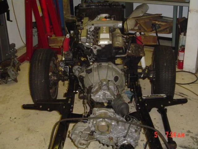

Guessing you have vacume s*** on the transfercase? If so you will have to loose it or notch the frame for either vehicle install.
Edit, also to mention split the tranny from the engine and make sure the pressure plate is not stuck to the flywheel if it has sat for some time in Japan outside. I learned this one the hard way after it was in the truck.

I'm pretty sure adding the 13BT will increase the value of either. The purists will cringe if it goes into the 45 but the market will pay more for the the rig with it in.
Being one who appreciates purists but modifies nearly everything I'd recommend putting the diesel in the 40 in spite of agreeing with most of what crushers said and the only reason is the wheeling. I'm sure you're going to take whatever rig gets the diesel further than you ever would previously for events etc. My GF and I think nothing of jumping in her 13BT powered 40 series for a thousand mile trip. The 13BT makes the wheeling even more fun once we get there. If that powerplant was in the 45 its inevitable that its going to see rock rash sooner than later. Its easier to avoid in the 40 and easier to fix.

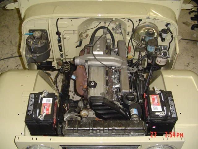

Is that the 6 cylinder? It is not a 13BT I have that figurd out.
You got it Pontiac......
So you can see how much room there would be with a 13BT.
Forgo the battery tray on the passenger side as it did not allow enough room with the 1HZ for a factory type air cleaner.
With the 13BT, (which I am not familiar with) the air cleaner turns a 90 degree elbow and down. Might be a good fit even with the battery tray.
Rob
I think that the 13 BT will fit fine. I wonder how much room you would have with a 1HD T. Yours doesn't look to bad.
the 40/42 series did come with a vacumm t/case and you could move the tranny mount over an inch or more to clear the vacumm OR you could buy the front half of a manual t/case and r&r that part in for a very clean install.
Rob
Rob ,where did you finally put the vac canister for the brake booster.
Did your 1HZ have a vac line attached to the water pump?
Just curious as the vac line attached to the water pump is not mentioned in my manuals but thats how they go.(1HZ 0nly)

I have also thought about the vacuum shifting transfer in the 45, and without actually looking at it, I bet you could hook up a mechanism to retain it. The split case vacuum unit is said to be too wide, but I bet you could rig something up to combine the two. I've heard people talk about tweaking a column shifter to work a 4spd, but talk is all it was....I have yet to see a pic.
these are just a suggestion of course...
You would need more like 3 inches over on the frame, I could not make it fit without cutting into the frame.
You made me go crawl under it with my good cloths on(actually I had to know).
Exactly 1.25inches of space on PTO side, with less than 1 inch on vacume side.
Maybe the older style transfercase was physically a tad smaller or the vacume setup was different.
So as for a newer split case assembly it would not fit.
