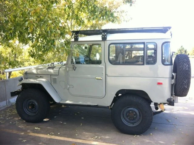

Low rider pic

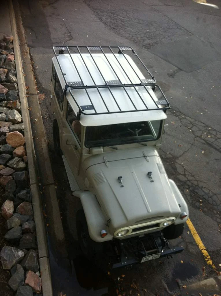

Here's a top view of the rack if anyone cares.
