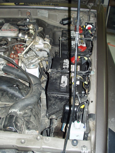

After fooling around with relay circuits and finally deciding that the simpler the better, I came up with the final setup to allow me to switch my Solar Converter from Load Balance to Convert utilizing a switch. Greg B. suggested that I hardwire the white 12v output of the Solar Converter with the fusebox, and splice in a toggle switch between that wire and the low side battery (+) pole. This would provide uninterupted current to the 12v fusebox while allowing me to switch back and forth between the two modes.
I changed all of my 12v wiring supplying the fusebox with 10 gauge wire. For a switch, I decided to get a nice on/off battery switch from a local marina because they are corrosion proof, heavy duty, and can handle way more current than I'll ever need (mine's good for 250A continuous). I found a spot on my firewall for the switch:

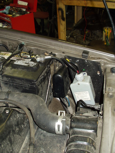

I also cleaned up all the wiring so that there are no exposed wires from the converter, switch or fusebox.
The Solar Converter remains in its original position, minus all the extra circuitry and relays that I added.
Everything tests out okay, and I'm finally happy with the setup. Cheers.
