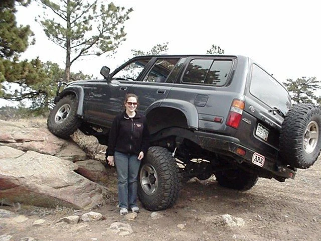

I know I'm lost here in the hardcore corner ;) But I have put 14" travel Bilsteins on the rear of my 80, and I use all 14" of travel. It has the standard Panhard setup as well.
But if you were designing from the ground up, it might be better to eliminate that 5th link, less stuff to deal with.
attachment.php
80 link bushings can be flexy :D
