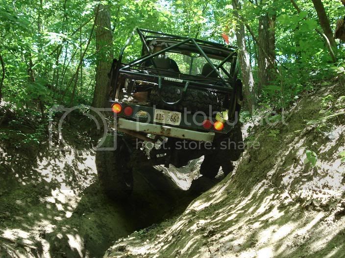

The winch cable was out to pull the other trucks out of the trail the pig just came up. :D
Captured the bottoms. The tops are locating just fine with the bumpstops inside the springs.
I'm gonna capture the tops as well. The springs banging and popping are driving me nuts.
