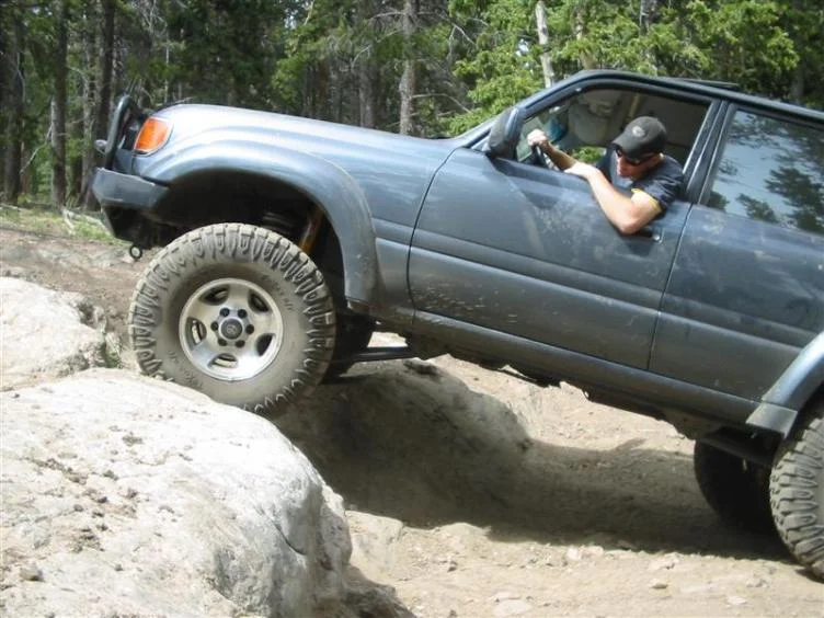

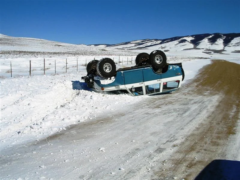

Pic 1: the reason why I'm sportin' the 80...It was an FJCruiser photo shoot in my hometown of Walden, CO... 18 degrees below zero, ice roll...I didn't get hurt but my prized decked out piggy got parted :(

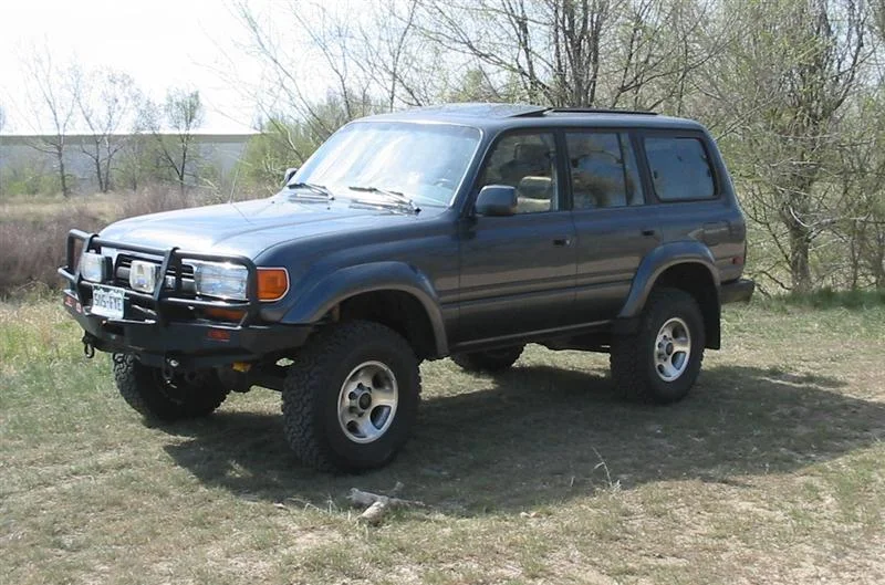

Pic 2: One of the first mods, ARB front bumper...found one used for next to nothing, that next week we went to a family reunion in Kansas and hit a deer at 70mph...no damage to vehicle or bumper...deer not so lucky road pizza, wife finally approved the ARB :grinpimp:

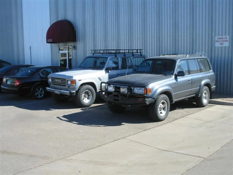

Pic 3: The next mod came in the form of a used(and tested!!!) rear TJM bumper from Actionjackson on the board. I had to rebuild the bearing setup and fabricate the rear tire mount section. Basically around the same time the lift went on. Lift is a bastardize/franken-lift that is ever evolving :cool: Upon initial install,
Slee 4" front Springs
OME "J" rear springs
OME L shocks
Homemade brakeline extensions, front swaybar spacers, bumpstops
285 BFG A/T's
Slee Front Control Arms
So about 1 week after the lift, I got some new shoes. I decided with to go with the 35X12.50.16 Interco Trxus as I have heard some good reviews on these tires. My first choice were the Toyo M/T's but they have just finally come back into stock. So far I have been very happy with the tires although I'm most likely moving up to a 36 or 37. :rolleyes: :D

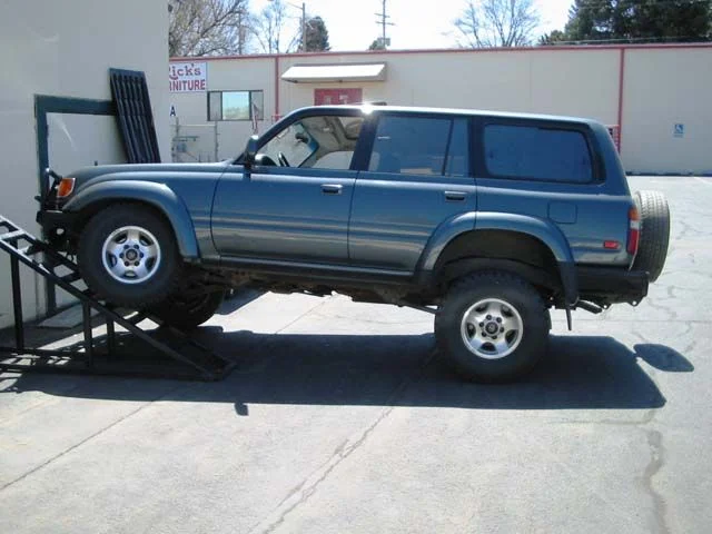

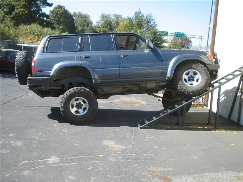

About this time, well actually before, I had started documenting all changes to the vehicle in terms of flexing. There is an RTI ramp about 2 blocks from my house so I get to test all the time. Changes haved ranged from stock vehicle up to 14" rear travel shocks, hitch pin mod, no swaybars etc.
here is that thread if you are intersted:
https://forum.ih8mud.com/showthread.php?t=95271&highlight=RTI
here is the stock cruiser pic flex:
attachment.php
Pic 3: is where I am at now, with 14" rear bilsteins
attachment.php

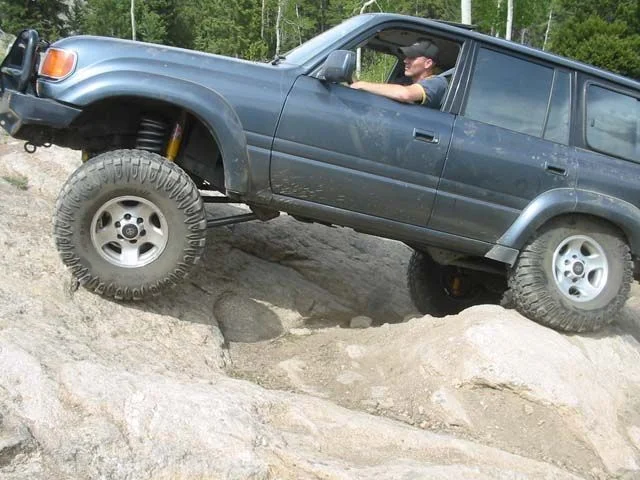

Crystal mountain, I have the "hitch-pin" pulled on this spot. Front end is moving pretty good
attachment.php
This is still OME shocks all the way around, the "L" shocks, very good travel!
attachment.php

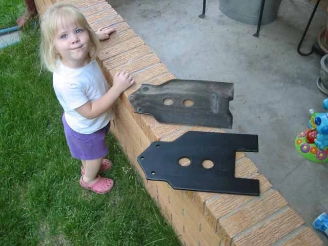

I had my fabshop make up a skid plate that mocked the factory original. I will add more bracing after I get my sliders on to make sure it fit with them correctly. Made out 3/8" steel...should finish up nicely. This is my helper as well.
attachment.php

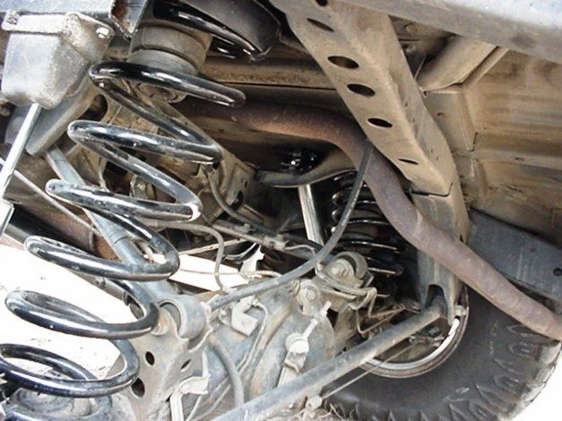

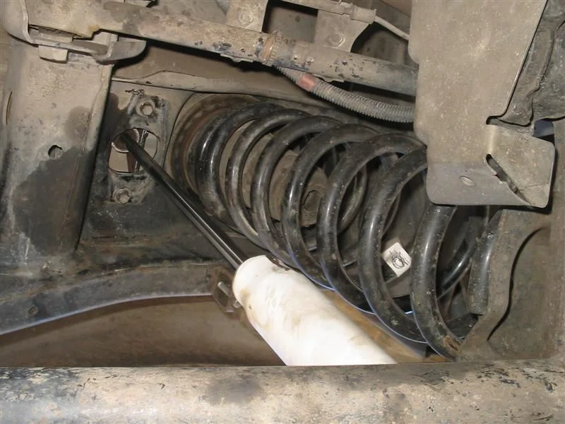

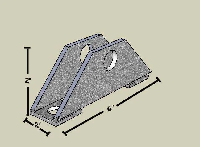

In a quest for more travel and stabillity. I wanted to try some longer shocks because I could easily max out the rears. fully compress and fully extend them. So I looked around for different mounts as we know the rear uses pin/eye setup and that OME L is the longest bolt in size. No one in the US I know makes an adapter for eye/eye mount and gives you more travel. I got the idea from ActionJackson and made it work with a stock setup, no bodylift.
So I mocked these up with cardboard then had them cut out of steel tubing. here is the thread on that. Definitley need to work measurements to get the best fit...thats my disclaimer anyways...this is more of guidelines... :D
This allowed me to fit 14" bilsteins 5125 series shocks in the rear on a 4" lift, I lost 1 more inch of compression because the bilsteins are a pretty long compressed shock. 20.75 compressed, 34.7" extended
https://forum.ih8mud.com/showthread.php?t=112634
attachment.php
attachment.php
Since then, I have decided to add a 1" spacer all the way around to get more travel out of the shocks since I basically lost 1" of compression over the L shocks. i am planning on going up to 36" or 37" tires so I might have needed a bit more bumpstop anyways.
I converted the front to an eye/eye style as well by making my brackets, but found out the best solution from someone on the RS board is to buy them from AA Mfg for $2.00 a piece...would have been useful BEFORE I did the mod. :cool: :cheers:

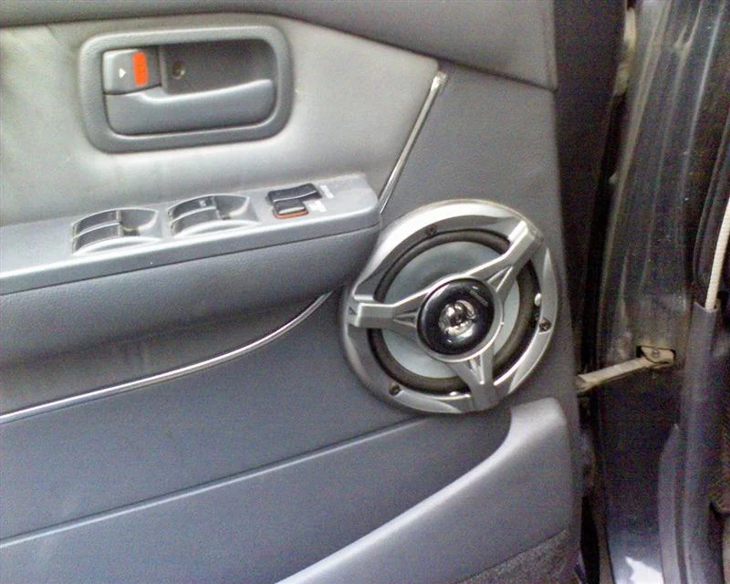

PIC 1: Since my factory speakers were poo...I decided to upgrade! Cheaply, my wife had a gift certificate to a stereo place and we decided to buy these. Sound SO much better than my wife's stock 97 speakers. They are Kenwood 6 1/2" and I had to mount them on the outside of the panel. They sound good and match the interior :princess:
Pic 2: Kelly Flats Wheeling
Pic 3: Crystal Mountain Ledge

More pics of the shock mounts, please.
nice write up! what did you do to mount your rear shocks ( specifically the lower mount) ?
On the bottom, I just reamed out the bushing a little more to fit on that OEM post. It's a bit bigger than what the shocks can use. Time will tell if that bushing goes to hell or not. If it does, I may just try to order bushings for the OME/OEM shocks or find someone that trashing some and use those...that would have been much easier :doh:
I'll see what I can do to get pics of the shock mounts. The tail pipe is factory, and will get cut back this winter, even tho I have yet to smash it :confused: which I figured I would have long ago.

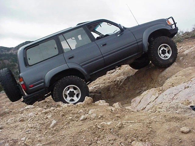

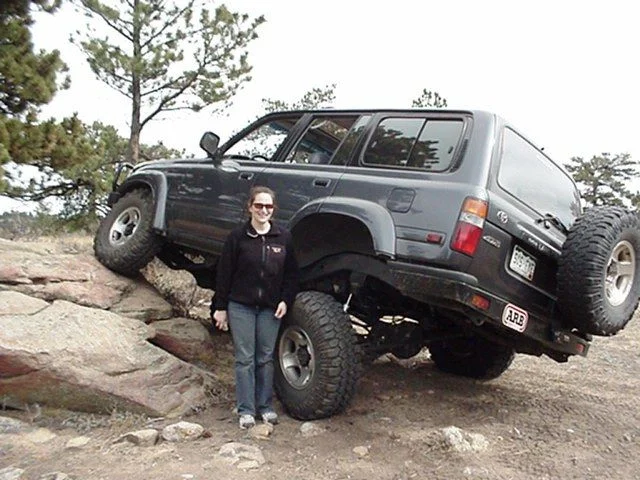

Here is some photo's from last saturday, TJ (pablocruise) and I went up to Kelly Flats to do some wheeling. On the way back I got pulled over in the Poudre Canyon doing 60 in a 35 :eek: I actually got a warning:cool: I was slowing down off a straighaway going into the narrows which goes from 45 to 35...:doh: Thank you Forest Service Officer Huff!!! :beer: I honestly did drive the speed limit all the way home.
Pic 1: Climbing part of Hear Attack Hill
Pic 2: Flexing on Posuer Rock, TJ's lil' Sister Katie standing in front, yes she's taller than 5' ;p
Pic 3: you can kinda see the shock mounts and how they work a little better in this pic
